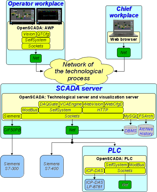

1 Areas of application OpenSCADA
Separating to the employment areas was made to simplify perception of the program functionality in light of traditional area of the project OpenSCADA — automation of technological processes. But also there possible mixed and specialized configuring of the program for real-time data operation, for example into areas: ERP, Billing, Smart House and etc.
Fig.1. Roles of OpenSCADA.

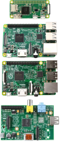

1.3 Environment of execution of the controllers (PLC)
LP-8781
LP-5141
SMH2Gi
PCA-6753
Raspberry Pi
Orange Pi

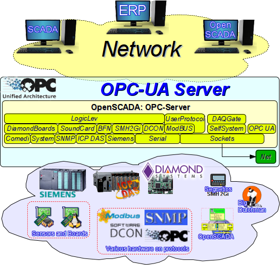

1.4 Universal OPC-UA server
Due implementation of the protocol OPC-UA into agent mode, OpenSCADA can provide a popular function of the OPC-server to client's protocols, which supports and direct implemented into OpenSCADA. The function common uses on platform MS Windows®, and many SCADA-systems on the platform work exclusively with OPC—servers, as the data sources. Thus, OpenSCADA can act as an universal OPC-server on Linux platform (Fig.2).
In plans. With adapting OpenSCADA to work on MS Windows® platform and implementing the work with OPC-DA by system DCOM, there will appear possibility for applying OpenSCADA into the gate OPC-DA -> OPC-UA role, which means free integration of old systems to the new or accumulation systems.
Fig.2. OpenSCADA role as OPC-UA server.
Acquisition and control of internal and external data (DAQ)
Different types of logical and physical sources that have data access utilities or accessible through simple and specialized network protocols. This is accomplished by writing a data acquisition procedure of the user protocol in the user programming language Module of the user programming language JavaLikeCalc
Module LogicLev
Module of the user protocol UserProtocol
Formation of logical sources and derivative parameters structures, based on templates of parameters and data of other sources Module LogicLev
Formation of logical sources using block diagrams Module BlockCalc
External servers and PLCs are built on OpenSCADA, possibly for duplication. Module DAQGate
Information about hardware and software platform Module System
Industrial controllers and other devices by the ModBus protocol Module ModBus
Industrial controllers by the DCON protocol Module DCON
Industrial controllers and other devices by the OPC-UA protocol Module OPC-UA
Industrial controllers and other devices by the MMS(IEC-9506) protocol Module MMS
Network devices and other sources by the SNMP protocol (Simple Network Management Protocol) Module SNMP
Industrial equipment of the firm ICP DAS, modules of the series: I7k, I8k, I87K and other on the ISA bus Module ICP_DAS
Industrial controllers of the firm Siemens of the series S7 Module Siemens
DAQ-boars of Diamond Systems Module DiamondBoards
DAQ-boars on the buses ISA, PCI, PCMCIA and USB Library Comedi
Module Comedi
Input channels of the sound controllers Module SoundCard
Automation of the "Big Dutchman" company Module BFN
Discrete inputs/outputs of general purpose of different single-board computers Module GPIO
