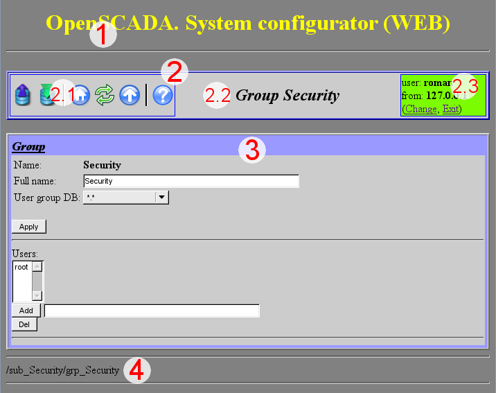

The operating window of the configurator consists of the following parts:
Addressing of the pages begins with an element of the second-level URL. This is due to the fact that the first-level element is used to identify the module of user Web-interface. For example, URL: "http://localhost.localdomain:10002/WebCfg//Functions" can be deciphered as call of the first-level page "Functions" of the Web-module WebCfg on the host "localhost.localdomain" through the port 10002.

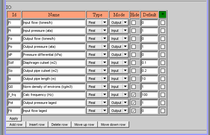

Tables contain values of basic elements. Type of the basic element is defined separately for each column. Example of the table is shown in Figure 6.
