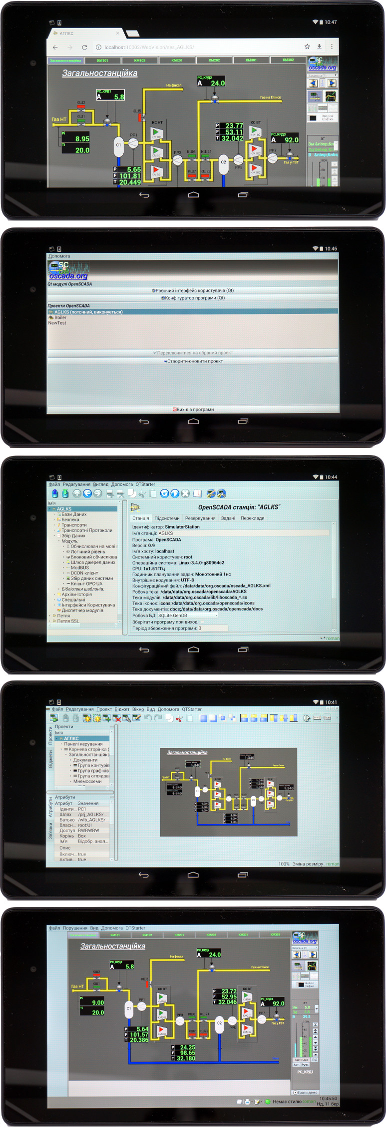

Tablet computer Asus Nexus 7 II (2013)
Key specification of the tablet:
| Hardware platform: | ARM Cortex-A15 [ARMv7] |
| Central processor: | Four-core Qualcomm Snapdragon APQ8064-1AA 1500 MHz |
| Operational memory: | 2 GiB DDR3 |
| Permanent memory: | 32 GiB |
| Video subsystem: | 400 MHz quad-core Adreno 320 |
| Screen: | IPS, 1920x1200 px (323 ppi) |
| Hardware | CPU | Entry into JavaLikeCalc, us | Operation sin(Pi) [in JavaLikeCalc], us | Operation pow(Pi,2) [in JavaLikeCalc], us | Model AGLKS [Vision, main mnemo], %(core) | Extra tests and notes |
| Google Asus Nexus7 II | ARM Cortex-A15, Qualcomm Snapdragon APQ8064-1AA, 28nm, 1.5 GHz, 4 Cores | 0.321 | 0.134 [0.239] | 0.122 [0.264] | 54 [82] |
armv7-a, Soft, VFP, Extra tests. |
