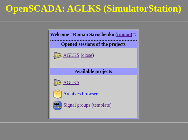

Fig.1. Authentication page.
Fig.2. Connection or creation of a new session of the execution project of the VCA.

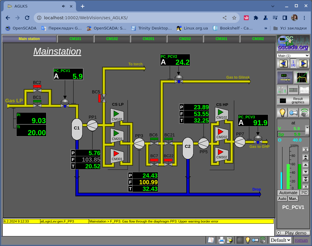

Fig.3. Main execution window.

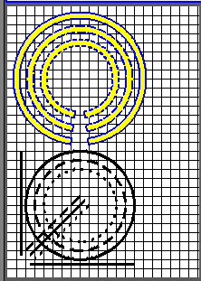

3.1 Elementary figure primitive (ElFigure)
Support of the elementary figures is implemented: lines, elliptical arcs, Bézier curves and fill of the enclosed space with the color and image with the properties:
Figure shows a part of the screen with a frame containing the elementary figures.

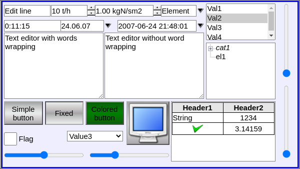

3.3 Primitive of the form element (FormEl)
Provides support for the form elements on the VCA frames with the planed properties, including the types:
The "Enabled" and "Active" modes are implemented, as well as the transfer of changes and events to the data model of the VCA — engine. The mode "Active" cause to the activity cursor set for not empty background and the addition conditions of the different views "Text", "Media" and "Box":
Figure represents a part of the screen with the frame containing the above-listed elements of the form.

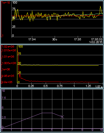

3.5 Primitive of constructing diagrams (Diagram)
The diagrams construction element releases for types: "Graph", "Spectrum" and "XY", with properties:
Figure represents a part of the screen with the frame containing examples of the diagrams: "Graph", "Spectrum" and "XY".

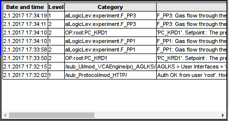

3.6 Primitive of the protocol formation (Protocol)
Provides for support of the element of the protocol formation with the following properties:
Figure represents a part of the screen with the frame containing an example of the protocol.

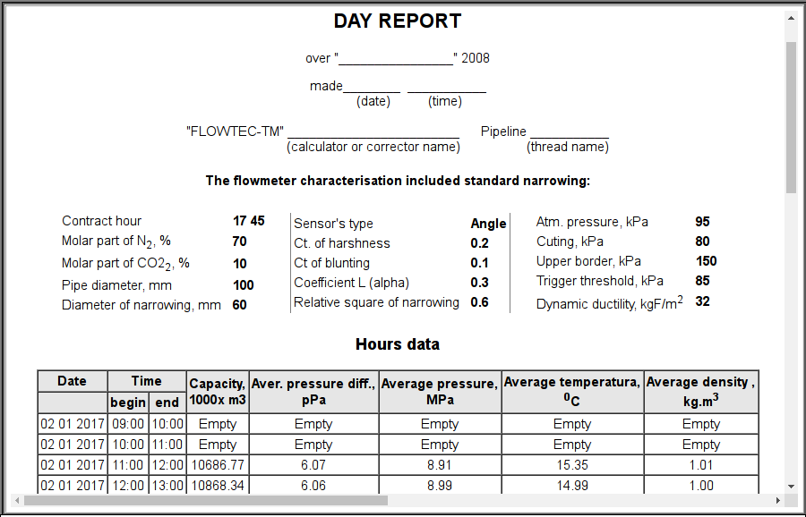

3.7 Primitive of the report formation (Document)
Provides for support element of the report formation with the following properties:
The basis of any document is the XHTML template. The XHTML-template is the tag "body" of the WEB-page which contains the document's static in the standard XHTML 1.0 and elements of the executable instructions in the user programming language of OpenSCADA in the view <?dp {procedure} ?>. The resulting document is formed by the procedures execution and insertion of their result into the document.
The source for values of the executable instructions are the widget attributes of the primitive, as well as all the mechanisms of the user programming language OpenSCADA. Attributes may be added by the user and they can be linked to the actual attributes or parameters or they can be autonomous, values of which will be formed in the widget procedure. In the case of linked attributes the values can be extracted from the archive-history.
Figure represents the frame, containing a sample of the document.

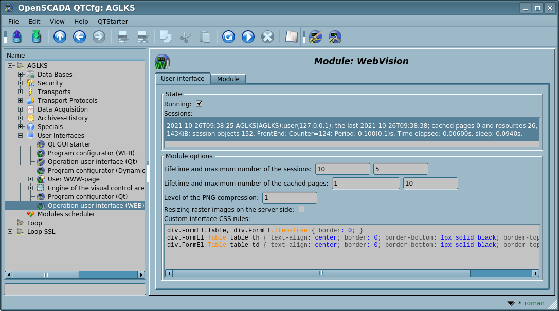

4 Overall configuration of the module
To configure and control this module, you have the configuration page of the OpenSCADA control interface (Fig.4):
Fig.4. Configuration page of the module.
You can deeply customise main interface of the module overriding and adding the HTML and JavaScript code by placing to folder of your OpenSCADA project files WebVisionVCA.html and WebVisionVCA.js which initially you can obtain from the module source code — UI.WebVision.

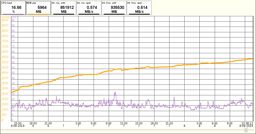

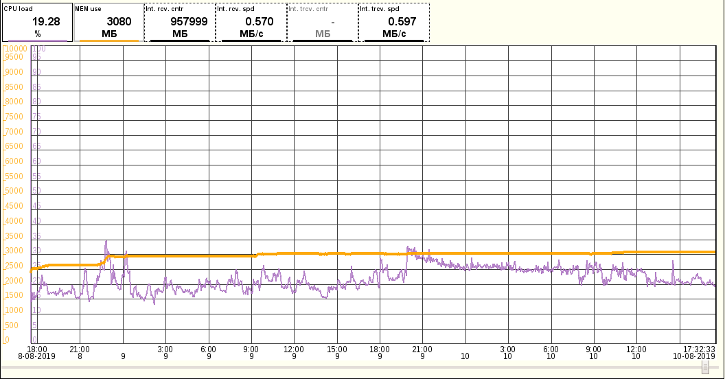

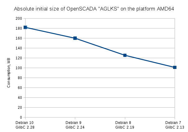

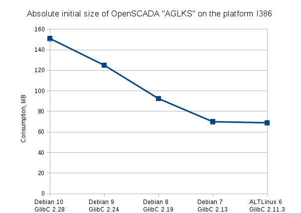

5 Efficiency and scalability
31.07.2019
GROUNDS: The Web-sessions may create many objects servicing the VCA-session for generating images, processing documents and performing other background functions of the end user Web-interface. Moreover, in difference to Vision, the VCA-sessions may be created, closed and recreated again multiple times for different users and remote hosts. In the time the memory heap is affected by the memory fragmentation, so the program consumes more memory than at the start. The table below represents the phenomenon for different environments and the first page of the DemoDB (AGLKS) project reopening:
Environment Initially, MB Iter. 1, MB Iter. 2, MB Iter. 3, MB Iter. 4, MB Iter. 5, MB Resume
Complete creation the Web- and VCA-sessions
Debian 10 amd64, GLibC 2.28, GCC 8.3.0 + MALLOC_ARENA_MAX=2 181 189 190 195 195 194 Satiated on the iteration 3, base consumption 8 MB, extra consumption 5 MB (62.5 %), liboscada.so 3.5 MB, ui_WebVision.so 0.75 MB
Debian 10 amd64, GLibC 2.28, GCC 8.3.0 + MALLOC_ARENA_MAX=1 177 185 186 186 185 186 Satiated on the iteration 2, base consumption 8 MB, extra consumption 1 MB (13 %), liboscada.so 3.5 MB, ui_WebVision.so 0.75 MB
Debian 9 amd64, GLibC 2.28, GCC 8.3.0 + MALLOC_ARENA_MAX=1 160 168 168 168.5 168.5 168.5 Satiated on the iteration 1, base consumption 8 MB, extra consumption 0.5 MB (6 %), liboscada.so 3.5 MB, ui_WebVision.so 0.75 MB
Debian 10 amd64, GLibC 2.28, GCC 8.3.0 + optional background objects in WebVision 184 194.5 200 207 207 212.5 Satiated on the iteration 5, base consumption 10.5 MB, extra consumption 18 MB (171 %), liboscada.so 3.5 MB, ui_WebVision.so 0.75 MB
Debian 10 amd64, GLibC 2.28, GCC 8.3.0 182 191.5 199 206 212 212 Satiated on the iteration 4, base consumption 9.5 MB, extra consumption 20 MB (200 %), liboscada.so 3.5 MB, ui_WebVision.so 0.74 MB
Debian 9 amd64, GLibC 2.24, GCC 6.3.0 160 170 178 179 183 185 Satiated on the iteration 5, base consumption 10 MB, extra consumption 15 MB (150 %), liboscada.so 3.5 MB, ui_WebVision.so 0.72 MB
Debian 8 amd64, GLibC 2.19, GCC 4.9.2 125.5 133 139 139 139 139 Satiated on the iteration 2, base consumption 7.5 MB, extra consumption 6 MB (80 %), liboscada.so 3.8 MB, ui_WebVision.so 0.79 MB
Debian 7 amd64, GLibC 2.13, GCC 4.7.2 101 108 111 112 112 112 Satiated on the iteration 2, base consumption 7 MB, extra consumption 4 MB (57 %), liboscada.so 3.4 MB, ui_WebVision.so 0.85 MB
Debian 10 i386, GLibC 2.28, GCC 8.3.0 + MALLOC_ARENA_MAX=1 144 152 152 152 152 152 Satiated on the iteration 1, base consumption 8 MB, extra consumption 0 MB (0 %), liboscada.so 3.7 MB, ui_WebVision.so 0.9 MB
Debian 9 i386, GLibC 2.24, GCC 6.3.0 + MALLOC_ARENA_MAX=1 126.5 132.5 133 133 133 133 Satiated on the iteration 1, base consumption 6 MB, extra consumption 0.5 MB (8 %), liboscada.so 3.7 MB, ui_WebVision.so 0.9 MB
Debian 10 i386, GLibC 2.28, GCC 8.3.0 151 158 162.5 166 166 166 Satiated on the iteration 3, base consumption 7 MB, extra consumption 8 MB (114 %), liboscada.so 3.7 MB, ui_WebVision.so 0.9 MB

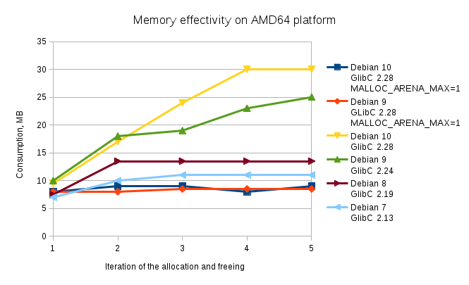

CONCLUSION: We see obvious degradation in the memory effectivity on the last Debian releases starting at Debian 8 (GLibC 2.19) on I386 and Debian 9 (GLibC 2.24) on AMD64, when the memory consumption increased up to 200% after 3,4 free-allocate iterations of the same data. To more presenting of the problem there have built follow images on the data basis:
Fig.5. Memory effectivity on AMD64 platform.

Fig.7. Absolute initial size of OpenSCADA "AGLKS" on the platform AMD64.
Fig.8. Absolute initial size of OpenSCADA "AGLKS" on the platform I386.
MEASURES:
  1. The optional background objects were implemented for the primitives "FormEl" and "Text", what will have most effect on mnemonic-schemes with these elements and wont have many effect for other, see the measuring data above.
  2. There were some tries to tune the memory allocator of GLibC using "Memory Allocation Tunables" without any significant effect, so we will notify the Debian community, firstly.
  3. The problem was detected in arenas of the memory allocator, setting whose number to 1 (MALLOC_ARENA_MAX=1) completely resolves the problem and the effect you may see on Figures 9, 10, for a real big application.
Fig.9. Tendency of the memory consumption on a real big application at the default conditions.
Fig.10. Tendency of the memory consumption on a real big application at the environment variable MALLOC_ARENA_MAX=1.
