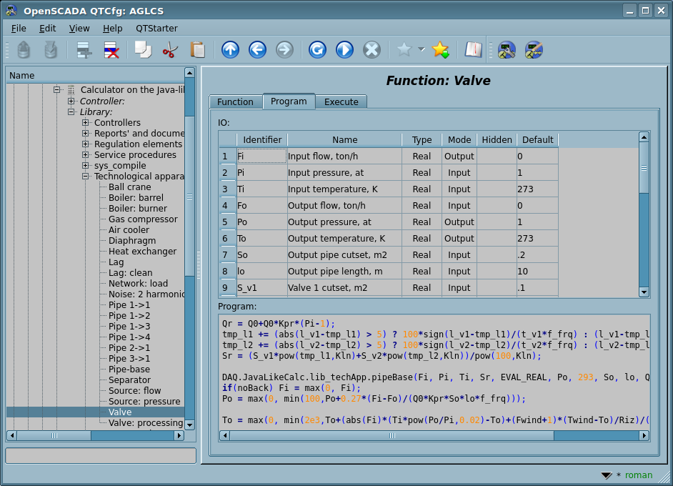

Here are some examples of programs on the Java-like language:
//Model of the course of the executive machinery of ball valve
if(!(st_close && !com) && !(st_open && com))
tmp_up = (pos>0&&pos<100) ? 0 : (tmp_up>0&&lst_com==com) ? tmp_up-1/frq : t_up;
pos += (tmp_up>0) ? 0 : (100*(com?1:-1))/(t_full*frq);
pos = (pos>100) ? 100 : (pos<0) ? 0 : pos;
st_open = (pos>=100) ? true : false;
st_close = (pos<=0) ? true : false;
lst_com = com;
//Valve model
Qr = Q0 + Q0*Kpr*(Pi-1) + 0.01;
Sr = (S_kl1*l_kl1+S_kl2*l_kl2)/100;
Ftmp = (Pi>2*Po) ? Pi*pow(Q0*0.75/Ti,0.5) : (Po>2*Pi) ? Po*pow(Q0*0.75/To,0.5) : pow(abs(Q0*(pow(Pi,2)-pow(Po,2))/Ti),0.5);
Fi -= (Fi-7260*Sr*sign(Pi-Po)*Ftmp)/(0.01*lo*frq);
Po += 0.27*(Fi-Fo)/(So*lo*Q0*frq);
Po = (Po<0) ? 0 : (Po>100) ? 100 : Po;
To += (abs(Fi)*(Ti*pow(Po/Pi,0.02)-To)+(Fwind+1)*(Twind-To)/Riz)/(Ct*So*lo*Qr*frq);
