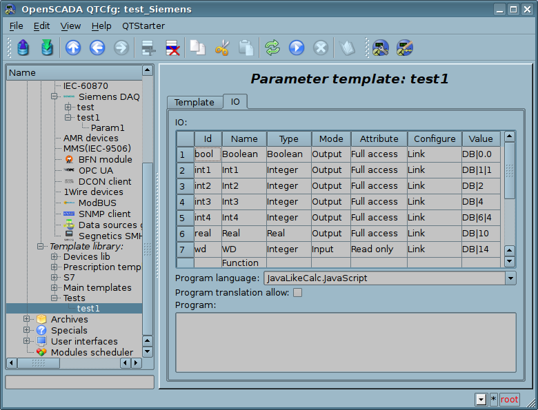

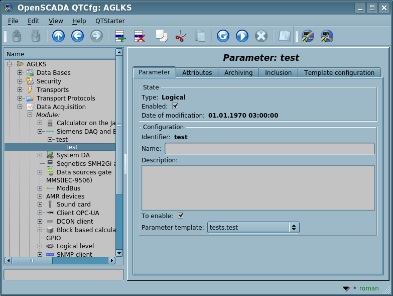

The additional configuration fields of the type parameters (Fig.4) is the selection field of the parameter template.
To configure the parameter template a corresponding tab is provided, the content of which is determined by the configuration of the template, that is the corresponding link fields and constant ones are created.

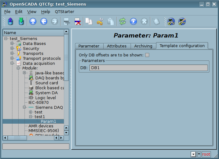

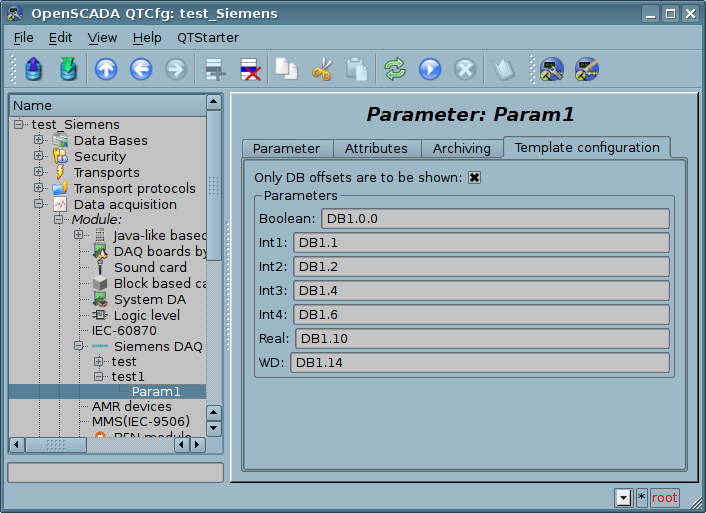

An illustrative example of the general process of configuring a parameter from a template to values is shown in Figures from 5 to 8.

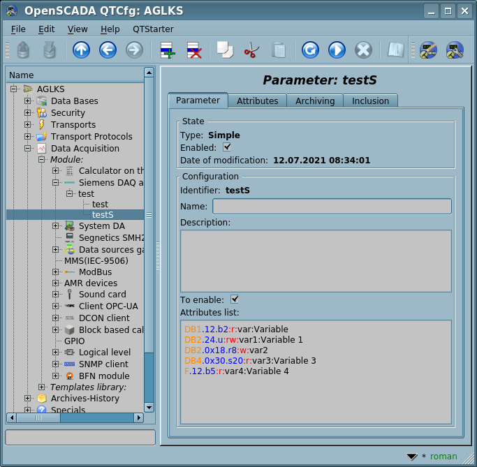

Main page of configuration parameters of the simple type parameter is shown in Figure 9.
One attribute line in the parameter of the attributes list can be written as "(DB{N}|F).{off}.{tp}{SzBit}:{flg}:{id}[:{name}]".

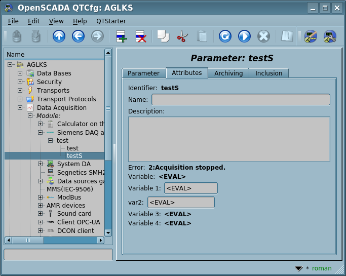

In accordance with the specified attributes list, the acquisition and creation of attributes of the parameter are performed (Fig. 10).
