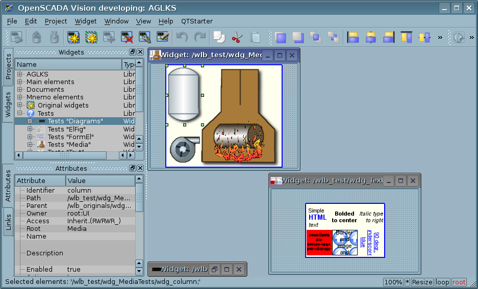

2 Tool of the graphical formation of the VCA interface
Development of the VCA interface is performed in a single window, realizing many documents interface (MDI) (Fig.2.a). This approach allows you to simultaneously open multiple frames of various sizes. The following mechanisms to control the development are used: toolbars, menus and context menus. Most actions are duplicated by different mechanisms, that allows you to quickly find the tool by the convenient method. Navigational interfaces are implemented by the attached windows. Configuration of the toolbars and attached windows is saved on exit and restored at startup that lets you to customize the interface for yourself.
Fig.2.a. Window of development the VCA interface.
Access to major components of the VCA is made by attached windows, in the Figure 2.a these windows are shown on the left side. These windows contain:
In the main space of the working window the pages of projects, frames of the widgets' libraries, user elements and elements of primitives at the time of their visual editing are placed.
At the top of the working window there is the menu. All the tools needed for development the VCA interfaces are placed in the menu. Menu has the following structure:
Above, under menu, or on the sides, there are the toolbars. Toolbars can be hidden or located, which is controlled in the menu item "View". The following toolbars are provided:
At the bottom of the development window of the VCA there is the status line. On the right side of the status line there are indicators of the visual scale of the edited frame, of the mode of changing of the size of the elements, of the mode of the VCA engine station and the user on whose behalf the development of the VCA interface is done. By double-clicking on the indicator of the user it can be changed the current user, entering the new username and password. In the main field of the status line it is displayed various information and assistance messages.

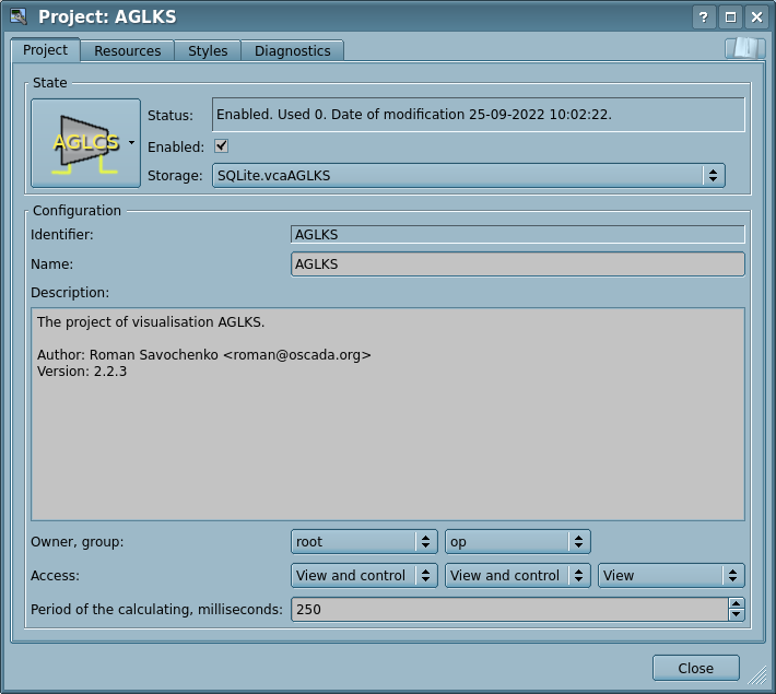

To edit properties of the visual elements there are two dialogues. The first dialogue allows you to edit the properties of containers of the visual elements, (Fig.2.b) — widgets libraries and projects. The second dialogue serves to edit the properties of the visual elements (Fig.2.d). Changes, made in the dialogues, at once, get to the VCA engine. To save these changes to the database, or restore from the database, it is necessary to use the appropriate tools of the main development window.
Fig.2.b. Dialogue of editing of the properties of the containers of the visual elements.
With the help of the main tab of that dialog you can obtain:
At.png The objects still support of specifying the spare storage addresses with tables before you rename the table in the standard form "wlb_{ObjID}" for the widget libraries and "prj_{ObjID}" for the projects.
  • user, group of users and the access for: user, users' group and all other;
  • period of the project calculating in the execution.
Fig.2.c. Tab "Diagnostics" of the project.
From this tab you can, for obtain the diagnostic messages: select the time, refresh to the current tiem and select the depth.

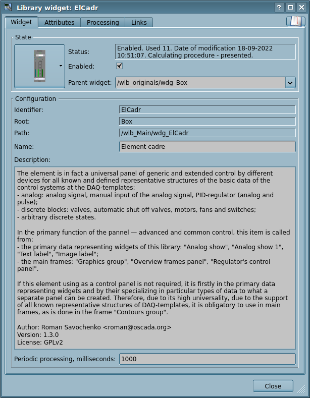

Fig.2.d. Dialogue of editing of the properties of the visual elements.
Dialogue of editing the properties of the containers of the visual elements contains two tabs: configuration tab of the the main parameters (Fig.2.b) and configuration tab of the container resources (Fig.2.e).

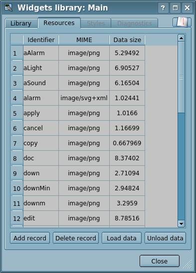

Fig.2.e. Editing tab of the container resources of the visual element.
Dialogue of editing the properties of the visual elements contains four tabs: configuration tab of the main parameters (Fig.2.b), tab of the element attributes (Fig.2.f), tab of the element processing (Fig.2.g) and tab of the element links (Fig.2.h). At different levels of the visual elements hierarchy some tabs can be available, but some are not. At.png The attribute name's rows in the "Processing" tab after the first one treat as help.

2.3 Visual editing
Visual editing of opened frames in main space of the working window is performed mostly for the Box primitive or by inner specific editing for not container primitives like to ElFigure, entry to which performed at twice mouse click.
For any frames in the visual editor available only visually changing the geometry, what you can do by placing the mouse cursor to right and/or bottom edges of the frame and next move the edge whether by mouse, holding the left button, or by keyboard, pressing the arrow keys — the arrow keys clicking cause of the corresponding size changing at 5 pixels on 1x scale and holding the Shift key you get 1 pixel. You can also change the frame scaling in the same way but holding the key Ctrl or toggling of the size mode on the status panel right.
Visual editing of the Box primitive means of the children widgets APPENDING, REMOVING, MOVING, GEOMETRY CHANGING, SCALE CHANGING and PROPERTIES EDITING.
Only for the widgets APPENDING you need no other widgets selection on the frame, just select needed widget from the library on the toolbar, or drag and drop from the tree of the widgets libraries, and place that in a mouse position by clicking the left mouse button. To cancel the add operation from the library on the toolbar, click the right mouse button.
For other operations you need to select an available child widget or a group of them, so let's see all features of the selection:
At.png The selection is saved at the keyboard focus loss when pressing the left mouse button on the selection for return.
For REMOVING the selected widget or group of them you can press whether the toolbar or context menu button "Delete visual item", or the Ctrl+D key shortcut.
As a combination of the APPENDING and REMOVING there for the selected widget or group of them you can copy/cut by the corresponding toolbar or context menu button or by the keyboard shortcut Ctrl+C/X and next unselect all and paste by the corresponding toolbar or context menu button or by the keyboard shortcut Ctrl+V.
For MOVING you can the selected widget or group of them drag, by pressing the left mouse button on the selected area, move the mouse to need position and drop, by releasing the mouse button; or can use for that the arrow keys — the arrow keys clicking cause of the corresponding position coordinate changing at 5 pixels on 1x scale and holding the Shift key you get 1 pixel.
For the GEOMETRY CHANGING of the selected widget or group of them you can point the mouse cursor to a green dot of the selection representation and next move the dot whether by mouse, holding the left button, or by keyboard, pressing the arrow keys — the arrow keys clicking cause of the corresponding size changing at 5 pixels on 1x scale and holding the Shift key you get 1 pixel. You can perform the SCALE CHANGING of the selection in the same way but holding the key Ctrl or toggling of the size mode on the status panel right. The coordinates of individual widgets in the selection change according to the ratio of their position in this selection!
The PROPERTIES EDITING of the selected widget or group of them is not a graphical operation mostly and performed in the control panel of the widget attributes, but the child widgets selection is very useful as allows you to select a group widgets for next them properties editing in general.

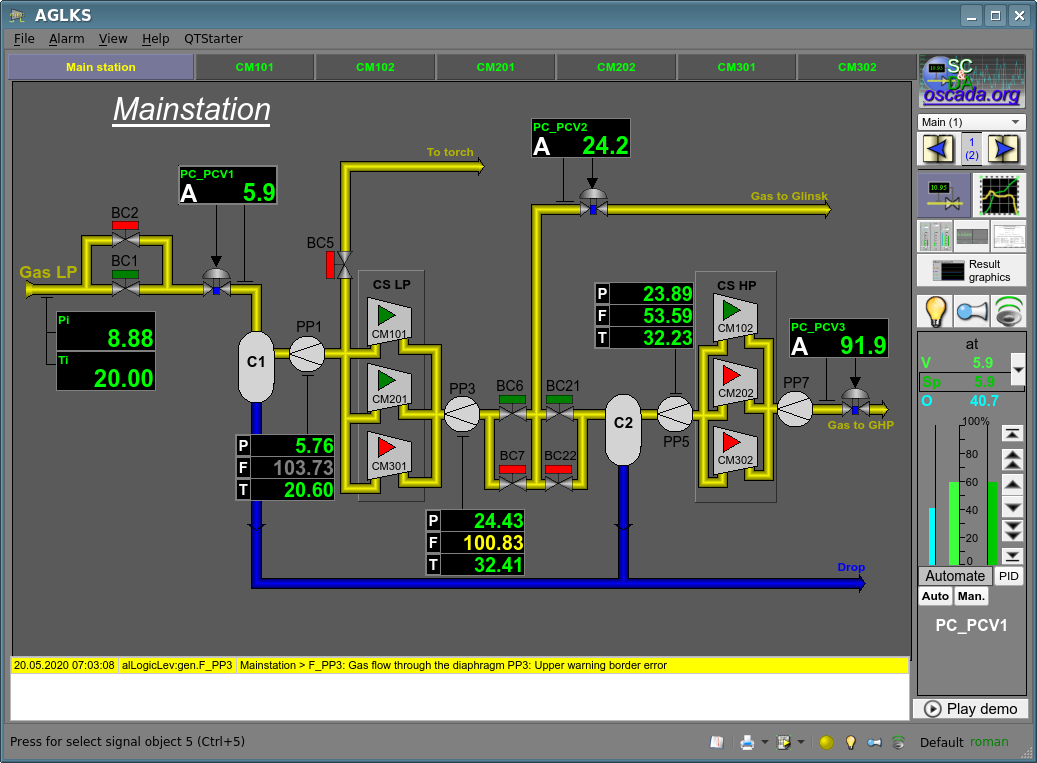

Fig.3. Main window in the execution mode.

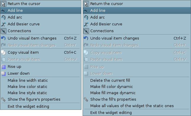

ElFigure Elementary graphical figure
The primitive is the basis for drawing elementary graphical shapes with their possible combinations in a single object. The support of the following elementary figures is provided:
  • Line.
  • Arc.
  • Bézier curve.
  • Fill of the enclosed space.
For all the figures, contained in the widget, set the common properties of thickness, color, etc., provides the possibility to specify the above-mentioned attributes for each figure separately and their dynamization.

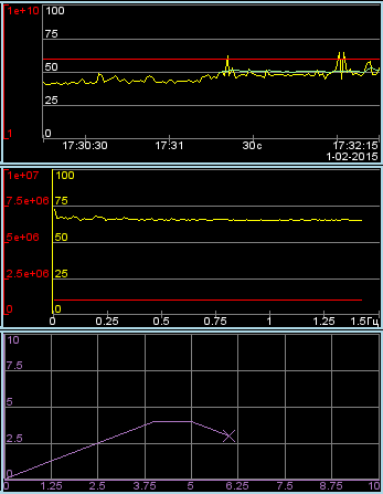

Diagram Diagram Element of the diagram with the support of the visualization in the real-time for the flow of several: trends (time charts), spectrum, XY diagrams.

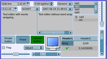

4.3 Primitive of the form element (FormEl)
Provides support for the form elements on the VCA frames with the planed properties, including the types:
The "Enabled" and "Active" modes are implemented, as well as the transfer of changes and events to the data model of the VCA — engine. The mode "Active" cause to the activity cursor set for not empty background and the addition conditions of the different views "Text", "Media" and "Box":
Figure represents a part of the screen with the frame containing the above-listed elements of the form.

4.5 Primitive of constructing diagrams (Diagram)
The diagrams construction element releases for types: "Graph", "Spectrum" and "XY", with properties:
The visualizer module provides and uses set of specific attributes of this primitive, the information is shown in the next table.
Identifier Name Appointment
sclWin Zooming the area framed by a window, mouse. A logical attribute type that is created by the user manually, as needed. For true, activates the mode of zooming the trend area framed by the window with the mouse.
Figure represents a part of the screen with the frame containing examples of the diagrams: "Graph", "Spectrum" and "XY".

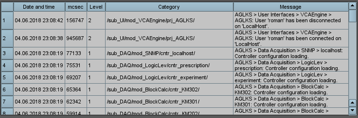

4.6 Primitive of the protocol formation (Protocol)
Provides for support of the element of the protocol formation with the following properties:
Figure represents a part of the screen with the frame containing an example of the protocol.

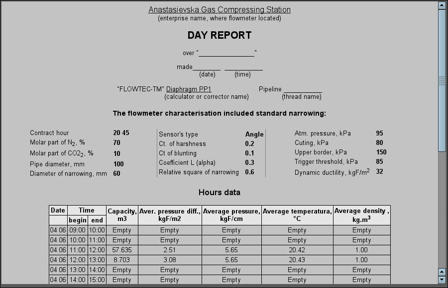

4.7 Primitive of the report formation (Document)
Provides for support element of the report formation with the following properties:
The basis of any document is the XHTML template. The XHTML-template is the tag "body" of the WEB-page which contains the document's static in the standard XHTML 1.0 and elements of the executable instructions in the user programming language of OpenSCADA in the view <?dp {procedure} ?>. The resulting document is formed by the procedures execution and insertion of their result into the document.
The source for values of the executable instructions are the widget attributes of the primitive, as well as all the mechanisms of the user programming language OpenSCADA. Attributes may be added by the user and they can be linked to the actual attributes or parameters or they can be autonomous, values of which will be formed in the widget procedure. In the case of linked attributes the values can be extracted from the archive-history.
Figure represents the frame, containing a sample of the document.

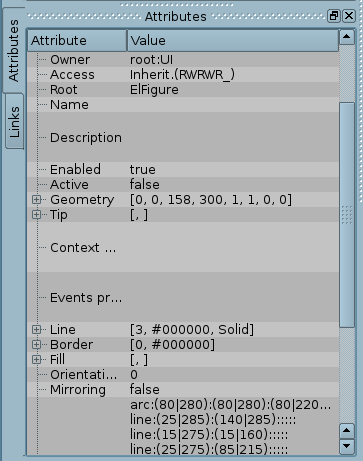

In order to get started with the graphical editor, after launching the OpenSCADA project, you need to call "Operation user interface (Qt)". The "Widgets" tab contains a list of existing graphical libraries and items that belong to them.
Suppose we need to add a graphic element to one of the existing libraries. To do this, select the library name, and click the button (Vision ElFigCreate.png) on the toolbar. In the appeared window enter the Identifier and name of the new graphic element. After that, let's move on to this element and press the button (Vision ElFigEdit.png). The drawing area will appear on the right. Using the double-click mouse over this field, or by using the context menu, we will enter the editing mode — the graphic editor mode, which allows you to perform all the provided manipulations with the figures. At that moment, when the graphic element we created is in focus, the tab "Attributes" will look like it is shown in Figure 5.3.a.
Fig.5.3.a. Attributes of the elementary figure.

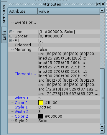

With the help of mouse, or the "Geometry" field of the "Attributes" tab, let's define the drawing area size and scale coefficients.
Using the "Line" field of the "Attributes" tab, lets define the width, color, line style of the figures, which we'll draw. With the "Border" field let's define the width and color of the border. The "Fill" field allows you to specify color, and image for the fills. "Elements list" contains a list of primitives used to create the graphical object. Elements of all fields of the "Attributes" tab can be dynamically changed in the user procedure.
Graphical primitives can be drawn with the mouse or by specifying the list of graphical primitives ("Elements list"). In the first case, the coordinates of the control points of the primitive are computed automatically, and width, color, style of the line, width and color of the border are set by defaults, from the "Attributes" tab. In the second case, the primitive must be described in the "Elements list" as follows:
line:(x1|y1):(x2|y2):width:color:border_width:border_color:style (1)
arc:(x1|y1):(x2|y2):(x3|y3):(x4|y4):(x5|y5):width:color:border_width:border_color:style (2)
bezier:(x1|y1):(x2|y2):(x3|y3):(x4|y4):width:color:border_width:border_color:style, (3)
Where:
(x1|y1) — coordinates of the first control point of the primitive;
(x2|y2) — coordinates of the second control point of the primitive;
(x3|y3) — coordinates of the third control point of the primitive;
(x4|y4) — coordinates of the fourth control point of the primitive;
(x5|y5) — coordinates of the fifth control point of the primitive;
width — line width, with which the primitive will be drawn;
color — line color, with which the primitive will be drawn;
border_width — border width;
border_color — border color;
style — line style ("0" — solid, "1" — dashed, "2" — dotted).
In this case, the values of the width, color, style of the line, width, and color of the border in the elements list are priority. If you want to use any of the properties, that are set in the fields "Line" or "Border" of the "Attributes" tab, then during the description of the primitive they should be skipped. For example, we want to create a line with: width 3, red color, solid and without border. At the same time in the "Line" field the following properties are set: line width 3, black color and solid style; and in the "Border" field: border width 5, green color. Then the description of the primitive in the elements list will be as follows:
line:(x1|y1):(x2|y2)::red:0:: (4)
Expressions (1) - (4) define the static properties of the primitives that can not be changed in user's procedure. To specify the dynamic properties it is necessary to use the following expression:
line:1:2:w1:c1:w2:c2:s1 (5)
Then, the "Attributes" tab will be appended by the fields: Point 1 (1), Point 2 (2), Width 1(w1), Width 2(w2), Color 1(c1), Color 2(c2), Style 1 (s1) (Fig. 5.3.b). Values of these fields can be changed in user's procedure, using the user programming language of OpenSCADA. Obviously, if desired, not all properties of the primitive can be declared dynamic, but one or more, in addition, one dynamic property can be used repeatedly.
Editing the coordinates of the control points is made using the mouse or by changing them in the elements list, for static points; or directly in the "Attributes" tab, with dynamic points in place ("Point 1", ...). Editing the other properties is made by means of changing the content of the fields "Line", "Border", "Fill" of the "Attributes" tab or the elements list.
Fig.5.3.b. Dynamic attributes of the elementary figure.

5.4 Popup menu of the graphic editor
The popup menu by the right-clicking in the editable widget is provided. Depending on what an object is under the mouse, popup menu can take several different forms. Below, in Figure 5.4, there are examples of the popup menu.
Fig.5.4. Popup menu for the lines (line, arc, Bézier curve) and for the fill, from left to right.
The popup menu includes the following sections (from the top to the bottom):

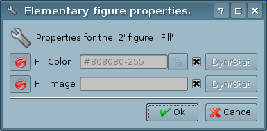

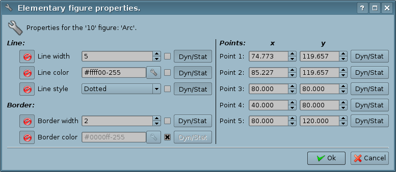

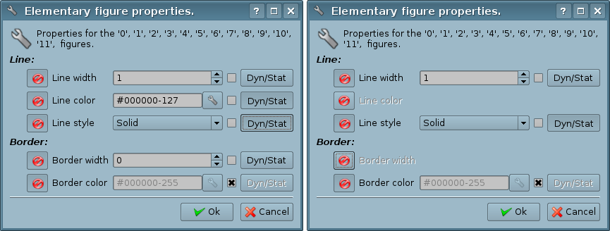

5.5 Properties dialog of the elementary figure
Dialog, versions of which are shown in Figures 5.5.a, 5.5.b, 5.5.c, is implemented for interactive and comfortable user control of the properties of the figure(s).
Fig.5.5.a. Properties dialog of the elementary figure for single figure (line, arc or a Bézier curve).
Fig.5.5.b. Properties dialog of the elementary figure for the group of selected figures.
Fig.5.5.c. Properties dialog of the elementary figure for the fill.
As can be seen from the figures above, the dialog can be of three different forms, depending on the object for which it is called. In the title of the dialog there are the numbers of figures, for which it is called. These numbers correspond to the figures positions in the elements list, starting from the top.
If the dialog called for a single figure (line, arc or a Bézier curve), then it is possible to edit the points' coordinates of the figure (Fig.5.5.a). If the point is connected to the point of another figure or figures, and "Connections" are enabled, then entered coordinates will be applied to all connected figures and fills, which involved the figure, will be redrawn accordingly.
If the dialog is called for the group of selected figures (Fig.5.5.b), properties (attributes) listed in the dialog will be applied to all figures listed in the title of the dialog. When you call the dialog, in the fields of the properties will be shown the data of the figure from the group of selected ones, for which it was called the popup menu. There is the possibility to include/exclude certain properties of the dialog. For this the (Vision disableButton.png) button is provided. In the case of exclusion of individual properties, they will not be processed upon acceptation of the dialog ("Ok" button). After the acceptation of the dialog, all of the data of the enabled properties will be applied to the whole group of figures.
Dialog for the fill's properties (Fig.5.5.c) allows you to manage the properties of the specific fill.
When selecting a check box to the right of a property, it (the property) after the acceptation of the dialog is set to the default value, which is listed in the "Attributes" tab. The "Dyn/Stat" buttons make the appropriate properties dynamic or static.

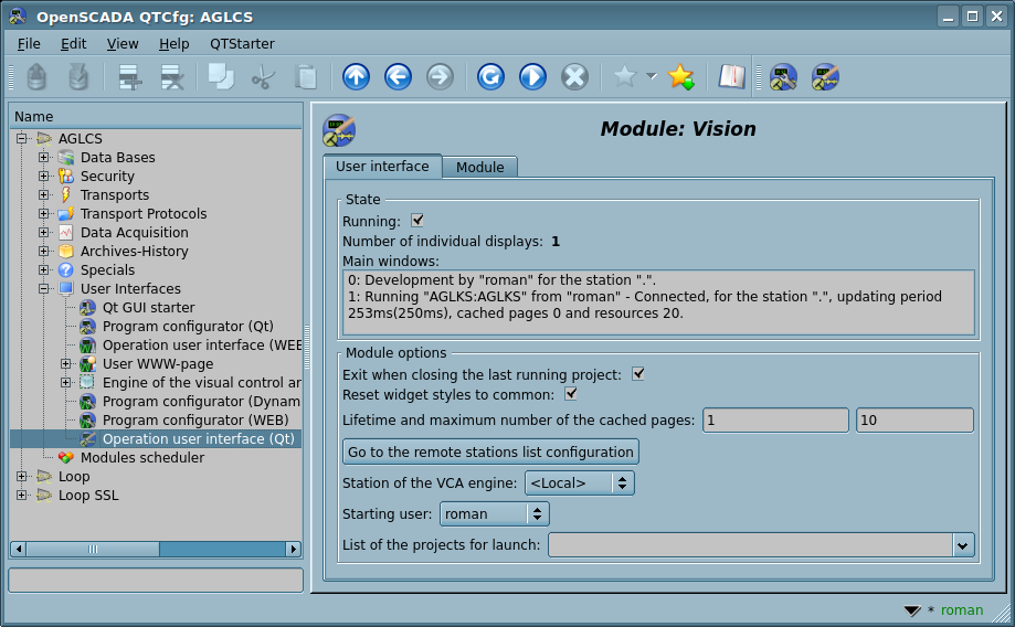

6 General module configuration
To set up own behavior in non-obvious situations, the module provides the ability to configure individual parameters through the control interface of OpenSCADA (Fig.6).
At.png The display selection function is possible for non-virtual and non-duplicate desktops, that is, when using xinerma or NVidia in the appropriate mode. Technically, the Qt-function screen() should return various display widget objects by their numbers.
Fig.6. Configuration page of the module.
