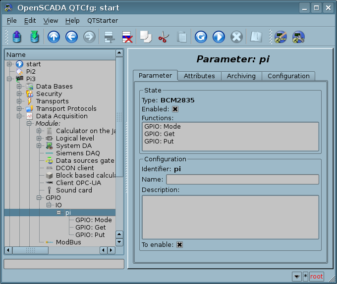

The parameter is the direct representative-reflection of the GPIO, which contains a list of attributes of a discrete type in an amount that corresponds to this GPIO type. The parameter configuration tab is shown in Figure 2. The data collection is performed only in synchronous mode since the GPIO should be fast.
With the parameter configuration tab you can set:

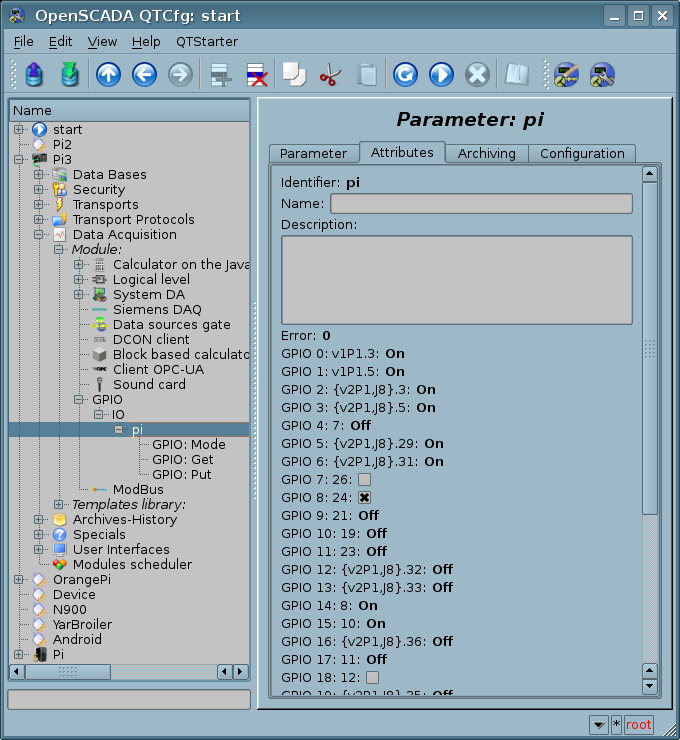

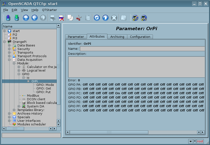

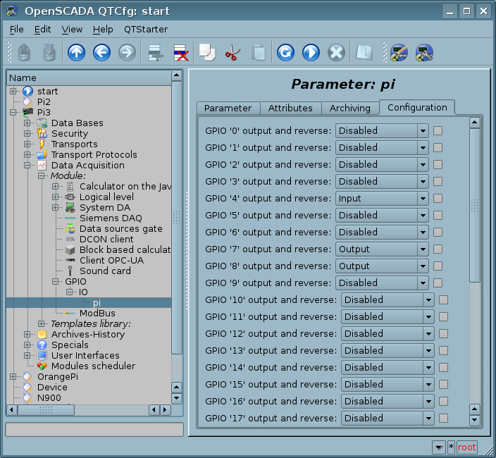

The tab "Attributes" of GPIO is shown in Figure 3 for BCM2835, and Figure 4 for SUNXI. For the GPIO, the "Configuration" tab (Fig. 5) is also available with the IO mode and the inversion state.
