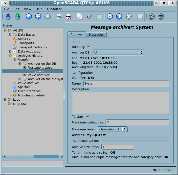

The module provides additional settings for the archiving process, Figure 1.
Fig.1. Additional settings of the message archiving process.
These additional parameters:
The database table for the message archiver has a structure {MIN, TM, TMU, CATEG, MESS, LEV}, where:

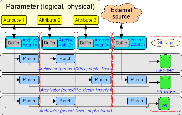

Archive of values is an independent component, which includes buffer processed by the archivers. The main parameter of the value archive is a data source. As the data source role may be the attributes of the subsystem "Data acquisition" as well as other external data sources (passive mode). Other data sources could be: network archivers of remote OpenSCADA, programming environment of OpenSCADA etc. No less important parameters are the parameters of the archive buffer. From the buffer parameters the opportunity of working of archivers depends on. At.png So, the periodicity of values in the buffer should be no more than the periodicity of the fastest archiver, and the buffer size is not less than double the size for the slowest archiver. Otherwise possible data loss.
General schema of archiving values is clearly shown in Figure 2.
Fig.2. General schema of archiving values process.
Value archiver of this module stores data in a database table, which is named "DBAVl_{ArchivatorID}_{ArchiveID}", for the single mode, and "DBAVl_{ArchivatorID}_<GRP>{N}", for the group mode, where:

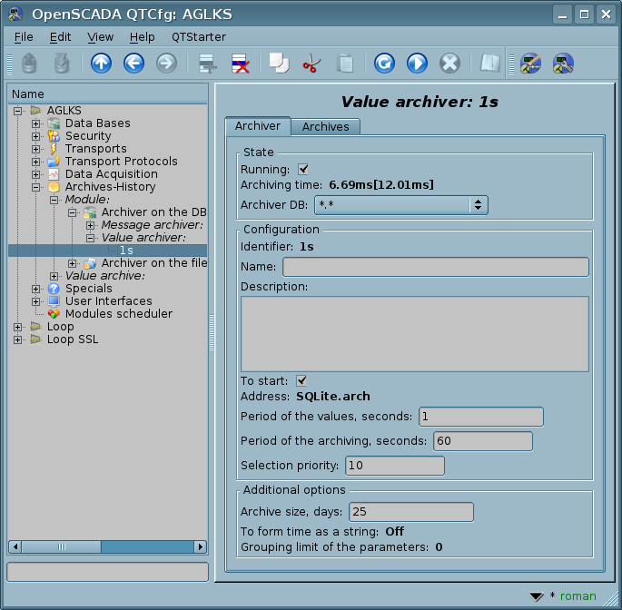

The module provides additional settings for the archiving process, Figure 3.
Fig.3. Additional settings of the value archiving process.
The database table for the value archiver has a structure {MARK, TM, VAL), for the single mode, and {MARK, TM, {PRM1}, {PRM2}, {PRMN}}, for the grouping mode, where:
