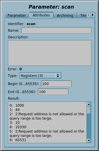

1.1 ModBus scanner (ModBusScan)
1.0 GPLv2 * en, uk, ru Roman Savochenko
Result and the operative setup.
ModBus scanner for Coils (1), Input Coils (2), Registers (3), Input Registers (4); in the range [0...65535]. The template useful to examine unknown ModBus devices, scanning their Coils' and Registers' map for detecting the available data addresses. The scanning performs per one item, whether it is a coil or a register, to prevent the data unavailability for strict data accessing devices. The protocol ModBus itself implemented by the OpenSCADA module DAQ.ModBus, together which the template designed to use.
Template IOs
Identifier Parameter Type Mode Attribute Configuration Value
lim Limit time, seconds Integer Input Not attribute Constant 10
type Type Integer numbers selection Input Full access Variable 2
0;1;2;3
Coils (1);Input Coils (2);Registers (3);Input Registers (4)
begin Begin (0...65535) Integer Output Full access Variable
end End (0...65536) Integer Output Full access Variable
res Result Text Output Read only Variable
this The object Object Input Not attribute Variable
Configuring and using
1. Create a source controller object, or use a suitable one, into the module "ModBus".
2. Create a source parameter object into the previous source controller object, set its Identifier like to "ModBusScan", select its type to "Logical" and select this template for it — enable the parameter.
3. Into the tab "Template configuration" of the logical parameter object you need to set:
  • Limit time, seconds — time of limiting for one cycle execution, the default value is a normal one.
4. RESULT: Selecting type of the data and setting the "Begin" and "End" attributes of the scanning range you will get the scanning result into the attribute "Result", which will be appended in the scanning process.

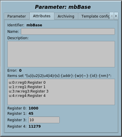

1.2 ModBus base (mbBase)
1.5 GPLv2 * en Roman Savochenko
ModBus base template of the protocol implementing on the Logical Level. Designed mostly to use in the base of creation specific ModBus-based protocols for the standard-part registers' access (functions 3, 4 for reading and function 16 for writing) and appending the new protocol specific part. The template was designed to work both under control of the controller objects of the module ModBus and LogicLev and can be managed from the template of the initiative connections processing for assigned output transports.
Complex postprocessing and complete generation-imitation of the separate attributes on the internal programming language of OpenSCADA into the configuration IO inProc (with appending the builtin syntax highlight rules), that is you are allowed for customizing without changing the template, where you can operate next service parameters:
  • tErr [IN|OUT] — text of the error (the attribute "err" format);
  • f_frq [IN] — frequency of calculation, the template IO;
  • this [IN] — reference to the parameter object, what executing the template;
  • ctx [IN] — object of the user context, what saved between the execution cycles;
  • args [IN] — object of arguments of the procedure.
Template IOs
transport Transport
Leave empty at including to a ModBus controller
String Input Not attribute Constant Sockets.mbbase
addr Device address, [0...247] Integer Input Not attribute Constant 1
mbType ASCII|TCP] String Input Not attribute Constant RTU
maxBlkSz ModBus maximum block size, [10...200] Integer Input Not attribute Constant 200
fragMerge ModBus blocks merging Boolean Input Not attribute Constant 1
inProc Input processing procedure Text Input Not attribute Constant
items Items set
Rows in the form "[u|i|u2|i2|u4|i4|i8|r|d|s]:{addr}:{w|r|~|i}:{id}[:{nm}]".
Text Input Full access Variable #<SnthHgl font="monospace"><rule expr="^#[^\n]*" color="gray" font_italic="1"/><rule expr=":[rw~i]*:" color="red"/><rule expr=":(0[xX][0-9a-fA-F]*|[0-9]*),?(0[xX][0-9a-fA-F]*|[0-9]*),?(0[xX][0-9a-fA-F]*|[0-9]*),?(0[xX][0-9a-fA-F]*|[0-9]*)" color="blue"/><rule expr="^(u|i|u2|i2|u4|i4|i8|r|d|s)" color="darkorange"/><rule expr="\\:" color="blue"/></SnthHgl>
tr Output transport Object Input Not attribute Variable
this Object Object Input Not attribute Variable
f_start Function start flag Boolean Input Not attribute Variable 0
f_stop Function stop flag Boolean Input Not attribute Variable 0
f_frq Frequency of calculation of the function, Hz Real Input Not attribute Variable 1000
f_err Function error String Input Not attribute Variable 0

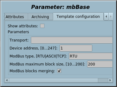

Configuration.
1. [ NonAutomatic ] Create an output transport of the type "Serial" or "Sockets", and set its Identifier like to "mbbase", one for each the devices' used serial bus.
2. [ NonAutomatic ] Set proper address and timeouts of the device.
3. Create and start a logical controller object or a ModBus controller object or use any present one with need scheduling properties.
4. Create a logical parameter object and select the template for that, one for the devices on one bus — enable the parameter.
5. Into the tab "Template configuration" of the logical parameter object you need to set:
  • Transport — to the address of the automatically created transport with its parameters after ":", accordingly to the function SYS.Transport.outAt() address format. Leave the field empty for the ModBus controller object. Tracing for the address changing is supported.
  • Device address [ LogicLevel ] — to logical address of the device on the bus under the transport in step 1. Tracing for the address changing is supported.
  • ModBus type [ LogicLevel ] — to the ModBus protocol type/variant from the list: RTU, ASCII, TCP.
  • ModBus maximum block size [ LogicLevel ] — to the ModBus protocol package data maximum size in the range [10...200].
  • ModBus blocks merging [ LogicLevel ] — for allowance of merging the ModBus protocol fragmented blocks of the registers.
  • Input processing procedure — form for the complex preprocessing and complete generation of the separate attributes on the internal programming language of OpenSCADA.
6. RESULT: The logical parameter object will: dynamically create needed attributes accordingly to the attribute "Items set" value and perform interaction and placing of gathered data to the parameter attributes. Also you are able to change for writable attributes.

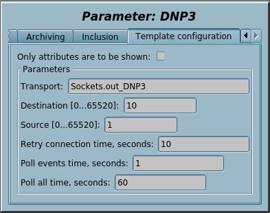

1.7 Distributed Network Protocol 3 (DNP3)
0.8 GPLv2 * en, uk, ru Roman Savochenko
Distributed Network Protocol 3 (DNP3) is a set of communications protocols used between components in process automation systems. Its main use is in utilities such as electric and water companies. Usage in other industries is not common. It was developed for communications between various types of data acquisition and control equipment. Competing standards include the older Modbus protocol and the newer IEC 61850 protocol and IEC 61870.
Details
The template implements currently for the client, which uses the followed functions: Confirm (0x00), Read (0x01), Write (0x02), Enable (0x14) and Disable (0x15) Spontaneous Messages.
And which implements and tested for the followed point-oriented objects (data types):
Considering the purpose and the application area, the protocol does not provide the direct determination of the requested data and the device, that implements it, provides all available ones upon request for the Class 0 data, after which only changes are requested for the Classes 1, 2, 3.
All received and controlled data is accumulated in an object of the attribute "items" for further control as an object in a table of the widget "Main.objProps", according to the complex object definition.
For standard control over parameter attributes, including archiving, it is possible to define the necessary data to create a separate representative attribute for them, which is described in the attribute "itemsSet", where they can be defined individually, with a semantic identifier and name, or in a range named by a template. The data in the attribute "itemsSet" is defined by records in the format ai|ao|cnt|di|do:{pnt}[-{endPnt}][:a[:{NameBase}]], where:
Examples of the parameters definition, rows of the attribute "itemsSet":
Template IOs
transport Transport String Input Not attribute Constant Sockets.out_DNP3
dest Destination [0...65520] Integer Input Not attribute Constant 10
src Source [0...65520] Integer Input Not attribute Constant 1
tmRetr Retry connection time, seconds Real Input Not attribute Constant 10
tmPoolEv Poll events time, seconds Real Input Not attribute Constant 1
tmPoolAll Poll all time, seconds Real Input Not attribute Constant 60
itemsSet ao|cnt|di|do:{pnt}[-{endPnt}][:a[:{NameBase}]]" Text Input Full access Variable
items All items Object Output Full access Variable
ctx IO context Object Input Not attribute Variable
oAVals Output values Object Output Not attribute Variable
Configuration.
1. Create an output transport of the type "Sockets", set its Identifier like to "DNP3", one for each the device-PLC.
2. Set proper address with port 20000 and timeouts of the Sockets device-PLC.
3. Create and start a logical controller object or use any present one with need scheduling properties. The interaction period preferred to be about 0.1 second.
4. Create a logical parameter object and select this template for that, one for each the device-PLC — enable the parameter.
  • Transport — to address of the transport into step 1. Tracing for the address changing is supported.
  • Destination — remote station address in the integer range [0...65520].
  • Source — the same station address (source) in the integer range [0...65520].
  • Retry connection time — retry connection time in seconds, at the connection missing and no response detection.
  • Poll events time — time in seconds of the events periodical polling (Class 1).
  • Poll all time — time in seconds of the complete data requesting (Class 0,1,2,3).
6. RESULT: The logical parameter object will perform interaction and placing of the gathered data to the object "items", creation/placing and checking for commands of the proper attributes, created by the "itemsSet" instruction.
7. In the process of the working, through the tab "Attributes" of operational data, in addition to obtaining the result, it is possible to perform operative setup and control on:
  • Items set by — for controlled items naming and definition as attributes and accessible for write.
  • All items, {Item attributes} — direct writing for the writable items.

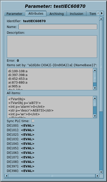

1.8 IEC-60870 (IEC60870)
1.4 GPLv2 * en, uk, ru Roman Savochenko
IEC 60870 part 5 is one from the IEC 60870 set of standards which defines systems used for telecontrol (supervisory control and data acquisition) in electrical engineering and power system automation applications. Part 5 provides a communication profile for sending basic telecontrol messages between two systems, which uses permanent directly connected data circuits between the systems.
Details
Considering the purpose and the application area, the protocol does not provide the direct determination of the requested data and the device, that implements it, provides all available ones upon request by the C_IC_NA_1 command, after which only changes are sent.
For standard control over parameter attributes, including archiving, it is possible to define the necessary data to create a separate representative attribute for them, which is described in the attribute "itemsSet", where they can be defined individually, with a semantic identifier and name, or in a range named by a template. The data in the attribute "itemsSet" is defined by records in the format ai|di|do:{IOA}[-{EndIOA}][:a[:{NameBase}]], where:
The module provides integrated support for time synchronisation of PLC by sending the C_CS_NA_1 service command.
In the template for the first time used the not requesting mode of an output transport and the attributes creation in free while performing.
Template IOs
transport Transport String Input Not attribute Constant Sockets.out_IEC60870
addr Address, {addr}.{OA} String Input Not attribute Constant 0.5
t1 Acknowledge lack activity timeout, seconds Real Input Not attribute Constant 1.5
t2 Acknowledge timeout, seconds Real Input Not attribute Constant 1
t3 Test timeout, seconds Real Input Not attribute Constant 2
k Maximum unconfirmed Integer Input Not attribute Constant 12
w Maximum no ack Integer Input Not attribute Constant 8
itemsSet Items set by: "ai|di|do:{IOA}[-{EndIOA}][:a[:{NameBase}]]" Text Input Full access Variable
syncTimePLC Sync PLC time Boolean Input Full access Variable
oAVals Output values Object Input Not attribute Variable
f_frq Frequency of calculation of the function (Hz) Real Input Not attribute Variable 1000
Configuration.
1. Create an output transport of the type "Sockets", set its Identifier like to "IEC60870", one for each the device-PLC.
2. Set proper address with port 2404 and timeouts of the Sockets device-PLC.
3. Create and start a logical controller object or use any present one with need scheduling properties. For interaction by IEC-60870-104 you need the execution period not greater than 0.1 second!
  • Address — remote station and object address in the format "{addr}.{OA}", for physical systems without a gateway is not particularly important.
  • Retry connection time — retry connection time in seconds, at the connection missing.
  • Poll all time — time in seconds of the complete data requesting, sending C_IC_NA_1.
  • Acknowledge lack activity timeout, in seconds.
  • Acknowledge timeout, in seconds.
  • Test timeout, in seconds.
  • Maximum unconfirmed — not used into the client since it is not generate such flows.
  • Maximum no ack — maximum input packages after what the client will send "Ack".

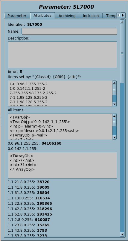

1.9 IEC-62056 (IEC62056)
2.0 GPLv2 * en, uk, ru Roman Savochenko
IEC-62056 is a set of standards for electricity metering data exchange. The IEC-62056 standards are the international standard versions of the DLMS/COSEM specification.
Details
DLMS or Device Language Message Specification (originally Distribution Line Message Specification), is the suite of standards developed and maintained by the DLMS User Association (DLMS UA) and has been adopted by the IEC TC13 WG14 into the IEC-62056 series of standards.
COSEM or Companion Specification for Energy Metering, includes a set of specifications that defines the transport and application layers of the DLMS protocol. The DLMS User Association defines the protocols into a set of four specification documents namely Green Book, Yellow Book, Blue Book and White Book. The Blue Book describes the COSEM meter object model and the OBIS object identification system, the Green Book describes the architecture and protocols, the Yellow Book treats all the questions concerning conformance testing, the White Book contains the glossary of terms.
In the template implementation were used the follow standards:
At.png This protocol doesn't specify a way of requesting-acquisition all available variables of the device, like to the protocols IEC-60870 and DNP3, so we need to point their directly and obtain their before that anywhere for the concrete device.
The template was initially implemented to work with the electricity counter Actaris SL7000 and next was adapted to Nik2300 old and new versions. Common OBIS codes were included and which substitute at selecting correspond preset device, also as there is performed setting specific flags.
Template IOs
transport Transport String Input Not attribute Constant Sockets.IEC62056
dest Destination in "{UHDLC}:{LHDLC}" or one SN digit
{UHDLC} and {LHDLC} — Digits in range [0...16383].
SN is in range [0...268435456].
String Input Not attribute Constant 17:6168
src Source [0...127] Integer Input Not attribute Constant 1
pass Password the device String Input Not attribute Constant ABCDEFGH
isDir Direct local data exchange at the 21 part Boolean Input Not attribute Constant 0
isLE Represent integer data in LE Boolean Input Not attribute Constant 0
tmPollAll Poll all time, seconds
Only for non direct mode of part 46.
tmSesEnd Waiting time after the session end, in seconds
Maybe useful in network of such counters when they need some time for switching to other counter.
Real Input Not attribute Constant 0
inProc Input procedure Text Input Not attribute Constant
presetDev Preset device
That is a known device with setting isDir, isLE, main OBISes and some address specific.
Strings selection Input Full access Variable None
Actaris SL7000;Nik2300;Nik2300 New;None
itemsSet Items set by: "{ClassId}-{OBIS}-{attr}"
{ClassId} — Digit in range [0...65535].
{attr} — Digit in range [0...255].
{OBIS} — Six digits in range [0...255] like to "{d}.{d}.{d}.{d}.{d}.{d}".
Text Input Full access Variable #<SnthHgl font="monospace"><rule expr="^#[^\n]*" color="gray" font_italic="1"/><rule expr="^[0-9]+-[0-9]+\.[0-9]+\.[0-9]+\.[0-9]+\.[0-9]+\.[0-9]+-[0-9]+" color="blue"/></SnthHgl>
Configuration.
1. [ NonAutomatic ] Create an output transport of the type "Serial" or "Sockets", and set its Identifier like to "IEC62056", one for each the devices' used serial bus.
3. Create and start a logical controller object or use any present one with need scheduling properties. The interaction period for part 46 preferred to be about 0.1 second!
  • Transport — to the address of the automatically created transport with its parameters after ":", accordingly to the function SYS.Transport.outAt() address format. Tracing for the address changing is supported.
  • Destination in "{UHDLC}:{LHDLC}" or one SN digit — remote station address in the two digit format each of which in range [0...16383] or one SN digit in range [0...268435456].
  • Source — the same station address (source) in the integer range [0...127].
  • Password the device — the device access password.
  • Direct local data exchange at the 21 part — switch mode of the data obtaining from part 46 to part 21.
  • Represent integer data in LE — switch the bytes packing order in integers from BE to LE.
  • Poll all time — time in seconds of the complete data requesting, pointed in the "itemsSet".
  • Waiting time after the session end — time in seconds when your countries need some time of switching when pass the requesting to next one.
6. RESULT: The logical parameter object will perform interaction and placing of the gathered data to the object "items", creation/placing the gathered data to the proper value attributes.
  • Preset device — for setting isDir, isLE, main OBISes and some address specific.
  • Items set by ... — for appending the device's OBIS to their reading.

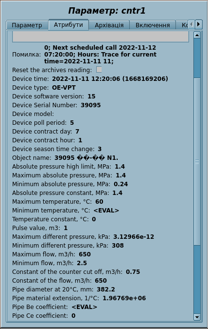

3.3 Slot LTD devices (SLOT)
0.8 GPLv2 * en Roman Savochenko
The template implements support for counters and correctors of the "SLOT" LTD production. The devices protocol is flexible and uniform for implementation of reading all available archives also as setting the configuration fields, but currently there was need only for reading the hourly archives, so the template reads the daily and hourly archives and some set of the instantaneous parameters.
The template includes also code for connect the counters through modems using the AT-commands.
Template IOs
transport Transport String Input Not attribute Constant Sockets.SLOT:10.39.77.10:4001
modem Modem
In the format "{TelN}[:{Init1}[:{Init2}[...{InitN}]]]"
modemTm Modem times
In the format "{tm}:{ConTm}"
String Input Not attribute Constant 40:5
addr Device address [0...65535] Integer Input Not attribute Constant 1
pipeN Pipe number [0...1] Integer Input Not attribute Constant 0
sched Scheduling at CRON String Input Read only Link
arhTmLim Time limit of processing the archiving, seconds Integer Input Not attribute Constant 120
arhD OpenSCADA archiver for device archive of days String Input Not attribute Constant
arhH OpenSCADA archiver for device's archive of hours String Input Not attribute Constant
reset Reset the archives reading Boolean Input Full access Variable
devTime Device time String Input Read only Variable
devTp Device type String Input Read only Variable
devSWVers Device software version String Input Read only Variable
devSN Device Serial Number Integer Input Read only Variable
devModel Device model String Input Read only Variable
devPollPer Device poll period Integer Input Read only Variable
devContrDay Device contract day Integer Input Read only Variable
devContrHour Device contract hour Integer Input Read only Variable
devSesonTimeCh Device season time change Integer Input Read only Variable
objNm Object name String Input Read only Variable
apH Absolute pressure high limit, MPa Real Input Read only Variable
apMax Maximum absolute pressure, MPa Real Input Read only Variable
apMin Minimum absolute pressure, MPa Real Input Read only Variable
apConst Absolute pressure constant, MPa Real Input Read only Variable
tMax Maximum temperature, °С Real Input Read only Variable
tMin Minimum temperature, °С Real Input Read only Variable
tConst Temperature constant, °С Real Input Read only Variable
pulseVl Pulse value, m3 Real Input Read only Variable
dpMax Maximum different pressure, kPa Real Input Read only Variable
dpMin Minimum different pressure, kPa Real Input Read only Variable
fMax Maximum flow, m3/h Real Input Read only Variable
fMin Minimum flow, m3/h Real Input Read only Variable
cntrCutOffConst Constant of the counter cut off, m3/h Real Input Read only Variable
flowConst Constant of the flow, m3/h Real Input Read only Variable
pipeD Pipe diameter at 20°С, mm Real Input Read only Variable
pipeTExt Pipe material extension, 1/°С Real Input Read only Variable
pipeBeCoef Pipe Be coefficient Real Input Read only Variable
pipeCeCoef Pipe Ce coefficient Real Input Read only Variable
pipeRoughCoef Pipe roughness coefficient Real Input Read only Variable
diaphD Diaphragm diameter at 20°С, mm Real Input Read only Variable
diaphTExt Diaphragm material extension, 1/°С Real Input Read only Variable
diaphBeCoef Diaphragm Be coefficient Real Input Read only Variable
diaphCeCoef Diaphragm Ce coefficient Real Input Read only Variable
diaphEdgeBluntCoef Diaphragm edge blunting coefficient Real Input Read only Variable
correctorTime Corrector time String Input Read only Variable
dP Pressure difference, kPa [arh] Real Input Read only Variable
P Pressure, MPa [arh] Real Input Read only Variable
T Temperature, °С [arh] Real Input Read only Variable
Fstd Volume standard cond., m3 [arh] Real Input Read only Variable
Fwork Volume work cond., m3 [arh] Real Input Read only Variable
itSt Item status [arh] String Input Read only Variable
tr Output transport Object Output Not attribute Variable
reqCntr Counter of the requests and the reconnection waiting (negative) Real Input Not attribute Variable 0
arhLastD Daily archive last item Integer Input Not attribute Variable 0
arhLastH Hourly archive last item Integer Input Not attribute Variable 0
this Object of the parameter Object Input Not attribute Variable

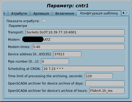

Configuration.
1. Create and start a logical controller object or use any present one with need scheduling properties.
2. Create a logical parameter object and select this template for it, one for each the devices — enable the parameter.
  • Transport — to the address of the automatically created transport with its parameters after ":", according to the function SYS.Transport.outAt() address format.
  • Modem — here you can set the modem configuration in the format "{TelN}[:{Init1}[:{Init2}[...{InitN}]]]" if your device accessed through a modem.
  • Modem times — here you can change the default modem timeouts in the form "{tm}:{ConTm}" if your device accessed through a modem.
  • Device address [0...65535] — set here the device address — Serial Number converted from hex to decimal.
  • Pipe number [0...1] — change here the default pipe of the device.
  • Scheduling at CRON — set here the logical execution at the CRON.
  • Time limit of processing the archiving — change here the default safety timeout.
  • OpenSCADA archiver for device archive of days — set here the archive used for storing the daily (86400 seconds) values — enables the day archive reading.
  • OpenSCADA archiver for device's archive of hours — set here the archive used for storing the hourly (3600 seconds) values — enables the hour archive reading.
4. RESULT: The logical parameter object will perform interaction and placing of gathered data to the parameter attributes.
