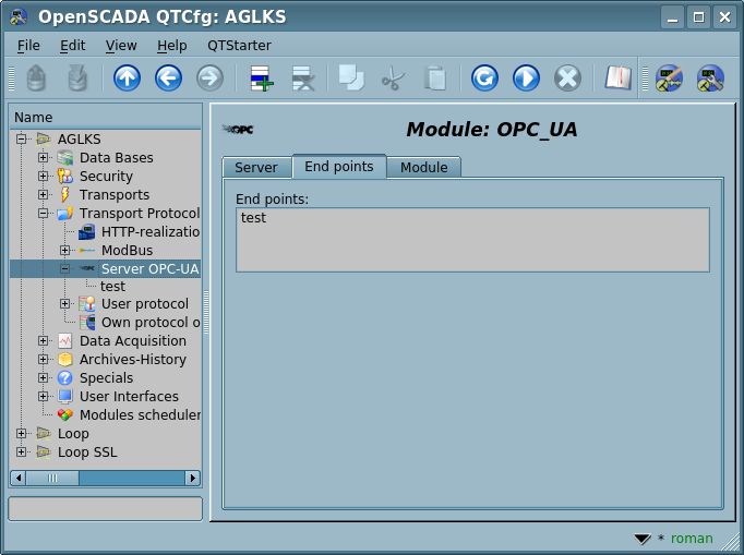

Input requests to the module-protocol are processed by the module in accordance with configured endpoint nodes of OPC-UA (EndPoints) (Fig.2).
Fig.2. Endpoint nodes of the protocol.

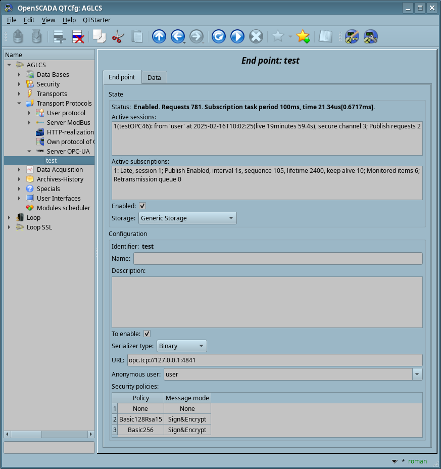

Endpoint node of the OPC-UA protocol is actually the server object of OPC-UA. Endpoint nodes in OPC-UA can be either local or remote. Local ones are designed to provide resources of OpenSCADA station by the protocol OPC-UA, while remote endpoint nodes are both for the service and review of available OPC-UA units, and to forwarding of the requests to remote stations. In this version of the module is only supported the configuration of the local endpoint nodes.
General configuration of the endpoint node is made on the main tab of the endpoint node's page (Fig.3) with parameters:
- Node status, as follow: common status, lists of the active sessions and subscriptions, "Enabled" and the name of the database containing the configuration, with tracking the availability of the data in different storages and providing the sequentially removing duplicates.
- Identifier, name and description of the node.
- State, in which to transfer the node at the start: "Enabled".
- Type of the protocol encoding, at the moment it is only "Binary".
- URL of the endpoint node.
- Anonymous user of enabling the anonymous access, or only authentication at empty.
- Server certificate and private key in the PEM format.
Hidden in the enabled state.
Fig.3. Main tab of the endpoint node's page.

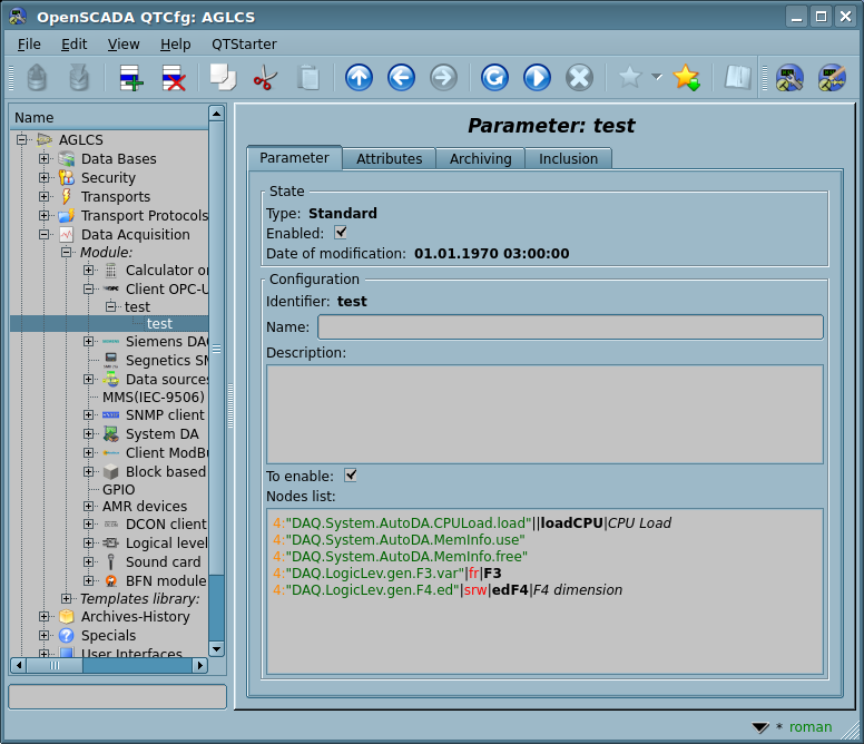

Additional configuration field of the type parameter (Fig.6) is the list of OPC-UA nodes and the field of navigation by OPC-UA nodes in single line, for the selected nodes of the type "Variable" insertion to the defined list. Attribute in this list is written as "{ns}:{nid}[|[{flg}][|{id}[|{name}]]]".
Where:
- ns — name space, number; zero value can be omitted;
- nid — node identifier by number, string, bytes string and GUID;
- flg — flags for do not request the metadata on the server: value type (b-Boolean,i-Integer,f-Float,s-String,o-Object), read/write mode (r-read, w-write);
- id — identifier of the created attribute;
- name — name of the created attribute.
Examples:
- 84 — root directory;
- 3:"BasicDevices2"||var — basic devices node in the name space 3 and the string view with the force attribute ID;
- 4:"61626364"||var|Variable — node in the names space 4 and the byte string view with the force attribute ID and name;
- 4:{40d95ab0-50d6-46d3-bffd-f55639b853d4}|irw|var|Variable — node in the names space 4 and the GUID view with no requesting the server metadata for RW Integer and the force attribute ID and name.
Fig.6. Configuration tab of the OPC-UA parameter object.

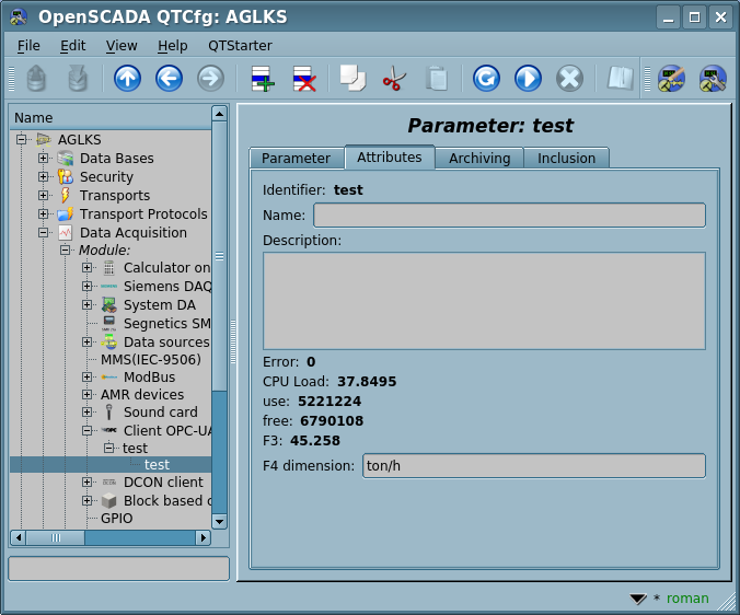

Fig.7. Tab of attributes of the parameter.

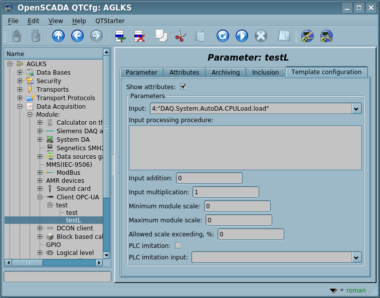

Рис.9. Tab "Template configuration" of the logical parameter type.

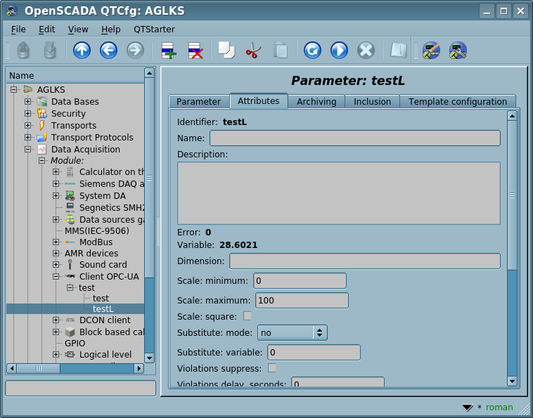

Fig.10. Tab of attributes of the logical parameter type.
