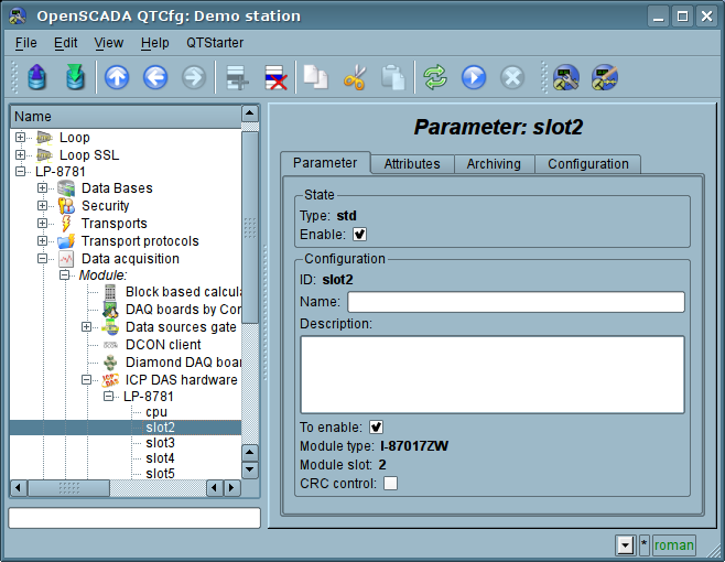

The module provides only one the "Standard (std)" type of the parameters with the parameters table name "ICPDASPrm_{CntrId}". There accessible three groups of modules/boards depending from selected bus:
Fig.2. Configuration tab of a parameter.

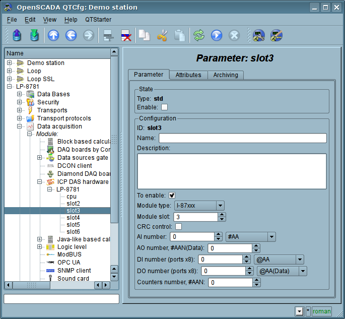

The configuration tab of parameter (fig.2) generally equal for all modules/boards groups and contain:

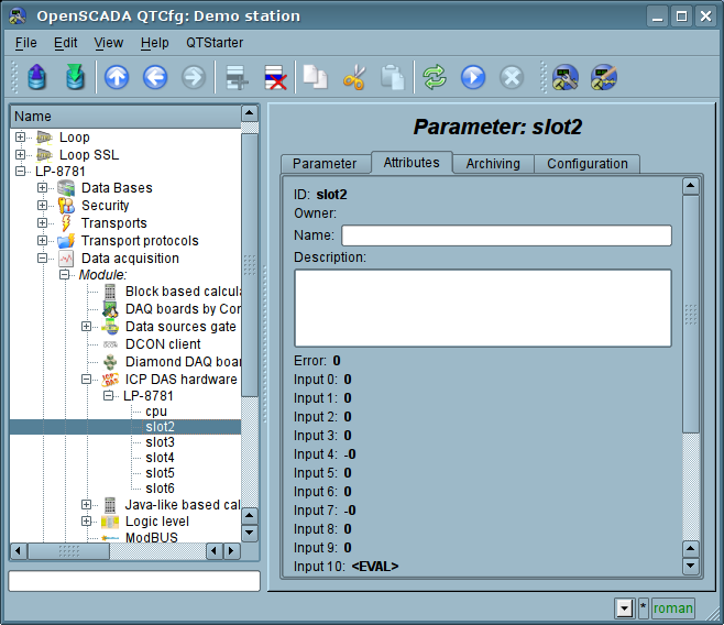

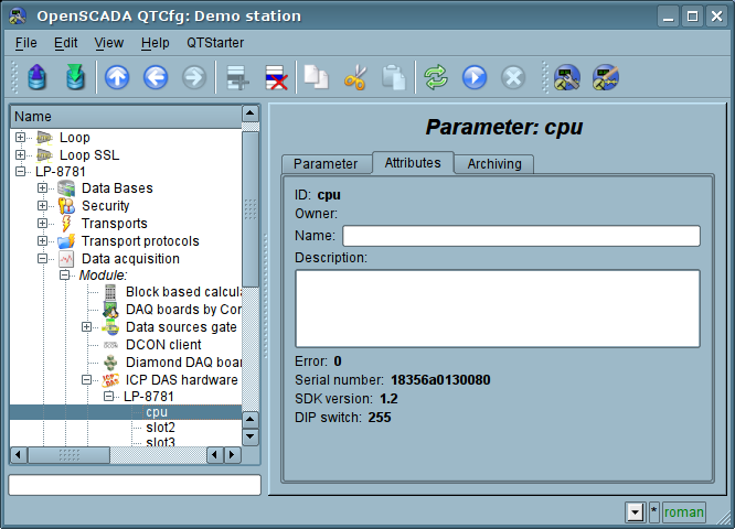

In accordance with the parameter settings the poll and the creation of attributes is made (Fig. 3).
Fig.3. Tab of attributes of a parameter.

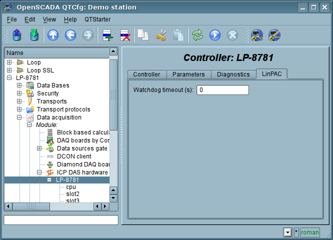

For common properties the controllers series LP-8xxx configuration allowed accordingly "LinPAC" tab on controller's page (Fig.4), and also by parameter "LP-8xxx" (Fig.5). Into parameter "LP-8xxx" you can get information about controller's serial number, SDK version, DIP and Rotary switch value. Into tab "LinPAC" you can set value for controller's watchdog timer. The watchdog timer is disabled by set it to zero value. Watchdog timer's value updated into controller's task and with it period, then the acquisition task hang consequently follow controller's restart! The watchdog value must be greater to the system full loading time, up to OpenSCADA loading, wherein OpenSCADA must be loaded after time sync start.
Fig.4. Tab "LinPAC" for configuration of controllers the serie "LP-8xxx"
Fig.5. Attributes of the parameter "LP-8xxx".

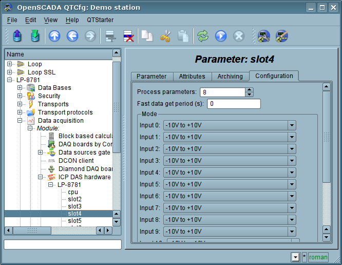

The module I-8014 formal provides speed access to data on one channel at 250 kHz by FIFO, however, because of the pledged hardware-program limitations it does not allow to reach speed over 100 kHz per channel when scanning into real-time, by low reading speed from FIFO. In that time the data reading causes the main CPU high load, that is 9.5 microseconds per sample.
The module I-8017 formal provides speed access to data on one channel at 130 kHz, however, because of the pledged hardware-program limitations it does not allow to reach speed over 33 kHz per channel when scanning multiple channels into real-time (by switching). Data expectation is in the blind cycle, which leads to great losses of the CPU at high frequencies of the acquisition.
The modules provides sixteen analog input attributes ai{x} and eight signs of violation of the upper ha{x} and the lower la{x} boundaries, for I-8017. Also "Configuration" tab is available with advanced configuration (Fig.6):
Fig.6. Tab "Configuration" of the modules I-8014 and I-8017.

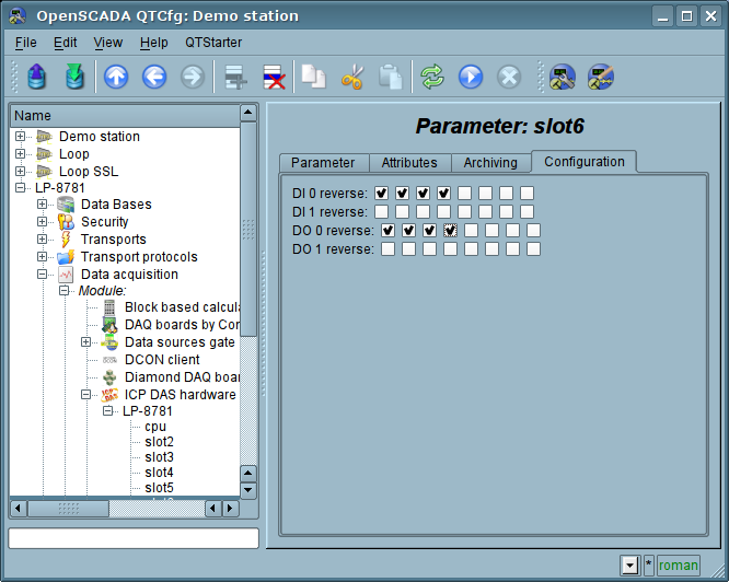

2.1.3 Digital input and output values inversion
For digital input and output modules, into tab "Configuration" (Fig.7), proposed selectable channel inversion function, that is too comfortably for next work with the channel.
Fig.7. Tab "Configuration" of digital input and output modules.

Besides support for modules into table 2 this modules group provide abstract module "I-87xxx" implementation, on select which to user will possible set quantity and types for generic connected module's signals: AI, AO, DI, DO and Counters. The function also selectable accessed for modules which containing signals AO and Counters and allows to limit processed channels quantity, for traffic decrease on the serial interface.
This abstract module "I-87xxx" you can use for modules "ICP DAS" I-7xxx series on "pure" serial bus.
Fields for signals quantity and types set provided into main tab of the parameter object configuration page (Fig.8).
Fig.8. Main tab of parameters of the abstract module "I-87xxx".

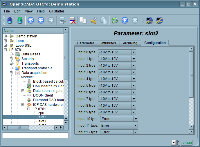

2.2.2 Channel type select for AI
For analog input modules possible to select mode/gain, which doing from list (Fig.9), if it specified for the module, or direct by mode's code set. The modes saved and stored into the module.

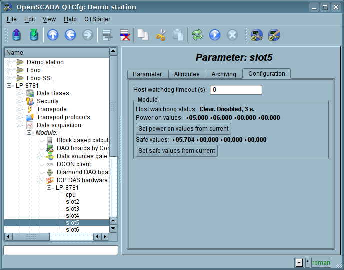

2.2.3 Host watchdog and default values for power on and by watchdog event
Modules with analog or digital outputs typical provide host watchdog function. And its sets safe outputs values on host activity miss for specified time. Also the modules allow specify outputs values for power on.
On Figure 10 presented tab for module with analog outputs and functions:
Fig.10. Tab "Configuration" of analog outputs modules.
