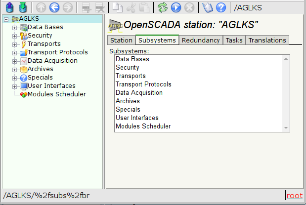

Let's examine the working window of the configurator in Figure 2.
The operating window of the configurator consists of the following parts:
1 Toolbar — contains the control buttons.
2 Address of the opened node — displays the selected node address.
3 Navigator — designed for direct navigation by the control tree and with support the group selection by holding Control or Shift keys, that is used by deletion and setting operations.
At.png Icon's image of the OpenSCADA project is taken firstly from the file "{StationName}.[png|gif|jpg|jpeg]" and next, at the first one missing, from the file "{StationID}.[png|gif|jpg|jpeg]", in the icons folder.
4 Workplace field — divided to parts:
4.1 Node name — contains the current node name.
4.2 Tabulator of the working areas — the root pages (control areas) of the node are placed into the tabulator. The control areas of the following levels are placed on the main control place.
4 Status line — indicating the configurator status.
