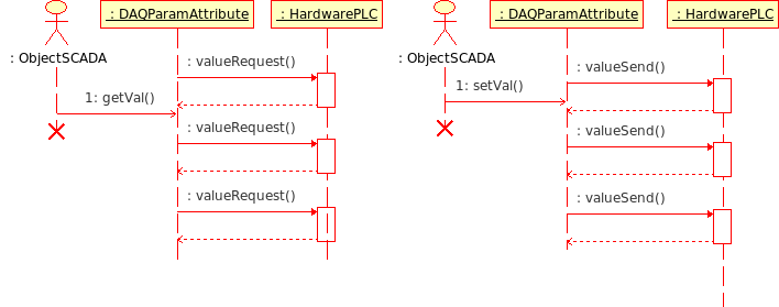

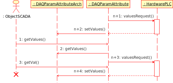

1.2 Simple asynchronous acquisition mechanism
The mechanism is characterized by requests to the data source, regardless of the request to the parameter attribute (Fig. 3). Usually, requests to the data source are made periodically in own polling task of the single taken controller and with the blocks of several signals. This request to the parameter attribute returns the value obtained from the last connection session with the data source. This mechanism is usually used when working with remote (network) data sources, characterized by high latency, i.e. delay in the response to the request.
With this method it's possible to optimize the time resource spent on one signal, and thereby increase the maximum number of requested signals during the time interval of the polling.
As an example, lets examine an industrial PLC "Siemens S7-315" during requesting him on the bus ProfiBus (1,5 Mbit/s). The average processing time of the MPI-request of this controller is 30 ms. If you use the synchronous mechanism for each signal, i.e. one request for each signal, then in one second we can get something about 33 signals. And if you apply the asynchronous mechanism, i.e. in the MPI-package to receive up to 220 bytes or 110 signals of integer type of 16-bit, then we can for one second get up to the 3630 signals. As you can see, the effectiveness of the asynchronous mechanism in this case is 110 times, that is the maximum capacity of MPI-package.
The disadvantage of the asynchronous mechanism is that the request of the value of parameter attribute returns not actual at the time of request value, but value of the last session of the polling of the controller. However, taking in account that the data source can be updated at intervals of ADC hardware limitations, and the sensors themselves may have certain restrictions on the reaction rate, the using of the asynchronous acquisition mechanism could have a serious grounds.
Application of the asynchronous mechanism for recording the values to the PLC is a fairly rare fact, because recording of values usually involves impact of the operator on the TP. Operator on the fact rarely makes adjustments to the process, therefore, the recording can be performed synchronously. However, there are situations, such as managing of the TP by the regulator on SCADA-system, acting as the runtime environment of PLC.
Fig. 3. Diagram of the sequence of interaction with the asynchronous requests.
In accordance with the diagram above, we obtain the following picture:

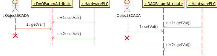

1.4 Passive acquisition mechanism and initiative connections
The passive acquisition mechanism is characterized by the initiative of providing data to the SCADA-system from the data source. This mechanism is rare but can occur in certain conditions or restrictions of the possibility of using the direct data acquisition mechanisms, Figure 1.4a. An example of such situation can be the geographically allocated systems of the data acquisition through mobile networks GPRS/EDGE/3G/4G/... . The allocation of all nodes to individual real and static IP-addresses, or the formation of a corporate mobile network, may prove to be expensive in such networks, therefore, the initiative of the data transferring from behind dynamic IP-addresses to one real IP-address of the SCADA-server is more accessible. Modification actions are transmitted to the data source at the time of the data transmission session by the source — reading. Although, typical requests are possible here through a VPN connection from a data source and proceeding through a network intermediate DBMS.
Fig.1.4a. Diagram of the sequence of interaction with the passive working mode.
In accordance with the diagram above, we obtain the following behavior of the passive mechanism:

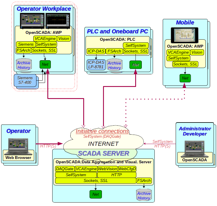

If the host initiating the connection has a dynamic address that is not "gray", that is, it can be connected directly, then the initiating connection can only be used to obtain a return address to which it is directly back connected, and in the controller of such connections only updating the dynamic addresses is performed.
At.png A special case is the initiative of the TCP-connection establishing from the data source and the standard requests do next by the server through the connection, that the input transports of the module "Sockets" and the module "SSL" are currently supported. This mode is currently even the most popular!
OpenSCADA also supports the initiation of such connections itself, that is, it can act as a data source for "gray" and dynamic IP. So, the input transport of the module "Sockets" and the module "SSL" in the mode 2 initiates the connection and then sends an identifying sequence and enters the normal mode of receiving requests from the host to which it is connected. At.png Regarding what is currently especially useful is the remote control of OpenSCADA stations in "gray" networks with such a connection.
Fig.1.4b. Initiative connection of the Data Sources.

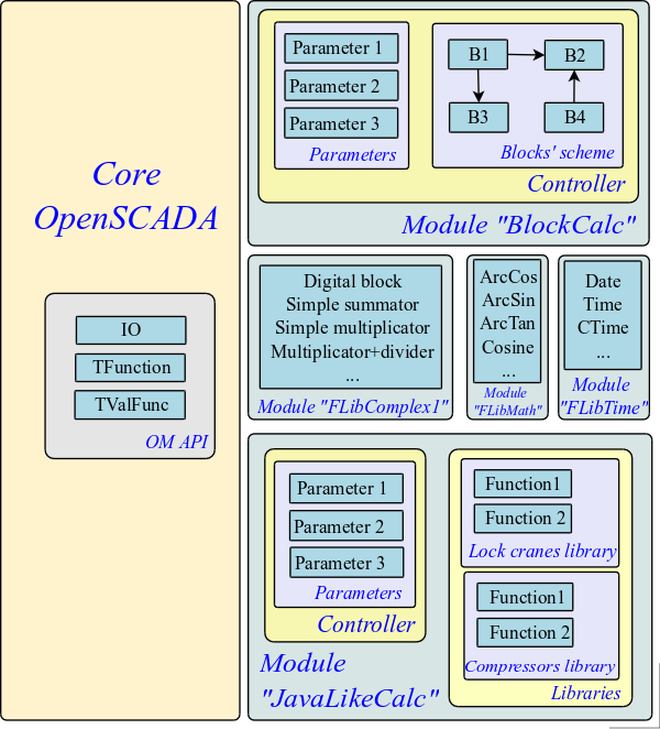

With the purpose of filling the user programming API with the functions, the following specialized modules of static functions of the user programming API are created:
Fig. 6. Overall structure of the programming area components.

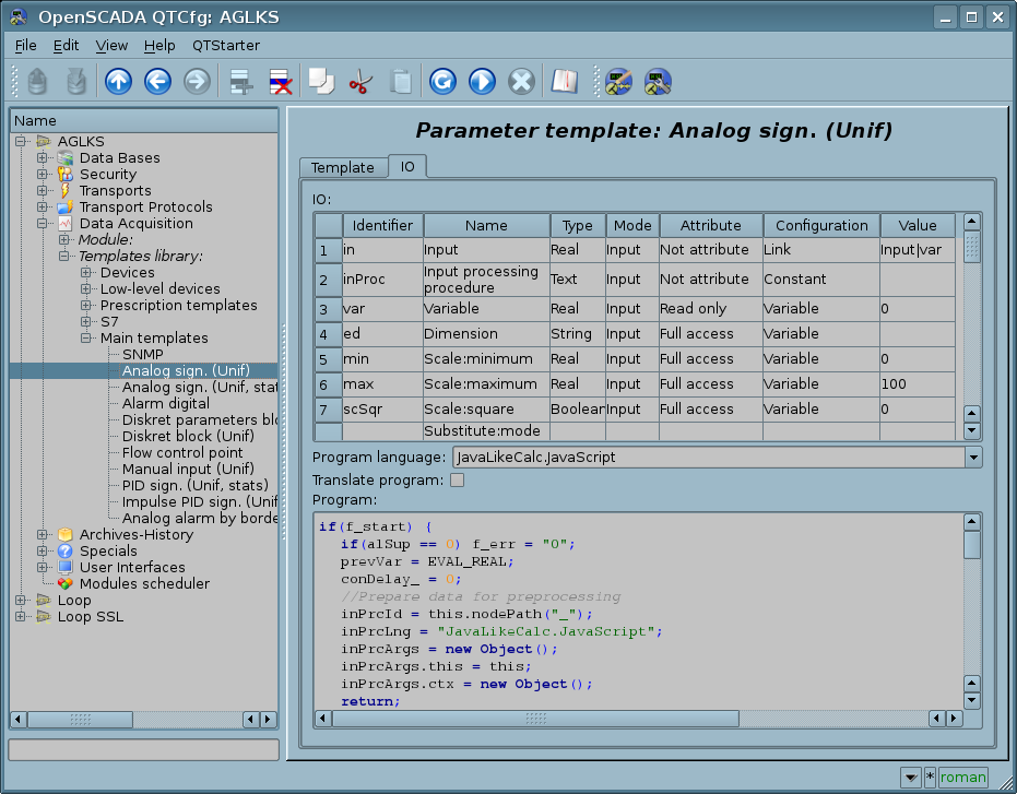

Figure 9 shows an image of the configuration tab of the parameters template of the subsystems "DAQ" as the table with the configuration of inputs/outputs and the text of the program of user programming.
Fig. 9. Configuration tab of a parameters template of the subsystem "DAQ".
The inputs/outputs tab "IO" of the parameters template provides the following properties of special purpose: "Attribute", "Configuration" and "Value".
The property "Attribute" is the reflecting sign of the template I/O on the resulting attribute of the parameter. There the following options for this property are provided:
The property "Configuration" is the sign indicating the using of input/output of the template function in the resulting configuration of the template on the logic level. The following options for this property are provided:
The field "Value" describes the preset value for the constants and templates of the external links. Template of the external links is used to describe the mechanism of grouping and automatic allocation of the external links. The template structure of the external links is the same in the part of connecting to the attributes of the subsystem "DAQ" and it is expanded by the specific format of the address of a separate module of the subsystem "DAQ", which uses the template mechanism. Connection to the parameters of the subsystem "DAQ" — the configuration template of the external link has the form {Parameter}|{attribute}, where:

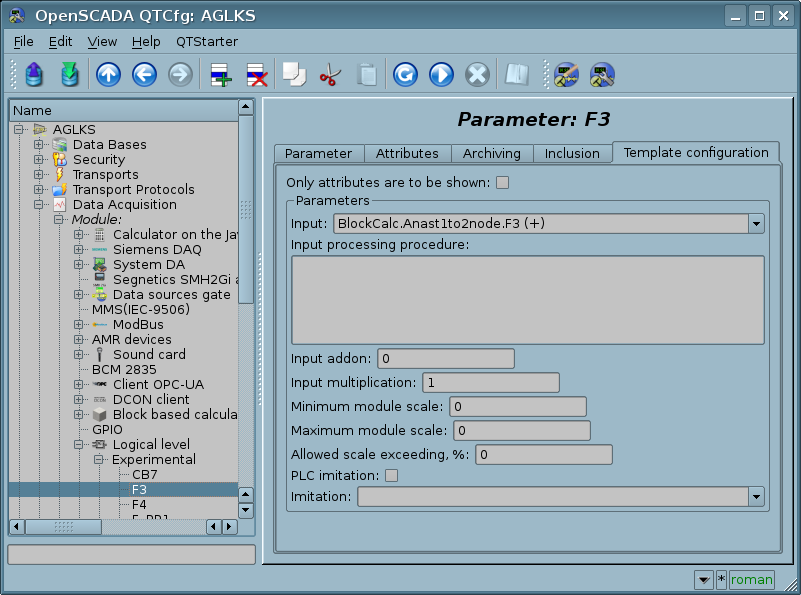

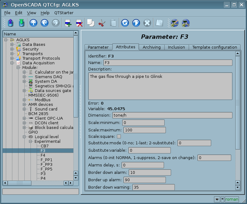

As an example of using the template, in Figure 10 is shown an image of the parameter "F3" of the logic level module, where the tab "Template configuration" is presented' for the configuration of the parameter template, including the linkage. In Figure 11 the tab "Attributes" is shown with the list of attributes and their values, created through the template.
Fig. 10. Tab "Template configuration" of the parameter "F3" of the logic level module.
Fig. 11. Tab "Attributes" of the parameter "F3" of the logical level module.

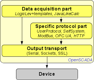

The conception of accessing the data by a user protocol we can imagine like to Figure 1.
Fig.1. Conception of user accessing to services and device's data.
As you can see from Figure 1, interaction with devices carried out through some transport on which their physically based. Requests to the transport you can send:

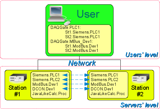

Redundancy in general and of the data sources in particular serves to increase the overall level of fault-tolerance of the solution by integrating the redundant nodes in collaboration with the main node. In case of failure of the main node, the grab of the main node functions by the redundant one takes place. The redundant scheme can work in the mode of the load distribution between the co-operating nodes.
Fig. 12. Horizontal and vertical redundancy.
In the case of the "Data acquisition" subsystem, data reservation (Fig. 12) serves as:

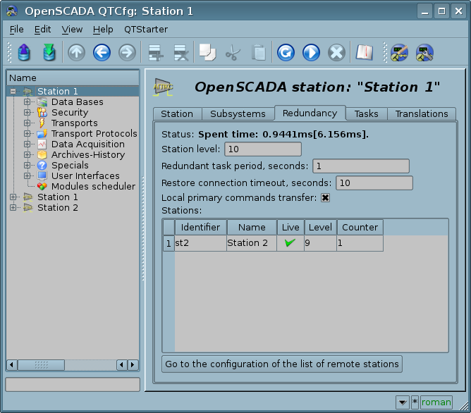

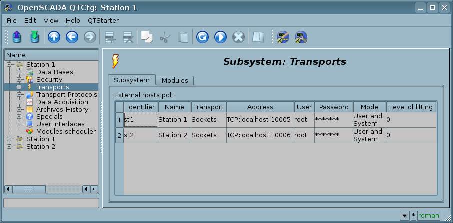

Redundancy configuration start from the redundant stations appending to the list of OpenSCADA stations in the tab "Subsystem" of the subsystem "Transports" (Fig.13). And to add here you need not only the redundant stations to the current one but the same current one with its external IP, that is some loop. Further this configurations will have been stored in the generic DB of the redundant system, and from this time the DBs will be used in all redundant station creation. Then there is important to make on that stage all need changes in the generic DB and about this project in general!
Fig. 13. Tab "Subsystem" of the "Transports" subsystem.
Next for the concrete station, with copy of the generic DB, we configure its specific parameters in the tab "Redundancy" of the main page (Fig.14), which will be stored in the configuration file.
Fig. 14. Tab "Redundancy" of the main page.

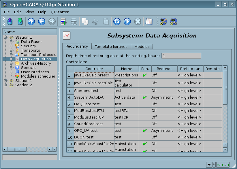

After that all next configurations of the redundancy performed in the tab "Redundancy" of the subsystem "Data acquisition" (Fig.15). If you will set the parameter "Local primary commands transfer" (Fig.14) then the configurations, like to any other generic ones, can be carried out at one of the stations, and the changes made will fall on all the redundant stations, of course, if they will be available.
Fig. 15. Tab "Redundancy" of the "Data Acquisition" subsystem.
The service task of the redundancy mechanism is always running and executed at intervals which are set in the appropriate configuration field. The real work on implementing the redundancy is carried out in the presence of at least one redundant station in the list of stations, and means:
To control the time spent in the cycle of serving the redundancy, the status field is provided. When approaching the real execution time to the cycle of the redundancy tasks it's recommended to increase the periodicity of this task execution!
For the controller object of the subsystem "Data Acquisition", "Asymmetric" and "Only Alarms" reservation modes are provided. Asymmetric redundancy is working with the configuration of the controller of the remote station, as it is, and does not trying to generalize it. For this mode work all early presented functions and properties of the redundancy. The redundancy "Only Alarms" is working in fact without a redundancy, but with oppressing the alarms from the reserve controller object to exclude a duble messages in the alarms.
