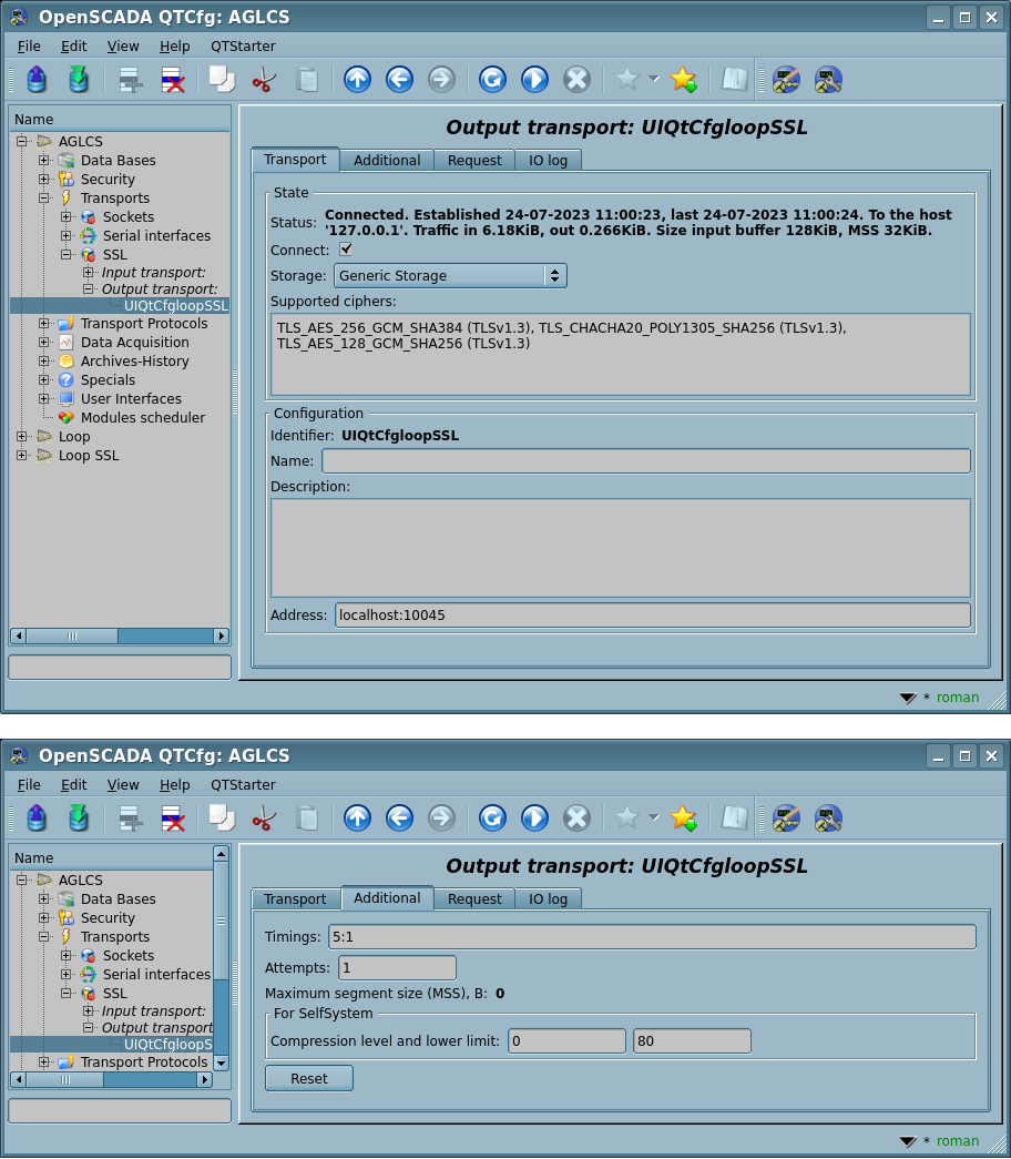

Using the main dialog you can set:
Using the additional dialog you can set:
At.png Hidden in the connected state.
Can be prioritatile specified into the address field as the second global argument, as such "localhost:123||5:1".
Can be prioritatile specified into the address field as the third global argument, as such "localhost:123||5:1||3".
