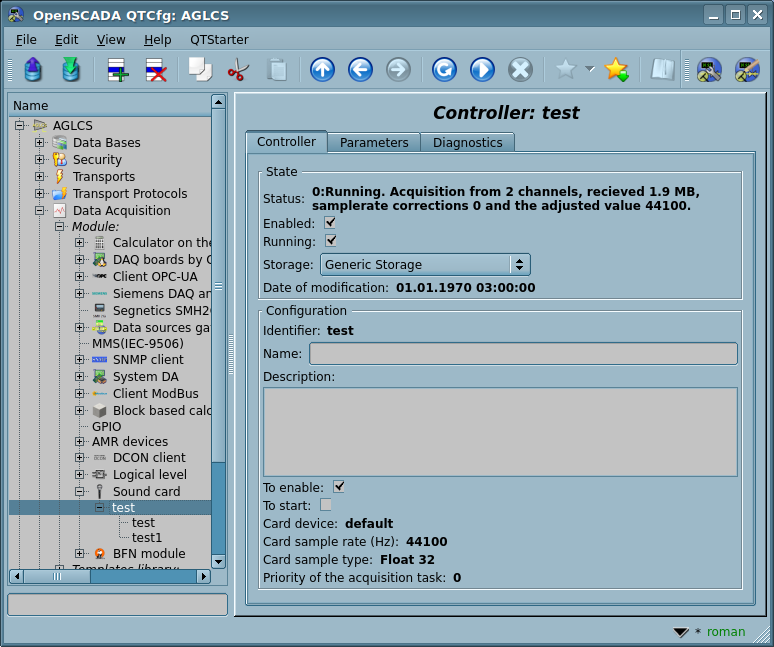

To add an audio input device a controller object is created and configured in OpenSCADA. Example of the configuration tab of the controller object is shown in Figure 1.
From this tab you can set:

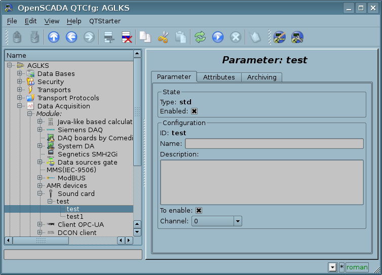

To add a channel of input sound device a parameter of the controller object is created and configured in OpenSCADA. Example of the configuration tab of the parameter is shown in Figure 2.

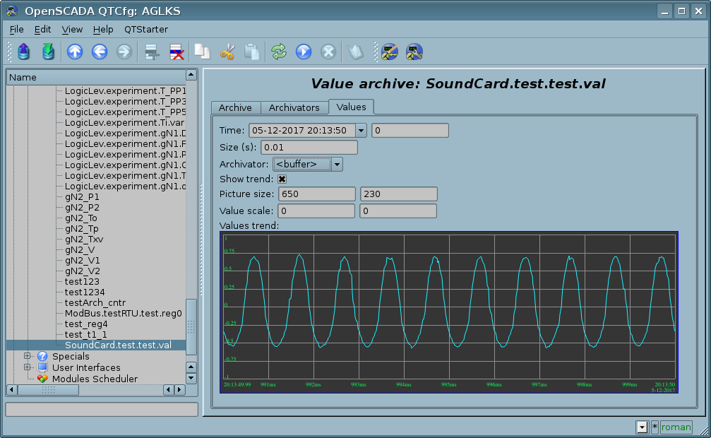

Tab of attributes of the parameter has the form presented in Figure 3, the tab of the values of the attribute's archive "val" is presented in Figure 4.
