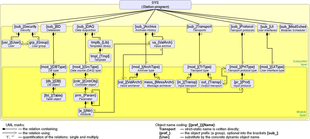

Before programming in OpenSCADA, you must examine the object structure of the program (Object Model) in the OpenSCADA Program Manual and in Figure 1.
Fig. 1. User object model of the core OpenSCADA.
From this document you will see that you can program next parts of OpenSCADA as the user:
User programming API is the tree of the OpenSCADA objects (Fig.1), every object of which can provide own list of properties and functions. Properties and functions of the objects can be used by the user in procedures on the languages of the user programming of OpenSCADA.
Currently OpenSCADA provides only one language of the text programming — JavaLikeCalc then you must learn it also before the starting! The entry point for access to the objects of OpenSCADA (Fig.1) from the user programming language JavaLikeCalc is the reserved word "SYS" of the root OpenSCADA object. For example, to access the function of output transport you should write: SYS.Transport.Serial.out_ModBus.messIO(mess);.
API of the objects provided by the modules is described in the own documentation of the modules and here links to their are provided.
