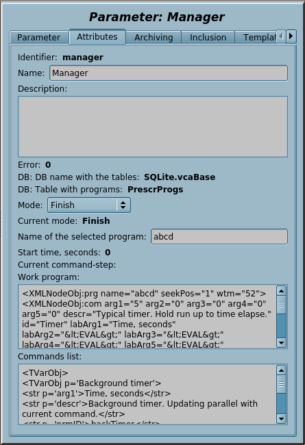

2.1 Prescriptions manager (manager) |
2.2 | GPLv2 | * | en, uk, ru | Roman Savochenko |
Basic, representative and unified template of a manager and a controller of the prescriptions, of their processing and direct execution in the "command-macro" mode. The template forms a structure of the prescription manager parameter which can be easily connected to all frames of this library.
The representative structure of the prescription manager is:
Functions
Template IOs
| Identifier | Name | Type | Mode | Attribute | Configuration | Value |
| dbDB | DB: DB name with the tables | String | Input | Read only | Constant | |
| dbComs | DB: Table with commands | String | Input | Not attribute | Constant | PrescrComs |
| dbProgs | DB: Table with programs | String | Input | Read only | Constant | PrescrProgs |
| comsCntr | Commands controller,
<empty> - for commands into the table, |
String | Input | Not attribute | Constant | * |
| mode | Mode | Integer numbers selection | Input | Full access | Variable | -2
-2;-1;0;1;2;3 Finish;Error;Stop;Run;Pause;Pass com |
| curMode | Current mode | Integer numbers selection | Input | Read only | Variable | -2
| prog | Name of the selected program | String | Input | Full access | Variable | |
| startTm | Start time, seconds | Integer | Input | Read only | Variable | |
| curCom | Current command-step | String | Input | Read only | Variable | |
| work | Work program | Object | Input | Read only | Variable | |
| comLs | Commands list | Object | Input | Read only | Variable | |
| clcCnt | Cycles counter | Integer | Input | Not attribute | Variable | |
| this | The object | Object | Input | Not attribute | Variable | |
| f_err | Function error | String | Input | Not attribute | Variable | 0 |
| f_frq | Frequency of calculation of the function, Hz | Real | Input | Not attribute | Variable | 1000 |
| f_start | Function start flag | Boolean | Input | Not attribute | Variable | 0 |
| f_stop | Function stop flag | Boolean | Input | Not attribute | Variable | 0 |
Configuring and using
dbDB dbProgs comLs prog mode curMode startTm curCom work

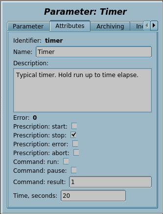

2.2.1 Command — Timer (timer) |
2.0 | GPLv2 | * | en, uk, ru | Roman Savochenko |
Template of a command of the prescription typical timer. The timer is only designed to hold time between other action steps and for example, so it only has one attribute, "Time" in seconds.
Template IOs
| start | Prescription: start | Boolean | Input | Full access | Variable | 0 |
| stop | Prescription: stop | Boolean | Input | Full access | Variable | 0 |
| error | Prescription: error | Boolean | Input | Full access | Variable | 0 |
| abort | Prescription: abort | Boolean | Input | Full access | Variable | 0 |
| run | Command: run | Boolean | Input | Full access | Variable | 0 |
| pause | Command: pause | Boolean | Input | Full access | Variable | 0 |
| rez | Command: result | String | Input | Full access | Variable | 1 |
| arg1 | Time, seconds | Real | Input | Full access | Variable | |
| tmp1 | Temporary 1 | Real | Output | Not attribute | Variable | 0 |

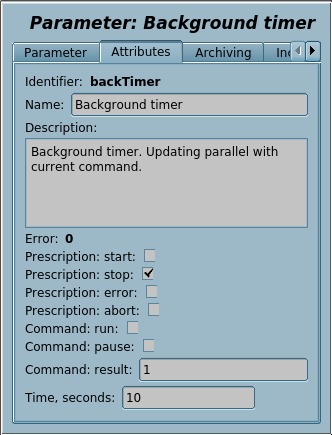

2.2.2 Command — Background timer (backTimer) |
Template of a command of the prescription background timer. The timer designed only for hold a time in the background to an example, then it contains only one attribute, it is "Time" in seconds.
Template IOs

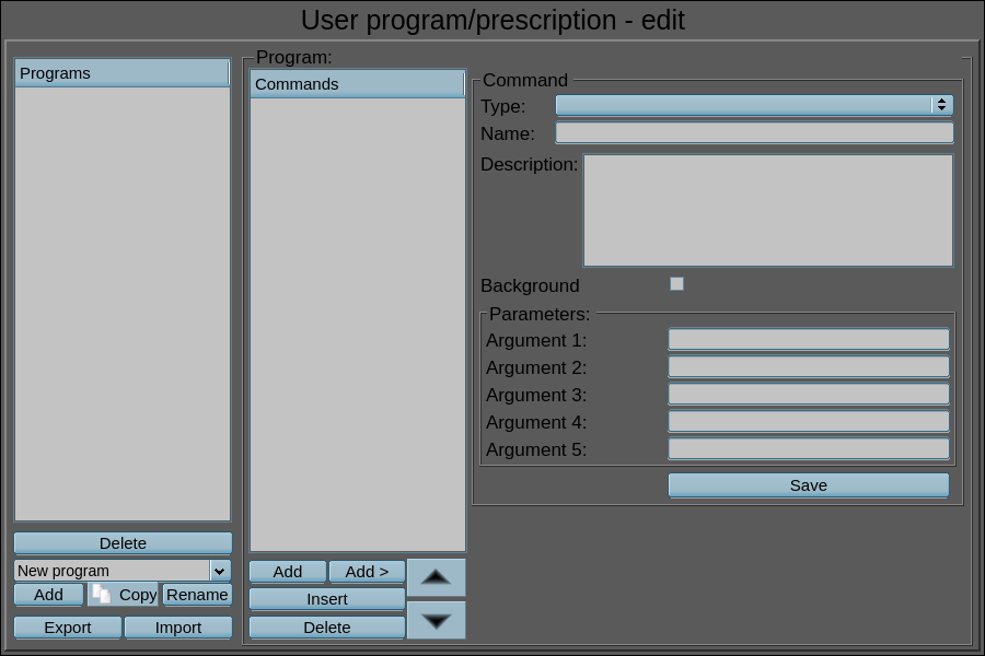

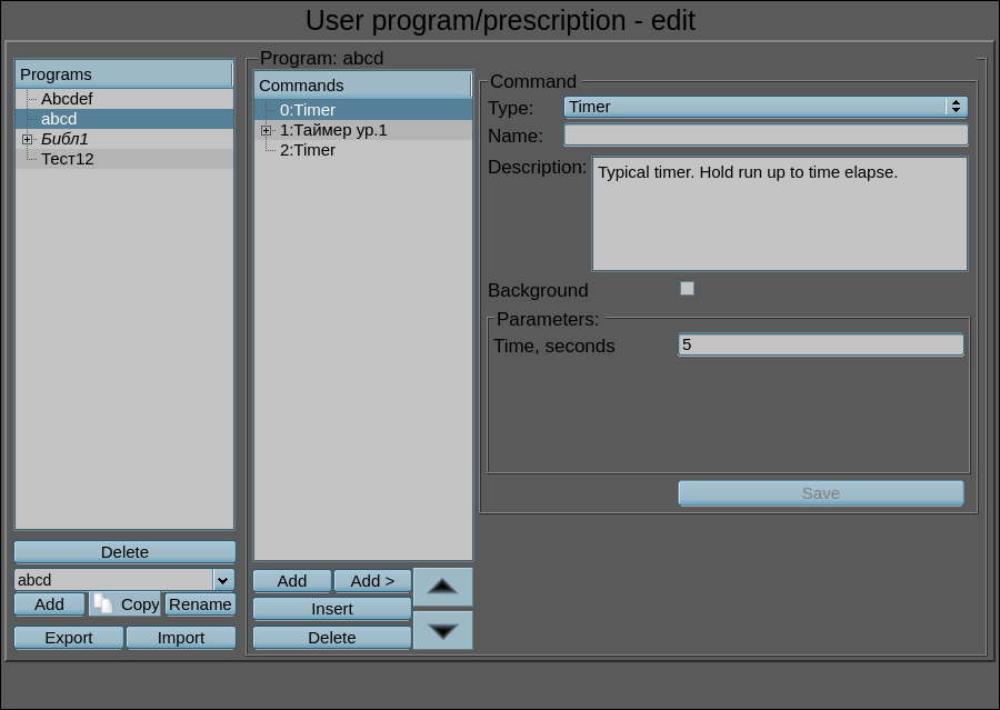

3.1 Prescription — edit (prescrEdit) |
1.3 | GPLv2 | * | en, uk, ru | Roman Savochenko |
The frame, shown in Figure 3.1, is one of the group frames for working with the prescriptions, which serves for the user-editing of the prescriptions-programs. The frame commonly uses and represents the representative structure of the prescription manager.
The frame contains from left to right:
Using — development
The frame is designed to perform the role of page, and should therefore be placed directly in the project's tree. To the frame can be connected one parameter of the prescription manager, by setting the links.
Using — runtime
In the runtime mode, the user can add new prescription-programs, delete, copy and export the existing ones as well as to import prescriptions from other OpenSCADA stations. In the selected prescription-program user can do: add or insert a new step, remove or move the selected step. For the selected steps of the prescription-program the user can set the command and enter the name, description, background execution flag and values for the available arguments of the selected command, and then to save changes of the step.
Removal operations are accompanied by the confirmation dialog.
{Linking and configuring the attributes
| Identifier | Name | Type | Configuration | Configuration template |
| dbDB | DB: Data base | String | Input link | Controller|dbDB |
| dbProgs | DB: Programs table | String | Input link | Controller|dbProgs |
| prExtComLs | Available commands list | Object | Input link | Controller|comLs |

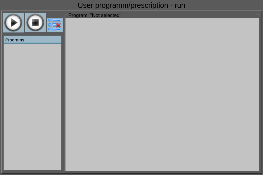

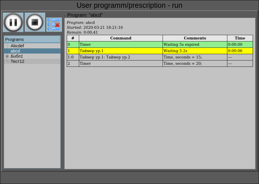

3.2 Prescription — run (prescrRun) |
The frame, shown in Figure 3.2, is one of the group frames for working with the prescriptions, which serves for control and observing of executing the programs-prescriptions, previously formed in the Prescription — edit frame. The frame commonly uses and represents the representative structure of the prescription manager. In addition to this full-format prescription frame, there is a simplified one — "Prescription — run, simple, that allows you to manage and to track compactly the prescriptions execution in other frames of the technological process.
The frame contains from the left to the right:
Using — development
To archive completed sessions while the operator is switching between frames, this full-format frame in the project tree must be set for the parameter "Page: process not opened".
At the end of the prescription-program, messages with session parameters are generated by the prescription manager, as well as archiving of the session document. The messages with the session parameters can be used either simply to view the sessions history or to create a session list, for example, in the graphics group to go to the history at the session time. The reports archive is set to the depth of 10 documents by default, what you can change by setting the "Archive length (n)" attribute of the document widget.
Using — runtime
In the runtime mode, the user can select the desired prescription-program and run-on the execution, and then track the execution progress or switch to other frames. The running program user can pause by pressing the "Pause" button or terminate by pressing "Stop". In addition, the user can skip the current step by clicking the "Skip" button. Also the user can review or print reports of the previously executed prescriptions of this full-format frame, for what it is necessary to press the left mouse button on the document and browse on the navigation bar through the archive of the executed prescriptions.

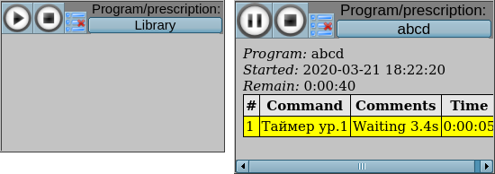

3.3 Prescription — run, simple (prescrRunSimple) |
The widget, shown in Figure 3.3, is a simple variant of the frame "Prescription — run", which designed for placing as a widget of the mnemonic schemes and it mostly works together the frame "Prescription — run". The frame commonly uses and represents the representative structure of the prescription manager.
The widget contains from the left to the right and to the bottom:
Using — development
This widget can be used by the developer to create mnemonic schemes with displaying the prescriptions execution activity and to fast control them. To use it you need to add this widget to a mnemonic scheme, adjust for the horizontal, vertical size, by scaling, and connect to the prescription manager, by setting the links.
Using — runtime
In the runtime mode, the user can select the desired prescription-program, in the dialog of selecting item into tree that appears at the prescription button click, and run-on the execution, and then track the execution progress or switch to other frames. The running program user can pause by pressing the "Pause" button or terminate by pressing "Stop". In addition, the user can skip the current step by clicking the "Skip" button.
| prExtCurCom | Controller: current command | String | Input link | Controller|curCom |
| prExtMode | Controller: mode | Integer | Full link | Controller|mode |
| prExtProg | Controller: program | String | Full link | Controller|prog |
| prExtStartTm | Controller: start time | Integer | Input link | Controller|startTm |
| prExtWork | Controller: work | Object | Input link | Controller|work |
