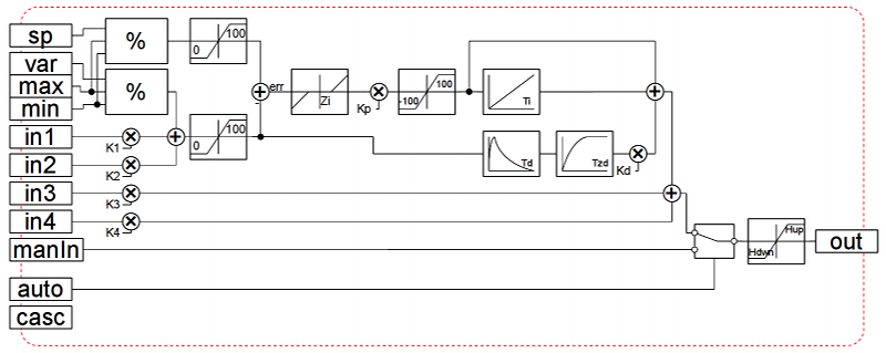

13 PID regulator (pid)
Description: Proportional-integral-differential regulator.
Parameters:
Identifier Parameter Type Mode By defaults
var Variable Real Input 0
sp Setpoint Real Output 0
max Maximum of the scale Real Input 100
min Minimum of the scale Real Input 0
manIn Manual input, % Real Input 0
out Out, % Real Return 0
auto Auto mode Bool Input 0
casc Cascade mode Bool Input 0
Kp Kp Real Input 1
Ti Ti, milliseconds Integer Input 1000
Kd Kd Real Input 1
Td Td, milliseconds Integer Input 0
Tzd Td lag, milliseconds Integer Input 0
Hup Upper limit of the out, % Real Input 100
Hdwn Lower limit of the out, % Real Input 0
Zi Insensitivity, % Real Input 1
followSp Follow setpoint from variable on the manual mode Bool Input 1
K1 K input 1 Real Input 0
in1 Input 1 Real Input 0
K2 K input 2 Real Input 0
in2 Input 2 Real Input 0
K3 K input 3 Real Input 0
in3 Input 3 Real Input 0
K4 K input 4 Real Input 0
in4 Input 4 Real Input 0
f_frq Frequency of the calculating, Hz Real Input 1
Structure:
