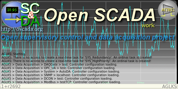

From the beginning, this module creates a separate thread for the main Qt thread, where it is possible to create a dynamic splash screen (Fig.1), since the main OpenSCADA tasks continue to run in the main thread. That version of Qt5 became especially sensitive to execution in a non-main thread, so for OpenSCADA it was added to this feature, but with the messages update in the screen saver from the service thread before and after the moment of switching to the primary tasks. To control this feature, the --QtInNotMainThread startup option, which enables thread execution in the non-main thread, is provided, for Qt4, so, by default, executing in the main thread is typical, for Qt5.
