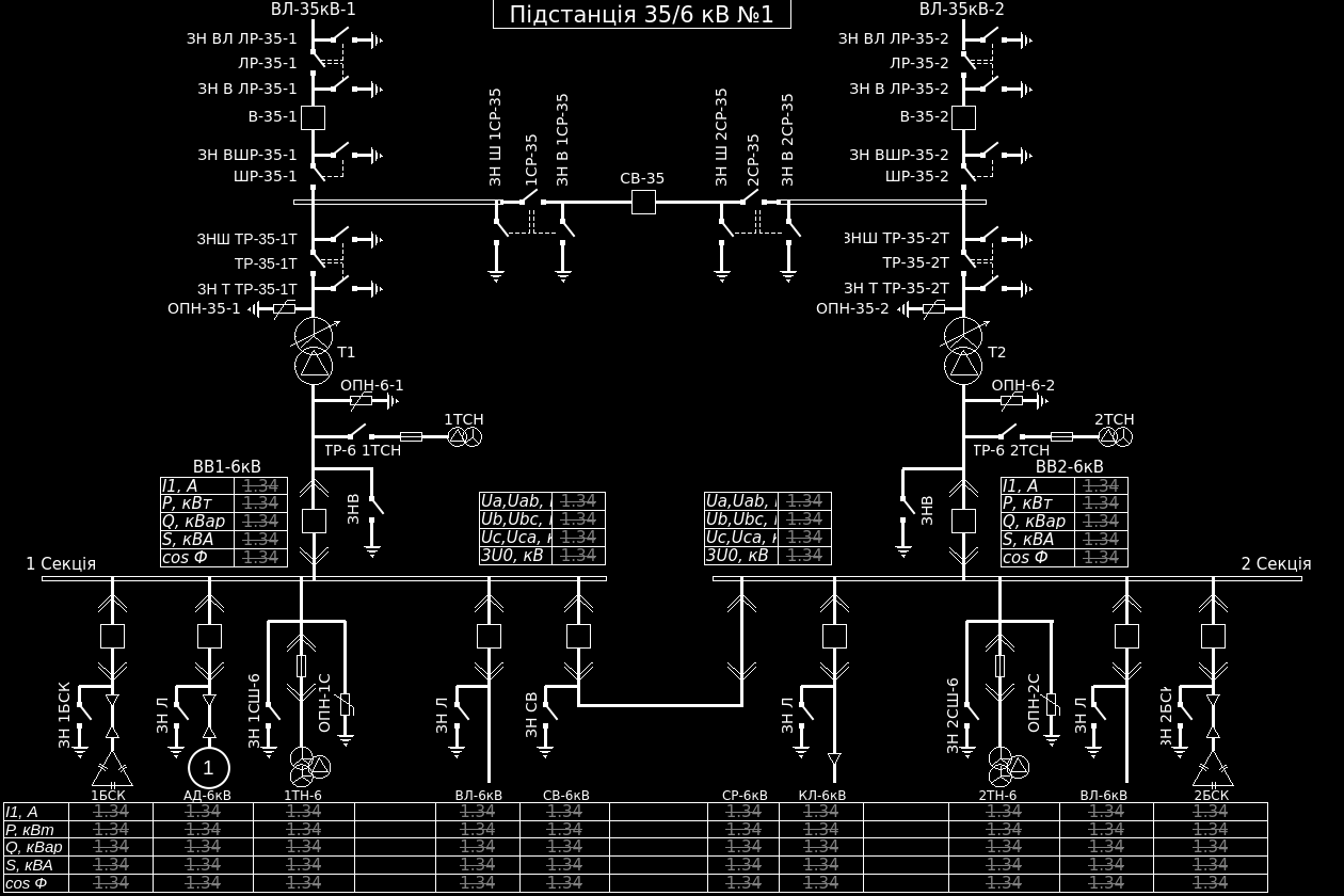

This library contains and is intended for the construction of integral electrical schemes of arbitrary configuration of its individual elements, which need to be visually connected to each other so that there are no obvious displacements along the common axis and the intervals between the connection of visual elements, especially for the connection lines and with the ability to have an equally perfect appearance across a wide range of scales, ideally at all.
The need for wide-scale mnemonic schemes is relevant because of the unified construction of the mnemonic schemes in the resolution 900x600 and the ability to perform them on large resolutions of modern displays, when the zoom factor can now reach 10.
Therefore, all imperfections of the manual fitting there will immediately pop up and spoil the picture, since it is difficult to do without special means and on the initial screen of development it is impossible to see them.
Accordingly, the following rules are recommended for fitting the elements to obtain the desired result:
Applying these rules can be quite simple to get the result in the figure:
