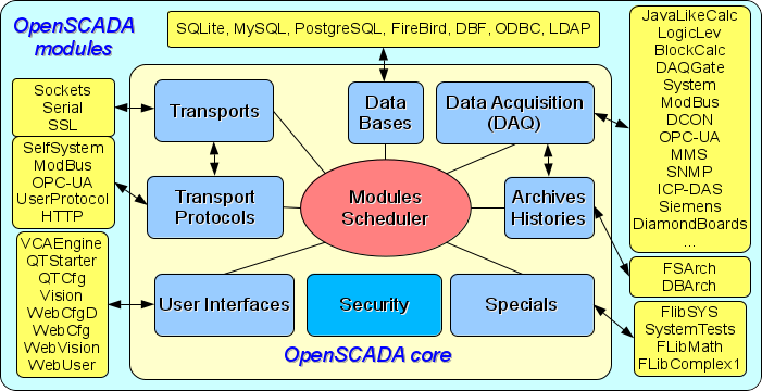

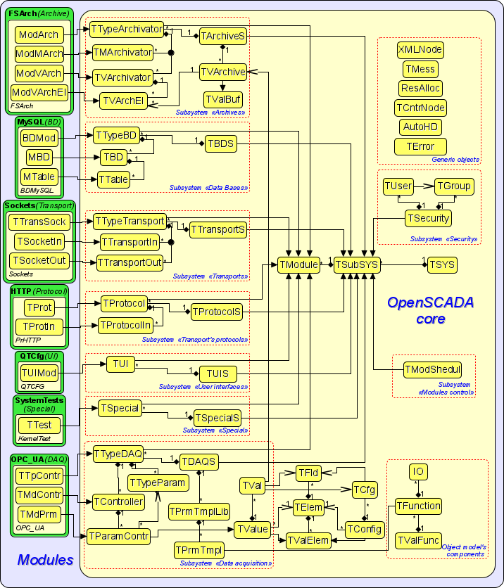

1 Internal structure
For a visual and accessible understanding of the OpenSCADA architecture, Figure 1 shows a static diagram of the OpenSCADA classes in the Universal Modeling Language (UML).
It can be seen from the diagram that OpenSCADA contains modular subsystems: "Archives-History", "Databases", "Transports", "Transport protocols", "User Interfaces", "Data Acquisition" and "Special", as well as subsystems: "Security" and "Module's management". The diagram shows the relationships between modular subsystems and modules of the corresponding types.
Fig. 1. Static class diagram.

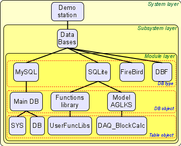

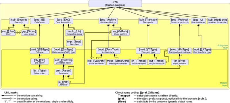

2 Overall structure of the program — modularity
The root, from which we construct the whole program, is the object #TSYS. The root contains subsystems #TSubSYS. The subsystems can be ordinary and modular. Difference the modular subsystems is clearly shown in Figure 1. Thus, modular subsystems necessarily contain a list of modular objects #TModule, for example, the archive-history subsystem #TArchiveS contains the modular objects #TTypeArchivator. Meanwhile, the normal subsystem does not contain such objects, for example, the security subsystem #TSecurity (Fig. 2).
Fig. 2. Hierarchical structure of OpenSCADA.
The root initialization process #TSYS defines a global variable "SYS" that can be used to directly access the root of the application from any of its nodes. The root initialisation is done once from the calling main function. After starting, control is captured by the root object of the program until it stops. The root object concentrates all the common functions of OpenSCADA.
The continuation of the root object #TSYS, which performs the functions of maintaining the flow of program messages, is the object #TMess, which is available through the global variable "Mess" initialised by the root of the program. The object contains functions of encoding, decoding and localisation of messages.
The subsystems #TSubSYS implement functions that are individual to each subsystem and with access common to all subsystems through the #TSubSYS object. The modular subsystem has the possibility of expanding functionality through modules, for which it provides access to modules of its type in the form of modular objects.
A module is a component of a modular subsystem. A module provides information about itself, its origin, and the functions it exports. A separate module implements functionality according to its own needs.

3 Subsystem "DB"
Subsystem "Databases" is represented by the object TBDS, which contains a modular objects of the following types of DB TTypeBD. Each type of database contains objects of individual databases of that type TBD. Each database in its turn, contains the objects of their tables TTable (Fig. 3).
Fig. 3. Hierarchical structure of the subsystem "DB".
The subsystem provides the basic functions to access the type of database, as well as generalized functions for the manipulation of the databases and tables. For example, to hide the source of data, which may be a configuration file, the functions of an abstract access to the data source are provided. For the storage system-wide data the system table and the function of the abstract to access it are provided. Consequently, system-wide data can be stored in the configuration file and in the database table. More about the data organisation conception you can read in the Data in OpenSCADA and their storage section.
Being a modular object, the type of database (TTypeBD) provides access to the implementation of the mechanism of one or another database. Access is made through a public databases of the module of a given type of database. Open/registered database is described in the table of databases to be opened or in the configuration file. There is, the so-called, the working database, which is always opens and is shown in the configuration file. DB which support the SQL-queries can grant access based on direct SQL-queries.
While working, the components of OpenSCADA open tables (TTable) available in the database and work with them.
