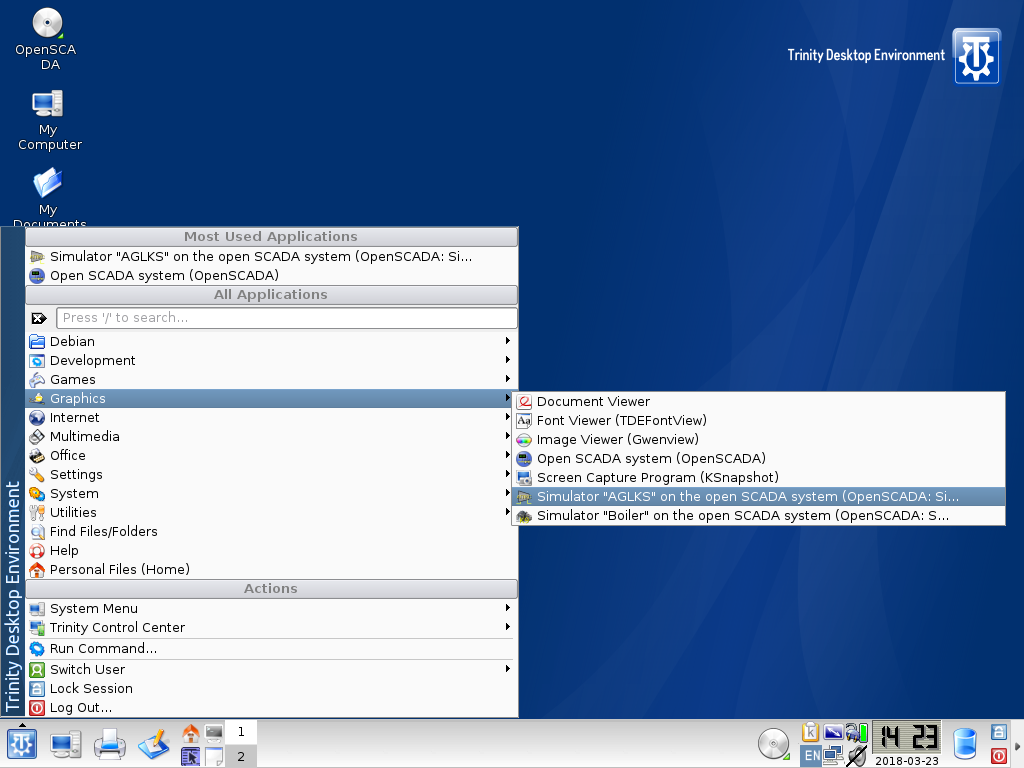

Start the local execution of OpenSCADA from the DB simulator "AGLKS" you can from the section "Graphics" of the desktop environment menu for the item "Simulator "AGLKS" on the open SCADA system" with a characteristic icon (Fig.3.1.1).
Fig. 3.1.1. Menu item of the desktop environment for local starting the demo of OpenSCADA.
Local starting also can be done from the console by the command:
openscada_AGLKS

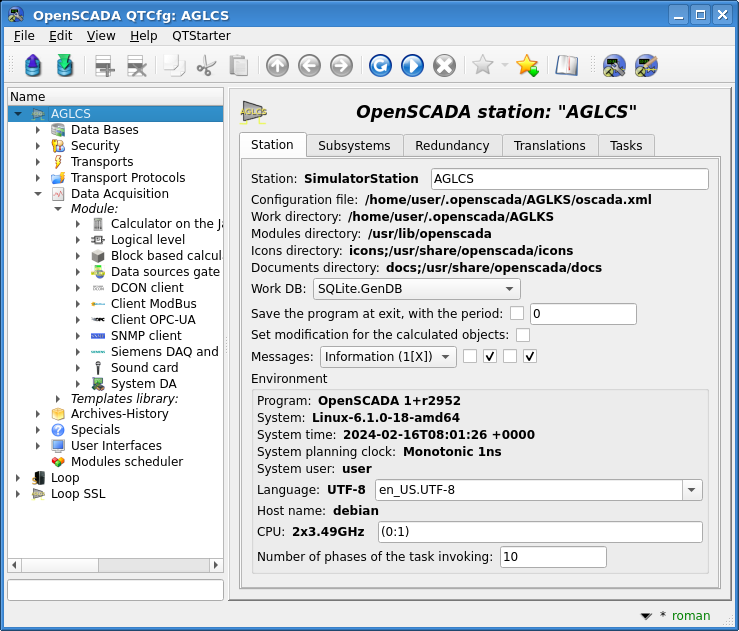

After the starting we'll get a window of the OpenSCADA graphical configurator — QTCfg (Fig.3.1.2) with the opened root page. The demo database specially configured so that the first window you'll see after the starting it is the configurator window, you can then open a window for creating graphical user interfaces, as well as run the user interface project for execution.
Fig. 3.1.2. OpenSCADA program configurator — QTCfg, the root page.
The program configurator of OpenSCADA is the main and sufficient instrument for configuration of any component of OpenSCADA. Like to many other components of OpenSCADA, the configurator is implemented as a module. Besides the QTCfg configurator there available other configurators those perform the same functions, but implemented on the basis of other technologies. For example, these are the Web-configurators: WebCfgD and WebCfg.
All actions in further we will overview only in the configurator QTCfg although all of them can be done in other configurators.
Structure of interface of the configurator window can be considered in details by the link. It is more important now for us to overview all available interfaces of OpenSCADA, so click next to the last icon in the top on the toolbar, which will open a window of development the user interface (Fig.3.1.3).

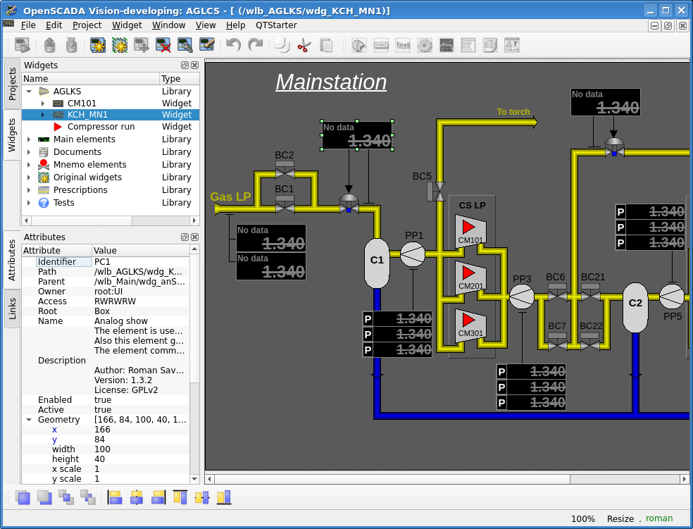

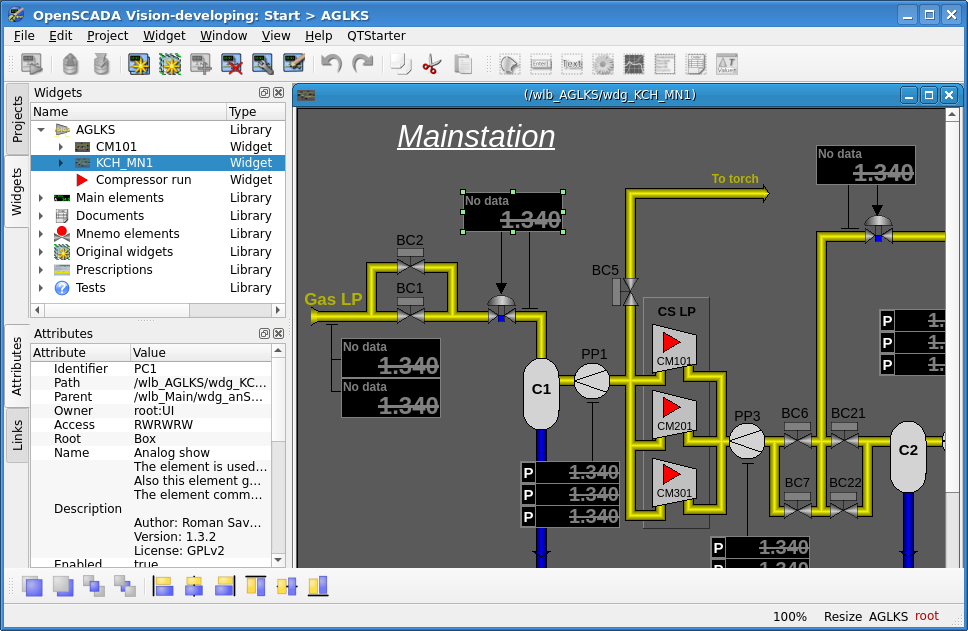

Fig. 3.1.3. Window of development the user interface.

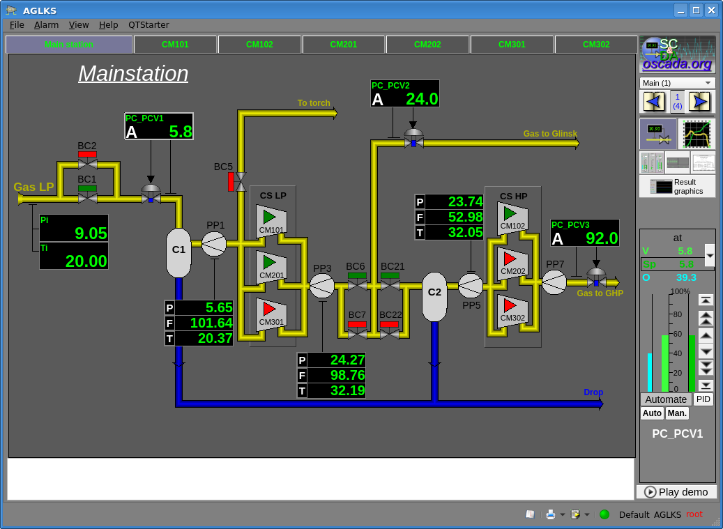

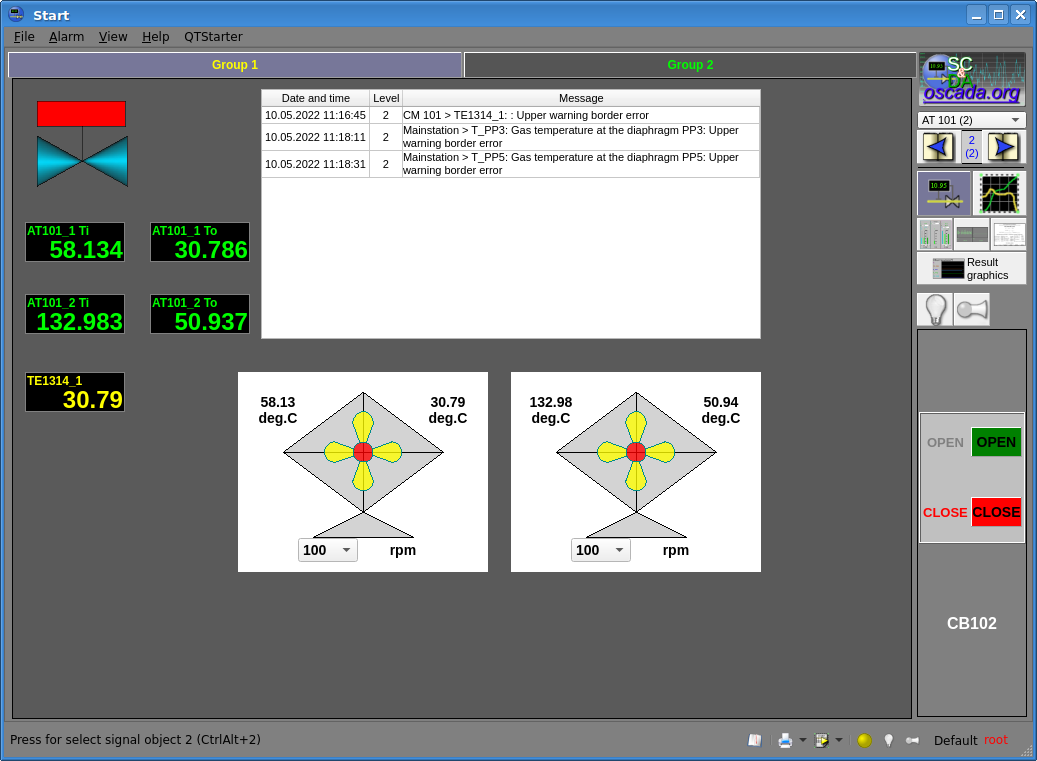

Then we can start execution of the "AGLKS" project, to do that select its in list of the projects and run, by clicking on the first left icon on the toolbar, or in the the popup menu. The result will be window of the end interface of the user — the operator (Fig.3.1.4).
Fig. 3.1.4. Window of the end interface of the user of the "AGLKS" project.
Building and executing the user interfaces is implemented by the Vision module of the "User interfaces" subsystem. In addition to this module the other modules of visualization is accessed, for example, OpenSCADA provides the WebVision module, which allows to execute projects, previously developed in the "Vision" interface module, through the Web technologies and by standard Web-browser.
At.png For accessing the Web-interfaces of need host on the Figure 3 you can sequentially try such URL: http://localhost:10002, http://localhost:10003, http://localhost:10004.
All actions in further we will overview only in the "Vision" module interface.

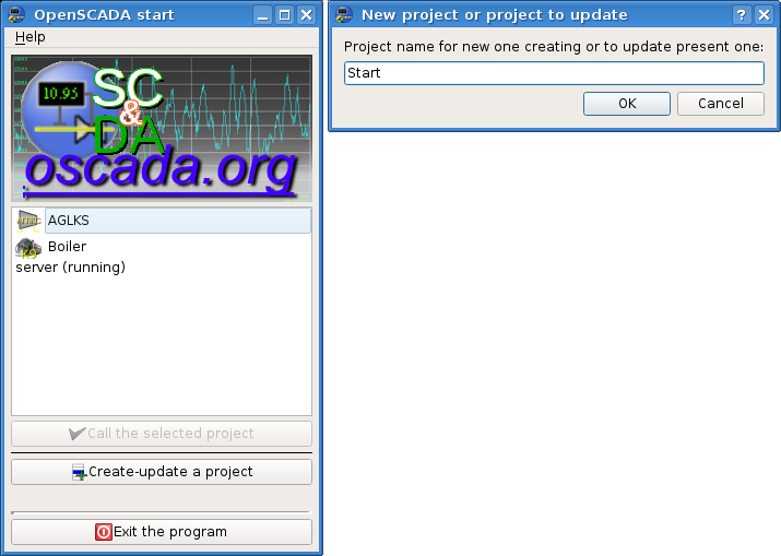

3.3 Your own project creation
In the window of the OpenSCADA project manager (Fig.3.3) we will create our own project, which can be called from the desktop environment menu in the "Graphics" section, the general item "Open SCADA system" with the characteristic icon (Fig.3.1.1) or the command from the console-terminal:
openscada
Fig. 3.3. Window of the project manager of OpenSCADA.
In this window we can also check the background execution of server and demo configurations.
That is, press the corresponding Create-update project button and enter the name of the new project — Start.
At.png When you want to check yourself for some problems or other reasons, you may download backup of the already ready OpenSCADA "Start" project and restore it by context menu in the same window Figure 3.3. You have to place the backup file in directory of OpenSCADA user projects — "~/.openscada/", like to from the console-terminal:
wget http://ftp.oscada.org/OpenSCADA/Projects/Start_QuickStart.backup -P ~/.openscada/

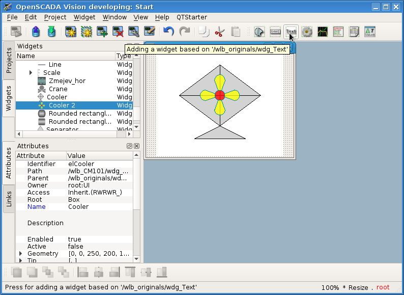

On configuration page of the UI.Vision visualizer (Fig.3.3.1.2) we will select:
Fig. 3.3.1.2. Configuration page of the visualizer UI.Vision.
The next launch of the UI.Vision module by the second end icon on the toolbar above should lead the visual development environment to a connection to the visualization project of the background demon project. Where you can perform remote development (fig.3.3.1.3) and run projects from this visualization server for execution (Fig.3.3.1.4).
Fig. 3.3.1.3. Screen of the remote development of UI.Vision for the visualizer server "AGLKS".
Fig. 3.3.1.4. Screen of the remote execution of UI.Vision for the visualizer server "AGLKS".

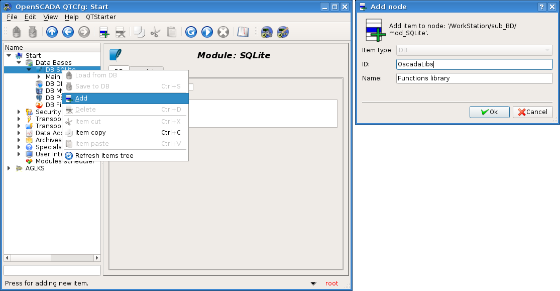

3.3.2 Connecting the standard OpenSCADA libraries
The newly-created OpenSCADA project does not contain any specific configuration, in fact it is empty and provides for the user to create a new configuration in the local SQLite database file "St.db", which is located in its own directory of the project with the same name. It is easier to create a complex project of the SCADA system using libraries of functions of the API of the OpenSCADA object model and libraries of the graphical elements, as well as other OpenSCADA libraries. To use the OpenSCADA libraries you need database files where the libraries are stored: connect-add in the object of the database module "SQLite" (Fig.3.3.2.1), install-select the address and specify the database encoding in "UTF-8" (Fig.3.3.2.2). At.png After what, or when there are already library database entries, you need to activate need ones, read on.
Fig. 3.3.2.1. Addition of an object of the DB "SQLite".
Fig. 3.3.2.2. The DB "SQLite" object of the OpenSCADA library.

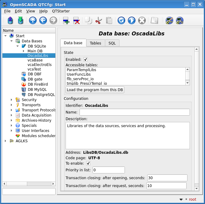

OpenSCADA distributions are supplied with a number of libraries in form the database files "SQLite" (table 3.3.2), which, when started-created a custom project, are located in the "LibsDB/" directory. According to this list we add, or use the ready entries, in the object of the database module "SQLite" for need libraries, we set the sign "To enable" and save. Next, to download the contents of the libraries you can enable the database and click on the button "Load the program from this DB", however, when loaded, a number of new objects are not enabled, so it's easier to exit the new project and run it again.
Table 3.3.2. OpenSCADA libraries included in the distribution.
Identifier Name Address Languages/charset Description
OscadaLibs OpenSCADA libraries LibsDB/OscadaLibs.db EN,UK,RU/UTF-8 Libraries of the data sources, services and processing.
vcaBase VCA: Main libraries LibsDB/vcaBase.db EN,UK,RU/UTF-8 Graphical elements' libraries of the OpenSCADA module UI.VCAEngine.
vcaTest VCA: Tests LibsDB/vcaTest.db EN,UK,RU/UTF-8 Graphical elements' tests library.
vcaElectroEls VCA: Electrical elements library of the user interface LibsDB/vcaElectroEls.db EN,UK,RU/UTF-8 Provides the mnemonic elements library of the user interface of the electrical substations and the electricity generation station.
As a result of adding OpenSCADA libraries you will get an environment ready for adding data sources, defining their history and forming the interface of your own SCADA-system project.

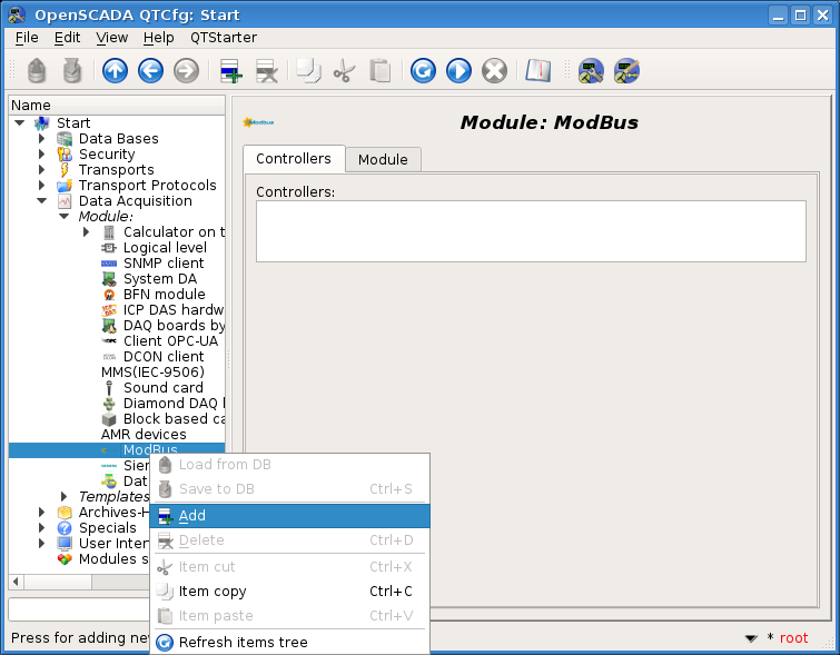

To acquire data by the ModBus protocol in OpenSCADA, there the ModBus module of the subsystem "Data Acquisition" is provided. To add a new controller object in the configurator, open the module page ModBus "Start"->"Data Acquisition"->"Module"->"ModBus" and press "Add" in the "ModBus" item's context menu (Fig.4.1.1).

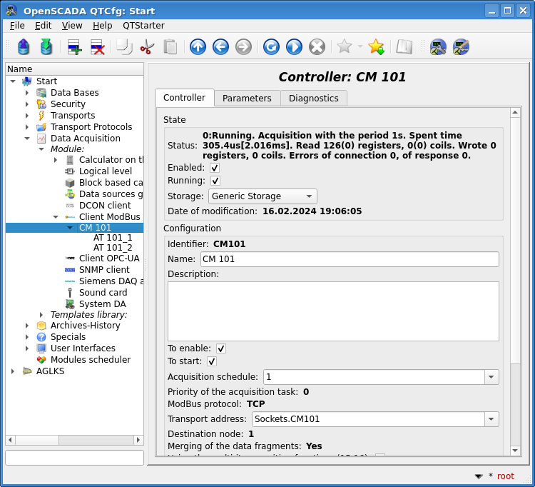

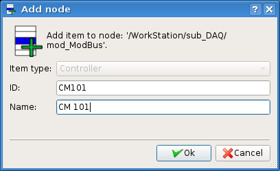

Fig. 4.1.1. Adding a controller object in the "ModBus" module of the "Data acquisition" subsystem.
As a result, a dialog box (Fig.4.1.2) will appear asking you to enter identifier and name of the new controller object. Identifiers of OpenSCADA objects are limited in size to 20 characters and it is recommended that they be entered with the characters of the English alphabet and numbers. In addition, it is desirable to start the identifier from letter, which will simplify its use in internal procedures. Names of OpenSCADA objects are limited in 50 characters, which can be any. Names are usually used to display and when it is empty, the identifier will be used. In further we can change the name in the object configuration, but the identifier can not be changed directly; however, the object can be cut (Ctrl+X) and then paste (Ctrl+V), renaming it. Enter according to the remarks earlier the ID CM101, the name "CM 101" — "CM101 (CM 101)".
Fig. 4.1.2. Dialog of specifying the identifier and name of the new object.

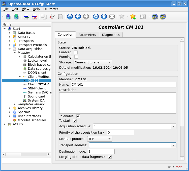

After confirmation we will have the new controller object. Let's select it in the configurator and familiar the settings (fig.4.1.3).
Fig. 4.1.3. Main tab of settings of the controller object of the ModBus module.
Configuring the controller object is usually specific to different types of data sources and protocols. For details of settings of the controller object of the module ModBus see to the link. We will consider the general and key settings of this module.
Before configuring communication with your controller it is necessary, from the documentation for this controller, to find out the settings of its network interfaces and protocols as well as, in the case of using ModBus, get a table of assigning external and internal signals of the controller to the numbers of the ModBus registers — the registers map.
Using the controller object page, in the "State" section you can first estimate the current status of the controller object and the actual state of communication with the physical controller and also change them quickly. That is, the "Status" field contains error code and text description of the current state of communication with the controller. In our case, the controller object is disabled. We can enable and run it by installing signs in front of the appropriate fields. Enabled controller object initiates parameters, running one launches a task of acquisition (separate thread to the controller object) also and provides the ability to transfer data to the controller through attributes of the parameters. The "Storage" field indicates the storage in which the configuration of the object is stored. We will arrange storage in the Generic Storage, that is, leave this field default.
In the "Configuration" section, the configuration of the controller object is directly located. Set the following ones leaving everything else unchanged:
Save our changes in the storage by clicking the second left icon on the toolbar.

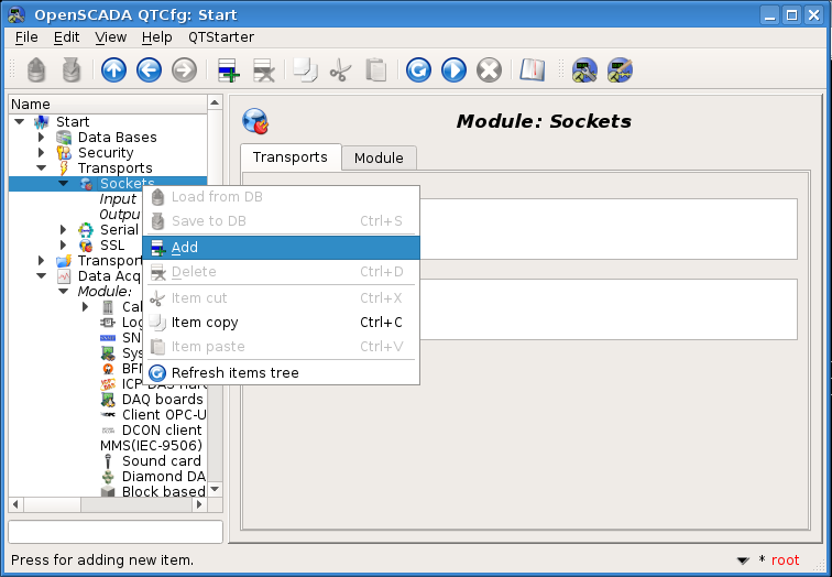

Now, in the same manner as the controller object, let's create the outgoing transport in the module "Sockets" ("Start"->"Transports"->"Sockets") through the context menu (Fig.4.1.4) and call the transport as well as the controller object "CM101 (CM 101)". Please note, that in the "Item type" field of the dialog of entry identifier and name (Fig.4.1.2) you have to select "Output transport"!
Fig. 4.1.4. Adding the output transport in the module "Sockets" of the subsystem "Transports".
Configuration page of the output transport is shown in Figure 4.1.5. This page also contains section of the status and operational control. In the "Status" field the textual description of the current state of the transport is contained. We can connect it by checking the box in front of the appropriate field. The field "Storage" indicates the object configuration storage — we will use the "Generic Storage".
Fig. 4.1.5. Configuration page of the output transport of the module "Sockets" of the subsystem "Transports".
The "Configuration" section directly contains the main configuration of the transport object, let's set the following ones:
Other types of the transports are created similar to the considered for "Sockets" method and their configuration usually differs only in the format of the address and timeouts in the tab "Additional". For converters USB->Serial,Modem that address you may learn in the operation system, for example by the console command dmesg just after its connection.

Configuration the controller object is finished — enable its by setting the flag "Enabled". The next step is configuration and choosing the data you need to query from the controller. This setting is done by creating a parameter of the controller. The parameter allows you to describe list of data obtained from the controller and to transmit them to the environment of OpenSCADA — the data model.

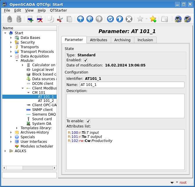

To add a new parameter we open the page of our controller object and on the popup menu of the item "CM 101" we'll click "Add" — we'll name "AT101_1 (AT 101_1)".
The configuration page of the obtained parameter is shown in Figure 4.1.6. This page contains the section of status and operational control. In the "Type" field it is contained the parameter type, in this case it is the type "Standard". We enable this parameter by setting a sign opposite the corresponding field. The enabled parameter is involved in the process of exchanging with the controller.
Fig. 4.1.6. Configuration page of the controller parameter "ModBUS".
The "Configuration" section directly contains the configuration of the parameter. Set the following ones, leaving everything else unchanged:
R:100:r:Ti:T input
R:101:r:To:T output
R:102:rw:Cw:Productivity
In the same way we'll create, or copy from AT101_1, the second parameter "AT101_2 (AT 101_2)" — list of attributes for its we'll establish in:
R:103:r:Ti:T input
R:104:r:To:T output
R:105:rw:Cw:Productivity

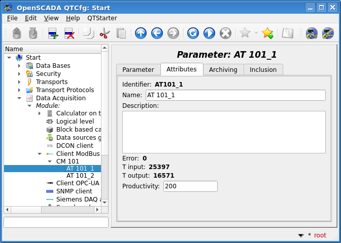

Save both the parameters. Now we can start our controller object for acquisition, for that we'll return to its page and in the section "Status" set the sign "Running". If we do not miss anything, then the exchange will start successfully and in the "Status" field we get similar presentation as shown in Figure 4.1.7.
Fig. 4.1.7. Page of the controller object when it is successfully exchanged with the physical controller.
In the case of the successful exchanging with the physical controller, we obtain also the described data of the controller in the infrastructure of OpenSCADA — the data model. You can see these data in the "Attributes" tab of our parameters AT101_1 (Fig.4.1.8) and AT101_2. Due to the acquisition is done regularly and periodically per one second, then we can observe their change by clicking on the "Refresh current page" button in toolbar.
Fig. 4.1.8. Page of the described attributes of the AT101_1 parameter.

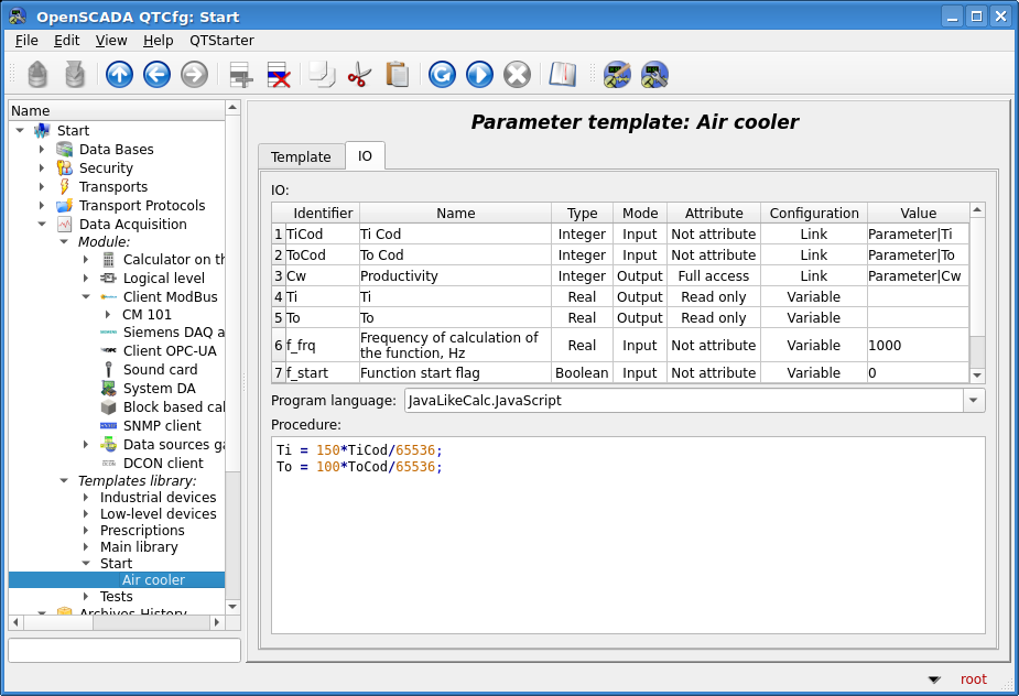

To perform the calculation, in the Logical Level module you must firstly create a template library of our project and a parameter template of the DAQ-Subsystem in it. To create a template library go to the page of the DAQ-Subsystem and, through the context menu, create a template library start (Start). The configuration page of the obtained object of the template library (Fig.4.2.1) contains the "State" section of the status and operative control, and the "Configuration" section that contains only the default configuration fields and which will remain unchanged. In general we have:

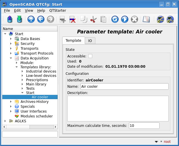

Fig. 4.2.1. Configuration page of the object of the template library.

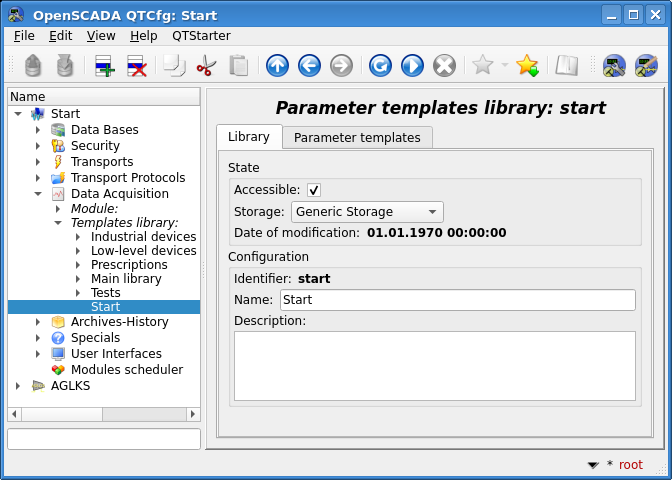

To create a template, open the page of the newly created template library "Start"->"Data Acquisition"->"Templates library"->"Start" and, through the context menu, create an object of the template airCooler (Air cooler). The configuration page of the obtained object of the template (Fig.4.2.2) contains the "State" section of status and operative control, and the "Configuration" section, that contains only the default configuration fields and which will remain unchanged. In general, we have:
Fig. 4.2.2. Configuration page of the template object.
Main configuration and formation the parameter template of data acquisition is made in the tab "IO" (Fig.4.2.3) of the template. Detailed description of the process of the template formation can be found at link.
In the template we will create two IO for inputs ("TiCod", "ToCod"), two for output ("Ti", "To") and one transparent ("Cw"). For the IO "TiCod", "ToCod" and "Cw" we will set the "Configuration" sign in Link, which will allow them to be linked with the "raw" sources. Will set the sign "Attribute" for the IO "Ti" and "To" to Read only, for "Cw" to Full access — to form three attributes in the data acquisition parameter: two is on read only and one on full access.
Set the language of the program in JavaLikeCalc.JavaScript and the program in:
Ti = 150*TiCod/65536;
To = 100*ToCod/65536;
Fig. 4.2.3. Tab "IO" of the configuration page of the template object.
Save the obtained template and establish a sign of accessibility (Fig.4.2.2).

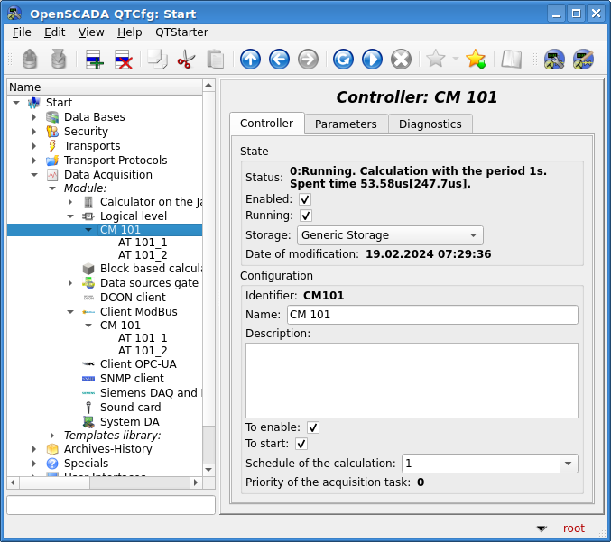

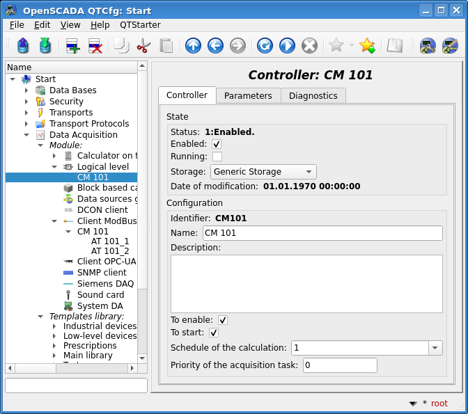

Now we will create objects of the controller and parameters in the LogicLev module of the DAQ-Subsystem. Object of the LogicLev controller and its parameters are created identically to the ModBus module earlier on the page "Start"->"Data Acquisition"->"Module"->"Logical Level". We name them identical to the objects of the module ModBus.
The controller object of the module LogicLev (Fig.4.2.4) has no specific settings and the default ones may not be touched except the "Schedule of the calculation" field, which will install in 1 (one) second. Before adding parameters you must turn on the controller object — set the "Enabled" flag.
Fig. 4.2.4. Main configuration tab of the controller object of the module LogicLev.
Parameter of the controller object of the LogicLev module (Fig.4.2.5) has the specific setting "Type", where you need to set "Logical", and select the template address, we have just created, in the field "Parameter template".
Fig. 4.2.5. Configuration page of the parameter of the controller object of the module LogicLev.

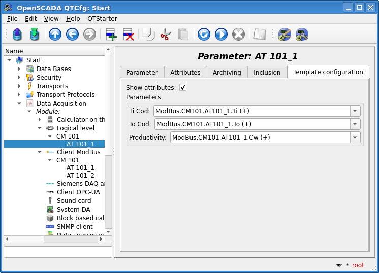

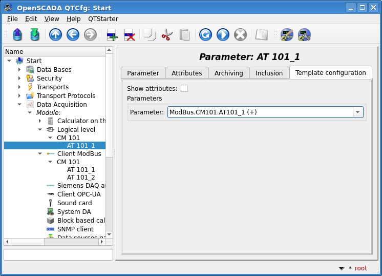

In addition to the basic configuration of the parameter it is necessary to configure the attached template (Fig.4.2.6). Configuration tab of the template appears in the parameter's mode "Enabled". To enable the parameter it is possible by the previously enabling the controller object. The flag "Show attributes" allows you to set apart each link (Fig.4.2.7). Since we in the template forcibly described the links format as "Parameter|Ti", we can establish all three links by simply pointing the address to the parameter in the controller object ModBus. Specify-select the address "ModBus.CM101.AT101_1" and "ModBus.CM101.AT101_2" in the appropriate parameters.
It should be noted that all the fields for entering object addresses in OpenSCADA have a mechanism for selecting the address. This mechanism involves element-by-element selection, during which movement in depth occurs. For example, at the beginning of the address "ModBus.CM101.AT101_1" set we will have an option of choosing the data source type, among which will be "ModBus"; after choosing which controller objects of the ModBus module will be added to the list of available selection elements where "ModBus.CM101" will be; selecting the element "ModBus.CM101" will add controller parameters and so on to the final element according to the object hierarchy. For possibility of returning to the level above, the elements of all the higher levels from the current address value are inserted into the list of choice.
Fig. 4.2.6. Tab "Template configuration" of the page of the LogicLev controller parameter.
Fig. 4.2.7. Tab "Template configuration" of the page of the LogicLev controller parameter with unrolling the links.

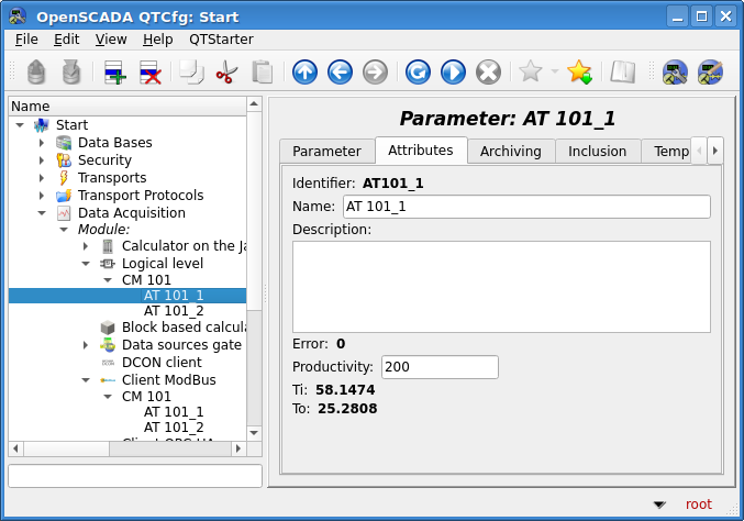

Let's save the created objects of the controller and parameters, after which we will start up the controller object by setting the "Running" sign in the "State" section. If we do not miss something, the calculation is successfully started and in the "Status" we'll get something like to Figure 4.2.8.
Fig. 4.2.8. Page of the controller object when its calculation in the LogicLev module is successful.
In the case of successful processing the template code in the parameters, we'll obtain the processed data in the infrastructure (the data model) of OpenSCADA. You can see these data on the "Attributes" tab of our parameters AT101_1 (Fig.4.2.9) and AT101_2.
Fig. 4.2.9. Page of attributes of the parameter AT101_1 of the LogicLev module.

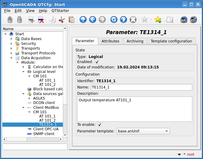

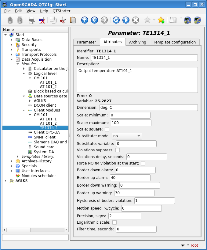

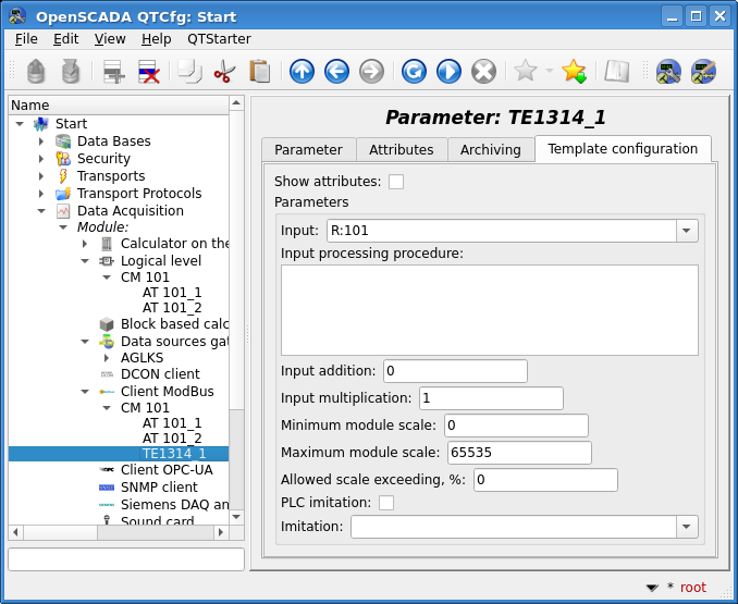

We name the analog parameter — TE1314_1 (TE1314_1) (Fig.4.3.1). The parameter type set to "Logical", the parameter template select in "base.anUnif", the description set in "Output temperature AT101_1", set the flags "To enable" and "Enabled". Next, we need to configure:
Fig. 4.3.1. Page of the logical parameter TE1314_1 of the module ModBus.
Fig. 4.3.2. Tab "Template configuration" of the parameter TE1314_1 of the module ModBus.
Fig. 4.3.3. Tab "Attributes" of the parameter TE1314_1 of the module ModBus.

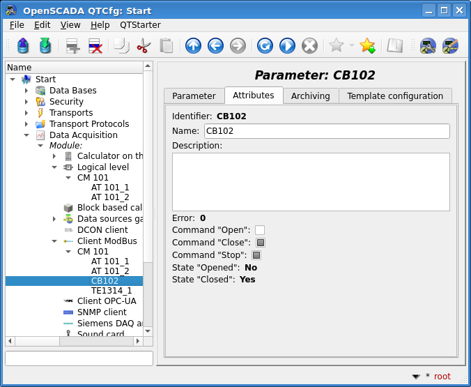

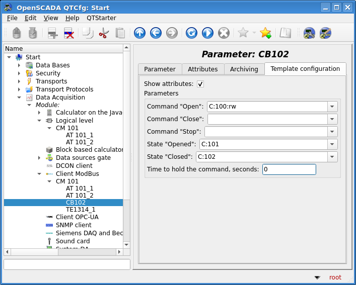

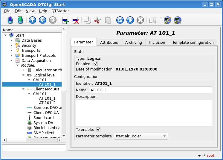

We name the discrete parameter — CB102 (CB102). The parameter type set to "Logical", the parameter template select in "base.digitBlockUnif", set the flags "To enable" and "Enabled". Next, we need to configure:
Fig. 4.3.4. Tab "Template configuration" of the parameter CB102 of the module ModBus.
Fig. 4.3.5. Tab "Attributes" of the parameter CB102 of the module ModBus.

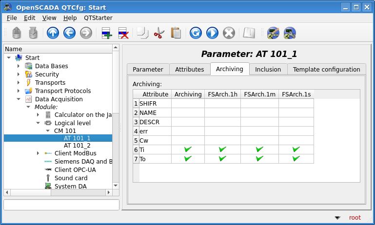

To enable the archiving of the attributes "Ti" and "To" of the AT101_1 and AT101_2 parameters in the previously created controller of the LogicLev module, it is enough on the "Archiving" tab of the configuration page to choose which attributes are to be archived and by what archivers (Fig.4.5.2). We'll choose the archiving of "Ti" and "To" attributes by the previously created archivers FSArch.1s, FSArch.1m, FSArch.1h. The same thing we do for the attribute "var" of the analog parameter ModBus.CM101.TE1314_1 and for "com" of the digital parameter ModBus.CM101.CB102.
Fig. 4.5.2. Tab "Archiving" of the AT101_1 parameter of the LogicLev module.

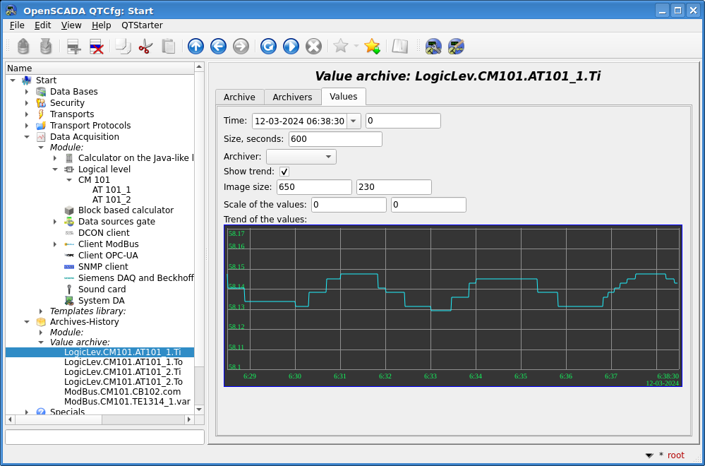

As a result of this operation, archival objects for the selected attributes will be created automatically. An example of the archive object for the attribute "Ti" of the parameter AT101_1 is shown in Figure 4.5.3.
Fig. 4.5.3. Page of the archive object of the "Ti" attribute of the AT101_1 parameter.
Usually the settings of the archive do not need to be changed, but if you need special configuration, it can be done on the aforesaid page. Often you may need to obtain the information about the archive. For example, find out the archive size both in time and on the storage, as well as look at the graph of the parameter (Fig.4.5.4).
Fig. 4.5.4. Tab "Values" of the archive object page of the "Ti" attribute of the AT101_1 parameter.

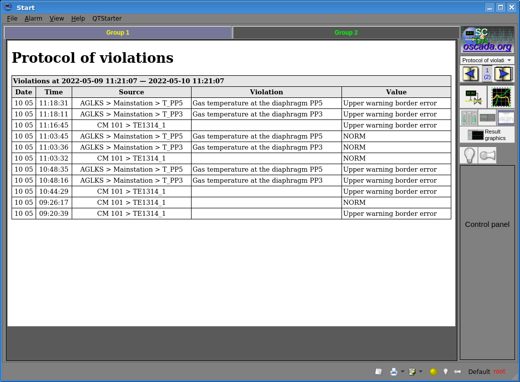

The controller objects, as well as individual parameter templates, can generate alert messages, for example — complex signal-tag templates generating messages when output values over one of the borders. Messages of this nature have a specific category and are called violations.
OpenSCADA messages previously come to the message buffer, which acts as the primary archive. However, the buffer has a limit and is stored only in RAM, that is, it is lost when the program is restarted. Role of storing messages in one or another storage is performed by the message archivers, as the value archivers for the values.
Accordingly we will create a message archiver for archiving of violations, for which we will open the archiving module page "Start"->"Archives-History"->"Module"->"Archiver on the file system" and through the context menu we will create an object of the message archiver alarms (Alarms). Note the value of the "Item type" field in the creation dialog, which should be the Message archiver! Configuration page of the resulting object of the message archiver (Figure 4.5.5) contains the "State" section of status and operative control, the configuration section "Configuration" and the "Additional options" section of specific settings of the archiver module. In general we have:
  • start the archiver for execution — set the sign opposite the corresponding field, only running archiver performs the archiving;
At.png Set last and after the execution of all this list.
  • specify the storage — leave the "Generic Storage" of the project;
  • we can control the time of the first and last message in the archive of this archiver;
  • we can control the total archive files size of this archiver;
  • we can control the current and maximum time of the archiving session.
  • set starting the archiver when the program is started — set the sign opposite the corresponding field;
  • set category of messages that characterises the violations — "al*";
  • set level of archived violations — "Information (1[X])";
  • set address of the archive folder — "ARCHIVES/MESS/alarms", which is by default;
Fig. 4.5.5. Configuration the message archiver "alarms" to the file system.
In the same way you can create message archivers of different nature, for example — the operator actions. For which it is enough to define the category of these messages and to form for them a template or regular expression rule. You can obtain the standard categories and their templates, or regular expression rules, on the message archiving page; or can study real messages on the main page of the subsystem "Archives-History", obtain here for information on categories and set up a template or regular expression rule. You can even create an archiver to archive all program messages, but doing so is not recommended because of large archives size and long access to them later.

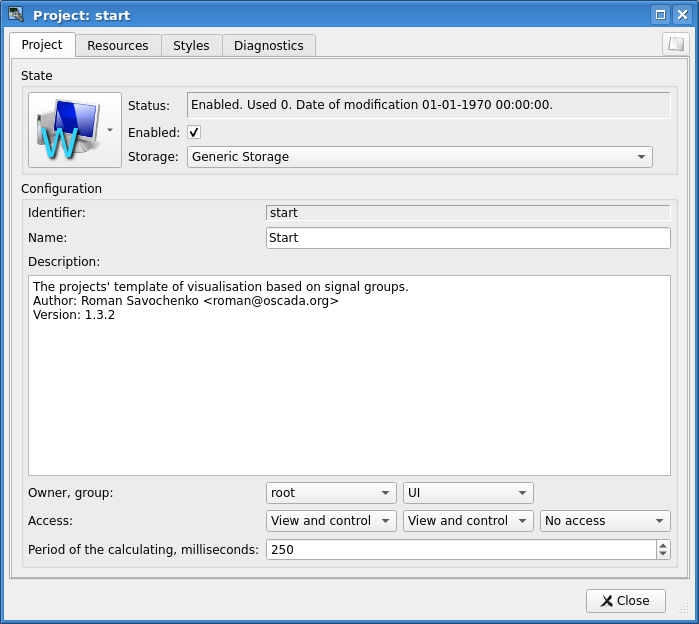

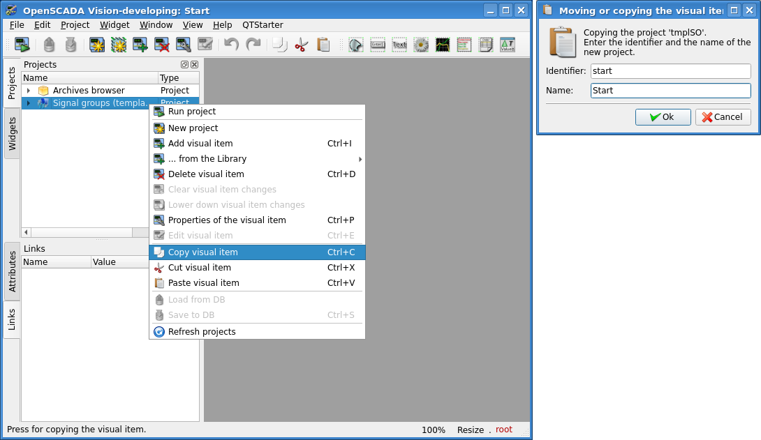

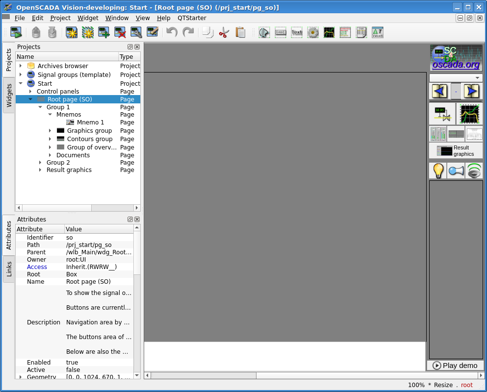

Copy the project "Signal groups (template)" by first clicking the button "Copy the visual item" on it and then the button Paste the visual item (Fig.5.1). In the dialogue we will call our new project start (Start) and in the project list we will get an item of our new project (Fig.5.1).
Fig. 5.1. Copying the template project to new one.
Before using and saving the new project (Fig.5.3) you need to change its storage to the "Generic Storage", that we can do on the main page of the properties dialog of the visual element, that is called by the the button "Properties of the visual item" (Fig.5.2). After that we will save our new project by clicking the third button on the left of the toolbar.
Fig. 5.2. Properties of the new project based on the template.
The template project (Fig.5.3) contains two branches — "Control panels" and "Root page". The branch "Control panels" contains typical control panels and set of the special frames. The branch "Root page", with the root page basis, contain subbranches for the signal objects "Group 1", "Group 2" and different branch "Result graphics". The signal object's subbranches "Group {n}" have a number identifier and can be expanded by appending up to so many, how many names will fit at the top in two rows. Presence of the grub "Group {n}" is reflected by activating the corresponding button of the signal object of the root page, allowing them to switch. Every subbranch "Group {n}" has containers or templates for display views, typically: "Mnemo", "Graphics groups", "Contours groups", "Groups of overview frames" and "Documents". Presence of pages in containers of the display views enables the selection possibility for the corresponding signal object of the root page. More information about the structure of the root page can be found at the link.
Fig. 5.3. Template project based on the concept of signalling objects.

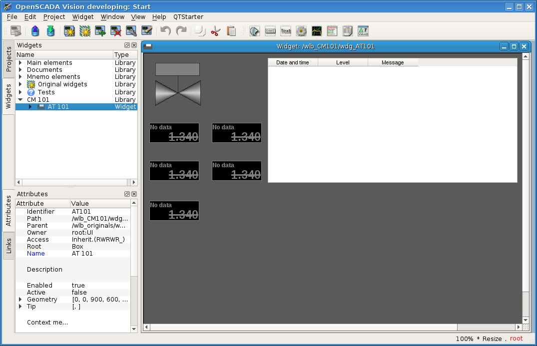

5.1 Adding the template page and connecting the dynamics
Let's examine tasks of the first level complexity, when in the already designed interface conception it is necessary to link the dynamics to the template page. The "Template page" idea means a page on the basis and with the help of inheritance there can be created a lot of final visualisation pages with individual list of the dynamics. Examples of these pages are: "Graphics group", "Contours group", "Overview frames panel" and "Result graphics". In Figure 5.1.1 the template page "Graphics group" is presented in the tree of our project "Start".

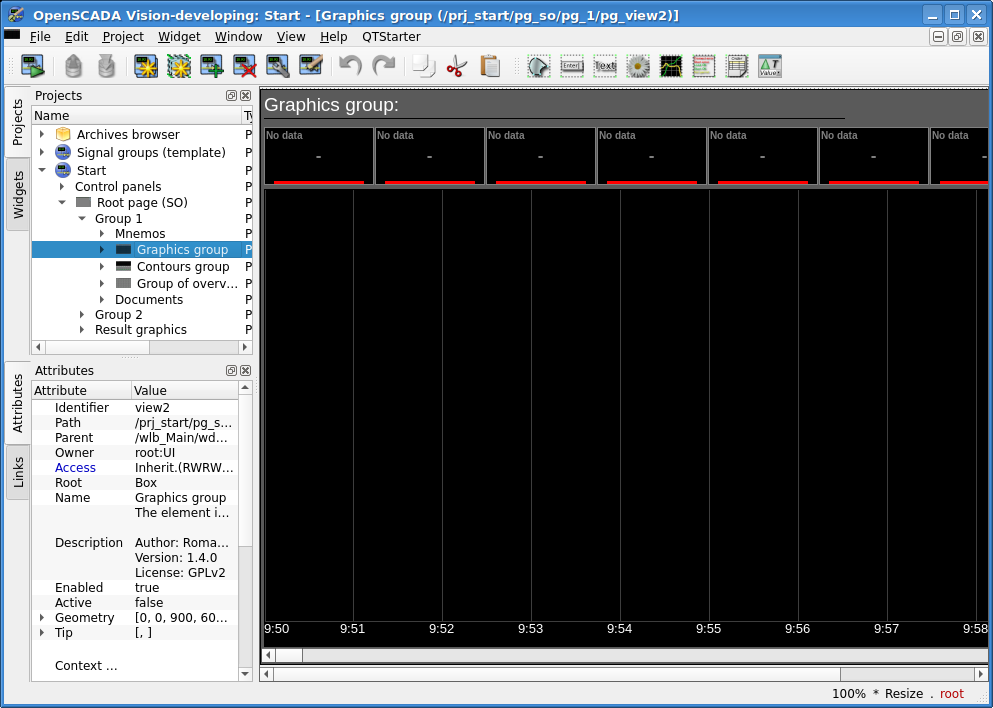

Fig. 5.1.1. Template page "Graphics group".
The template page "Graphics group" provides an opportunity to link up to eight signals for simultaneous display them on the graphs. Elements at the top will automatically hide for unspecified links.

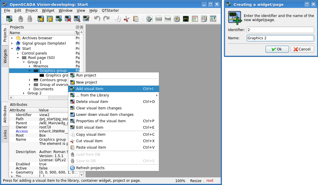

Let's create a new graphics group in the template container "Graphics group" of the first group of the root page. For that select the menu item "Add visual item" in the context menu of the item "Graphics group" (Fig.5.1.2), then enter ID "2" and name "Graphics 2" — 2 (Graphics 2).
Fig. 5.1.2. Adding the graphs group "Graphics 2".
After confirming the name entry, a new page will be created, however, for activation we need to enable it. You can enable this page in dialog of the properties editing of the page (Fig.5.1.3). To open this page it is possible by selecting the menu item "Properties of the visual item" in the context menu of the newly created page. You can create the page in the logical container based on the template by copying the template to yourself, as well as copying another page of this container, but also with links.
Fig. 5.1.3. Dialogue of the properties editing of the visual element.

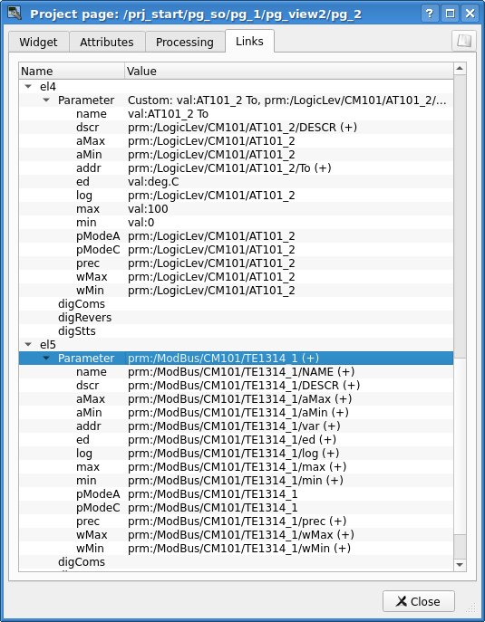

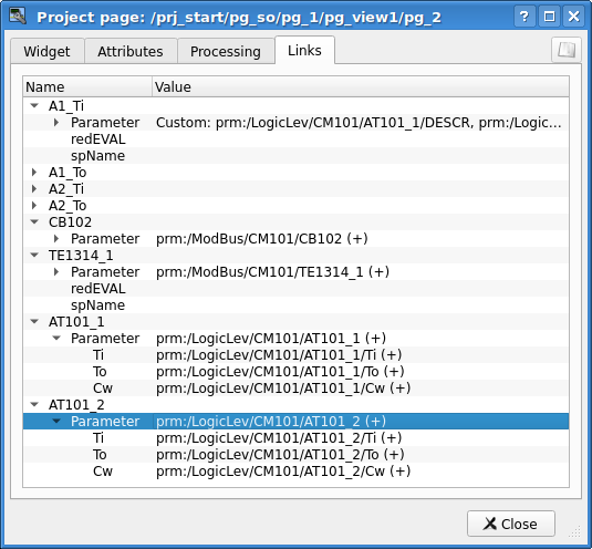

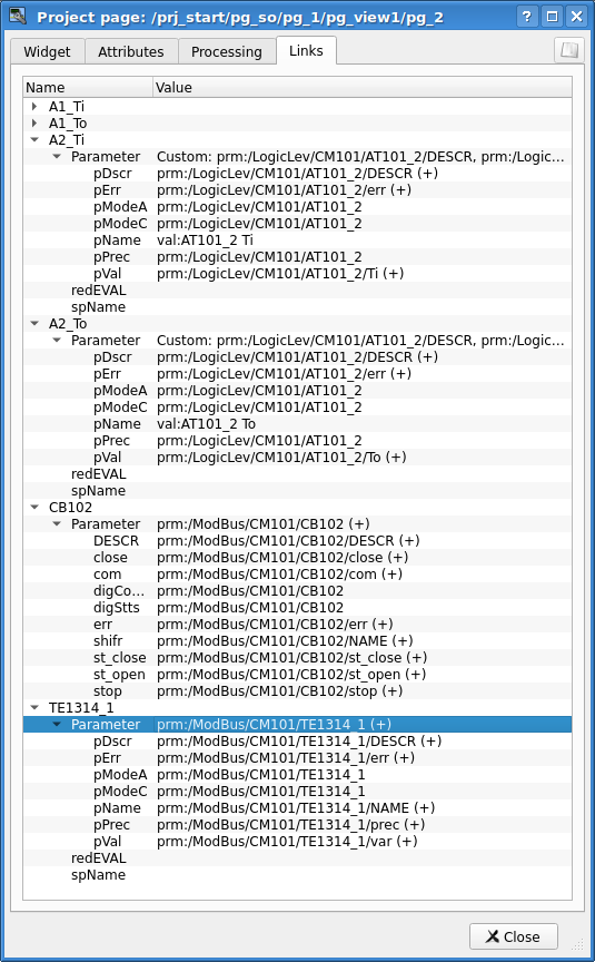

After enabling the page you are ready to set links to the early created parameters of the controllers. To do this, without leaving the dialog of the properties edition of the newly created page (Fig.5.1.3), click on the tab "Links" (Fig.5.1.4). On this tab we can see a tree with the elements "el1" ... "el8". Expand any of the element we'll see the branch "Parameter" and exactly in it we have to specify or choose the address of our attributes "Ti" and "To". In general we fill out four elements and during this part of the properties you must specify as constants:
If the template of the controller parameter predicts in advance the attributes presence, specified as constants, then only the parameter can be specified and the attributes are arranged automatically. This can be seen by attaching the previously created complex object-tag of the analog signal ModBus.CM101.TE1314_1.
Fig. 5.1.4. Tab "Links" of the dialog of edition of the properties of the visual item.

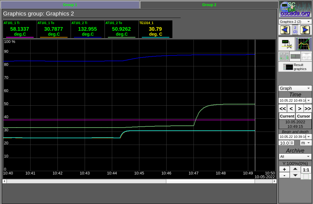

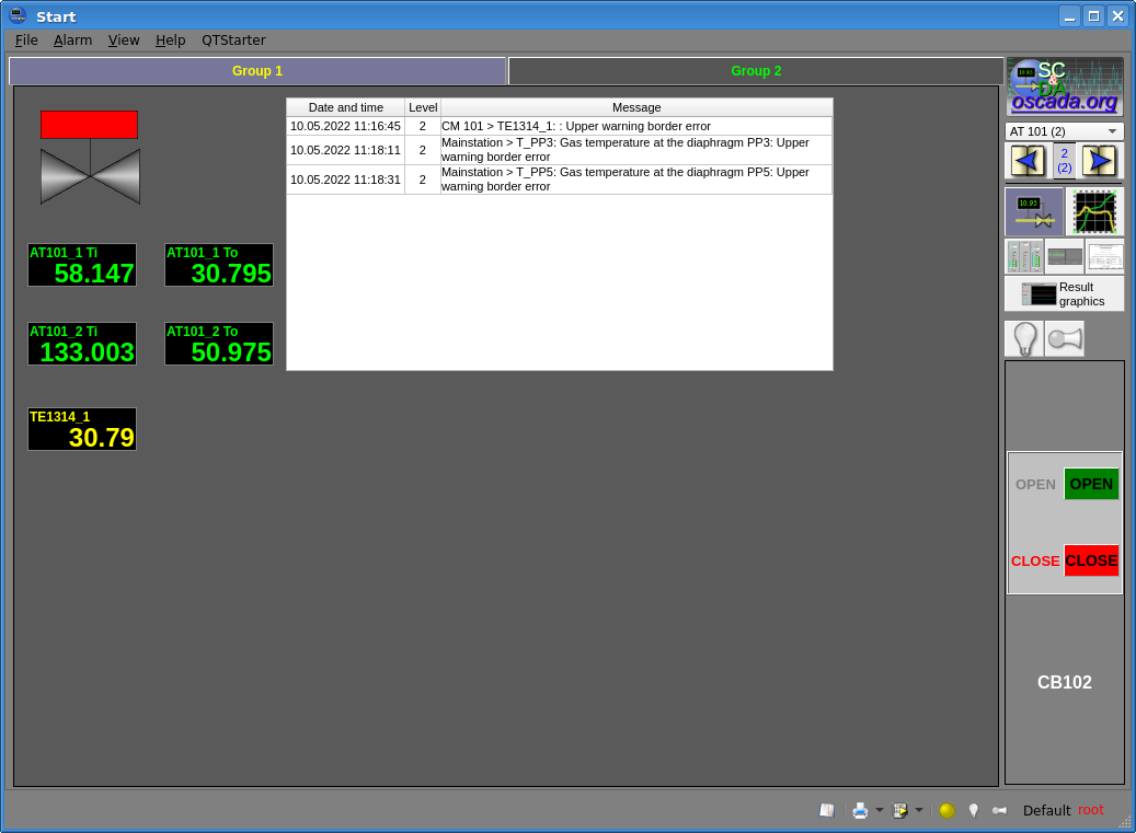

After completing the linking we can check result of our efforts, to do this we'll close the editing properties dialog and run the project "Start" for execution — about the run button we remember from the previous sections. Next choose the graphics and switch to the second page. With error-free configuration we should see something similar to that shown in Figure 5.1.5. Note that for the parameter of the complex object-tag with the established limits of violations, the output value beyond the boundary is marked by an emergency color. In order to see the violation abroad you can set the value of the fan's performance in 100 (Fig.4.2.9).
Fig. 5.1.5. Graphs group with connecting of four signals and one parameter of the object-tag.

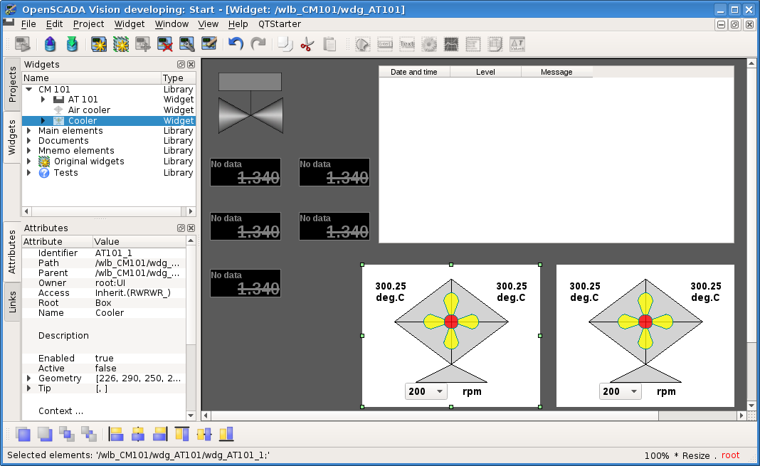

5.2 Creating a new frame — mnemonic schemes
Let's raise the level and create a new frame, on which we'll put the basic displaying elements of values of our controller parameters. Such frames are usually called the mnemonic schemes and in addition to the dynamics displaying, and even in the first place, contain a static image of the technological process in the mnemonic representation. We are not going to focus on static creation and will add the dynamic elements and link them to the parameters of our controllers. And we'll put the created frame to the tree of our project.

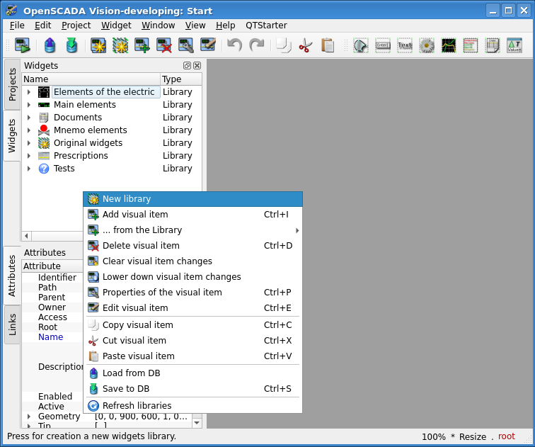

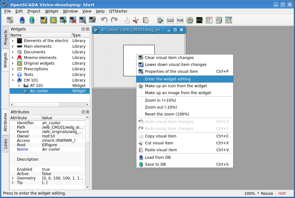

New frames, destined later to be placed in the project, are to be created and changed in a widget library. Create the new widget library by selecting the vertical tab "Widgets" and in the context menu of the window of the widget libraries select the menu item "New Library" (Fig.5.2.1). In the dialog of entering the name we'll specify — CM101 (CM 101).
Fig. 5.2.1. Adding new widget library.

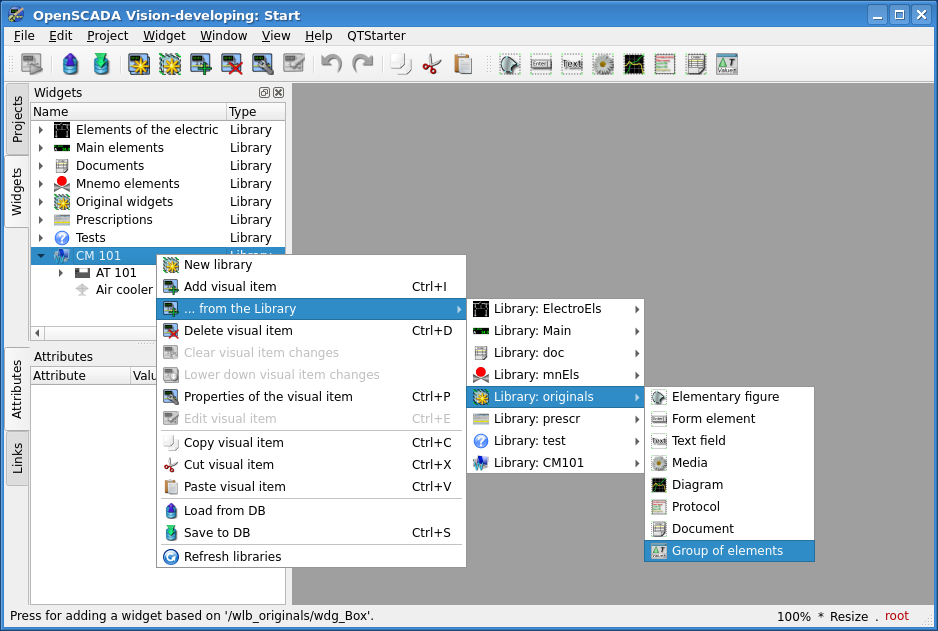

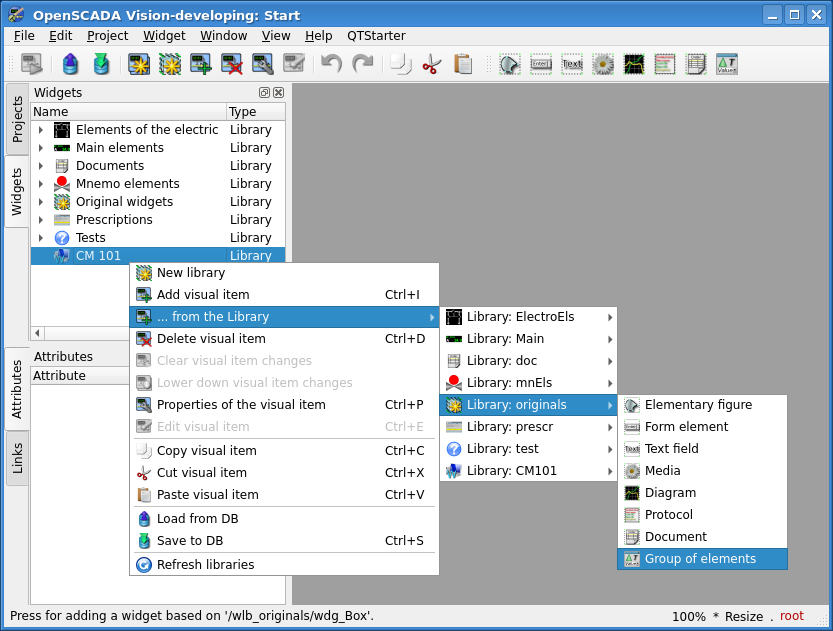

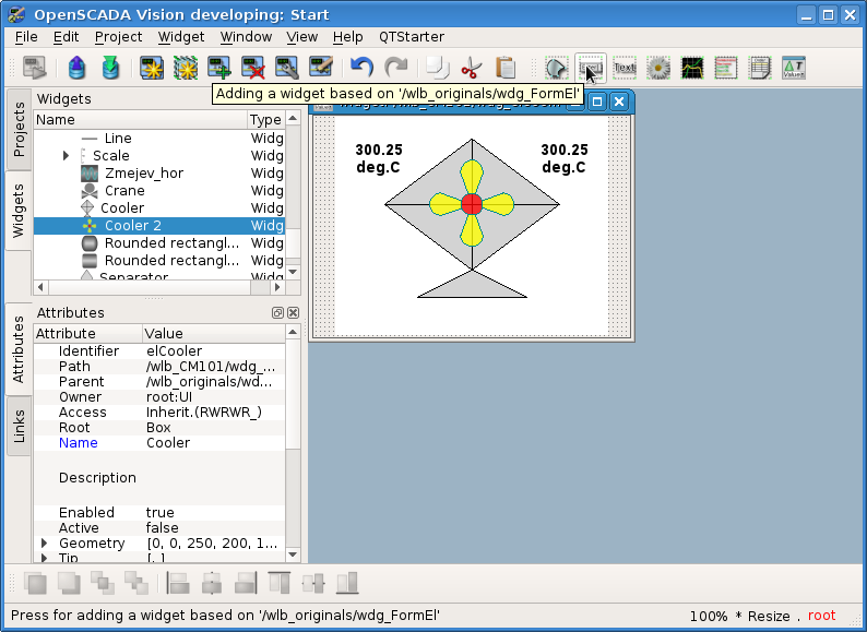

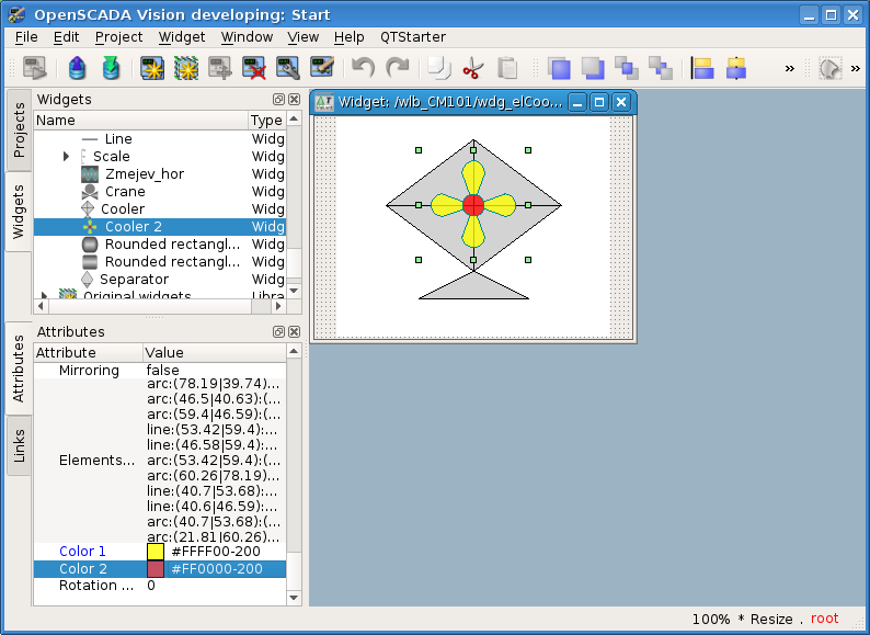

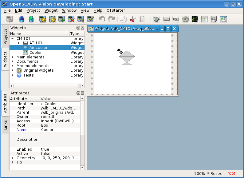

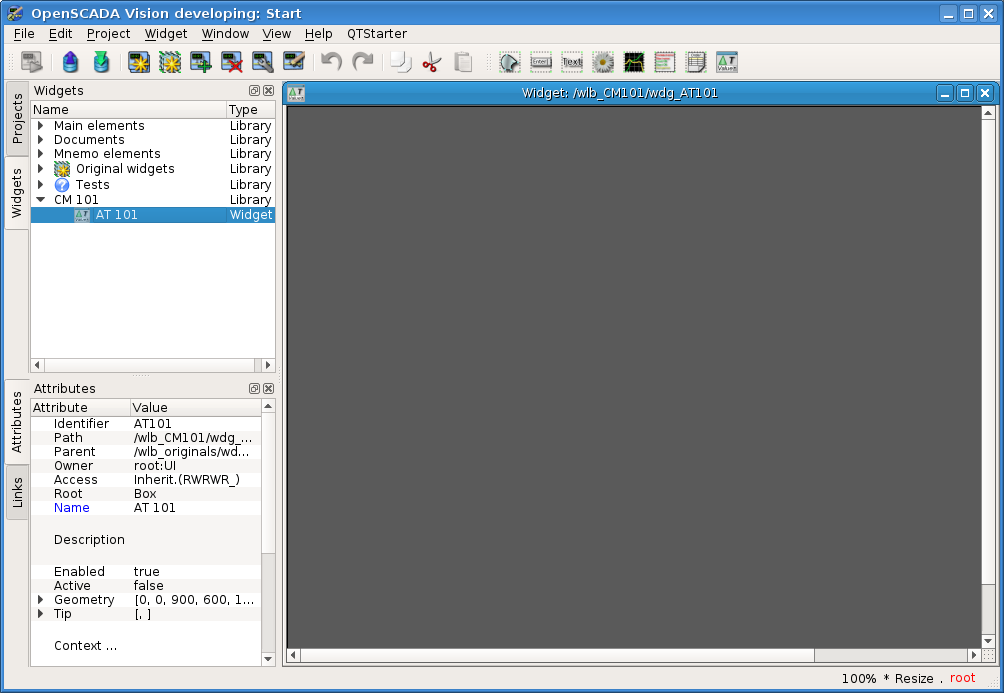

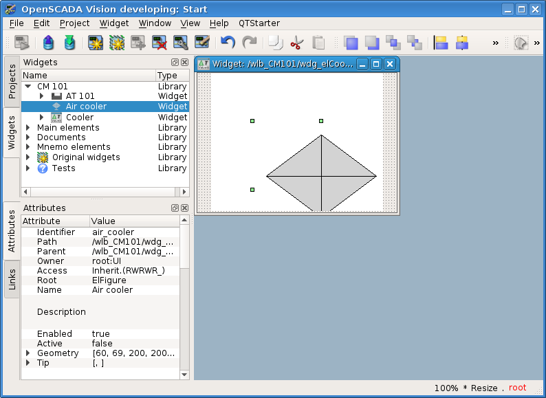

Next we'll add a new frame by selecting "... from the Library"->"Library: originals"->"Group of elements" (Fig.5.2.2) in the context menu of the created library "CM 101". In the dialog of entering the name we'll specify AT101 (AT 101). In the basis of any frame and page must lay the primitive "Group of elements (Box)", and therefore we have chosen it.
Fig. 5.2.2. Adding new frame.

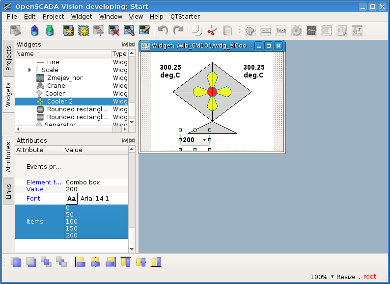

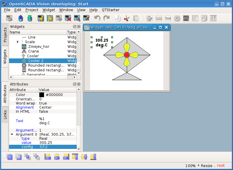

Immediately after creation the new frame it is necessary to set its basic properties, characteristic to the mnemonic scheme frame. Properties or attributes of any visual element can be specified in the toolbar "Attributes", pre-selecting the desired visual element. Let's select the created frame "AT 101" and set the following properties:
As a result we get an empty frame (Fig.5.2.3), ready to add elements to it. To visual edit or review the frame you should select the menu item "Visual item edit" of the frame's context menu.
Fig. 5.2.3. View of the new frame and the set attributes of the mnemonic scheme.

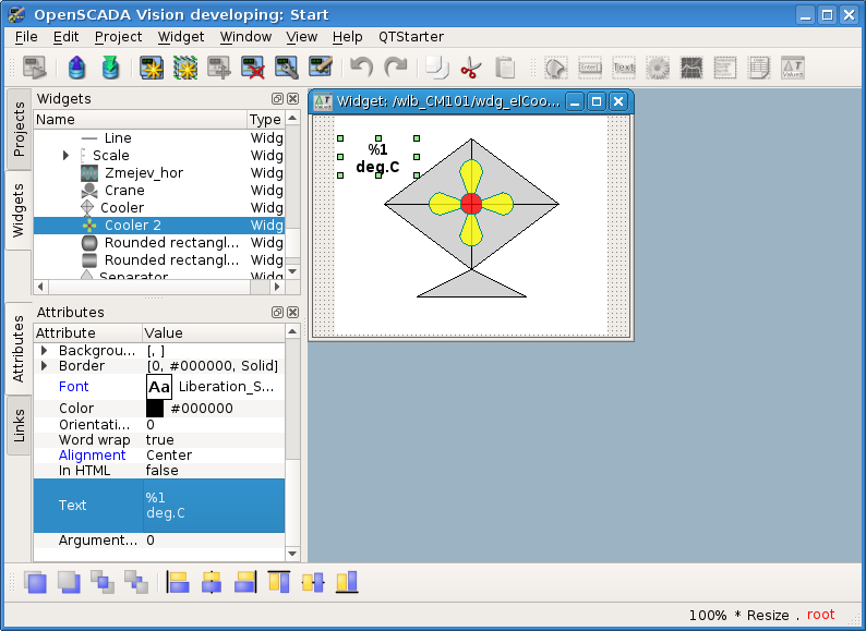

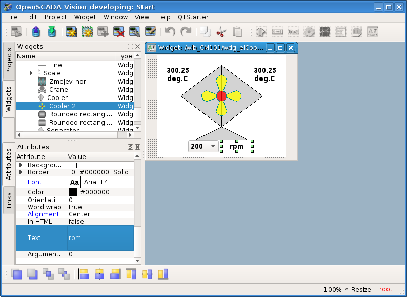

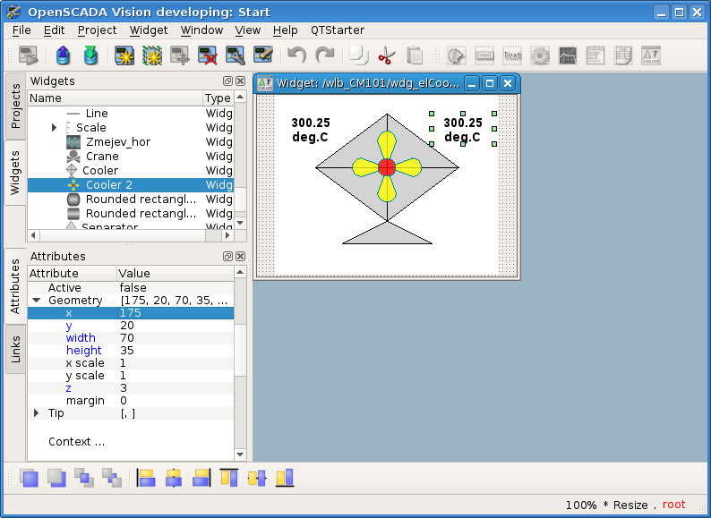

Now, to the frame we will add elements for displaying the values of the analog parameter for our four signals and the parameter of the complex object-tag ModBus.CM101.TE1314_1. To locate the display element of the analog signal on the mnemonic scheme we need to select it and then select the menu item "Widget"->"Library: Main"->"Analog show" in the menu of the window; after which the cursor will appear with the image of this element, which should be brought into the desired area of the mnemonic scheme and press the left mouse button. At the time of adding, a dialog will appear asking for the name of the new item. Similarly we will add five elements that we call: A1_Ti, A1_To, A2_Ti, A2_To and TE1314_1.

Put our mnemonic scheme to the branch "Start"->"Root page (SO)"->"Group 1"->"Mnemos" by selecting the menu item "... from the Library"->"Library: CM101"->"AT 101" in the context menu of the project page "Mnemos". Identifier for the new mnemonic scheme set to "2" and the name field leave blank — 2.
Next we need to carry out the operation known to us from the previous section, that is — establishment of connections to the previously created controller parameters. To do this we will open the tab "Links" (Fig.5.2.5) of the dialogue of editing the properties of the mnemonic scheme, where we will see the tree with the elements "A1_Ti", "A1_To", "A2_Ti" and "A2_To". Expanding any of the elements we will see the "Parameter" branch in which we have to specify or select the address in the item "pVal" of the values of our attributes "Ti" and "To", respectively. In the process of filling the elements, some of the properties must be specified as constants:
As with the group of graphs in the previous section, for the complex parameters of the object-tag ModBus.CM101.TE1314_1 and ModBus.CM101.CB102 you can specify only the parameter and the attributes will be arranged automatically.
Fig. 5.2.5. Tab "Links" of the dialog of editing of the mnemonic scheme properties.
Now we can save our mnemonic scheme and look at the result. To do this, close the dialog of properties and launch our project "Start" for execution. Next switch to our mnemonic scheme with the paging buttons and in the case of an error-free configuration we must see a similar to Figure 5.2.6.
Fig. 5.2.6. Mnemonic scheme with four linked signals, complex object-tag parameters and the protocol.
Note that the output value of the complex parameter of the tag-object beyond the boundary of violations is indicated by flashing through an emergency color for: the parameter, the alarm object and the yellow circle below. In addition to flashing, in case of violation, a monotone alarm (often a buzzer) and a speech synthesis of the position of the parameter specified in the "spName" link field (fig.5.2.5) are performed, when the corresponding speech synthesizer is available. When the violation is activated, the buttons with the notification type indication are activated, right and right-below, and by clicking on them the corresponding type of notification is quieted. By pressing on the flashing yellow circle right-below all the notification are quieted. Presence of the violation is also displayed by a record in the protocol we added. In order to see the violation abroad you can set the value of the fan's performance in 100 (Fig.4.2.9). More about the concept of work with the violations can be read in the "How to form violations, alarms and notifications" document.
The history of violations can be viewed in the "Protocol of violations" document, which is available when selection the view "Document" (Fig.5.2.7).
Fig. 5.2.7. The "Protocol of violations" document.

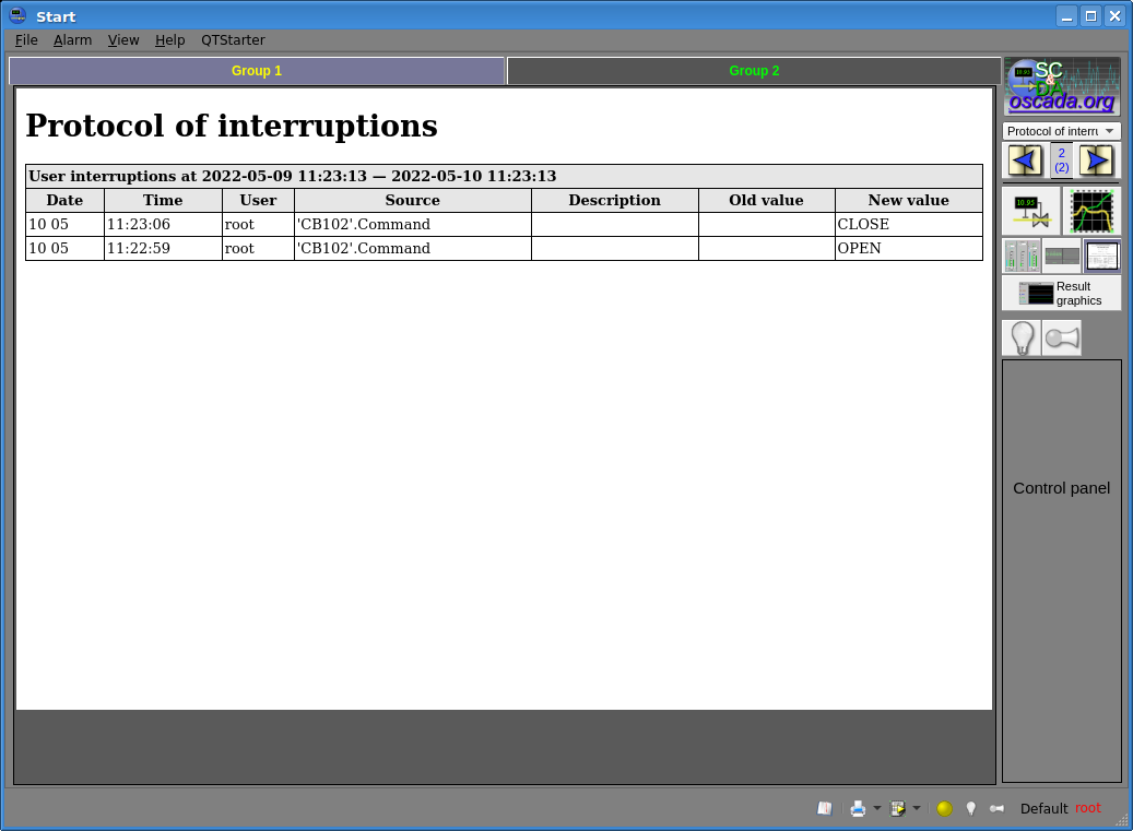

The discrete complex parameter of the object-tag ModBus.CM101.CB102, presented by us in the form of a ball valve, is active. That is, it can be selected, than having the control panel on the right (Fig.5.2.6), as well as send commands (open or close). You can transfer the commands from the control panel or through the context menu. All actions of the operator from the control influence are logged and the protocol document can be viewed at selection the view "Document" (Fig.5.2.8).
Fig. 5.2.8. The "Protocol of interruptions" document.

5.3.1 Creation the "Air cooler" widget on the basis of the primitive "Elementary figure"

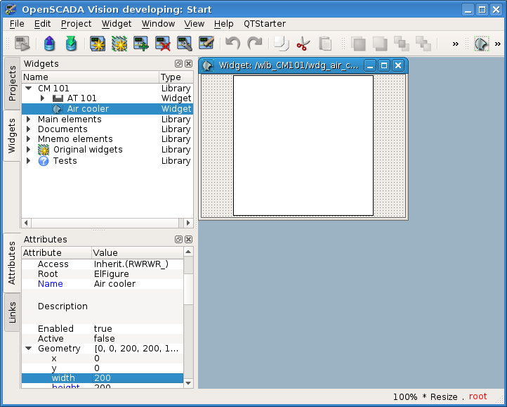

We will create the widget in the "CM 101" library created us before. To do this, click the right "mouse" button on the item in this library and select the menu item "... from the Library"->"Library: originals"->"Elementary figure" as it is shown in Figure 5.3.1.1 and we name the new element air_cooler (Air cooler).
Fig. 5.3.1.1. Adding widget to the "CM 101" library based on the primitive "Elementary figure".
After confirmation we will have a new widget with the name "Air cooler", select it in the widget library "CM 101" and open for editing via the context menu of the new element (Fig.5.3.1.2). In the attributes inspector we will set the properties:
Fig. 5.3.1.2. Primary widget configuration.

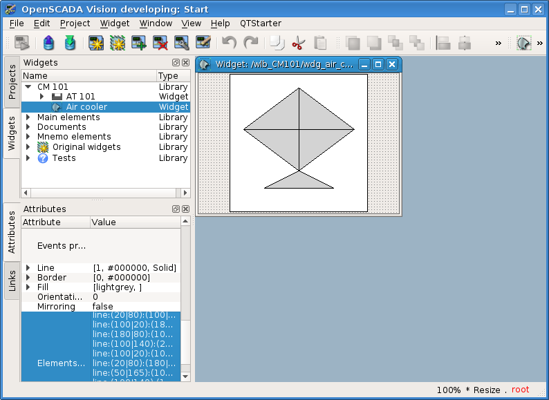

Now let's draw the visual representation of the widget, which can be done in two ways:
More information about the editor is available here.
Fig. 5.3.1.3. Entering the drawing mode of the widget based on the primitive "Elementary figure".
In our example we will use the second method, for what in the "Elements list" field of the attribute inspector we introduce the following list and press "Ctrl" + "Enter":
line:(20|80):(100|20)
line:(100|20):(180|80)
line:(180|80):(100|140)
line:(100|140):(20|80)
line:(100|20):(100|140)
line:(20|80):(180|80)
line:(50|165):(100|140)
line:(100|140):(150|165)
line:(150|165):(50|165)
fill:(20|80):(100|20):(180|80):(100|140)
fill:(50|165):(100|140):(150|165)
All the points are indicated statically, since dynamic and coordinate changes are not provided in the execution mode, and all other parameters are left by default. So, our widget will take a look at Figure 5.3.1.4.
Fig. 5.3.1.4. Image corresponding to the widget "Elements list".

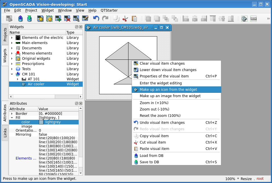

Create an icon for our widget, which will be visible in the widget tree of the library "CM 101" (Fig.5.3.1.5).
Fig. 5.3.1.5. Creating an icon of the widget.
On this the process of creating the first widget can be considered completed. Let's go on the stage of composition and creation a result widget.
5.3.2 Creation a final-combined widget "Cooler" on the basis of the primitive "Group of elements"
The final widget we'll create in the "CM 101" library, to do this we must click the right mouse button on the library and select the primitive "Group of elements" as it is shown in Figure 5.3.2.1, we will name the new element — elCooler (Cooler).
Fig. 5.3.2.1. Adding a widget to the library "CM 101" based on the primitive "Group of elements".
After confirmation we will have a new widget with the name "Cooler". Select it in the widget library "CM 101" and open for editing. In the attributes inspector we will set the properties:
Take the previously created element "Air cooler" and drag it — press the left button of the "mouse" manipulator on it and move the cursor to the area of the newly created widget, where we release the button (Fig.5.3.2.2).
Fig. 5.3.2.2. Drag and Drop of the widget "Air cooler" to the widget-container "Cooler".
As a result, a dialog window appears asking you to enter the identifier and name of the new widget. The identifier and name can be specified arbitrarily, we will enter the identifier air_cooler and leave the name empty and it will be inherited from the parent — the element "Air cooler". Thus, the newly created widget inside the container "Cooler" will inherit the element "Air cooler". After confirming the input of the identifier and the name, the "Air cooler" widget will be added to our widget container "Cooler" (Figure 5.3.2.3). In the attributes inspector we will set the properties for it:

Next we will unroll the menu item of the library "Mnemo elements", will find there the "Cooler 2" element and drag it to the widget container. This element will dynamically display the intensity of the air cooler. For the new widget enter the identifier cooler2 and leave the name again empty, after which the "Cooler 2" widget will be added to our "Cooler" widget-container. Thus, the newly created widget inside the "Cooler" container will inherit the element of the library "Mnemo elements" — "Cooler 2". In the attributes inspector we will set the properties:
Fig. 5.3.2.4. Change the color transparency of the inherited widget "Cooler 2".

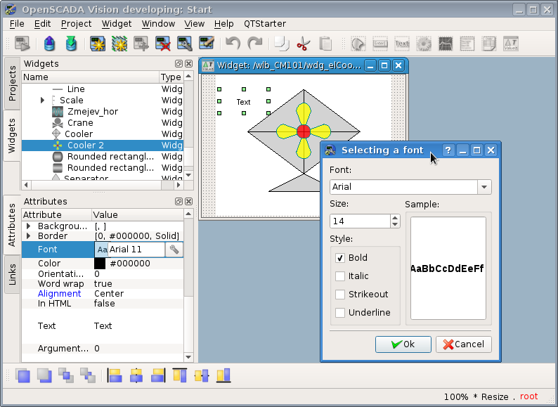

Now in the "Cooler" widget add two text fields based on the "Text" primitive, in order to display the input and output flow temperature. To do this, select the "Cooler" widget and, in the visual panel of the "CM 101" library, select the menu item of the primitive "Text" as shown in Figure 5.3.2.5. For the first text field, enter the identifier Ti and in the attribute inspector we will set the properties:
At.png Font Arial can be missing in the dialog, so select one that you like.
%1
deg.C
Fig. 5.3.2.5. Adding a new element based on the primitive "Text".

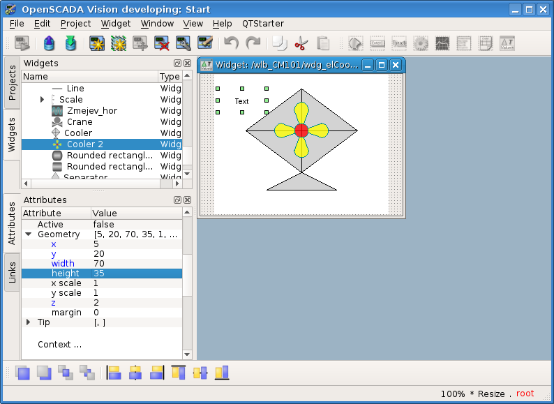

Fig. 5.3.2.6. Specifying the geometry of the widget "Ti".
Fig. 5.3.2.7. Changing the font size for the widget "Ti".
Fig. 5.3.2.8. Changing the field "Text" and indication the argument's presence for the widget "Ti".
Fig. 5.3.2.9. Configuration of the argument of the widget "Ti".
Now, in order to create a similar widget for the output temperature, copy the widget "Ti", insert the copied widget and give it the identifier To (Fig.5.3.2.10). In the attribute inspector, we will set the properties:
Fig. 5.3.2.10. Widget "To".
Now add a widget based on the primitive "Form element" (Fig.5.3.2.11), which we will use to select the set-points of the cooler productivity. We will specify the identifier cw (Figure 5.3.2.12) and in the attribute inspector we will set the properties:
0
50
100
150
200
Fig. 5.3.2.11. Adding a widget based on the primitive "Form element".
Fig. 5.3.2.12. Filling the parameters of the combo box "cw".
To display the productivity dimension of the cooler add another widget based on the primitive "Text". We do the same procedure as for the "Ti" widget. We will specify the identifier dimension (Figure 5.3.2.13) and in the attribute inspector we will set the properties:
Fig. 5.3.2.13. Adding the widget "dimension" based on the primitive "Text" and changing its properties.

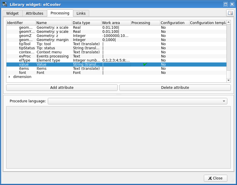

To add the processing logic of the "Cooler" widget, open the dialog for the properties editing of this visual element and go to the tab "Processing". In this tab we will see the attributes tree of the widget and the text field of the attributes processing program. To solve our task we need to add three attributes: Ti, To, Cw (Fig.5.3.2.14); for which you need to unroll the root element ".", select any item inside it and click the button "Add attribute" below.
Next enable the processing of the attribute value of the combo box "cw" as shown in Figure 5.3.2.15. Similarly we will turn on the arg0val attribute for Ti and To, as well as the speed attribute for the "cooler2" element.
Fig. 5.3.2.14. Adding three attributes for the element "Cooler" of the library "CM 101".
Fig. 5.3.2.15. Enabling the processing of the attribute "value" of the combo box "cw".

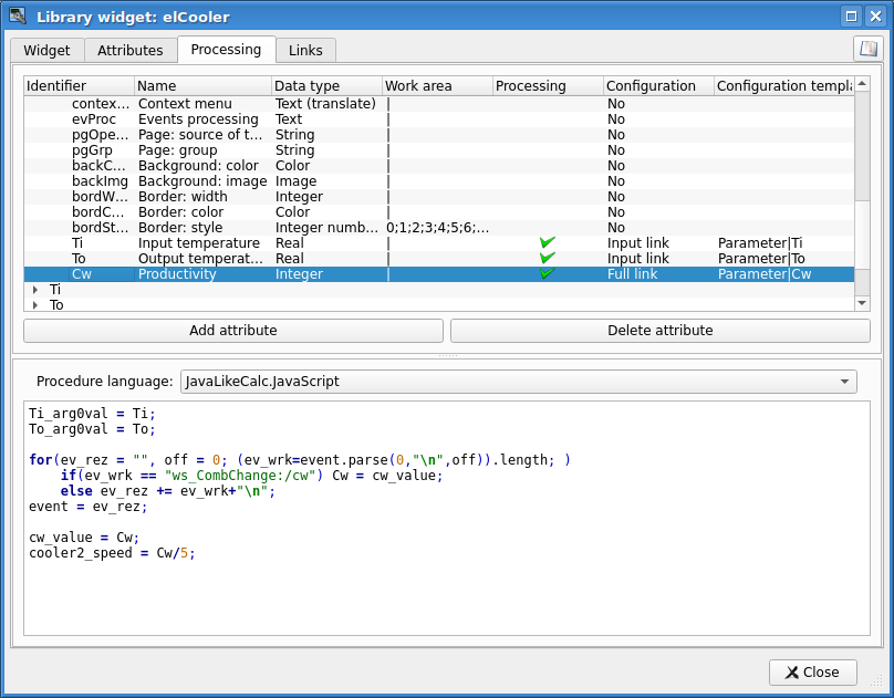

Finally we will set up the user programming language "JavaLikeCalc.JavaScript" and write this very program for processing the widget:
Ti_arg0val = Ti;
To_arg0val = To;
for(ev_rez = "", off = 0; (ev_wrk=event.parse(0,"\n",off)).length; )
    if(ev_wrk == "ws_CombChange:/cw") Cw = cw_value;
    else ev_rez += ev_wrk+"\n";
event = ev_rez;
cw_value = Cw;
cooler2_speed = Cw/5;
At.png Placing or editing the widget program does not directly compile it, that is, there will be no error messages in the program if they have a place to be. This is due to the fact, that the direct execution of the program, and thus its compilation, is carried out in the context of execution and at the moment of starting up of the visualisation project for execution. In this case all errors, that occurred during the compilation, are displayed as OpenSCADA messages and the error widgets are not processed. For details on how to debug user procedures see the "How to debug the OpenSCADA project" document.
Processing the widget in whole and executing its program performed at any event in the life cycle of the VCA project (specified in the "Period of the calculation" field of the "Project" tab, Figure 5.2) and periodically with the widget processing period (specified in the "Periodic processing" field of the "Widget" tab, Figure 5.1.3). By default, the widget processing period is taken from top widget and it is 1000 ms, so when you want faster updating your widget, you can set "Periodic processing" to 250 ms on the "Widget" tab.
The resulting tab "Processing" of the widget "Cooler" of the library "CM 101" will look like shown in Figure 5.3.2.16.
Fig. 5.3.2.16. The resulting tab "Processing" of the widget "Cooler" of the library "CM 101".

5.3.3 Adding the complex element to the mnemonic scheme
To test the operability and to evaluate the results of our efforts, add the created widget to the mnemonic scheme, developed in section 5.2. We perform this operation for two coolers "AT101_1" and "AT101_2".
To do this we will open the frame of the mnemonic scheme "AT 101" for editing, grab our complex element by the "mouse" and drag to the mnemonic scheme, where we drop it in the desired position — enter the identifiers AT101_1 and AT101_2, respectively. Place the added items as convenient to us. After performing these manipulations we must get the mnemonic scheme with a look in Figure 5.3.3.1.
Figure 5.3.3.1. Mnemonic scheme with our complex elements.
We will save the new mnemonic scheme and close its window. Next go to the project and open this mnemonic in the project tree "Start"->"Root page (SO)"->"Group 1"->"Mnemos"->"AT 101". As you can see, our new elements are appeared here automatically and we only need to connect the links to them, to do this we'll open the dialog of editing the properties of the mnemonic scheme on the tab "Links" (Fig.5.3.3.2). On this tab we see the tree with the elements "AT101_1" and "AT101_2", unrolling any we'll see the branch "Parameter" with the attributes "Ti", "To" and "Cw". Thus we can simply specify in the field "Parameter" the address of the parameter "prm:/LogicLev/CM101/AT101_1" and "prm:/LogicLev/CM101/AT101_2", respectively, and the attributes will be placed automatically.
Fig. 5.3.3.2. Tab "Links" of the dialog of editing the mnemonic scheme properties.
Let's save our mnemonic scheme and check the result, for what close the dialog of properties, start the project "Start" for execution and switch to the second mnemonic scheme with the paging buttons. In the error-free configuration we have to see a similar image as shown in Figure 5.3.3.3.
Fig. 5.3.3.3. The resulting mnemonic scheme.
On this mnemonic scheme through our complex elements we can not only observe, but also control productivity the coolers simply by changing the value in the combo box. Changing performance we can notice the change in temperature and signalling on the complex analog parameter of the object-trend. We can see and review the history of changes on the graphics group we created in Section 5.1 and the document "Protocol of violations" mentioned in Section 5.2.
