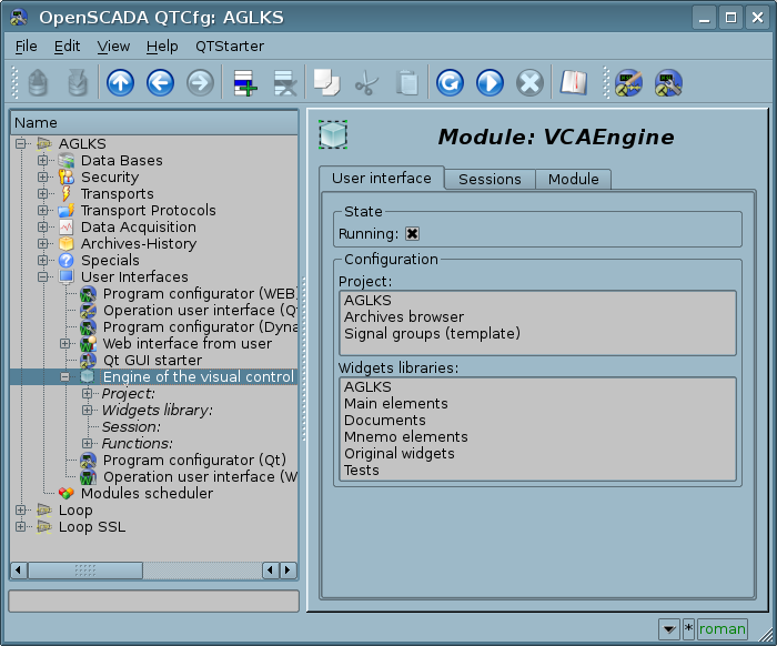

The module provides OpenSCADA for visual control area engine (VCA). The module itself does not implement visualization of VCA, but contains data in accordance with the concept "Model/Data — Interface". The visualization of this module's data is performed by the visualization modules of VCA, such as Vision and WebVision.
Visual control area (VCA) is an integral part of the SCADA system. It applies to the client stations with a view to providing accessible information about the control object and to for the the issuance of the control actions to the object. In various practical situations and conditions the VCA, based on different principles of visualization, may by applied. For example, this may be the library of widgets Qt, GTK+, WxWidgets or hypertext mechanisms based on the technologies HTML, XHTML, XML, CSS and JavaScript, or third-party applications of visualization, realized in various programming languages Java, Python, etc. Any of these principles has its advantages and disadvantages, the combination of which could become an insurmountable obstacle to the use of VCA in a practical case. For example, technologies like the Qt library can create highly-productive VCA, which will undoubtedly important for the operator station for control the technological processes (TP). However, the need for installation of that client software in some cases may make using of it impossible. On the other hand, Web-technology does not require installation on client systems and is extremely multi-platform (it is enough to create a link to the Web-server at any Web-browser) that is most important for various engineering and administrative stations, but the productivity and reliability of such interfaces is lower, that actually eliminates the using of them at the operator stations of TP.
OpenSCADA has extremely flexible architecture that allows you to create external interfaces, including user, in any manner and taste. For example, the OpenSCADA configuration environment available now as by means of the Qt-library, and also the Web-based.
At the same time, independent creation of the VCA implementations in different basis may cause the inability to use the configuration of one VCA in another one. That is inconvenient and limited from the user side, as well as costly in terms of implementation and follow-up support.
In order to avoid these problems, as well as to create as soon as possible the full spectrum of different types of VCA, the project for the construction of the concept of VCA is founded. The result of this project was this engine module (data model) of VCA, as well as direct visualization modules Vision and WebVision.

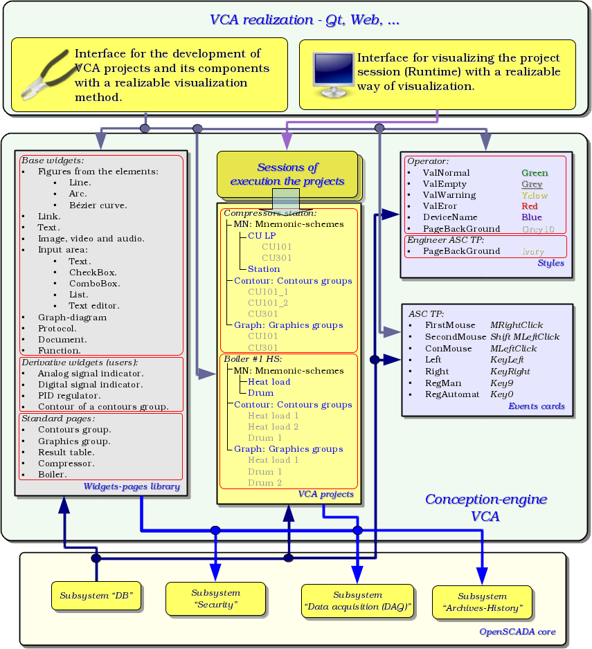

1 Purpose
This engine module (data model) of the VCA is aimed to create the logical structure of the VCA and the execution of sessions of individual instances of the VCA projects. Also, the module provides all the necessary data to the final visualizers of the VCA, both through local mechanisms of interaction of OpenSCADA, and through the control interface of OpenSCADA for remote access.
Final version of the VCA module will provide:
  1. formation from the template frames, by assigning the dynamics and without the graphical configuration;
  2. graphical formation of new frames, using ready-made visualization elements from the library - mnemosmes;
  3. forming, in the library, new ones: frames, template frames and display elements.

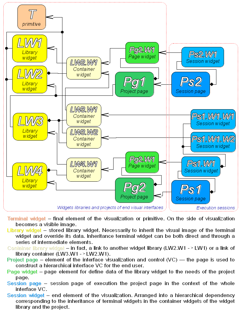

VCA, in whole, can operate in two modes — the development and running. In the mode of development, the interface of the VCA and its components is formed, the mechanisms of interaction are determined. In the execution mode, performes the formation of the UI interface and the interaction with the end user, based on the developed VCA.
VCA interface is formed of the frames, each of which, in its turn, formed from elements of the primitives, or user interface elements. Herewith, the user interface elements are also formed from the primitives or other user elements. That gives us a hierarchy and reuse of already developed components.
Frames and user elements are placed in the libraries of widgets. The projects of the interfaces of the final visualization of the VCA are formed from these libraries' elements. Based on these projects the visualization sessions are formed.
The described VCA structure is shown in the Figure.
That architecture of the VCA allows the support of three levels of complexity of the developing process of the control interface:

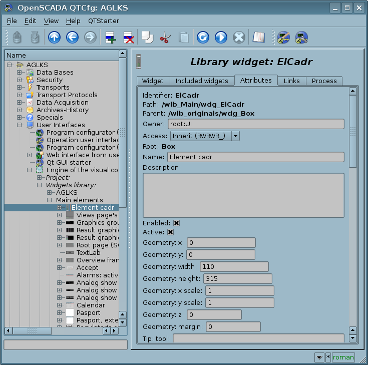

3.1 Frames and elements of the visualization (widgets)
Frame is the window, which directly provides information to the user in graphical or text form. The group of interconnected frames creates whole user interface of VC.
Content of the frame forms from the visualization elements (widgets). Widgets may be the basic primitives (different elementary figures, text, trend, etc.) and derivative, formed from the basic or other derivative widgets. All widgets are grouped by libraries. In the process of the work, the user can create his own libraries of derivative widgets.
Actually the frame itself is also a widget that is used as a final element of visualization. This means that the widget libraries can store the blanks of frames and the templates of the resulting pages of the user interface.
Frames and widgets are passive elements that do not normally contain links to the dynamics and other frames, but only provide information about the properties and the nature of the dynamics (configuration), connected to the properties. Activated frames, i.e. containing links to the dynamics and active connections, form the user interface and are stored in the projects. In some cases, it is possible the direct appointment of the dynamics in the blanks of frames.
Derivative frames/widgets can contain included widgets, which can be glued-linked of one another with the logic by the user programming language of OpenSCADA.
The widget is an element through which the following is provided:
Setting and linkage of the widgets is done through their properties. Parent widget and the widgets it contains, can be complemented by user properties. Then, the user and static attributes, are associated with the properties of included widgets by internal logic. To show the dynamics (current and archived data), properties of the widgets are dynamized, that is linked with the attributes of the parameters of OpenSCADA or properties of other widgets. Using, for linking nested widgets by internal logic, the user programming language of OpenSCADA relieves the issue of implementing a complex visualization logic, thus providing high flexibility. Practically, you can create fully dynamized frames with complex interactions at the user level.

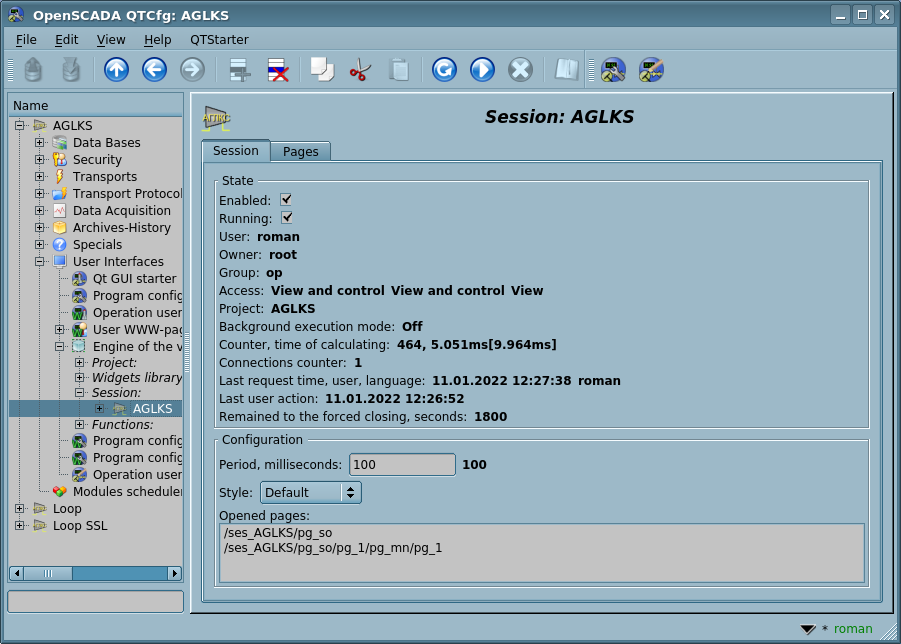

3.3 Session of the project execution
The project session is expanded tree of the project for direct it execution, which includes an individual task of hierarchical the widget's procedures execution. For each project can be opened many sessions. The end-user visual interface forming performs by the visualizers from data of the project's session, after the session creation by the request.
Between the widgets, at different levels of the hierarchy, finally formed fairly complex hereditary links, which are determined by the possibility of using some widgets by others, ranging from the library widget to the session widget. To explain these features of interaction, the figure shows an exhaustive map of "using" inheritance.
At the session level widget contains a object of values of calculation procedure. This object is initiated and used in the case of presence of the calculation procedure itself. At the time of the initialization, the list of parameters of the procedure is created and a compilation of the procedure is performed with these parameters, in the module that implements the selected programming language and with the name of the resulting procedure in the form of a coded full name of the widget. The compiled function is connected to the object of values of the calculation procedure, and further the calculation is performed with the session period.
Calculation and processing of the widget runs in the following sequence:
The session objects of the project inherit from an abstract object "Widget" and use the appropriate objects of the project. Thus, the session "Session" uses the project "Project" and forms expanded tree on its basis. Project page "Page" is directly used by the session page "SessPage". The remaining objects "SessWdg" are deployed in accordance with the hierarchy of page elements.
In addition to the standard properties of the abstract widget "Widget", elements of the pages and the session pages themselves get the following properties: storage of the object of values of the computational procedure, calculation of the procedures and mechanism for processing of the events. Pages of the session, in addition, contain a container of the following by the hierarchy pages. The session, in general, is calculated with the specified periodicity and in sequence:
This policy allows to bypass the pages according to their hierarchy, and events in the widgets "climb up" during one iteration.
The sessions support multi-language at the level of the control interface of OpenSCADA, which depended from values of the generic attributes "lang" and "user" and which visualizer can set in proper way of own language. This function is enabled by dynamic messages translation of OpenSCADA.

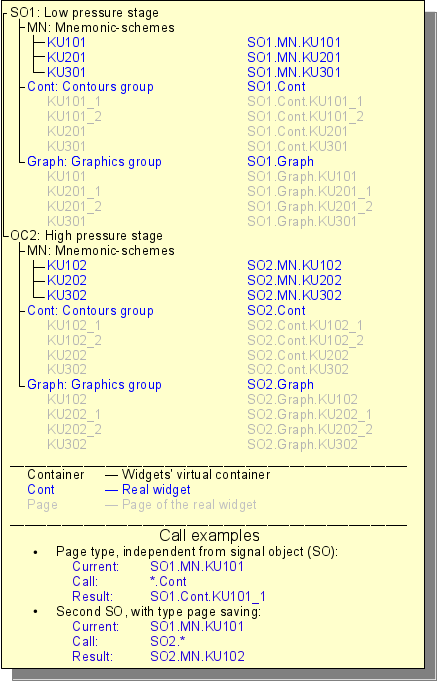

The mechanism "Script for the control the opening of pages" based on the basic attribute of the widget "evProc", which can be used for opening the pages. Scenario of this attribute is stored as a list of commands with the syntax: "{event}:{evSrc}:{com}:{prm}". Where:
The following commands are implemented:
Special characters of the template are deciphered as follows:
For a correct understanding of working the template mechanism, when choosing a page, we give a few real examples:
Initially: /pg_so/pg_1/pg_mn/pg_1
Command: open:/pg_so/2/*/*
Result: /pg_so/pg_2/pg_mn/pg_1
Command: open:/pg_so/*/gkadr/*
Result: /pg_so/pg_1/pg_gkadr/pg_1
Command: next:/pg_so/*/*/$
Result: /pg_so/pg_1/pg_mn/pg_2

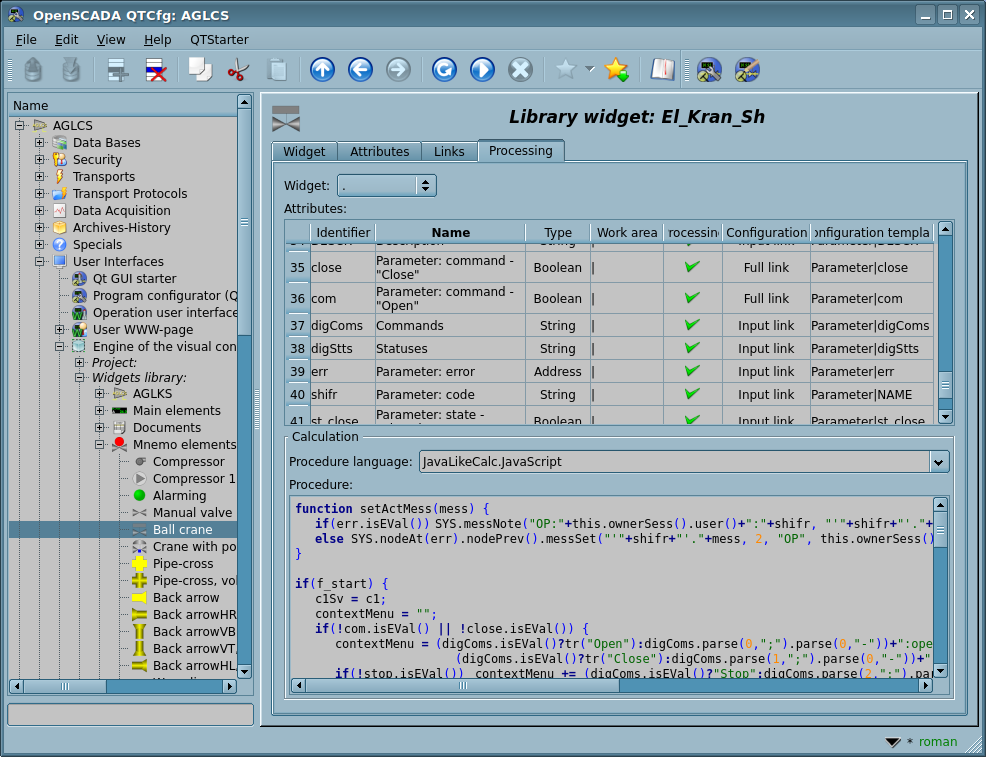

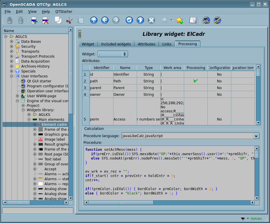

Figure. Tab "Processing" of the configuration page of the widget.
In addition to configuration fields of the attributes the column "Processing" in the table provides, for selective using of the attributes in the computational procedure of the widget, and the columns "Configuration", "Configuration template", to describe the links configuration.
If the "Processing" column is true, then the variable {widget ID}_{attribute ID} becomes available in the computational procedure, for example cw_value.
The column "Configuration" allows to specify the link type of the widget attribute:

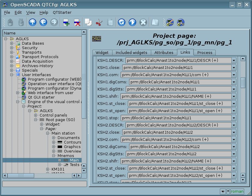

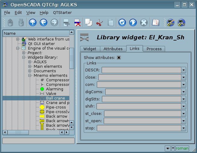

The figure shows a tab of links for group attributes, by specifying only the parameter. The following figure shows the individual attribute assignment.
Figure. Tab "Links" of the configuration page of the widget with the group assignment of the attributes by the specifying only the parameter.
Figure. Tab "Links" of the configuration page of the widget with the individual assignment of the attributes.

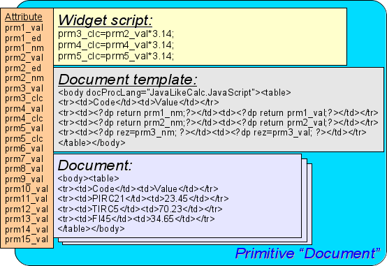

Document Document Element of the generating reports, journals and other documentation on the basis of available data.

Table. The common set of properties/attributes in the widget
Identifier Name Number Value
id Identifier - Identifier of the element. The attribute is read-only, designed to provide information on the ID of the element.
path Path - Path to the widget. The attribute is read-only and designed to provide full information about the element location.
parent Parent - Path to the parent widget. The attribute is read-only and designed to provide information about the ancestor location which the widget is inherited from.
owner Owner - The widget owner and group in the view "{owner}:{group[,group1,groupN]}", by default the "root:UI".
perm Permission -
Permission to the widget in the view "{user}{group}{other}" of octal number like to "0664-RWRWR_", plus the inheritance flag enables the inheritance for owner and its permissions from the upper widget.
Where "user", "group" and "other" is:
  • "__" (0) — no access;
  • "R_" (4) — read-only;
  • "RW" (6) — read and write.
By default that is in 01000 — inheritance.
root Root 1 Identifier of the widget-primitive (basic element) which underlies the widget visualization shape.
name Name - Name of the element. Accessible to modification the element name.
dscr Description - Description of the element. Text field of the brief description.
en Enabled 5 The state "Enabled" of the element. Disabled element is not shown in the execution mode.
active Active 6 The state "Active" of the element. Active element may receive focus in the execution mode, and thus receive keyboard and other events with their subsequent processing.
geomX Geometry: x 7 Geometry, coordinate 'x' of the element position.
geomY Geometry: y 8 Geometry, coordinate 'y' of the element position.
geomW Geometry: width 9 Geometry, the width of the element.
geomH Geometry: height 10 Geometry, the height of the element.
geomXsc Geometry: x scale 13 Horizontally scale of the element.
geomYsc Geometry: y scale 14 Vertical scale of the element.
geomZ Geometry: z 11 Geometry, coordinate 'z' (level) of the element on the frame. Defines also the order to transfer the focus through active elements.
geomMargin Geometry: margin 12 Geometry, the margins of the element.
tipTool Tip: tool 15 Text of a brief help or tip on this element. Realized usually as a tool tip, while keeping your mouse cursor over the element.
tipStatus Tip: status 16
Text information on the status of the element or the guide to action over the element. Implemented usually in the form of a message in the status bar while keeping your mouse cursor over the element.
* Modification the attribute from session of the root page will record the message in the status bar of the visualization window of the session.

3.9.7 Element of formation of the documentation (Document)
The primitive is intended for the formation of reporting, operational and other documentation based on document templates.
Table. List of additional properties/attributes of the primitive "Element of formation of the documentation (Document)"
style CSS 20 CSS rules in lines like to "body { background-color:#818181; }".
tmpl Template 21 Template of the document in XHTML, starts from the tag "body" and includes the procedure parts:
<body docProcLang="JavaLikeCalc.JavaScript">
  <h1>Value<?dp return wCod+1.314;?></h1>
</body>
doc Document 22 Final document in XHTML, starts from the tag "body".
font Font 26 Basic font of the text. Font name in the view "{family} {size} {bold} {italic} {underline} {strike}", where:
  • "family" — font family, for spaces use symbol '_', like: "Arial", "Courier", "Times_New_Roman";
  • "size" — font size in pixels;
  • "bold" — font bold (0 or 1);
  • "italic" — font italic (0 or 1);
  • "underline" — font underlined (0 or 1);
  • "strike" — font struck (0 or 1).
Examples:
  • "Arial 10 1 0 0 0" — Arial font size 10 pixels and bold.
bTime Time: begin 24 Start time of the document, seconds.
time Time: current 23 Time of the document generation, seconds. Write the time for the document generation from that point or zero for regeneration.
process In the process 27 Indication of the process of forming a document in a separate thread.
n Archive size 25 Number of the documents or the depth of the archive.
Attributes of the enabled archival mode
aCur Archive: cursor: current - Position of the current document in the archive. Record of the value <0 produces the archiving of this document.
vCur Archive: cursor: view -
Current visual document of the archive. Writing a value of:
  • -1 — selecting the next document;
  • -2 — selecting the previous document.
aDoc Archive: current document - Current archive document in XHTML, starts from the tag "body".
aSize Archive: size - Real size of the archive document.
Features of the primitive "Document":
The basis of any document is the XHTML template. The XHTML-template is the tag "body" of the WEB-page which contains the document's static in the standard XHTML 1.0 and elements of the executable instructions in the user programming language of OpenSCADA in the view <?dp {procedure} ?>. The resulting document is formed by the procedures execution and insertion of their result into the document.
The source for values of the executable instructions are the widget attributes of the primitive, as well as all the mechanisms of the user programming language OpenSCADA. Attributes may be added by the user and they can be linked to the actual attributes or parameters or they can be autonomous, values of which will be formed in the widget procedure. In the case of linked attributes the values can be extracted from the archive-history.
The figure shows the structure of the widget of the primitive "Document". According to this structure, "Document" contains: XHTML template, results documents and data processing procedure. Data source of the procedure and output documents is attributes of the widget.
Figure. Block diagram of the primitive "Document".
Working in two modes is provided: "Dynamic" and "Archive". Difference between archive mode is the availability of the archive of the specified depth and attributes which allow you to control the process of archiving and viewing of the document in the archive.
Generation of the document is always performed at the time of setting of the attribute time relative to the earlier set begin time of the document in the attribute bTime. With the archive turned off the resulting document is placed directly in the attribute doc. When the archive is turned on the resulting document is placed in the cell under the cursor, the attribute aCur, as well as in doc if value of the archive cursor aCur and the visualized document cursor vCur match. Attributes of the archival cursors provide several command values:
As mentioned above, the dynamics of the document template is determined by inserts of executable instructions of the view "<?dp {procedure} ?>". The procedures may use the same attributes of the widget and functions of the user programming interface of OpenSCADA. In addition to widget attributes, special attributes are reserved, see the table.

The project sessions
Obtaining the session list expanded by some options
REQ: <get path="/UI/VCAEngine/[%2fbr%2fses_|%2fses%2fses]" chkUserPerm="{chkUserPerm}" onlyMy="{onlyMy}" />
  • chkUserPerm — checking for the user permition before listing [0|1];
  • onlyMy — listening only my own sessions [0|1].
RESP: <get path="/UI/VCAEngine/[%2fbr%2fses_|%2fses%2fses]" chkUserPerm="{chkUserPerm}" onlyMy="{onlyMy}" rez="0">{sessions}</get>
  • sessions — sessions list in the tags "el", where the identifier is in the tag text. Expanded by the extra attributes:
    • "user" — user of the session;
    • "proj" — project of the session.
<get path="/UI/VCAEngine/%2fses%2fses" rez="0" onlyMy="1" user="roman">
  <el user="roman" proj="AGLKS">AGLKS</el>
  <el user="roman" proj="AGLKS">AGLKS0</el>
</get>
Obtaining the sessions list of the specified VCA project
REQ: <list path="/UI/VCAEngine/%2fserv%2fsess" prj="{project}" />
  • project — identifier of the requested project.
RESP: <list path="/UI/VCAEngine/%2fserv%2fsess" prj="{project}" rez="0">{sessions}</list>
  • sessions — sessions in the "el" tags.
<list path="/UI/VCAEngine/%2fserv%2fsess" prj="AGLKS" rez="0" user="roman">
  <el>AGLKS</el>
</list>

4 Configuring the module via the control interface of OpenSCADA
Through the control interface of OpenSCADA, components that use it, can be configured from any configurator OpenSCADA. This module provides an interface to access all the data object of the VCA. Main tab of the configuration page of the module provides access to widgets libraries and projects (Fig.4.1). The tab "Sessions" provides access to opened sessions of the projects (Fig.4.2).
Fig.4.1. Main configuration page of the module.
Fig.4.2. Tab "Sessions" of the configuration page of the module.
In addition to the list of opened sessions, the tab in Figure 4.2 contains a table with a list of sessions that must be created and started up at the boot time of OpenSCADA. Creation of sessions through this tool can be useful for Web-based interface. In this case, when connecting, Web-user data is ready and ensures the continuity of the formation of archival documents.
Configuration of the container widgets in the face of libraries and widget projects is done through pages in Figure 4.3 (for project) and Figure 4.5 (for widgets library). The widgets library contains the widgets, and project — the pages. Both types contain a tab of configuration resources used by widgets (Fig.4.6). The project page also contains the tab "Diagnostics" (Fig.4.4) for debugging and monitoring the execution of pages in sessions.
Fig.4.3. Configuration page of the projects.
From this page you can set:
At.png The object still supports of specifying the spare storage addresses with tables before you rename the table in the standard form "prj_{ObjID}".
Fig.4.4. Tab "Diagnostics" of the projects.
From this tab you can select time (or refresh to current) and depth to obtain the diagnostic messages of the sessions of running this project.
Fig.4.5. Configuration page of the widgets libraries.
At.png The object still supports of specifying the spare storage addresses with tables before you rename the table in the standard form "wlb_{ObjID}".
Fig.4.6. Configuration tab of resources of the container.
Configuration of the project's session differs significantly from configuration of the project (Fig.4.7), but also contains pages of the project.
Fig.4.7. Configuration page of the projects sessions.
Configuration pages of the visual elements, placed in different containers, may be very different, but this difference is the presence or absence of individual tabs. Main tab of the visual elements in fact is the same everywhere, differing in one configuration field and three into the session (Fig.4.8). The pages contains the tabs of the child pages and included widgets. The container widgets contains the tab of the included widgets. All visual elements contain attributes tab (Fig.4.9), except the logical containers of the projects. Elements, at the level of which it is possible to build the user procedure and to determine the links, contain the tab "Processing" (Fig.4.10) and "Links" (Fig.4.11). At.png The attribute name's rows in the "Processing" tab after the first one treat as help.
Fig.4.8. Main tab of configuration of the visual elements.
From this page you can obtain:
Fig.4.9. Tab of the attributes of the visual elements.
Fig.4.10. Tab of processing of the visual elements.
Fig.4.11. Tab of links of the visual elements.
Modules/VCAEngine/en - GFDLJune 2025OpenSCADA 0.9.8
