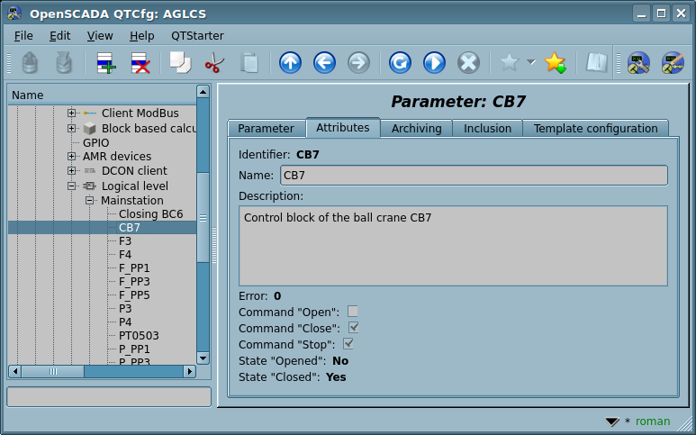

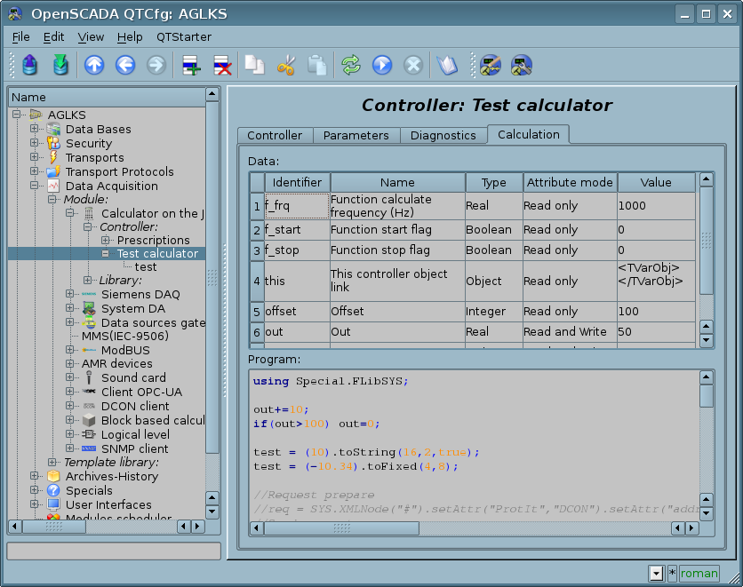

Current execution context of DAQ procedures you can observe into a proper page of the object of the execution context, like: the tab "Attributes" of the Logic Level parameter (Fig. 1), the tab "Calculation" of the Java-like based calculator (Fig. 2) and so on. To append some interim values you can temporary append (or set as an read-only attribute) and link some attributes to the template or append and link some IO to the function.
Fig. 1. Tab "Attributes" of the Logic Level parameter.
Fig. 2. Tab "Calculation" of the Java-like based calculator.

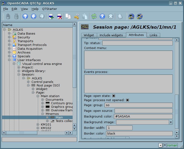

Current execution context of the VCA procedures (procedures of the widgets) you can observe on the tab "Attributes" of the proper page or widget of the session of the executed now project (Fig. 3). To append some interim values you can temporary append and link several attributes to the widget/page.
Fig. 3. Tab "Attributes" of a page or widget of the session of the executed now project.

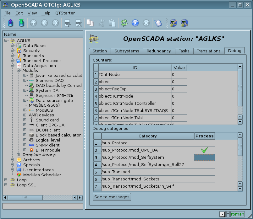

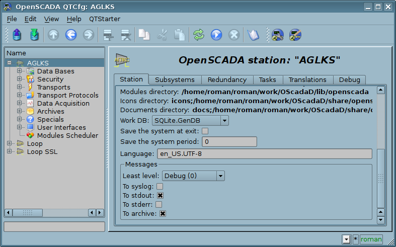

At.png The debugging messages (the suffix is "Debug" or the level is 0), on the last versions of OpenSCADA, will be allowed to observe only after the debugging enabled: the field "Least level" set to "Debug (0)" (Fig. 8) and check category(es) of the messages (Fig. 9), for the details read here! The debugging messages enabling and disabling allows you to include the debug messages permanently into the procedures with the proper category of the place. All other, not debug, messages will show anytime, for levels more or equal to the globally set (Fig. 8). Some messages, as VCA-Events, will be also enabled with that mechanism!
Fig. 8. Field "Least level" set to "Debug (0)".
Fig. 9. Select categories of nodes for debugging and debugging messages.
