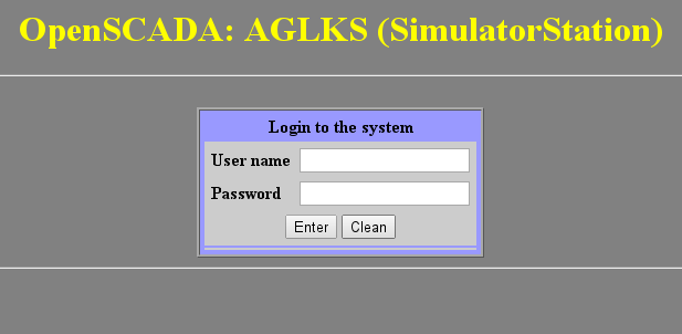

Using the module starts with the opening of the session (the user authentication) by the module of the protocol HTTP (Protocol.HTTP). For the operation of the authentication and the mechanism of saving of the session, the browser must allow Cookies.

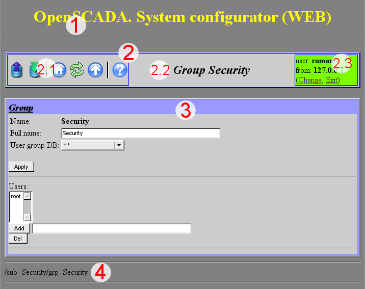

Fig.1. User authentication.
Fig.2. Structure of the operating window of the user.
The operating window of the configurator consists of the following parts:
1. Header — contains the module name.
2. Control Panel — consists of:
2.1. Navigator — serves the navigation functions through the pages tree.
2.2. Node name.
2.3. User — displays the current user of the session, his address and lets you to change the user.
3. Workplace field — contains the configuration content of the control language interface, starting with the root tabs to the end elements.
4. Footer — contains for address of current page.

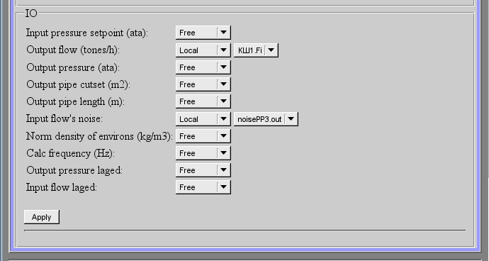

1 Basic elements
The basic elements include: information elements, fields to input of the values, elements of combo box, flags. To set for new values of the basic elements the group method is used, for this there is a button "Accept" on the form. In the case of an element name absence, the basic element connects to the previous one. Examples of the basic elements, with connections, is shown in Figure 3.
Fig.3. Basic elements and their connections.

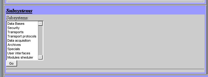

3 Lists
Lists contain a group of basic elements of the same type. For operations on elements of a list the additional buttons are added. In addition, through the list of items, the operations of moving to other pages are performed, for which the button "Go" is added. Lists can be indexed. Example of the list with the moving is shown in Figure 5.
Fig.5. The list.

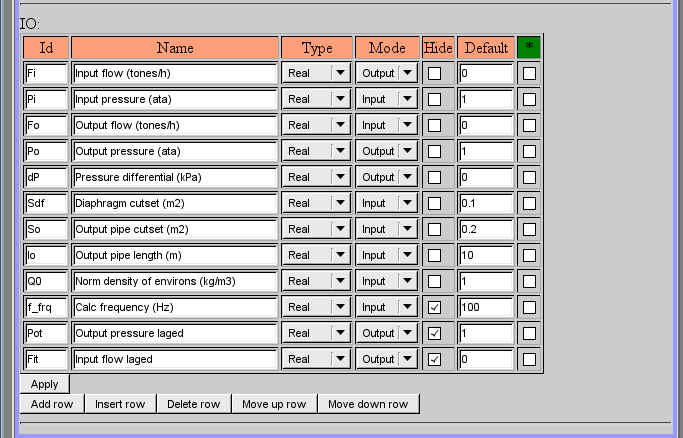

4 Tables
Tables contain values of basic elements. Type of the basic element is defined separately for each column. Example of the table is shown in Figure 6.
Fig.6. The table.
