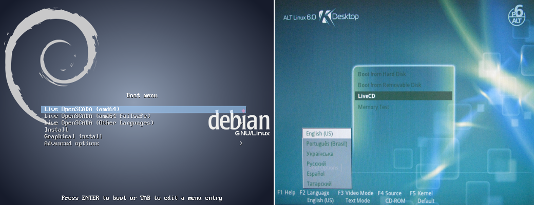

After selecting the device, you should see the boot menu for the live disk (Fig. 2) where you can pre-select the boot option in a specific language, for Debian, or your language, with the F2 key for ALTLinux.
Fig. 2. The select language menu for the live disk Debian, ALTLinux.

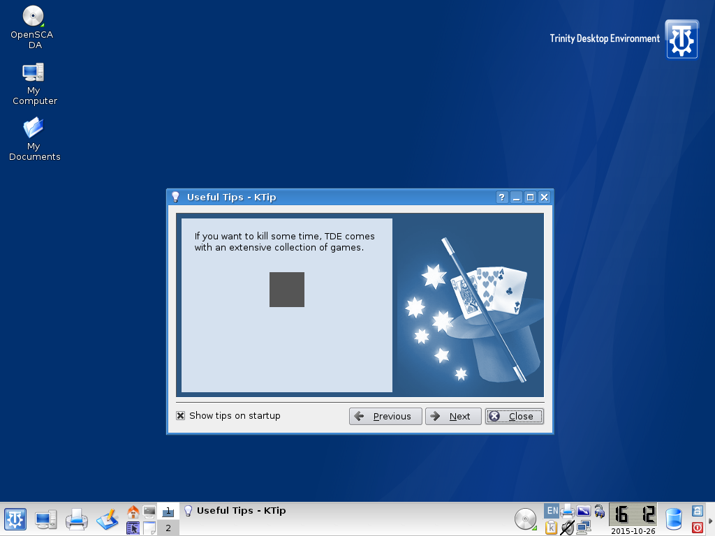

As a result of booting a live disk, you will get the TDE desktop (Fig. 3).
Fig. 3. Desktop of the live disk.
