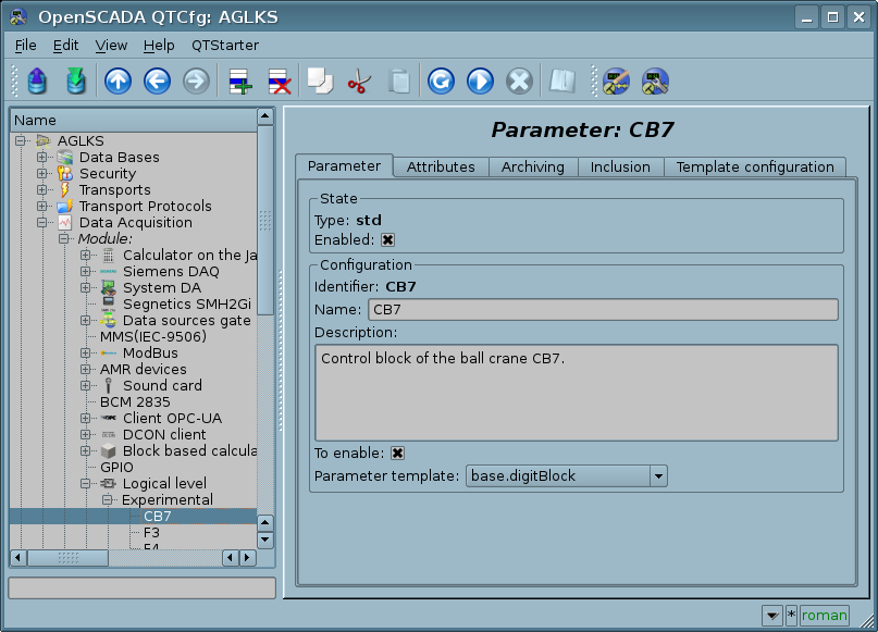

Fig.2. Configuration tab of a parameter.

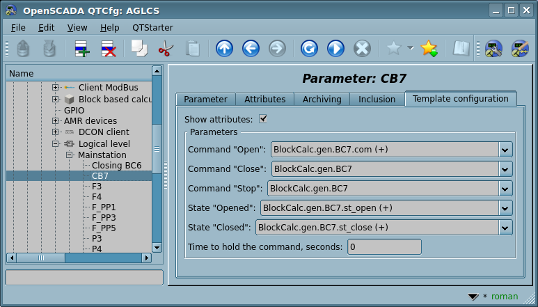

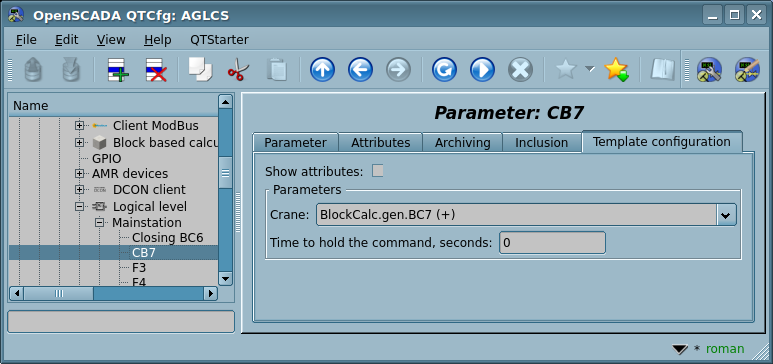

When forming a template of the logical type of the parameter of this module, the specific of the link format of the template must be taken into account. The link should be written as: {Parameter}|{identifier}, where:
This record allows to group multiple attributes of the source parameter and assign them only by the choice of the same parameter. That is, in the configuration dialog of the template (Fig.3) only the parameter will be specified. This however does not rule out the possibility of assigning the attributes of the parameters separately to each one, in addition, if you omit the link description in the specified format in the template configuration, then the attribute of the parameter (Fig.4) will be assigned.
The module provides a special processing of a number of attributes of the template:
The sign "(+)" at the end of the address signals the successful linking and presence of the target object. For object-type attributes, hierarchical access to a specific property of the object is allowed by defining its path through the '#' symbol, for example: "LogicLev.experiment.Pi.var#pr1.pr2".
Fig.3. Configuration tab of a parameter template.
Fig.4. Configuration tab of a parameter template. Show only attributes.
