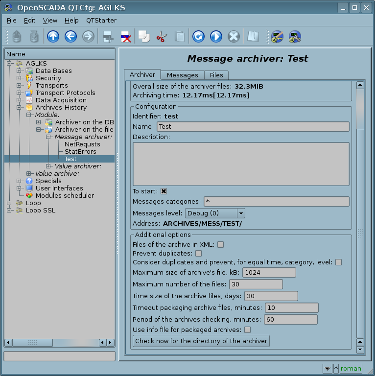

The module provides additional settings for the archiving process, Figure 1.
Fig.1. Additional settings of message archiving process.
These additional parameters:

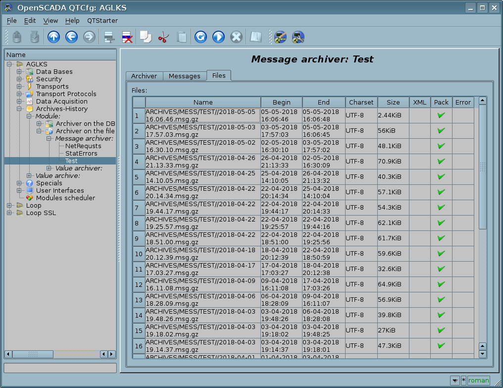

To control the archiver files you can view the tab "Files", Figure 2.
Fig.2. Tab "Files" of an message archiver.

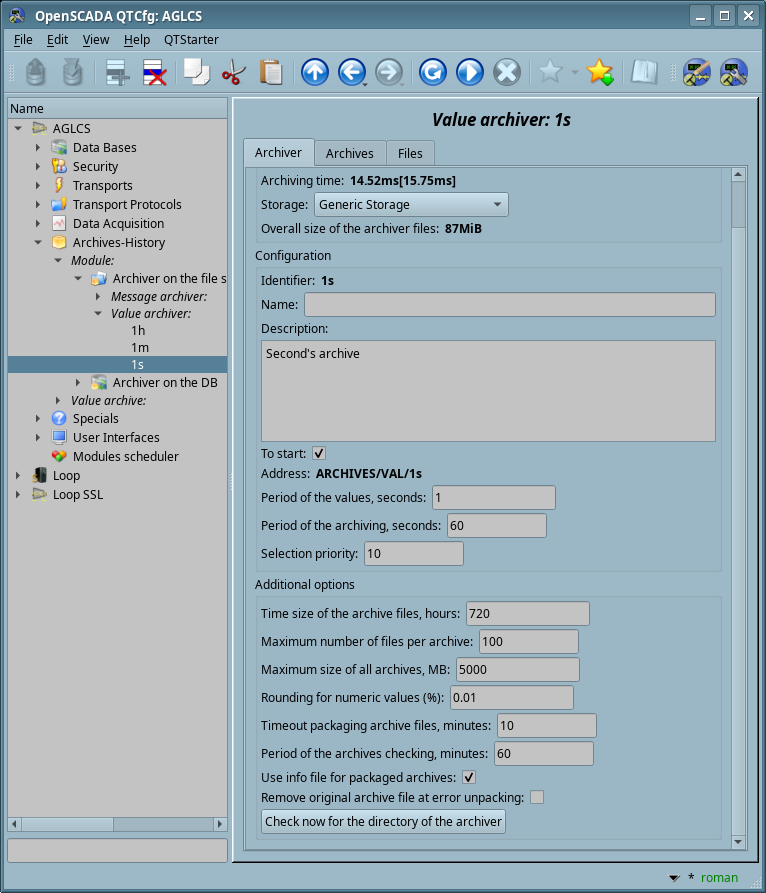

The module provides additional settings for the archiving process, Figure 4.
Fig.4. Additional settings of the value archiving process.

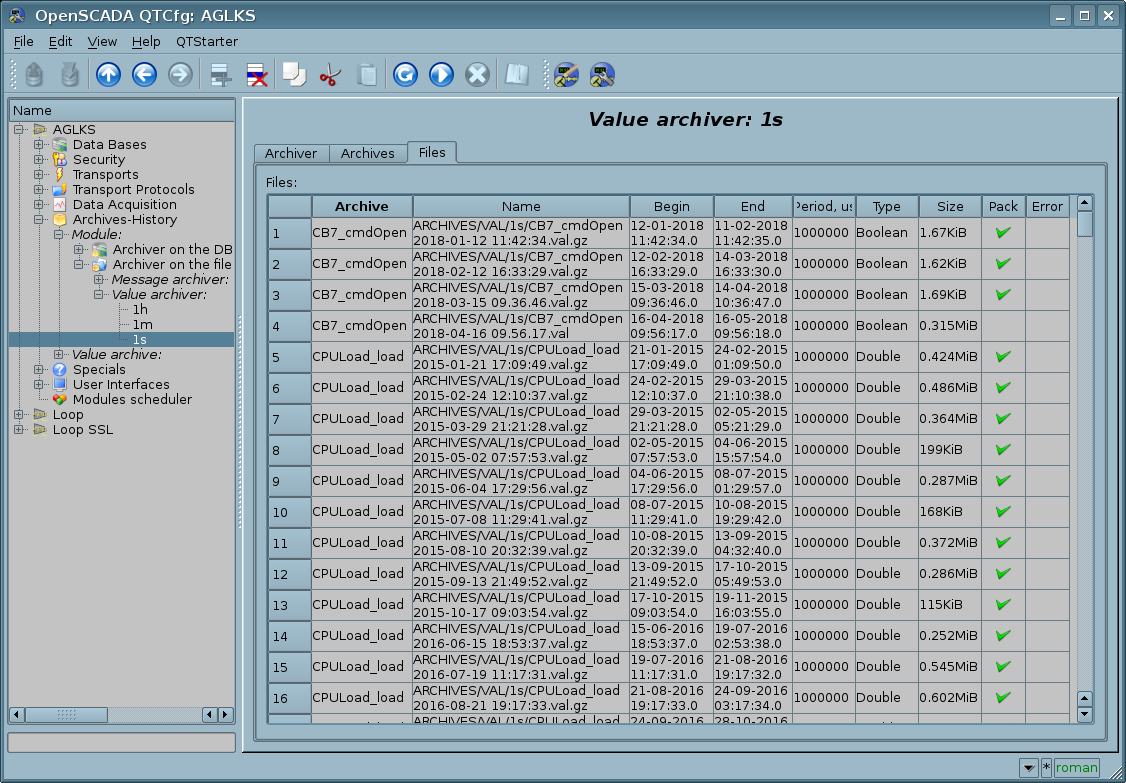

To control the archiver files you can view the tab "Files", Figure 5.
Fig.5. Tab "Files" of a value archiver.

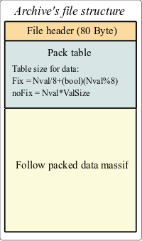

2.1 Files format of the value archive
To implement the archiving to the file system the following requirements are to be done:
According to the above requirements, the file multiplicity archiving method is organized (for each source). The archive cycle is implemented at the file level, that is, a new file is created, and the old one is deleted. For quick compression, we use the method of drawing to the last of the same value. For these purposes, the archive file provides a bit-packet size one by one with the amount of stored data. That is, each bit corresponds to one value in the archive. The value of the bit indicates the presence of a value. For a stream of identical values, the bits are reset. In the case of an archive of strings, the table is not bitwise and bytewise and contains the length of the corresponding value. In case of flow of identical values, the length will be zero and the first will be the same value. Since the table is byte then the archive can store strings up to 255 characters long. Thus, the methods of storing can be divided into a method of data of fixed and non-fixed size. The general structure of the archive file is shown in Figure 6.
Fig.6. Overall structure of a value archive.
When creating a new archive file, creates: the header (the header structure in Table 1), the zero bitmap of the archive packaging and the first not-valid value (EVAL). Thus, an archive generated by not-valid values is initialized. Forth, the new values will be inserted into the values field with the adjustment of the index packaging table. This follows that passive archives will degenerate into files of size the header and the bitmap table.

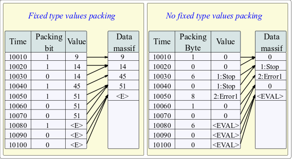

Clarification of the sequential packaging mechanism is shown in Figure 7. As can be seen from the figure, the packaging sign contains the length (non-fixed types) or the packaging sign (fixed types) of the individual value. This means that to get the desired value offset it is necessary to sum the length of all previous valid values. Performing this operation every time and for each value is a very hard operation, therefore, a mechanism for caching the values offsets was introduced. The mechanism caches the values offsets through a certain number of them, and also caches the offset of the last value to which access was made (separately for reading and writing).
Fig. 7. Mechanism of the sequential packaging of the values.
