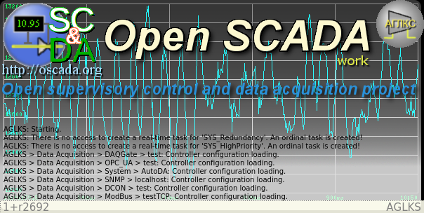

From the beginning, this module creates a separate thread for the main Qt thread, where it is possible to create a dynamic splash screen (Fig.1), since the main OpenSCADA tasks continue to run in the main thread. That version of Qt5 became especially sensitive to execution in a non-main thread, so for OpenSCADA it was added to this feature, but with the messages update in the screen saver from the service thread before and after the moment of switching to the primary tasks. To control this feature, the --QtInNotMainThread startup option, which enables thread execution in the non-main thread, is provided, for Qt4, so, by default, executing in the main thread is typical, for Qt5.
Fig.1. Dynamic splash screen of the module.

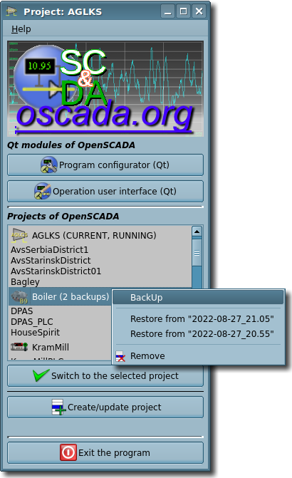

The starter dialog window (Fig.2) in whole provides:
Fig.2. Starter dialog window of the module.

With the integration into OpenSCADA elements of the project manager, this module received the function of selecting existing and creating new OpenSCADA projects in the list of the projects and project commands (Fig.2). Currently, there are two modes of the starter dialog window (Fig.2), which is the mode of the initial start and the mode of execution of the selected project.
The initial mode is, in fact, a launch mode without a specified project, and it involves choosing a project for switching to the second mode, and accordingly hides the list of Qt GUI modules, even if they are loaded to the initiating configuration.
In the project execution mode, all common mechanisms work, that is a call to Qt GUI modules and a start-collapse in the system tray, and the startup dialog (Fig.2) contains a list of available Qt GUI modules and the information about the running project in the title of the window.
In the list of projects, the user (via the context menu) is additionally given the opportunity to remove not running projects, BackUp and restore projects from the selected backup.
In addition to the names of the projects in the list of projects, to the right of the title, their status is provided — "current", "running" and "{N} backups". The state "current" means that the execution of this particular project is carried out. The state "running" indicates a multiple-start blocking file presence, and thus the execution of the project, and separately from this project if the state "current" is not specified next. You can select and try to switch to a project in the "running" state by accepting the warning, but if this project is actually executed now and the presence of the lock file is not residual after the program crash, then the switching program just ends! The state "{N} backups" indicates presence the specified backups number of the project.
