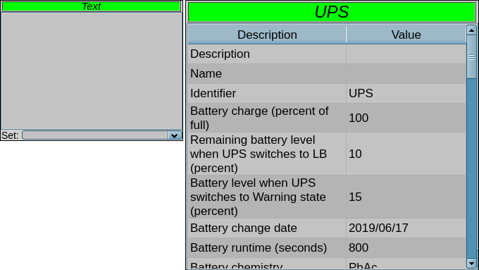

1.6 Object properties (objProps)
1.2 GPLv2 * en, uk, ru Roman Savochenko
The element on Figure 1.6 serves to display the properties of the data source in tabular form and to highlight them in color, as an object, and to allow the values of the recordable properties to be changed. This element also generates violation notifications according to the features of the object. The element generally uses and represents a representative structure "Complex objects" of the DAQ-templates.
Fig.1.6. The element "Object properties" in the development and runtime modes (left to right).
Using — development
This widget can be used by the developer in creating mnemonic schemes with consolidated rendering of the object as a whole and entity with properties. To use it you need to add this widget to a mnemonic scheme, adjust for the horizontal, vertical size, by scaling, and link to the data source parameter at the DAQ-template "Complex objects".
Using — runtime
In the runtime mode, a table is displayed with properties in the rows where the first column is the property name and the second column is its value. Row can be backlit by an alarm color in case of violation of this property. Of particular importance is the title of the widget, which displays the name of the object background color which can become an emergency color in the presence of violations in the object.
The properties table is active and at selecting the property row, which means the writing, a field for setting the property value will appear below.

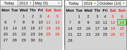

1.7 Calendar (calendar)
1.0 GPLv2 * en, uk, ru Roman Savochenko
The element on Figure 1.7 is used to display the month of the calendar by week, which allows you to select the year, month and day, as well as switch to the current day.
Fig.1.7. The element "Calendar" in the development and runtime modes (left to right).
Using — development
This widget can be used by the developer to create mnemonic schemes with displaying the calendar. To use it you need to add this widget to a mnemonic scheme, adjust for the horizontal, vertical size, by scaling, and use the attribute "selTime" of this widget to obtain and to set the date.
Using — runtime
In the runtime mode, the year, month, and day are displayed according to the "selTime" attribute.
The user can select the year and month from the list, as well as the day in the represented weeks. An appropriate button is provided for a quick return to the current day.
Linking and configuring the attributes
Identifier Name Type Description
selTime Selected time Integer The calendar in seconds from the UNIX-epoch.

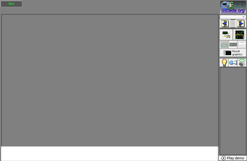

2 Root page (SO) (RootPgSo)
2.7 GPLv2 * en, uk, ru Roman Savochenko 1000 ms
The element-frame, shown in Figure 2, serves as the basis for the user interfaces creating, initially for control the technological processes, grounded on the signal objects (SO).
The root page contains four areas:
Signal objects area of the buttons-indicators provides information on the presence of violations in the signal object and for switching between them.
To show the signal objects selection the background color is used, by the styles: backColorButton and backColorButtonSel. And the violations are displayed in the color of the text according to the styles: labColorGood, labColorWarning, labColorAlarm; and in which value the text of the inquieted signal object may blink.
Buttons are currently generated dynamically by copying the first and only, according to the virtual pages of the signal objects in the project tree, with the serial digital identification from 1 (one). The limitation on the number of buttons or signal objects is only the total length of the names of the signal objects that can be placed in two rows of these buttons. That is, for short names we can get up to near 100 signal objects. If the signal object is one, even this single base button is hidden.
Navigation area by types of view — indication of the choice and selection of the type of view, such as: "Mnemonic schemes", "Graph groups", "Contour groups", "Documents" and more; and the listing buttons or the direct selection combobox of the frames into the signal object.
The buttons area of the types of view is dynamic, in the sense of occupying the space of the missing ones, and the meaning of the types of view themselves are configured to different from the default value, i.e. there are two main types of view (view1 and view2), three auxiliary (view3, view4 and view5), as well as one common to the whole interface (view6).
Below are also the buttons of quietation those appear in the event of violations, and at the top is a customizable logo.
Container of the main frames of the user interface — the area of the container for inclusion in it of the basic frames by their choice of buttons of types of view or change of the signal object.

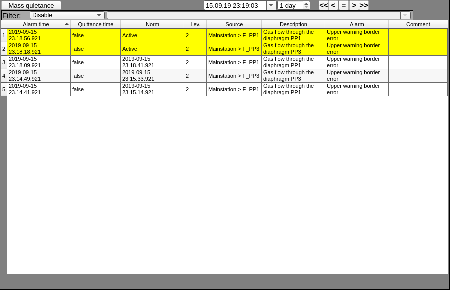

The generic table of active violations — contains coloured rows of actual alarms sorted by their importance with the more important on the top. The widget disabled initially.

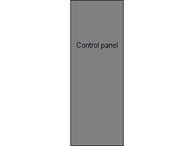

Container of the control panels — container area to include control panels of various objects in the container area of the main frames, for example — panel of the parameter, document, graph and more.
Under the control panels container placed a button to start the demo mode — mode in which performed periodic switching for representative frames, changing regimes and other operations by a scenario.
Fig.2a. The "Root page (SO)" frame in the development mode.
Using — development
This widget can be used only in the root page mode that should be placed in the project's tree as an element "so". Additionally, around the main page should be made following tree hierarchy:
/control/* — logical container, contains a variety of control panels;
/so/ — this frame as a container, contains of logical containers of the signal objects:
{n}/ — logical container of the signal object n (1...), contains logical containers and templates of the types of view:
[view1|mn]/* — the type of view 1 (typically and early it is the mnemonic schemes), contains a lot of pages of the end frames;
[view2|ggraph]/* — the type of view 2 (typically and early it is a template of the graphics group), contains a lot of pages of the end frames;
[view3|gcadr]/* — the type of view 3 (typically and early it is a template of the contours group), contains a lot of pages of the end frames;
[view4|gview]/* — the type of view 4 (typically and early it is a template of the overview frames panel), contains a lot of pages of the end frames;
[view5|doc]/* — the type of view 5 (typically and early it is a logical container of the documents), contains a lot of pages of the end frames;

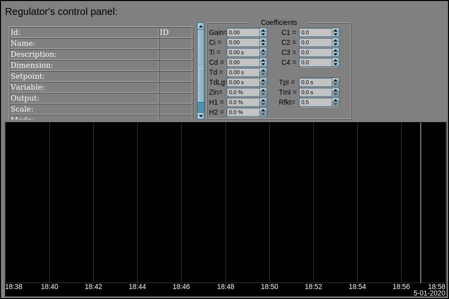

greg/* — the specific page template of the PID-regulator configuration, contains a lot of pages of the end PID-regulators configuration, statically connected and which are call only by the "PID" button of the element cadre.
[view6|rg]/ — logical container of the global type of view 6 (typically and early it is the result graphics — common graphs for the entire interface):
[view6|rg]/* — the type of view 6 (typically and early it is a template of the result graphics), contains a lot of pages of the end frames.
At.png Identifiers of the pages of the types of view, specified as [view1|mn], must be specified in the tree either in the new scheme "view1" or in the old scheme "mn". Mixing is not supported and the view items must not be empty, that is contain at least one active page!
As the text of the signal object buttons, there are used name of the logical container with the corresponding n identifier. The description of this container also takes the text of the tooltip to this button if it is not empty. Description of the container also taken into tooltip for this button, if it is not empty.
All further adjustments and edits around this frame must be made for its copy-link in the project tree, and it is strongly not recommended to edit it in the library, otherwise you will lose the ability to update the library or these changes when updating it!
The text and the tooltip of the buttons of the types of view are directly changed in the corresponding properties of these widgets. The fast keys of the type of view are taken from the toolbar brackets, such as "Graphs (CtrlAlt+G)", and processed accordingly. To change the image of the type of view, it is enough to override the icon of the corresponding view, such as "view1", by loading the image with the appropriate name in the project Mime-data.
To enable the generic table of active violations just set 1 (one) in the frame links configuration for "alarms > en".
To enable and configure the returning to some non privilege user after some time of the inactivity just set {minutes)-{user} in the frame links configuration for "defUser".
You can change the image of the logo in the same way as the image of the type of view, that is, upload a new image called "logo" to the project's Mime-data, and then adjust the geometry of the logo widget to the desired proportions. You can move the image widget to the left by moving the signal object button to the right by the size of the logo. If you do not need the logo at all then to nullify the widget width, but do not remove it!
Potentially, you can also move the navigation bar and the control panel container to the left by moving the main frame container, and maybe the signal object button, to the right.
If necessary, the root page can be appended with additional elements that do not require special processing, that is, changes to the initial procedure of the frame, that is no longer using but editing. At.png It should be noted here that reducing the size of the containers will lead to the appearance of scrollbars and-or will require adjusting the frames of placement in the container but this may not be necessary given the extension of the container to unused button rows of the signal objects.
Using — runtime
When starting the frame in the runtime mode, there are first constructed the buttons of the signal objects, which are formed in two rows, after which the container of the main frames expands up for one row if there is enough one, or for two if the signal object is one. Next, there are formed buttons of the types of view, present of which are activated and expanded to fill the space of the missing ones.
After the dynamic forming, the frame periodically controls the frame change in the main frame container, which is displayed by the corresponding background color in a button of the signal object and the type of view to which the frame belongs. Between the listing buttons, information about the total number of frames and the current position is updated, and the buttons themselves are activated according to the possibility of listing in the current frame position. For the combobox of direct frames selection from list, respectively, the current list of frames is formed and the name of the current one is set. It also monitors the status of violation-notification of the signal objects, which is accordingly displayed by the text color of the buttons of the signal object and its flashing, as well as the quietation buttons are activated or deactivated.
At.png The frame supports now of working with very big "Periodic processing" value or disabling the periodic processing in whole (the value -2) and that value also propagated to the child pages and widgets if they want such behaviour (the value -1). That is possible by a mechanism of the events early processing and the possibility of control the processing periodicity from the procedure.
Changing of the frame in the control panel container are not tracked and their are generally called from the main frame interface, unless it is cleared by changing the main frame by opening the panel-terminator.
From the basic actions, the frame allows the user to select the signal object, the type of view and the corresponding frame. By pressing the button of the signal object, the type of view, directly selecting in the combobox or listing; resulting in a call to the corresponding frame in the main frame container. From the ancillary actions, the user can quiet the violation-notification and start the Demo-mode, if one provided. The default frame setting involves servicing a number of hotkeys, such as CtrlAlt+[1...0] to call the signal objects 1 to 10, and CtrlAlt+[MGCVDR] to call appropriate types of view.
Fig.2b. The "Root page (SO)" frame in the runtime mode.

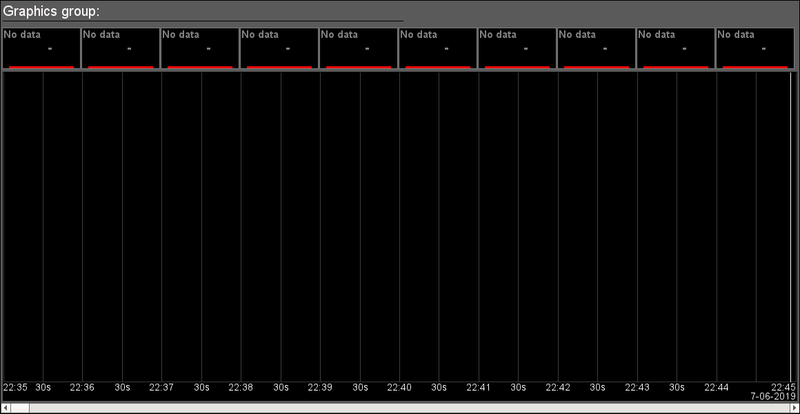

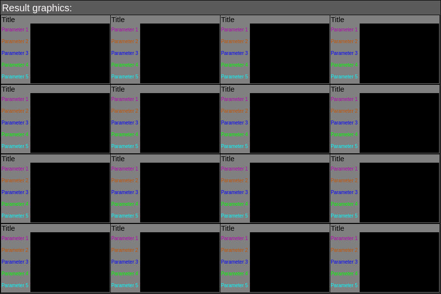

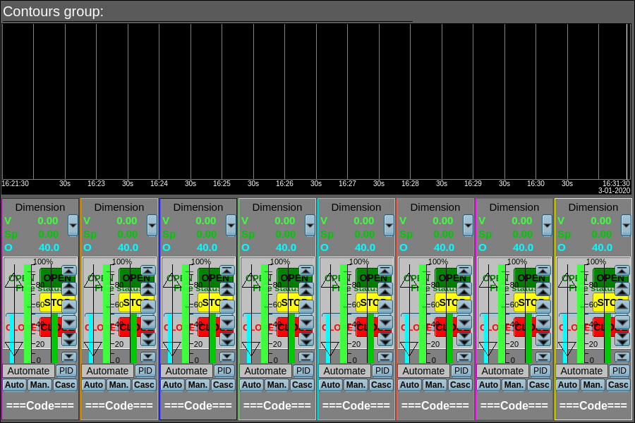

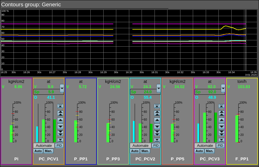

3.1 Graphics group (grpGraph); Graphics group 10 (grpGraph10)
1.6 GPLv2 * en, uk, ru Roman Savochenko -1 ms (parent)

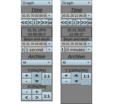

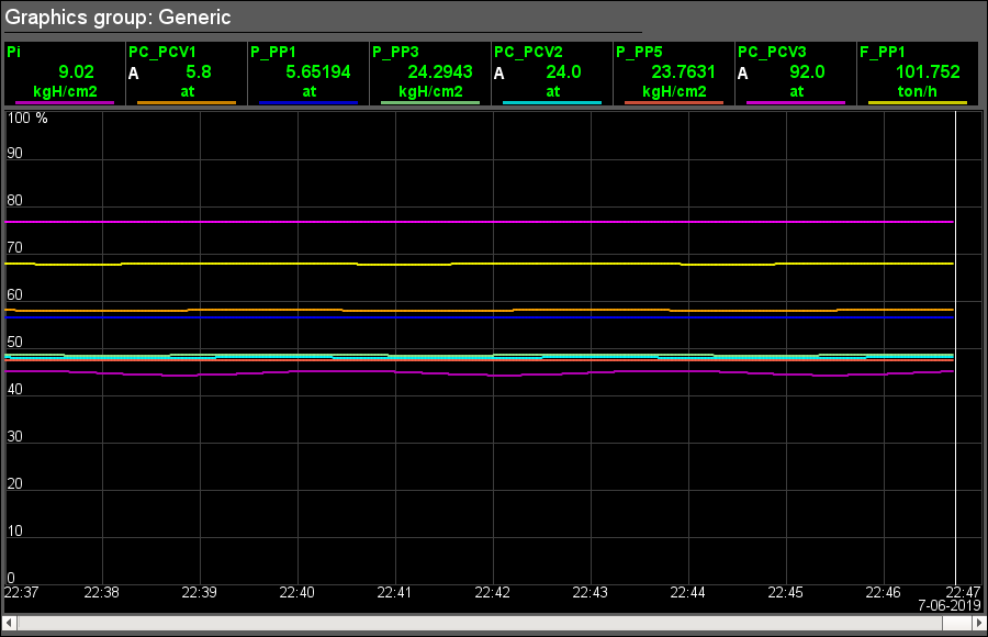

The element-frame shown in Figure 3.1 is provided for simultaneous observation of trends and control the parameters in the signal object, includes both instances of the widget "Graphics group element" of each parameter (up to 8 or 10) and the primitive "Diagram" to monitor the parameters' trends and browsing history, and also the scroll bar for fast navigation on allowed history of selected parameters for show. The variant in 10 trends is inherited from the base variant in 8 trends and you can create your own variants by inherit the base and append more graphics group elements.
Fig.3.1a. The "Graphics group" frame in the development mode.
Using — development
The frame is designed to perform the role of page-template, and should therefore be placed directly in the project's tree. In the project-template "Signal groups", for each signal object, this frame is included in the role of a template that allows you to create on its basis a set of pages of the graphics group. To each frame can be connected up to eight-ten parameters, setting the links. Trends, for which there are not set the links, will be hidden at runtime or allowed for user's selection at case of presence the list of the parameters to select in the attribute "Select: parameters accessible to select" (the list format described in the parameters selection dialog).
The default trend depth in the past is set at 10 minutes — for current operational control, which can be changed directly by editing the corresponding field of the diagram widget, for example, for the project template page, to spread to all end pages.
Using — runtime
In the runtime mode, the trends, for which links have been set, are displayed. Control of the parameters from the graphics group element, described in detail in the section of the "Graphics group element (ElViewGraph)" widget. Additionally you can control the display properties of graphs, for what, together this page, there automatically opens the graph control panel or you have to click the left mouse button in the graph area.
At.png The frame supports now of working with very big "Periodic processing" value and that value is set now to inherit from parent page/session (the value -1). That is possible by a mechanism of the events early processing and the possibility of control the processing periodicity from the procedure.
Fig.3.1b. The "Graphics group" frame in the runtime mode.

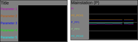

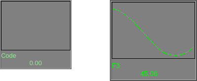

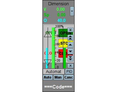

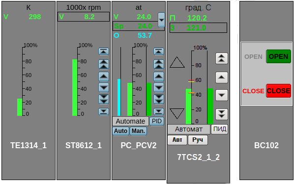

3.1.1 Graphics group element (ElViewGraph)
1.5 GPLv2 * en, uk, ru Roman Savochenko 2000 ms
The element-widget shown in Figure 3.1.1 is provided to create graphics groups. The widget contains information about parameter, the regulator mode, if the parameter is such, the units of analog parameter, as well as the color corresponding to the parameter's trend. The widget commonly uses and represents the representative structure of the DAQ-templates "Analog signal" and "Discrete block".
Fig.3.1.1a. The "Graphics group element" widget in the development mode.
Using — development
Though this widget is not intended for independent use in isolation from the graphics groups, it can be used, for example, placing it to the mnemonic scheme and linking with the data source parameter.
Using — runtime
In the runtime mode, in the main field of the element, there are displayed the parameter name, the regulator mode (only for the regulators), the current value-variable and the unit of this parameter; which, depending on the presence of a violation, are displayed in the color style: labColorGood, labColorWarning, labColorAlarm. At the hardware errors and non validity the data, the last value is greyed out.
Except the available visual data, a number of control elements are provided:
The widget saves of a user selected parameter in the session table of the project and loads the parameter at next run, include the trend color which default value typically takes from a style.
At.png The widget supports now of working with very big "Periodic processing" value and that value is set now to inherit from parent widget/page/session (the value -1). That is possible by a mechanism of the events early processing and the possibility of control the processing periodicity from the procedure.
Fig.3.1.1b. The "Graphics group element" widget in the runtime mode.

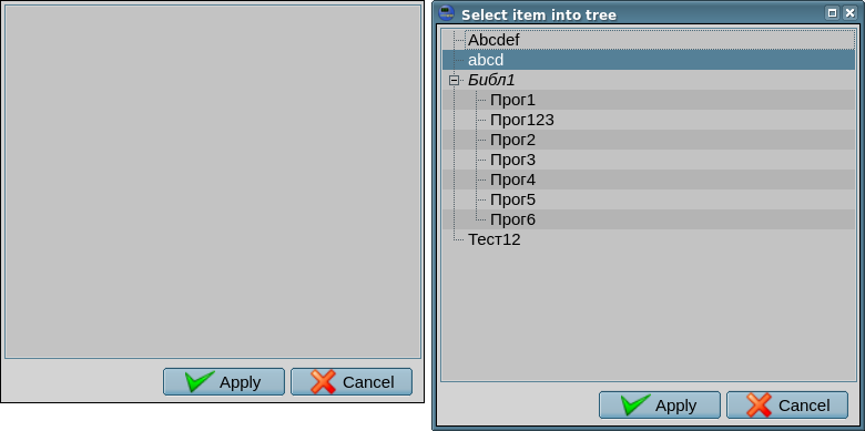

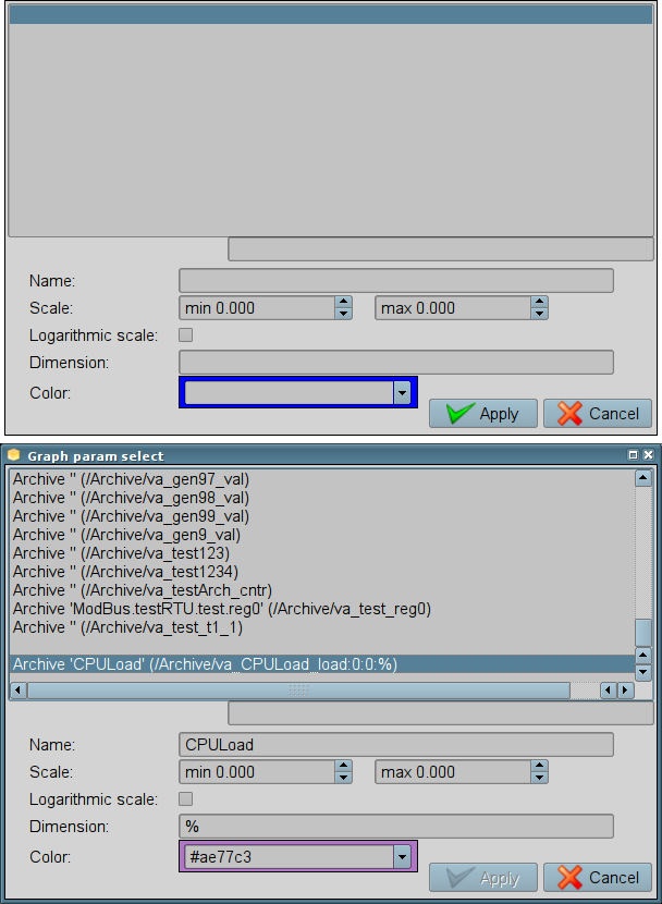

3.1.2 Graph parameter selection (graphSelPrm)
1.5 GPLv2 * en, uk, ru Roman Savochenko -1 ms (parent)
The element, shown in Figure 3.1.2, implements a dialog of selection the data source, often the archive ones, for the trend formation in the "Graphics group" frame. Selection is provided from the list, specified in the attribute "Select: parameters accessible to select (allowSelLst)" of the frame-initiator. For the selected source you can specify the name, scale, logarithmic scale, dimension and the color of the trend.
In the "Select: parameters accessible to select (allowSelLst)" attribute the data sources should be placed in the following way:
Examples of the "Select: parameters accessible to select (allowSelLst)" attribute's content:
/System/AutoDA/prm_CPULoad/load:CPU Load:0:100:%
/LogicLev/gen/prm_F3
<varhs>
Fig.3.1.2. The "Graph parameter selection" frame in the development and runtime mode.
Using — development
This frame should be placed to the panels' logical container of the project tree. The "Select: parameters accessible to select (allowSelLst)" attribute must be defined to a list of sources according to the rules described above in the "Graphics groups", which should provide the selection of the sources by the user. As a result, the "Select" item will appear in the context menu of the Graphics group element.
Using — runtime
Calling the dialogue is made by the "Select" item of the Graphics group element context menu. The dialogue provides the user to the possibility of selection the data source from the list, as well as an indication of its basic parameters: name, scale, logarithmic scale, dimension and the color of the trend, which you also can select typical/styled one by clearing. When you accept the dialogue the selected parameters are applied to the graphics group element chart, replacing the links. The "<Clear>" item selection and applying causes to clearing all the links and the graph's item. Into a text field under the list you can rapidly find any needed parameter.

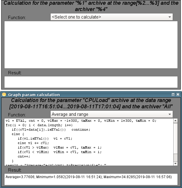

3.1.3 Graph parameter calculation (graphCalc)
The element, shown in Figure 3.1.3, implements a dialog of user calculation of the selected graph parameter for the graphically visible data. The user is given an option to select calculations from the built-in library, the privileged user ("root" or in the "ITW" group) has the opportunity to edit or write their own calculation procedure.
In general, the built-in library currently contains the following functions of the user calculation:
Fig.3.1.3. The "Graph parameter calculation" frame in the development and runtime mode.
Using — development
Using — runtime
Calling the dialogue is made by the "Calculation" item of the Graphics group element context menu. The dialog gives the user the choice of the function of calculation the visible data of the selected parameter and the ability to edit-write their own function, for the privileged user. The calculation result is located in the corresponding text box.

1.3 GPLv2 * en, uk, ru Roman Savochenko -1 ms (parent)
The element-frame, shown in Figure 3.2, provides for simultaneous monitoring and control of contours of several parameters, up to eight, includes both instances of the widget "Element cadre for each contour, and the primitive "Diagram" to monitor the trends of the contours and viewing history.
Fig.3.2a. The "Contours group" frame in the development mode.
Using — development
The frame is designed to perform the role of page-template, and should therefore be placed directly in the project's tree. In the project-template "Signal groups", for the first signal object, this frame is included in the role of a template that allows you to create on its basis a set of pages of the contours group. To each frame can be connected up to eight parameters, setting the links. Contours and trends, for which there are not set the links, will be hidden at runtime.
Using — runtime
In the runtime mode, the contours and trends, for which links have been set, are displayed. Control of the parameters by contours, described in detail in the section of the "Element cadre" panel. In addition to this you can control the trends display properties, which requires the left mouse button to click in the trend's area and by means of appeared trend's control panel to make the necessary actions.
Fig.3.2b. The "Contours group" frame in the runtime mode.

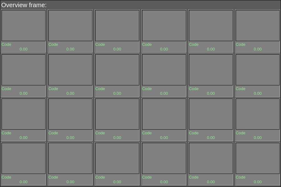

3.3 Group of overview frames (ViewCadr)
1.1 GPLv2 * en, uk, ru Roman Savochenko -1 ms (parent)

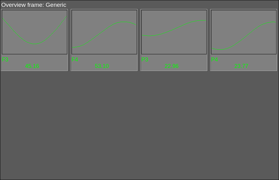

The element-frame shown in Figure 3.3 is used to display the current parameter trends in individual frames-widgets with up to 24 units (6x4) for which scaling is supported depending on their configured number. The frames-widgets of the parameter trends are implemented with the satellite widget "Frame of the group of overview".
Fig.3.3a. The "Group of overview frames" frame in the development mode.
Using — development
The frame is designed to perform the role of page-template, and should therefore be placed directly in the project's tree. In the project-template "Signal groups", for the first signal object, this frame is included in the role of a template that allows you to create on its basis a set of pages of the group of overview. Frames-widgets, for which there are not set the links, will be hidden at runtime and will be performed the proportional scaling to missing full rows and columns to fill the entire frame.
Using — runtime
In the runtime mode, the frames-widgets, for which links have been set, are displayed. Control of the parameters from the frames-widgets, described in detail in the section of the "Frame of the group of overview" widget.
Fig.3.3b. The "Group of overview frames" frame in the runtime mode.
Identifier Name Type Configuration Configuration template Description
name Name String Constant Frame's name
Frame-widget {r}_{c}, where {r} — rows from 1 to 4 and {c} - columns from 1 to 6.
el{r}_{c} The list of linked parameters corresponds to ones of the "Frame of the group of overview (ElViewCadr)" widget

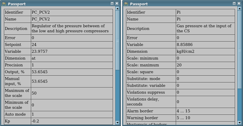

3.3.1 Frame of the group of overview (ElViewCadr)
1.2 GPLv2 * en, uk, ru Roman Savochenko -1 ms (parent)
The element-widget, shown in Figure 3.3.1, serves as the basis for the group of overview frames and is not usually used independently. The widget displays the text information about parameter in the form of the name and value, and a trend of the parameter for small period of time (2 minutes) to observe the current trend of the parameter with auto-scaling on the value scale. The widget commonly uses and represents the representative structure of the DAQ-template "Analog signal".
Fig.3.3.1. The "Frame of the group of overview" widget in the development and runtime modes (left to right).
Using — development
Though this widget is not intended for independent use, in isolation from the group of overview frames, it can be still used, for example, placing it to the mnemonic scheme and linking with the data source parameter.
Using — runtime
In the runtime mode, the main field of the element displays the parameter name, the current value-variable and the trend of the parameter; which are always displayed in the style color: labColorGood.
In the active mode of the element you can obtain the parameter passport clicking the right mouse button on the body of the widget. The passport will present all properties of the parameter. Pressing the left mouse button in the widget body will cause to appear in the panels area for control panel of the parameter, and the selection of this widget will be displayed with the blinking frame.
name Name String Input link Parameter|NAME Parameter name (code) for display in the name's field.
addr Address Address Input link Parameter|var Address to the value attribute of the parameter to construct the trend.
var Variable Real Input link Parameter|var Directly the parameter value to be displayed in the value field.
3.4 Result graphics (ResultGraph)
The element-frame shown in Figure 3.4 is used to display a group of the current parameter trends (up to 5) in individual frames-widgets with up to 16 units (4x4) for which scaling is supported depending on their configured number. The frames-widgets of the parameter trends are implemented with the satellite widget "Frame of the result graphics".
Summary the total number of displayed graphs in one frame reaches 80, and it is intended to form a separate type of view that is used outside the signal objects — globally for the entire visualization project.
At.png The frame doesn't support any control.
Fig.3.4a. The "Result graphics" frame in the development mode.
Using — development
The frame is designed to perform the role of page-template, and should therefore be placed directly in the project's tree. In the project-template "Signal groups", at the root page level it has a special virtual page "Result graphics" with the result graphics template, that allows you to create on its basis a set of pages of the result graphics. Frames-widgets, for which there are not set any links, will be hidden at runtime and will be performed the proportional scaling to missing full rows and columns to fill the entire frame.
Using — runtime
Fig.3.4b. The "Result graphics" frame in the runtime mode.

3.4.1 Frame of the result graphics (ResultGraphEl)
The element-widget, shown in Figure 3.4.1, serves as the basis for the result graphics and is not usually used independently. The widget displays the name of the group and up to five trends, with their text labels, over a fixed period of time (10 minutes) to observe the current trend of the parameters. The widget commonly uses and represents the representative structure of the DAQ-template "Analog signal".
Fig.3.4.1. The "Frame of the result graphics" widget in the development and runtime modes (left to right).
Using — development
Though this widget is not intended for independent use, in isolation from the result graphics, it can be still used, for example, placing it to the mnemonic scheme and linking with the data source parameter.
Using — runtime
In the runtime mode, the main element field displays the group header, headers and trends of the parameters in the configuration-defined or styled colors.

3.5 Regulator's control panel (cntrRegul)

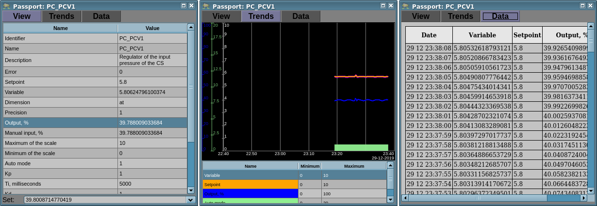

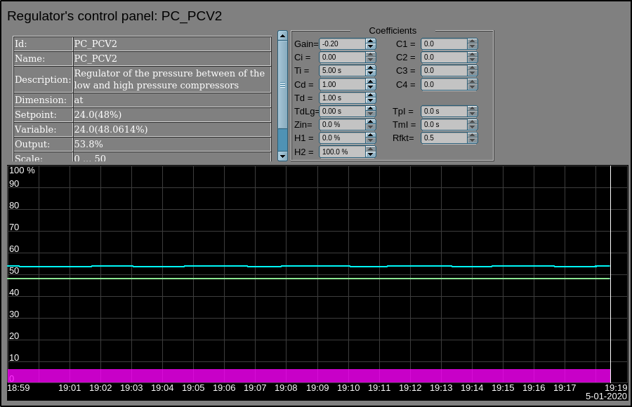

Element-frame, shown in Figure 3.5, is used for adjustment of PID-regulator, includes information about the parameter-regulator, fields of the regulator's settings and the "Diagram" primitive, to monitor the trends of the regulator and browsing history. The frame commonly uses and represents the representative structure of the DAQ-template for the analog and pulse PID-regulators.
Fig.3.5a. The "Regulator's control panel" frame in the development mode.
Using — Development
This frame can be used as a panel, called from the control of panel of the parameters, as well as a template-page. The frame should be placed directly in the project's tree, namely to the panels container, where the dynamic linking will be performed to the regulator parameter. To create a static list of contours of the regulators' configuration, with the possibility of listing in it, you must place them in the container "greg" of the regulators' contours of each signal object and statically link them with the corresponding parameter, and to ensure equality of the panel's ID and the linked parameter.
The default trend depth in the past is set at 20 minutes — for current operational control, which can be changed directly by editing the corresponding field of the diagram widget.
Using — runtime
In the runtime mode, you can see:
Users have an ability to change the PID-regulator's coefficients, mode, set-point, output and immediately to see the reaction on the diagram. In addition, the user may learn the history of the regulator work, which requires the left mouse button click in the graph area and by means of appeared trend's control panel to make the necessary navigation actions. To return the control panel of the parameter the left mouse button must be clicked in an empty area of the frame.
Fig.3.5b. The "Regulator's control panel" frame in the runtime mode.

3.6 Alarms — state (alarmsSt)

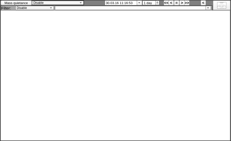

The element-frame in Figure 3.6 serves to display the violations history and to update their dynamically for the current time in a full-format tabular form, to highlight them in color and text and the possibility of multilevel filtering. The violations are obtained from the buffer of current-active violations of OpenSCADA and archive(s), specified in the configuration field "alArch". In fact, the element implements the primitive "Protocol" functions for violations and extension opportunities.
The frame in general contains elements:
According to the announced list of the control elements, message sorting can be modified by the user, both by the built-in column sorting mechanism of a single visualizer and at the data model level, if such function the visualizer is not provided. Considering the basic purpose of the frame is the status of the violations (ie history), the default sorting rule is the "last" to the messages top.
The frame is created, and is usually used, in pair with the widget of dynamically display the active violations, which is completed with main features of this frame but only for active violations and in the small widget.
The main user extension is the ability to define visible table fields from a list of options:
At.png This frame and its fields generally represent the structure of the violation message, which is described in detail in the Program manual.
As you can see from the list of possible table fields, this item supports confirmation, commenting, and user fields.
Fig.3.6a. The frame "Alarms — state" in the development mode.
Using — development
The widget is designed to perform the role of page, and should therefore be placed directly in the project's tree. After adding, the frame must be adjusted for the properties, such as the list and the order in which the table fields are displayed.
At.png Because the frame displays the status and the history of the violations, the creation and use of the message archiver is mandatory. Therefore, create or use a template archiver "Alarms" of the startup project with duplicate exclusion options, and specify it (FSArch.alarms) in the frame property "alArch".
The combobox of selecting sorting rule is disabled by default for the sake of using the built-in column sort function of the table of the corresponding visualizer. If this feature is not provided by the visualizer then enable this combo box.
If you want to exclude the validation function then you have to exclude the validation time "qttm" from the list and make the table element inactive.
The report building at the table data is also disabled by default. To enable it, you have to place the frame of alarms reporting in the logical container of panels of the project tree and then enable the characteristic report generation button in the upper right corner of this frame.
Using — runtime

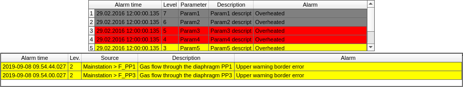

In the runtime mode, a table is created from the active violations list, for the current time, and violations from the history by defined fields, with the activity control and marking and rules of the highlighting; the contents of which are updated periodically and dynamically for the current time.
The user can use the navigation bar to determine the time interval of the data in the table, specifying the top-end and depth of the required data. In the process of requesting too tight data spaces, only the number of messages specified in the property messLim will be readable, and the user can use the button in the navigation bar, what appears in that case, to move to the next piece.
The data obtained in the table can be filtered by the content of the column selected accordingly, which can be performed at up to five levels, the filter elements of which will appear after the last filter level is selected.
The user is given the opportunity to confirm the violation, by changing the value of the confirmation time field or by using the control panel that pops up after selecting the table element and the violation item. The user may also confirm all active violations by clicking the mass confirmation button.
If there is a column sort function in the visualizer, or enable sorting at the data model level, the user can select a column to sort the table rows at that content.
The user may also comment on the violation by correcting appropriate field of the table.
To generate a separate report, the user can click the characteristic button in the top right corner if this feature is enabled.
Fig.3.6b. The frame "Alarms — state" in the runtime mode.

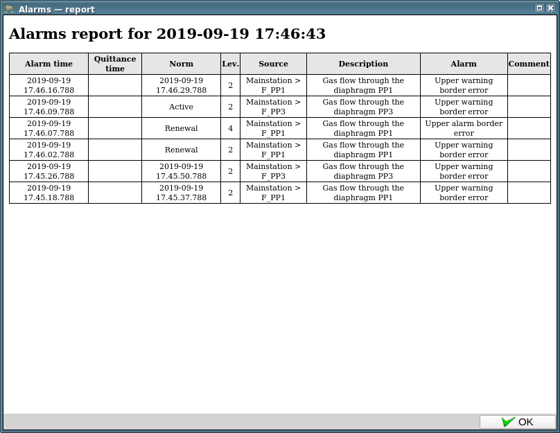

3.6.1 Report (alarmsStReport)
The element-frame, shown in Figure 3.6.1, implements a dialog to display a report document based on a list of violations received from the full-format frame of presenting the violations history.
The main purpose and function of this frame is to provide an opportunity to print the violations history table and export data from it.
Fig.3.6.1. The frame "Alarms — report".
Using — development
Using — runtime
Calling the dialogue is made by a characteristic button, at the top right, of the full-format frame of presenting the violations history. The dialog provides the text of the report document and a button at the bottom right to close it.

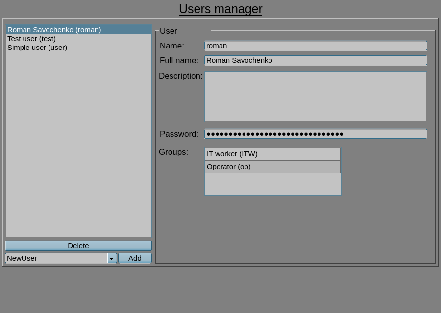

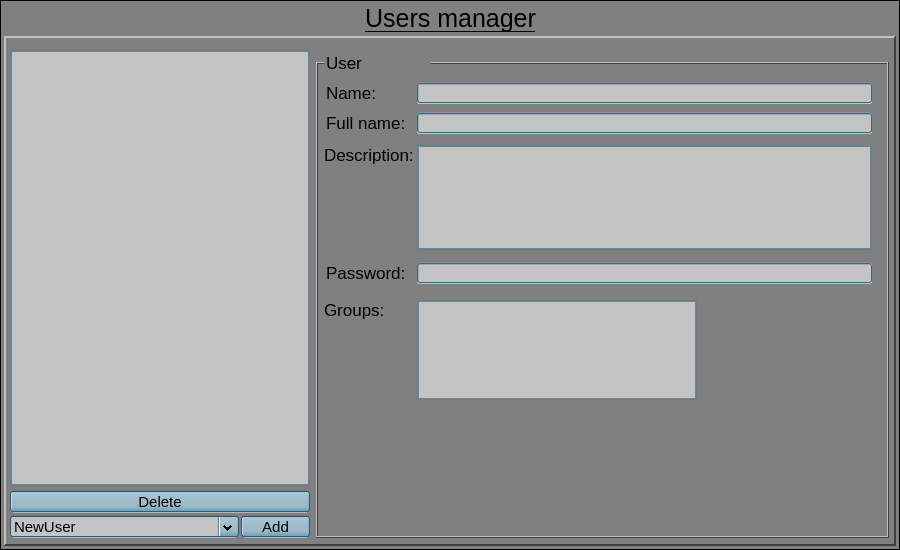

3.7 Users manager (userManager)
1.7 GPLv2 * en, uk, ru Roman Savochenko -2 ms (disabled)
The element-frame, shown in Figure 3.7, serves to control users from the user interface itself. That is, typically this feature is provided to the SCADA programmer at the Security subsystem configuration, but sometimes there is a need to provide this capability from the user interface and with a few restrictions on controlled users and their groups that this frame performs and generally provides:
Fig.3.7a. The "Users manager" frame in the development mode.
Using — development
The widget is designed to perform the role of a page, and should therefore be placed directly in the project's tree. Additionally, into the panels folder of the project, you need to place the acception dialog frame and some attribute configuration is required, below, where no links are provided.
Using — runtime
In the runtime mode, a list is formed with available users and, at their selection, on the right displayed their information that can be changed. The user can be added and removed by the appropriate interface commands under the list of users.
Fig.3.7b. The "Users manager" frame in the runtime mode.
owner Owner String Owner and group of the frame that have access to it, typically "root:Security" — to allow the frame to be accessed, the user must be included in the "Security" group.
perm Access Integer numbers selection Frame access rules, typically "RWRW__" — the frame is viewable and controllable only for "root" and users in the "Security" group.

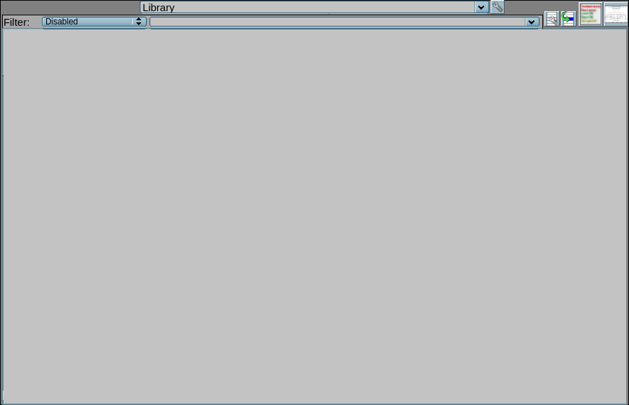

Fig.3.8a. The "Storehouse" frame in the development mode.
Using — development

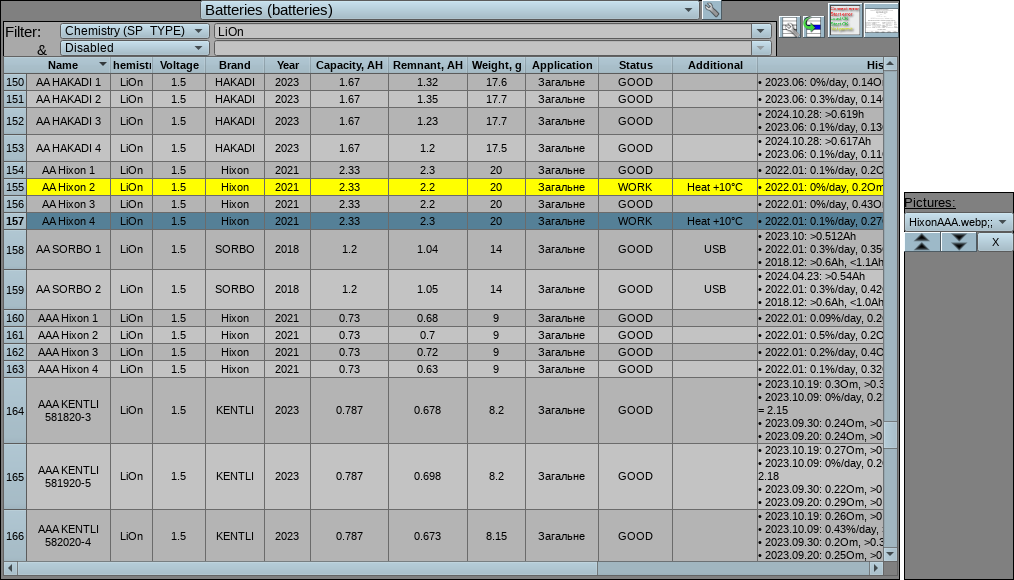

In the runtime mode you will see a single big table for class (Fig.3.8b) and data (Fig.3.8c) representing with edition right in the table or in the item edition form (Fig.3.8d).
In the main class data representing mode the users can observe the table, filter and sort the representing data at the specified fields.
In the main class data edition mode the users, allowed to edit, can add, copy, remove the rows/records and edit the fields.

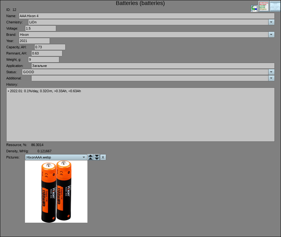

Fig.3.8d. The "Storehouse" frame in the runtime mode at the item edition form.

The element shown in Figures 4.2 is in fact a universal panel of generic and extended control by different devices for all known and defined representative structures of the basic data of the control systems at the DAQ-templates:
In the primary function of the pannel — advanced and common control, this item is called from:
If this element using as a control panel is not required, it is firstly in the primary data representing widgets and by their specializing in particular types of data to what a separate panel can be created. Therefore, due to its high universality, due to the support of all known representative structures of DAQ-templates, it is obligatory to use in main frames, as is done in the frame "Contours group".
Fig.4.2a. The "Element cadre" widget in the development mode.
Using — development
The panel does not require any special configuration by the user, it should only be located in the panels folder of the project tree of the concept of the signal objects of the root page "RootPgSo", which will allow it to be dynamically invoked and opened in the control panels container of the root page.
The panel Identifier, when placed, should be saved and its line of call, upon receiving focus, in the events processing attribute "evProc" of the primary widget will look "ws_FocusIn::open:/pg_control/pg_ElCadr".
Using — runtime
Indications of the analog parameter — in this mode, there is no any control, and there are only units displaying, the value's histogram and the name of the parameter.
Manual input of the analog parameter — in addition to displaying indications of analog parameters the buttons to enter a new value are displayed. Enter of the value is displayed in the field at the top, in the backlight rectangle. To validate the input, press the left mouse button in the area of the backlight rectangle, without that the typed value will be reset after a few seconds.
PID-regulator's mode — to the value of a variable and its histogram are added values and histograms of set-point and out of the PID-regulator, the buttons to enter a new value of the set-point or out, as well as the mode adjustment buttons and the field to display the current mode. Also, for the user with appropriate privileges ("root:ITW"), it is available the button to go to a frame to set the coefficients of the PID-regulator. In the case of pulse PID instead of histogram of the analog output it is displayed the status of pulse output with the help of triangles "Up" and "Down" and the manual entry of output leads to direct formation of pulse, respectively down or up.
Mode of the discrete device — in this mode the name and the field of discrete assemble of the parameter are displayed. The field of the discrete assemble contains the current state of discrete device, on the left, and the buttons of commands, on the right. There are two states of the device: "Open", "Closed" and the three commands: "Open", "Close", "Stop". The names of the states and commands can be adjusted during set up. Changing the state of the discrete device is determined by pressing the corresponding command. In direct discrete mode, a combo box is formed with a list of elements from digComs, the current state from st_text and sending commands to com_text.
Every action on this panel (change of PID-regulator set-point, state of the discrete parameter, ...) is recorded in the actions log by the generation of appropriate messages according to the message structure of the operator actions.
For any displayed or controlled parameter the passport can be obtained by clicking the right mouse button on the contour field. The passport will present all the properties of the parameter.
Fig.4.2b. The "Element cadre" widget in the runtime mode.

4.3 Passport, extended (cntrPaspExt)
The element shown in Figure 4.3 is an information-control dialog around the data source parameter — an expanded parameter passport. Unlike the simple passport, the expanded one, in addition to information, provides the ability to control the parameter attributes and display the history of the standard attributes in both a trend and a data table.
Information and control for parameter attributes remains the primary function provided in the "View" tab, where the attribute table is formed as their are, with the "Name" and "Value" columns. The table is active and if you select an entry of the accessible to write attribute and at corresponding permissions (root:op), a field for entering new values will be provided at the bottom.
The history is provided in the following two tabs "Trends" and "Data", which may not be available in the absence of the history-archives at standard attributes. The "Trends" tab contains a graphics area, of the primitive "Diagram", on most of the window, and a table at the bottom with the names, colours, and graph scales. The graphs are updated periodically and built with a period of 1 second and a fixed depth of 1 hour. The "Data" tab contains only the "Document" primitive field with a table with attribute values in columns that is updated with a period of 1 second for the history data period and to a depth of 100 records. The following items of the representative parameter structures are considered standard attributes with history:
In the trends of the analog parameters building the attributes are separately processed for alarm [aMin...aMax] and warning scales [wMin...wMax], which are also displayed in the graph.
At.png This dialogue is currently the main one and has replaced the simple passport dialogue.
Fig.4.3. The "Passport, extended" dialogue in the runtime mode.

The dialogue provides the user in the tab "View" with information about the data source parameter in the list and the values of all the properties-attributes of the parameter in the table. Where writable attributes may be edited at the permissions "root:op" in the appeared at the bottom field for entering new values, at selecting the attribute.
For the history the user may observe the trends in the tab "Trends" and the data in the tab "Data". For the trends the user may also highlight some one, selecting it in the bottom table, and correct the scales if it is wrong.

4.5 Panel of the graphs (grph_panel)
The element shown in Figure 4.5 is a specialised panel for dynamic control of basic user properties of the primitive "Diagram". So, the panel allows you to view graphs of the history for the required period of time and the desired resolution, supports: the scale, the selection of archiver for display and the graphs presentation in a spectrum of present frequencies or XY.
Fig.4.5. The panel of the graphs in the development and runtime modes (left to right).
Using — development

The panel allows the user to:
tSek Trend time DateTime Full link <page>|tSek
tSize Trend size Real Full link <page>|tSize Time size-interval of the graph in the history from the trend time.
trcPer Trace period Integer Full link <page>|trcPer Period of the trend updating-tracing.
type Type Integer Full link <page>|type Graph's type: "Trend", "Spectrum of frequencies", "XY".
valArch Archiver String Full link <page>|valArch
curSek Cursor DateTime Full link <page>|curSek Time of the cursor setting.
curUSek Cursor, microseconds Integer Full link <page>|curUSek Time of the cursor setting, microseconds.
sclVer Vertical scale Real Full link <page>|sclVerScl Percentage of the vertical scale.
sclVerOff Vertical scale offset Real Full link <page>|sclVerSclOff Percentage of the offset on the vertical scale.
sclHor Horizontal scale Real Full link <page>|sclHorScl Percentage of the horizontal scale.
sclHorOff Horizontal scale offset Real Full link <page>|sclHorSclOff Percentage of the offset on the horizontal scale.
sclWin Scale by window Boolean Full link <page>|sclWin Switching the window scaling mode.
sclWinCtx Scale: by window save context Object Input link <page>|sclWinCtx Context of storing of the original scale parameters for return.

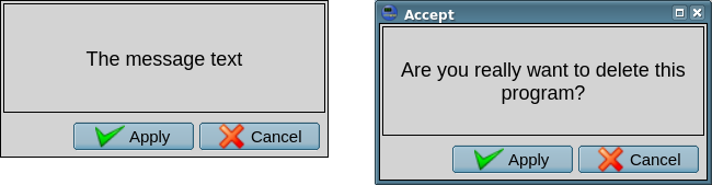

4.7 Accept (accept)
1.0 GPLv2 * en, uk, ru Roman Savochenko -1 ms (parent)
The element on Figure 4.7 implements a simple operations' acception dialog. The dialog contains a message with a question and two buttons "Apply" and "Cancel". The dialogue, for example, is used in the frame Users manager to accept the deleting operation.
Fig.4.7. The "Accept" dialog in the development and runtime mode.
Using — development
The dialogue does not require any special configuration by the user, it should only be located in the panels folder of the project tree of the concept of the signal objects of the root page "RootPgSo", which will allow it to be dynamically invoked and opened as an external dialogue window.
The dialogue Identifier, when placed, should be stored and its line of call, upon pressing the button "progDel", in the events processing attribute "evProc" of the primary widget will look "ws_BtPress:/progDel:open:/pg_control/pg_accept". The question message is taken from the "mess" attribute and the "dlg_Apply" signal is transmitted to the "event" at acception.
Using — runtime
Calling the dialogue is made from the frame-initiator, and closing is made by pressing any button of the dialog. If you click the "Apply" button the "dlg_Apply" signal will be sent to the frame-initiator, by which it can perform the desired actions.
elEvent Element: event String Full link <page>|event It is used to send the "dlg_Apply" event if accepted.
elMess Element: message String Input link <page>|mess Source of the question message in the dialogue.
