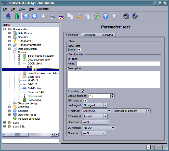

Module DCON provides only one type of parameters — "Standard". On the parameters tab you can set:

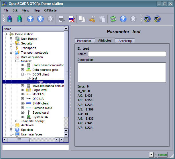

In accordance with the settings of the parameter and the interrogation and creation of the attributes is carried out(Fig. 3).
