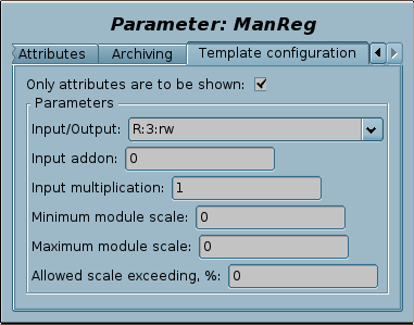

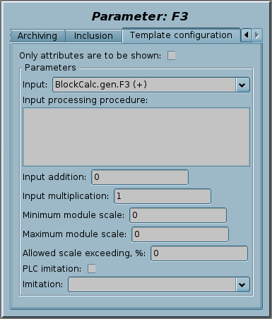

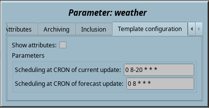

1. Create and start a logical controller object or use any presented one with the need scheduling properties.
2. Create a logical parameter object and select this template for it. Enable the parameter.
3. Into the tab "Template configuration" of the logical parameter object you need to set:
  • Inputlink to a source of the "raw" signal.
  • Input processing procedure — form for the complex preprocessing and complete generation of the analog input on the internal programming language of OpenSCADA. It is optional and should be defined in complex cases, for example:
  • simple and transparent preprocessing to bring the percentage of UPS load to power that can be done with iMult also:
in = 490*in/100;	//the UPS has 480W

  • Minimum and maximum of the module scale — must be set at the case of significant difference the hardware and the generic scales, for example:
  • the input is raw and measured in value of the current [4...20]mA, here it is necessary to specify 4 and 20 mA;
  • the previous case where it is necessary to simply and transparently calibrate the end value — with a precision device set 4mA and 20mA and indicate here the real measured values of the "raw" signal.
  • Input addition and multiplication — use for easy and linear correction of the input, for example:
  • calibration for the end value, which is less transparent and these coefficients should be calculated according to the formulas:
iAdd = ((plcMin*precMeasMax)/plcMax - precMeasMin)*(plcMax/(plcMax-plcMin))
iMult = (plcMax - plcMin) / (precMeasMax - precMeasMin)
  • Allowed scale exceeding — set if necessary to exceed the value of the main border, and when this scale starts to perform the recommendation function, say for the initial display of the trend on this scale.
  • PLC imitation and the imitation input — define at the need to simulate the input as required in the functions.
4. RESULT: Launching the controller object (where this parameter is created) and if it has not been started, we must get the operational data in the tab "Attributes" for: variable, error status; and the generation of violations if the state of the error is nonzero.

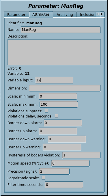

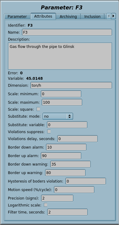

5. In the process of the working, through the tab "Attributes" of operational data, in addition to obtaining the result, it is possible to perform operative setup and control on:
  • Scale: minimum and maximum — strictly At.png set to the range of data changes by availability and according to the hardware border, otherwise the value will be distorted! In the absence of the hardware border, this, the main border, is arbitrary and advisory, although exceeding of the border by the value will be also accompanied by a violation.
  • Scale: square — set if the hardware border is square one.
  • Filter time — set the filtering time for noisy signals.
  • Substitute: mode and variable — set the desired substitution mode at invalidity the variable.
  • Violations suppress — set at the need of the parameter violations complete suppression — to disable their generation in whole.
  • Violations delay — set the delay time for the generation of the violations, to exclude frequent generation, characteristic to uncertain sources of data, characterized by short-term loss of communication.
  • Border up/down alarm/warning — set when it is necessary to generate violations at the exceeding of the alarm/warning borders.
  • Hysteresis of borders violation — set the hysteresis of removing the violation, that is, removal of the violations occurs at the specified percentage later, in order to prevent the frequent generation by fluctuating the value near the border.
  • Motion speed — set if it is necessary to warn about fast change of value.
  • Name, Description, Dimension, Precision, Logarithmic scale — set this information as need when displayed, or as an element of the passport.
  • Input/Outputlink to a source of the "raw" IO signal, or do not link for the stand-alone mode.
  • Minimum and maximum of the module scale — must be set at the case of significant difference the hardware and the generic scales, for example see the template "Analog signal, unified".
  • Input addition and multiplication — use for easy and linear correction of the input, for example see the template "Analog signal, unified".
4. RESULT: Launching the controller object (where this parameter is created) and if it has not been started, we must get the operational data in the tab "Attributes" for: variable, error status; and the generation of violations if the state of the error is nonzero; and it will be allowed to set new values.

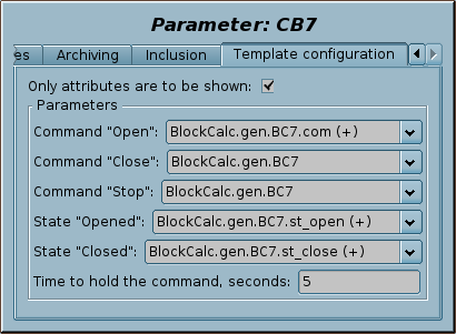

1.4 Discrete block, unified (digitBlockUnif)
1.0 GPLv2 * en, uk, ru Roman Savochenko
Result and the operative setup.
Common, representative and unified template of the block for union of Discrete parameters for the common control device. The template forms a structure of discrete parameter-block (complex tag) which can be easily connected to most widgets and cadres of the main elements library of the user interface just pointing the parameter object.
The representative structure of discrete parameters (complex tags) is a latch object with two characteristic states and three commands, which in the final representation may have a different meaning and name:
Significant graphical shapes representing the structure:
Functions
Template IOs
Identifier Name Type Mode Attribute Configuration Value
com Command "Open" Boolean Output Full access Link com
close Command "Close" Boolean Output Full access Link close
stop Command "Stop" Boolean Output Full access Link stop
st_open State "Opened" Boolean Input Read only Link st_open
st_close State "Closed" Boolean Input Read only Link st_close
tCmd Time to hold the command, seconds Integer Input Not attribute Constant 5
last_cmd Last command Integer Output Not attribute Variable 0
w_tm Process command counter Real Output Not attribute Variable 0
f_err Function error String Input Not attribute Variable 0
f_frq Frequency of calculation of the function, Hz Real Input Not attribute Variable 1000
f_start Function start flag Boolean Input Not attribute Variable 0
f_stop Function stop flag Boolean Input Not attribute Variable 0
Configuration.
Configuring and using

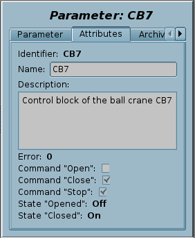

4. RESULT: Launching the controller object (where this parameter is created) and if it has not been started, we must get the operational data in the tab "Attributes" for: states and commands.
5. In the process of the working, through the tab "Attributes" of operational data, in addition to obtaining the result, it is possible to perform operative control, performing the commands:

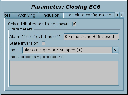

  • "Alarm "{st}:{lev}:{mess}" — define the criterion for the violation formation, leave blank to disable the violations generation.
  • "State inversion" — set to invert the representative attributes, that is, "st_open" set for "in" equal to false.

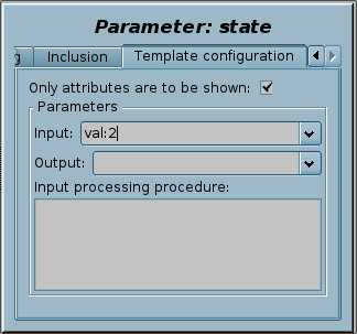

1.6 Code state (codeState)
1.4 GPLv2 * en, uk, ru Roman Savochenko
A variant of the common, representative and unified template of the block for union of Discrete parameters, expanded by more than two states and three commands that can be encoded by an integer value. The template forms a structure of parameter (complex tag) which can be easily connected to most widgets and cadres of the main elements library of the user interface just pointing the parameter object.
The representative structure of the parameter (complex tag) of the code state is:
Functions
  • in [IN|OUT] — IO of the code state;
  • text [OUT] — direct text status setting;
  • coms [IN] — list of available commands, of the corresponded IO;
  • com_text [IN|OUT] — text of the received command;
  • levErr, tErr [IN|OUT] — alarm level [-79...0] and text of the error (the attribute "err" format);
  • f_frq [IN] — frequency of the calculation, the template IO;
  • this [IN] — reference to the parameter object, what executing the template;
  • ctx [IN] — object of the user context, what saved between the execution cycles.
Template IOs
in Input Integer Input Read only Link Signal|in
out Output Integer Output Read only Link Signal|out
inProc Input processing procedure Text Input Not attribute Constant
alSup Violations suppress Boolean Input Full access Variable
alDelay Violations delay, seconds Real Input Full access Variable 0
st_text State "Text" String Input Read only Variable
stats States, rows "{code}:{State}" Text Input Full access Variable
com_text Command "Text" String Input Full access Variable
coms Commands-states, rows "{code}:{State}" Text Input Full access Variable
digComs Commands Text Input Read only Variable
SHIFR Code String Input Not attribute Variable
NAME Name String (translate) Input Not attribute Variable
DESCR Description Text (translate) Input Not attribute Variable
this Object Object Output Not attribute Variable
Configuration.
  • Input and Outputlink to a source of the "raw" signal.
  • Input processing procedure — form for the processing and complete generation-imitation of the input, and issuing of the specific output, on the internal programming language of OpenSCADA. For example:
  • complete creation for the state code and alarms forming:
gO = this.cntr().prm_grps;
if(gO.prm_fansControl.PRG_CntrFan_AutoMode_G1.get().isEVal())	in = 4;
else {
  if(!(tVl=gO.prm_fansControl.PRG_CntrFan_Alarm_ThermalRelay.get()).isEVal() && tVl)
    levErr = -4, tErr = "11:alarm";
  if(gO.prm_fansControl.PRG_CntrFan_AutoMode_G1.get())
    in = gO.prm_fansControl.PRG_CntrFan_On_G1.get() ? 1 : 2;
  else in = 3;
  • forming the clock time text and issuing the time synchronization — direct status text setting and issuing for specific commands:
curTm = SYS.time();
text = SYS.strftime(curTm, "%H։%M %d.%m.%Y");
if(!(tVl=gO.prm_other.PRG_RTC_UNIX.get()).isEVal()) {
  text += " ("+(tVl-curTm).toString(10,0,true)+")";
if(com_text.length && !com_text.isEVal() && (tVl=coms.match("^([^:]+):"+com_text,"m")).length && tVl[1] == 1) {
  gO.prm_other.SET_RTC_New_UNIX.set(curTm);
  gO.prm_other.KEY_RTC_set_time.set(true);

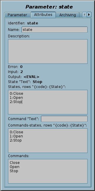

4. RESULT: Launching the controller object (where this parameter is created) and if it has not been started, we must get the operational data in the tab "Attributes" for: input, output, code-input state, error status; and the generation of violations if the state of the error is nonzero.
  • States — set to list of accordance with its status code to text.
  • Commands-states — set to list of accordance with its status-command code to text.
  • Command "Text" — set in the command text, which is described in the command list, for the code conversion and issuance.

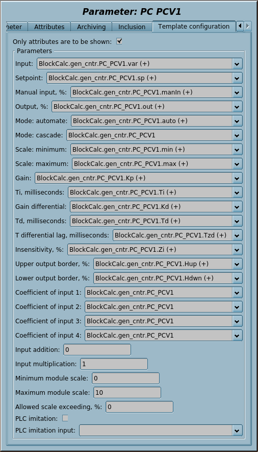

Configuration.
  • Inputlink to a source of the "raw" analog signal.
  • Setpoint, Manual input, Output, Mode: automate, Mode: cascade, Scale: minimum, Scale: maximum, Gain, Ti, Gain differential, Td, T differential lag, Insensitivity, Upper output border, Lower output border, Coefficient of input 1, Coefficient of input 2, Coefficient of input 3, Coefficient of input 4link to a source of the PID-regulator.
4. RESULT: Launching the controller object (where this parameter is created) and if it has not been started, we must get the operational data in the tab "Attributes" for: variable, error status; and the generation of violations if the state of the error is nonzero. Also we will get all the PID-specific attributes.

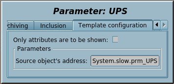

1. Create a source controller object in the module "System" and set its identifier like to "SYSData".
2. Create a source parameter object in the previous controller object and set its identifier like to "UPS".
3. Create and start a logical controller object or use any presented one with the need scheduling properties.
4. Create a logical parameter object and select the template for it. Enable the parameter.
5. In the tab "Template configuration" of the logical parameter object you need to set:
  • Source object's address — to address of the source UPS parameter object (see to step 1) like to "System.SYSData.UPS".
6. RESULT: When running the controller object (where this parameter was created) and if it was not started, we must obtain in the parameter attribute items this object with all the attributes and their properties. In case of some violations, we will get the corresponding information in the attribute of the parameter err, for which you can adjust the attributes of the boundaries of the corresponding violations.

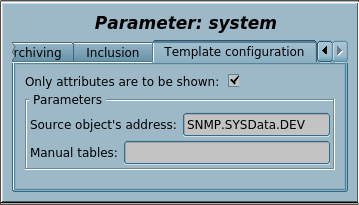

1. Create a source controller object in the module "SNMP" and set its identifier like to "SYSData".
2. Create a source parameter object in the previous controller object and set its identifier like to "DEV".
  • Source object's address — to address of the source SNMP device parameter object (see to step 1) like to "SNMP.SYSData.DEV".
  • Manual tables — enter manually some static MIB-variables.

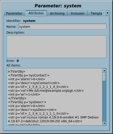

2.3 Disk SMART (DiskSMART)
1.0 GPLv2 * en, uk Roman Savochenko
Data combination of the disk SMART in a complex object of the attribute "All items". The template designed to use together with the DAQ-module "System" in the part "Disk SMART" and to represent this data by the frame "Object properties" as a complex object with properties and signalling at common errors. Some SMART attributes can be unknown or wrong for specified disk due to their missing in the disks DB, especially for modern SSD, so the template provides a feature to redefine names the attributes.
Template IOs
Identifier Parameter Type Mode Attribute Configuration Value
srcAddr Source object's address String Input Not attribute Constant
items All items Object Output Full access Variable
defs Item definitions Text Input Full access Variable
this The object Object Input Not attribute Variable
NAME Name String Input Not attribute Variable
DESCR Description String Input Not attribute Variable
Configuration.

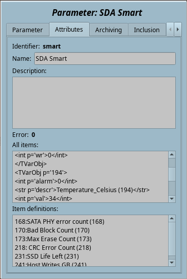

1. Create a source controller object in the module "System" and set its identifier like to "SYSData", set the property "Auto create active data sources" to "All sources" and start by setting "Running".
2. Create and start a logical controller object or use any presented one with the need scheduling properties.
3. Create a logical parameter object and select the template for it. Enable the parameter.
4. In the tab "Template configuration" of the logical parameter object you need to set:
  • Source object's address — to address of the source disk SMART parameter object like to "System.SYSData.DiskSMARTsda".
5. RESULT: When running the controller object (where this parameter was created) and if it was not started, we must obtain in the parameter attribute items this object with all the attributes and their properties. In case of some violations, we will get the corresponding information in the attribute of the parameter err.
6. In the visual interfaces developing of the module Vision place the frame "Object properties" to any page and link it to the parameter object, created in step 3.
7. RESULT: In runtime of the page you get a table with data of the object, notifications about violations in the header and the possibility to redefine names of the SMART attributes.

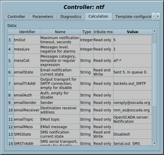

Template IOs
io UserPrt: Output IO Object Input Not attribute Variable
tr UserPrt: Transport Object Input Not attribute Variable
tmOut Maximum notification timeout, seconds Integer Input Not attribute Constant 5
messLev Messages level, negative for alarms Integer Input Not attribute Constant 1
messCat Messages category, template or regular expression String Input Not attribute Constant al*:*
messCatExcl Message exclusion category, in regular expression String Input Not attribute Constant
emailState Email notification current state String Output Read only Variable
emailTrAddr Output transport for SMTP connection, empty for disable String Input Not attribute Constant Sockets.out_SMTP
emailAuth Auth, empty for disable String Input Not attribute Constant user:pass
emailSender Sender String Input Not attribute Constant noreply@oscada.org
emailReceiver Destination receiver address String Input Not attribute Constant test@oscada.org
emailTopic EMail topic String Input Not attribute Constant Notification
emailMess EMail message String Input Not attribute Constant
SMSState SMS notification current state String Output Read only Variable
SMSTrAddr SMS serial transport, empty for disable String Input Not attribute Constant Serial.out_SMS
SMSPin SMS-pin, empty for disable String Input Not attribute Constant 1111
SMSTel SMS destination receiver, tel. number String Input Not attribute Constant +380XXXXXXXXX
SMSTextMd SMS in the text mode, else PDU Boolean Input Not attribute Constant 0
Configuration.
1. Create a parameter in a controller object of the Logical Level or a controller object in the module DAQ.JavaLikeCalc.
2. Create an output transport of the type "Serial" and set its Identifier like to "SMS", one transport suitable for more receivers.
3. Set for proper address, only for the Serial device. The serial port speed, asynchronous data format and timeouts will adjusted by the function.
4. Create an output transport of the type "Sockets" or "SSL" and set its Identifier like to "SMTP", one transport suitable for more receivers.
5. Set-up for proper address, for Sockets(25) or SSL(465). The transport timeouts will be adjusted by the function.
6. In the tab "Template configuration" you need to set:
  • Maximum notification timeout, seconds.
  • Messages level, negative for alarms.
  • Messages category, template or regular expression.
  • Message exclusion category, in regular expression.
  • Output transport for SMTP connection, empty for disable.
  • Auth, empty for disable.
  • Sender.
  • Destination receiver address.
  • EMail topic.
  • EMail message.
  • SMS serial transport, empty for disable.
  • SMS-pin, empty for disable.
  • SMS destination receiver, tel. number.
  • SMS in the text mode, else PDU.
7. RESULT: Sending for the pointed messages at SMS or EMail(SMTP).

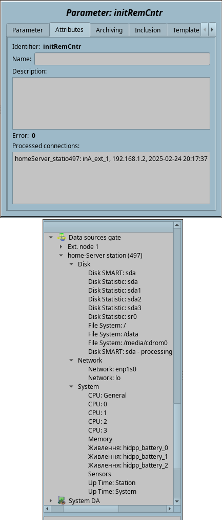

3.2 Control the remote initiative connections (initRemCntr)
1.1 GPLv2 * en, uk Roman Savochenko
The template of processing input initiative connections expands early one template initiative connections processing for the associated output transports by complete representing data of the remote OpenSCADA hosts on some aggregation server and with a possibility of control the remote hosts through the server, that is finishing the conception of data acquisition in the passive mode and the initiative connection.
The template does in whole:
ID of the remote host is formed in the view "{HostDomain}{StatName}{RandKey}" and with limiting to 20 symbols, where:
Data model of the representative Logical Controller can contain both the generated links with processing parameters, and custom parameters, when the user is decided to publish some extra data. The generated items from DAQ.System are represents sources currently:
The aggregated data in DAQ.GAQGate can be lifted to up, or used in derivative DAQ objects, or whether directly on custom frames, or in future on a Dynamic Frame, which scheduled to implement; and without any additional action you will get notification about violations on the hosts.
Template IOs
inTransport Input transport String Input Not attribute Constant Sockets.InitRemCntr
conTm Connection time, ms Integer Input Not attribute Constant 5000
accessTm Timeout of accessing, hours
Used for repeating to create representative objects of not accessed hosts and for removing old connections.
Zero or negative value for disabling the control!
Integer Input Not attribute Constant 24
cntrUser Access: user String Input Not attribute Constant root
cntrPass Access: password String Input Not attribute Constant openscada
cntrObj Control object in DAQ.LogicLev and DAQ.System String Input Not attribute Constant RemCntr
prcTr Processed connections Text Output Read only Variable
this Object Object Input Not attribute Variable 0
Configuration.
1. Create an input transport of receiving the initiative connections of the module "Sockets" or "SSL" with the name like to "Sockets.InitRemCntr".
2. Set the previously created transport to the need address of opening the input socket and move it to the mode of creating the associative output transports, leaving the protocol field in empty.
3. For this template create and run a logical controller object or use any available with the required scheduling properties.
4. Create a logical parameter object and select this template for it. Enable the parameter.
  • Input transport — to value of the identifier of the input transport, created in the item 1, like to "Sockets.InitRemCntr";
  • Connection time — timeout of connection to the initiative hosts after that to close the connection;
  • Timeout of accessing — used for repeating to create representative objects of not accessed hosts and for removing old connections; zero or negative value for disabling the control;
  • Access: user and password — user and password of the remote host with permition of creation there Logical Controller and DAQ.System Controller Object, that is the user must be included to the "DAQ" group;
  • Control object in DAQ.LogicLev and DAQ.System — to ID of managed-created Controller Objects on the remote hosts.
6. RESULT: Starting the controller object (where this parameter was created) and when it was not started, we should get checking the specifying input transport for initiative connections and their initialisation in described above way and with notification processed connection in the attribute "Processed connections".

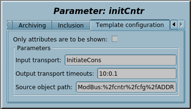

3.3 Initiative connections processing for the associated output transports (initConAssociateTrs)
1.2 GPLv2 * en, uk, ru Roman Savochenko
The template of processing input initiative connections was created to provide the last link of implementation and support for conception of data acquisition in the passive mode and the initiative connection, that is — the control of associative connections, created by the input transport at each connection.
At.png After implementation this control together the new common-unified output transport connection function outAt() that template became deprecated for sources adapted to use the new mechanism, but you still can use the template for not adapted sources.
The function of creation associated output transports at connections is currently only supported by the module "Sockets" and for TCP-sockets.
The control of associated transport means:
The template can control the containers of data source objects, constructed both as DAQ-objects of the controllers and logical level parameters, what representing the data source and having a transport address definition field, and what generally defined by the configuration field "srcObjPath" of the format {CntrAddr}:{TrCntrFldAddr}, where:
Template IOs
inTransport Input transport String Input Not attribute Constant InitiateCons
outTrTm Output transport timeouts String Input Not attribute Constant 10:0.1
srcObjPath Source object path String Input Not attribute Constant ModBus:%2fcntr%2fcfg%2fADDR
prcTr Processed transports Object Output Read only Variable

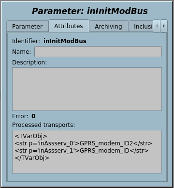

Configuration.
1. Create an input transport of receiving the initiative connections of the module "Sockets" with the name like to "InitiateCons".
3. Provide a container of the data sources to which associative transports must be connected, which can be either a DAQ-module (such as "DAQ.ModBus"), or a logical controller (such as "DAQ.LogicLev.Sources"), or a parameter in it (such as "DAQ.LogicLev.PLC.Sources"), with logical level parameters representing the data source.
4. For this template create and run a logical controller object or use any available with the required scheduling properties.
5. Create a logical parameter object and select this template for it. Enable the parameter.
6. In the tab "Template configuration" of the logical parameter object you need to set:
  • Input transport — to value of the identifier of the input transport, created in the item 1, like to "InitiateCons";
  • Output transport timeouts — increase the first digit for very slow connections and typical is normal in most situations
  • Source objects path — set according to the item 3, for the first part, and to the control field path, for the second part, for example, and typically for for "ModBus", is — "ModBus:%2fcntr%2fcfg%2fADDR".
6. RESULT: Starting the controller object (where this parameter was created) and when it was not started, we should get, in the attribute prcTr of the parameter for information about the processed and therefore successfully transport-linked data sources. In case of some violations, we will get the corresponding information in the attribute err of the parameter. The absence of a representative object for the received identifier is placed in the protocol of messages.

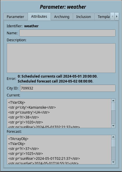

3.4 Weather (weather)
The template of acquiring weather data from different weather services in Internet and initially it is only Open Weather.
The weather data divided on current and forecast with their placing in corresponded objects, where current attributes placed directly in the root and forecast days (the "day" object) and times (the "time" object) inwardly corresponded day according to the current timezone. These data acquired at specified schedule independently for current and forecast, and by default the current ones are performed per hour when forecast ones per day. The data can be accessible by user both as directly and through a specially created widget of the main library.
Template IOs
schedCur Scheduling at CRON of current update String Input Not attribute Constant 0 8-20 * * *
schedFC Scheduling at CRON of forecast update String Input Not attribute Constant 0 8 * * *
city City ID String Input Full access Variable 709932
current Current Object Input Read only Variable
forecast Forecast Object Input Read only Variable
this Parameter Object Input Not attribute Variable 0
Configuration.
1. For this template create and run a logical controller object or use any available with the required scheduling properties.
3. In the tab "Template configuration" of the logical parameter object you need to set:
  • Scheduling at CRON of current update — to value of need scheduling for current data acquiring in the CRON format, at empty the acquiring will be performed with period of execution the controller object;
  • Scheduling at CRON of forecast update — to value of need scheduling for forecast data acquiring in the CRON format, at empty the acquiring will be performed with period of execution the controller object.
4. RESULT: Starting the controller object (where this parameter was created) and when it was not started, we should get the weather data in the attribute Current (current) and Forecast (forecast) and after setting your city code in the corresponded attribute. City code you can obtain from the official site in the URL after searching your city in the site form.

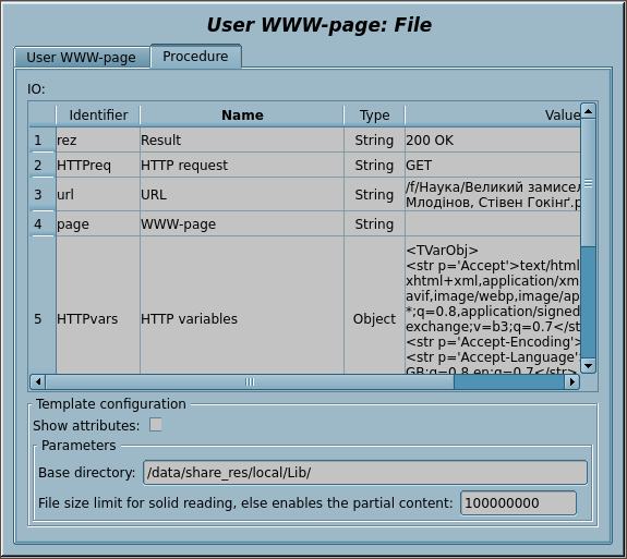

4.1 WebUser: HTTP File Server (fileServerHTTP)
1.2 GPLv2 * en, uk Roman Savochenko
The template for implementing a HTTP File Server directly in OpenSCADA, which is suitable one at missing a full-featured one for functions of servicing file requests from OpenSCADA Web-interfaces.
Currently there implemented only requesting files by the GET request of HTTP. There are supported also chunks and the Partial Content requests in single range and with forcing to this mode at some configured file size.
Template IOs
rez Result String Input Not attribute Variable 200 OK
HTTPreq HTTP request String Input Not attribute Variable
url URL String Input Not attribute Variable
sender Sender String Input Not attribute Variable
page WWW-page String Output Not attribute Variable
HTTPvars HTTP variables Object Output Not attribute Variable
baseD Base directory String Input Not attribute Constant /data/share_res/local/Lib/
fSzSolidLim File size limit for solid reading, else enables the partial content Real Input Not attribute Constant 10e6
tr Transport Object Output Not attribute Variable
prt Protocol Object Output Not attribute Variable
Configuration.
1. Create a page in the UI.WebUser module with some reasonable PageId.
2. In the tab "Procedure" you need to set:
  • Base directory from which the page'll search files.
  • File size limit for solid reading, else enables the partial content.
3. RESULT: Opening URL "http://{OpenSCADAHost}/WebUser/{PageId}/{MyFile}" in a WebBrowser will open and send you file on FS "{baseD}/{MyFile}".
