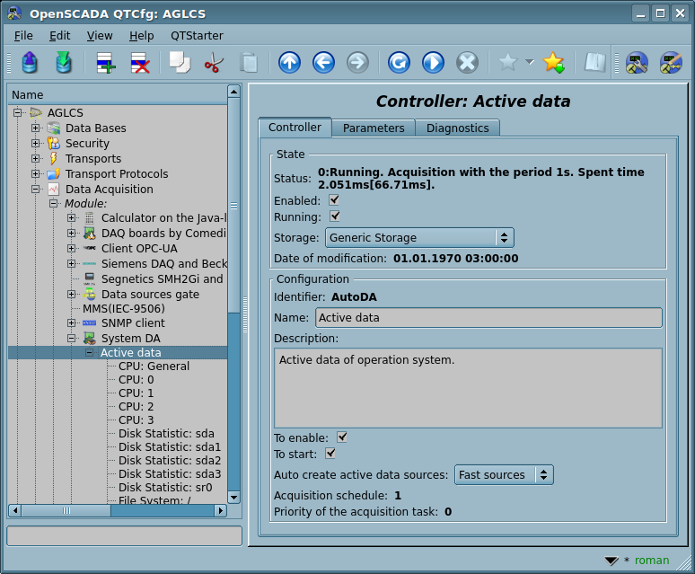

1 Controller object
To add a data source of OS there is created and configured a controller object in OpenSCADA. An example of the configuration tab of the controller object of the given type shown in Figure 1.
Fig.1. Configuration tab of the controller object.

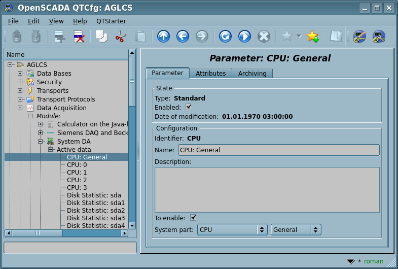

2 Parameters
The module provides only one the "Standard (std)" type of the parameters with the parameters table name "OSPrm_{CntrId}". Additional configuration fields of the parameters of the module (Fig. 2) are:
Fig.2. Configuration tab of the DAQ parameter.
