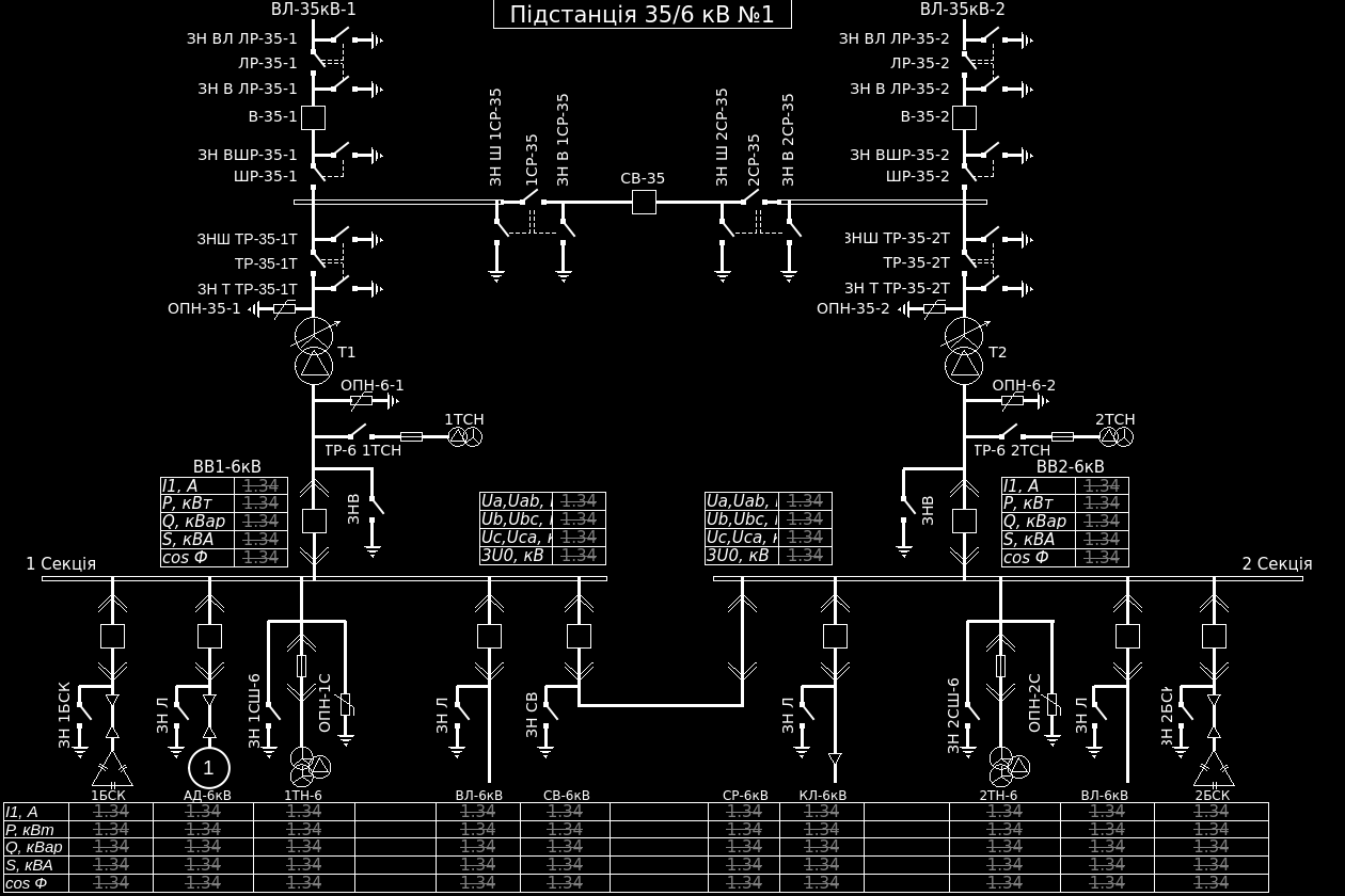

3 Addition 1: Adjustment and fitting of elements, construction of complete electrical schemes
This library contains and is intended for the construction of integral electrical schemes of arbitrary configuration of its individual elements, which need to be visually connected to each other so that there are no obvious displacements along the common axis and the intervals between the connection of visual elements, especially for the connection lines and with the ability to have an equally perfect appearance across a wide range of scales, ideally at all.
The need for wide-scale mnemonic schemes is relevant because of the unified construction of the mnemonic schemes in the resolution 900x600 and the ability to perform them on large resolutions of modern displays, when the zoom factor can now reach 10.
Therefore, all imperfections of the manual fitting there will immediately pop up and spoil the picture, since it is difficult to do without special means and on the initial screen of development it is impossible to see them.
Accordingly, the following rules are recommended for fitting the elements to obtain the desired result:
  1. Aligning elements by axis should be performed by centering, or to the left and to the right for elements with several connections at one side, since they are all unified in size 100x100 and at the condition of providing their systematic arrangement on the mnemonic scheme on the same scale, typically 0.2.
  2. Perfect fit is more difficult because there is currently no tool to draw one element to the nearest border of another, and it is possible only at a separate calculation of the coordinates. Therefore, it is recommended to partially overlap one element to another, at 100% development scale, after the previous rule and according to the algorithm:
    • to pull up the second element to the first, in one pixel step (holding down Shift) until the visual gap disappears, that is, the maximum possible distance remaining there will be 1 pixel;
    • compensate this remain by another step of 1 pixel.
At.png When developing at a scale other than 100%, say 150%, we get a maximum compensation of 1*(150/100)=1.5, ie the compensation steps must be the larger whole (ceil) — 2.
Applying these rules can be quite simple to get the result in the figure:
The mnemonic scheme sample with electrical items.
