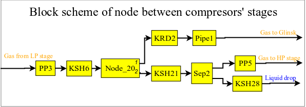

Languages of block programming based on the notion of circuits(functional blocks). Moreover, depending on the substance of the block, block circuits may include: logic, relay logic circuits, a model of technological process, and more. The essence of the block circuit is that it contains a list of blocks and relations between them.
From a formal point of view a block is an element(function), which has inputs, outputs, and an algorithm for computing. Basing on the concept of programming area, block is a frame of values associated with the object of function.
Of course, the inputs and outputs of blocks may be needed to be connected for a solid block scheme. The following types of links are provided:

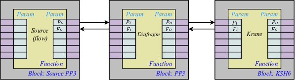

Conditionally, connections of blocks can be represented as links between the blocks as a whole(Fig. 1) or detailing of the links(Fig. 2). In the process of binding parameters of blocks the connection of parameters of any type is acceptable. Thus, in the process of computation automatically casting of types will be done.
Fig. 1. General connections between blocks of a block scheme.
Fig. 2. Detailed links between blocks.

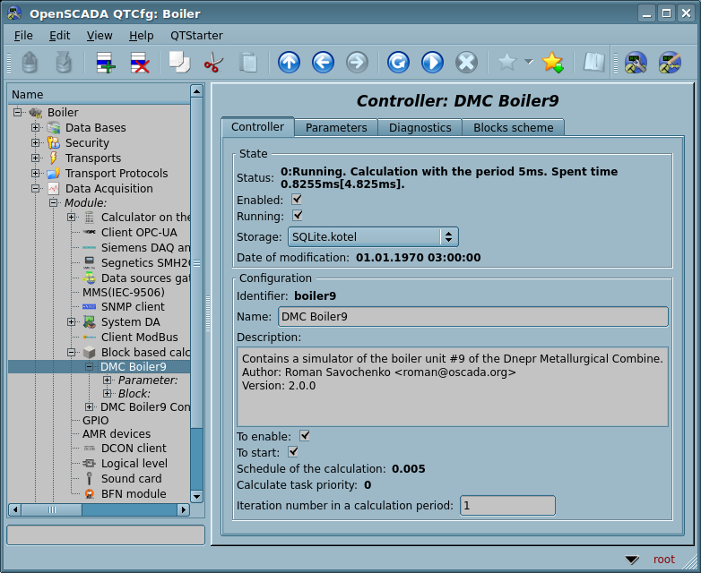

Each controller of this module contains the block circuit, which he computes with the specified period. In order to provide calculated data in the system OpenSCADA the parameters can be created in the controller. Example of the configuration tab of the controller of the given type depicted in Fig. 3.
Fig. 3. Configuration tab of a controller.
From this tab you can set:

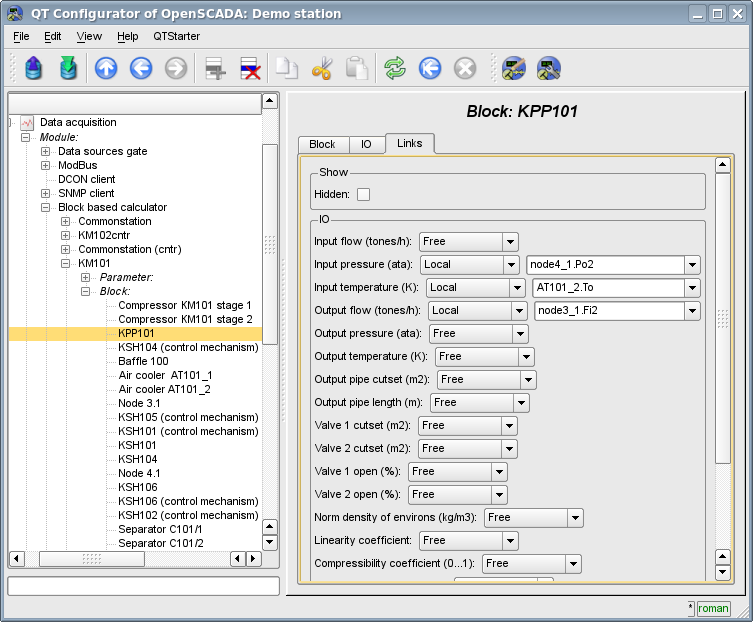

Using the configuration tab of links of the block of the block scheme the links can be set for the parameter of each block separately.
The following types of links are supported:

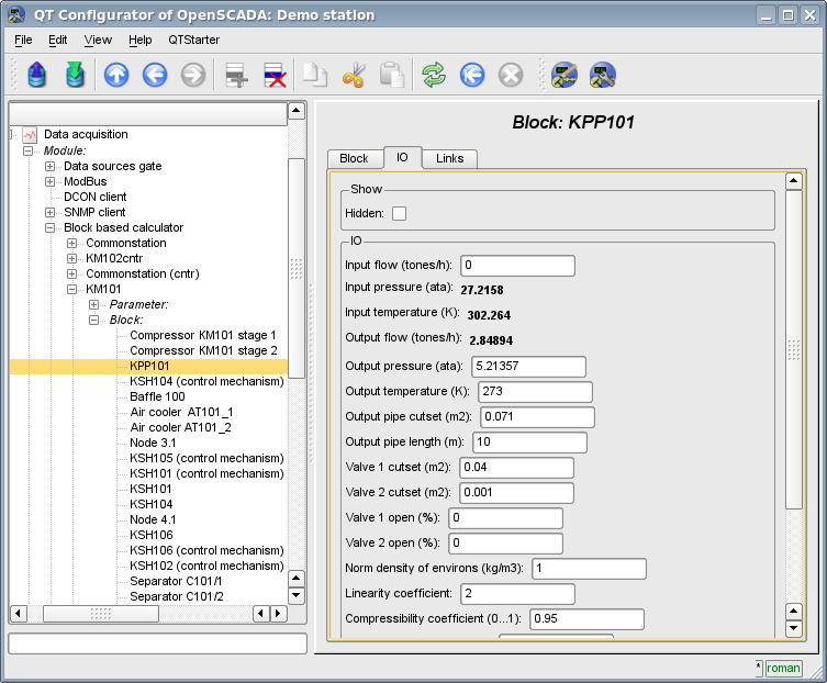

To set values for the parameter of the block there is the corresponding tab (Fig.6).
In accordance with the custom functions in the system OpenSCADA the four main types of IO are supported: integer, float, boolean and string.
Fig. 6. Configuration tab of values of parameters of a block of a block scheme.
The module provides a special treatment of a number of IO of the block:
