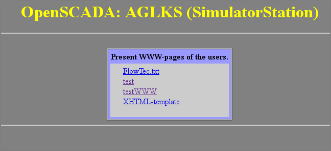

Addressing of the pages begins with the second element of the URI. It is connected with the fact that the first element of the URI is used to identify the user WWW-interface module. For example, URL http://localhost.localdomain:10002/WebUser/UserPage can be deciphered as a call of the user page "UserPage" of this module on the host "localhost.localdomain" on port 10002. In the case of absence of the second element of URI and instruction to display an index of the user pages in the configuration, the index of the pages is generated (Fig.1).
Fig.1. Index of the user pages.

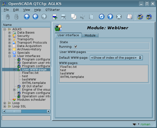

The main tab of the module configuration (Fig.2) contains the state of the module, provides the ability to select the default page and allows you to make the user pages list.
Fig.2. Main tab of the module configuration.

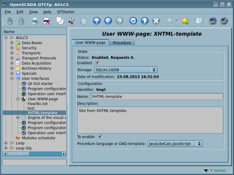

The module provides the ability to create multiple implementations of WWW-pages in the object "User WWW-page" (Fig.3).
Fig.3. Main configuration tab of a user page.
The main tab contains the basic settings of the WWW-page:

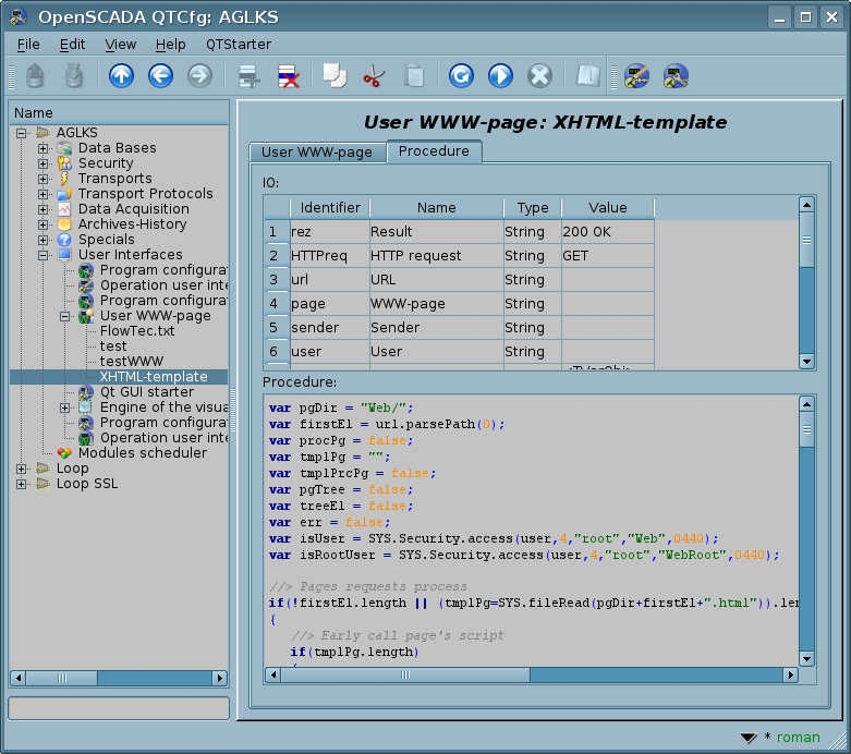

All requests to the user pages are sent to the direct procedure of the processing of the requests of the user page, or to the DAQ-Template procedure, which is represented on the "Program" tab of the user page object (Fig.4). In the case of the DAQ-Template, the template configuration tab is also provided (Fig.5).
Fig.4. The tab "Procedure" of an user WWW-page object.
Tab of the procedure for processing the requests to the user's page contains:
