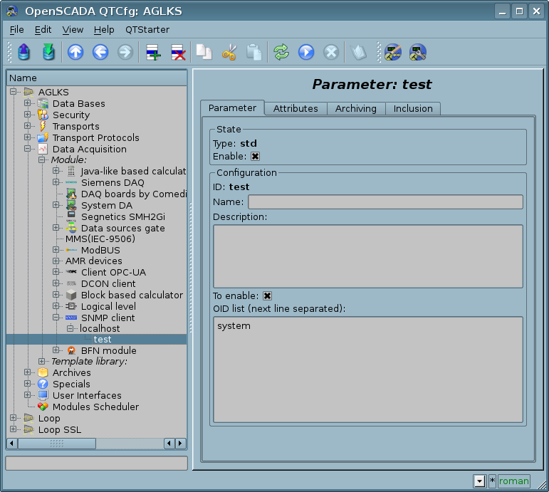

Module SNMP provides only one type of parameters — "Standard". An additional configuration field of parameters of the module(Fig. 2) is a list of MIB-parameters, the branches or separated items (scalars) of which are to be read.
Fig.2. Configuration tab of parameters.

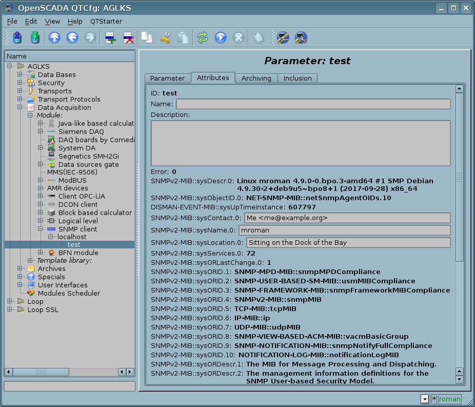

In accordance with a specified list of MIB-parameters is carried out a survey of their branches (or scalars) and creation of attributes of parameters. Further, updating of values of parameters is carried out. Attributes are named in accordance with the code addressing of MIB-parameters, as the ID, and the addressing from the base of MIB objects in the name of the attribute(Figure 3).
Fig.3. Tab of attributes of parameters.
