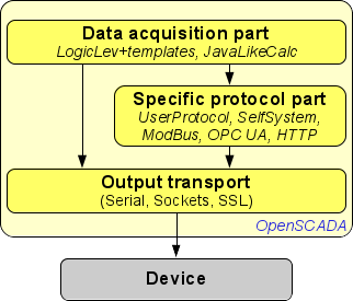

For the DAQ-templates in generic you need to create a representing object of the device into the Logical controller module and to select the proper template from the templates library. Next, to correct configuration, follow to specific of the template into its individual description. The conception of accessing the data by a user protocol we can imagine like to Figure 1.
Fig.1. Conception of user accessing to services and device's data.
As you can see from Figure 1, interaction with devices carried out through some transport on which their physically based. Requests to the transport you can send:
  1. Directly by OpenSCADA system API function of the transport object string messIO( string mess, real timeOut = 0 );, if the protocol specific part is very simple and you need only the data extract.
  2. Wrapped data request req by function int messIO( XMLNodeObj req, string prt ); and for protocol prt, if the protocol part is complex enough and already presented in OpenSCADA.
  3. Wrapped data request specific for user by function int messIO( XMLNodeObj req, "UserProtocol" ); and the user protocol implementation, if the protocol part is complex enough and not yet present in OpenSCADA. The user implements here itself of the protocol specific part in the module UserProtocol and the data specific part in the template for the Logical Level module or directly in controller's procedure on the internal language of the module JavaLikeCalc.
At.png This latter method is currently developed to the possibility of forming a protocol code part directly in the same code of the template as a separate built-in function with call the requesting function of the first method, if there is no need for reuse, or even if such a need exists and it makes sense to create a complex template that can combine the role of the output protocol, through its connection to the user protocol module. And it will be completely stored in a single template library.
At.png Working directly with the output transport of the string messIO(string mess, real timeOut = 0); function does not imply blocking the output transport outside this function call and, therefore, for complex protocols with response packets more than in one packet, which requires the "waiting" process, can not be used a shared transport, at which can be sent packets of different protocols or even one, but for different tasks (controller objects). Therefore, if you need to use shared transport, place the poll parameters in one controller object (task), or use the user protocol module to which this remark is irrelevant, since it performs such blocking at the time of the call of the processing procedure, as well as other modular protocols of OpenSCADA. To place a protocol implementation here you need to do and to follow for the shown demands:

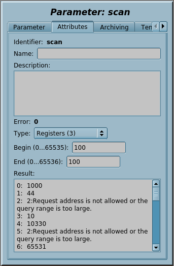

1. Create a source controller object, or use a suitable one, into the module "ModBus".
2. Create a source parameter object into the previous source controller object, set its Identifier like to "ModBusScan", select its type to "Logical" and select this template for it — enable the parameter.
3. Into the tab "Template configuration" of the logical parameter object you need to set:
  • Limit time, seconds — time of limiting for one cycle execution, the default value is a normal one.
4. RESULT: Selecting type of the data and setting the "Begin" and "End" attributes of the scanning range you will get the scanning result into the attribute "Result", which will be appended in the scanning process.

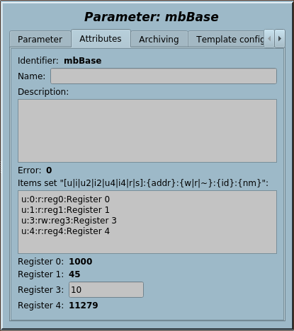

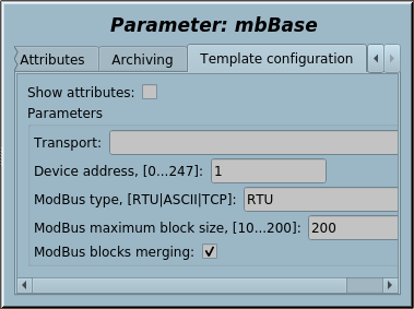

Configuring and using
1. Create an output transport of the type "Serial" or "Sockets", and set its Identifier like to "mbbase", one for each the devices' used serial bus.
2. Set proper address and timeouts of the device.
3. Create and start a logical controller object or a ModBus controller object or use any present one with need scheduling properties.
4. Create a logical parameter object and select the template for that, one for the devices on one bus — enable the parameter.
5. Into the tab "Template configuration" of the logical parameter object you need to set:
6. RESULT: The logical parameter object will: dynamically create needed attributes accordingly to the attribute "Items set" value and perform interaction and placing of gathered data to the parameter attributes. Also you are able to change for writable attributes.

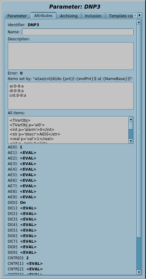

The template implements currently for the client, which uses the followed functions: Confirm (0x00), Read (0x01), Write (0x02), Enable (0x14) and Disable (0x15) Spontaneous Messages.
And which implements and tested for the followed point-oriented objects (data types):
Considering the purpose and the application area, the protocol does not provide the direct determination of the requested data and the device, that implements it, provides all available ones upon request for the Class 0 data, after which only changes are requested for the Classes 1, 2, 3.
All received and controlled data is accumulated in an object of the attribute "items" for further control as an object in a table of the widget "Main.objProps", according to the complex object definition.
For standard control over parameter attributes, including archiving, it is possible to define the necessary data to create a separate representative attribute for them, which is described in the attribute "itemsSet", where they can be defined individually, with a semantic identifier and name, or in a range named by a template. The data in the attribute "itemsSet" is defined by records in the format ai|ao|cnt|di|do:{pnt}[-{endPnt}][:a[:{NameBase}]], where:
Examples of the parameters definition, rows of the attribute "itemsSet":

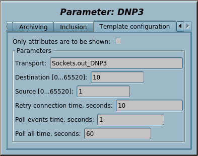

1. Create an output transport of the type "Sockets", set its Identifier like to "DNP3", one for each the device-PLC.
2. Set proper address with port 20000 and timeouts of the Sockets device-PLC.
3. Create and start a logical controller object or use any present one with need scheduling properties. The interaction period preferred to be about 0.1 second.
4. Create a logical parameter object and select this template for that, one for each the device-PLC — enable the parameter.
  • Transport — to address of the transport into step 1. Tracing for the address changing is supported.
  • Destination — remote station address in the integer range [0...65520].
  • Source — the same station address (source) in the integer range [0...65520].
  • Retry connection time — retry connection time in seconds, at the connection missing and no response detection.
  • Poll events time — time in seconds of the events periodical polling (Class 1).
  • Poll all time — time in seconds of the complete data requesting (Class 0,1,2,3).
6. RESULT: The logical parameter object will perform interaction and placing of the gathered data to the object "items", creation/placing and checking for commands of the proper attributes, created by the "itemsSet" instruction.
7. In the process of the working, through the tab "Attributes" of operational data, in addition to obtaining the result, it is possible to perform operative setup and control on:
  • Items set by — for controlled items naming and definition as attributes and accessible for write.
  • All items, {Item attributes} — direct writing for the writable items.

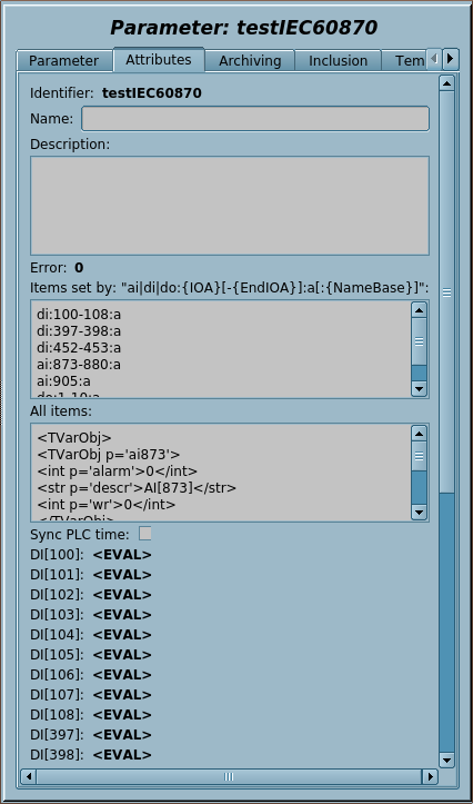

Considering the purpose and the application area, the protocol does not provide the direct determination of the requested data and the device, that implements it, provides all available ones upon request by the C_IC_NA_1 command, after which only changes are sent.
For standard control over parameter attributes, including archiving, it is possible to define the necessary data to create a separate representative attribute for them, which is described in the attribute "itemsSet", where they can be defined individually, with a semantic identifier and name, or in a range named by a template. The data in the attribute "itemsSet" is defined by records in the format ai|di|do:{IOA}[-{EndIOA}][:a[:{NameBase}]], where:
The module provides integrated support for time synchronisation of PLC by sending the C_CS_NA_1 service command.
In the template for the first time used the not requesting mode of an output transport and the attributes creation in free while performing.

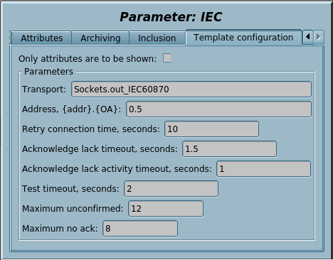

transport Transport String Input Not attribute Constant Sockets.out_IEC60870
addr Address, {addr}.{OA} String Input Not attribute Constant 0.5
tmRetr Retry connection time, seconds Real Input Not attribute Constant 10
tmPoolAll Poll all time, seconds Real Input Not attribute Constant 60

Configuration.
1. Create an output transport of the type "Sockets", set its Identifier like to "IEC60870", one for each the device-PLC.
2. Set proper address with port 2404 and timeouts of the Sockets device-PLC.
3. Create and start a logical controller object or use any present one with need scheduling properties. For interaction by IEC-60870-104 you need the execution period not greater than 0.1 second!
  • Address — remote station and object address in the format "{addr}.{OA}", for physical systems without a gateway is not particularly important.
  • Retry connection time — retry connection time in seconds, at the connection missing.
  • Poll all time — time in seconds of the complete data requesting, sending C_IC_NA_1.
  • Acknowledge lack activity timeout, in seconds.
  • Acknowledge timeout, in seconds.
  • Test timeout, in seconds.
  • Maximum unconfirmed — not used into the client since it is not generate such flows.
  • Maximum no ack — maximum input packages after what the client will send "Ack".

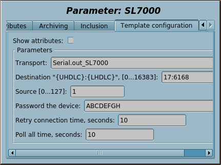

Configuration.
1. Create an output transport of the type "Serial" directly or by the "Sockets" gate, and set its Identifier like to "IEC62056", one for each the devices' used serial bus.
2. Set proper address and timeouts of the Serial device.
4. Create a logical parameter object and select the template for that, one for each the device-PLC — enable the parameter.
  • Destination "{UHDLC}[:{LHDLC}]" — remote station address in the two digits format each of which in the range [0...16383], this address can be pointed as one digit of the range [0...127].
  • Source — the same station address (source) in the integer range [0...127].
  • Password the device — the device access password.
  • Poll all time — time in seconds of the complete data requesting, pointed in the "itemsSet".

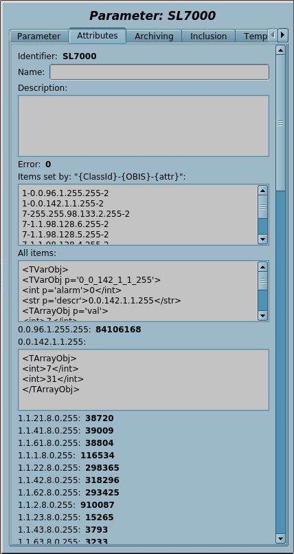

6. RESULT: The logical parameter object will perform interaction and placing of the gathered data to the object "items", creation/placing the gathered data to the proper value attributes.
  • Items set by — for appending the device's OBIS to their reading.
