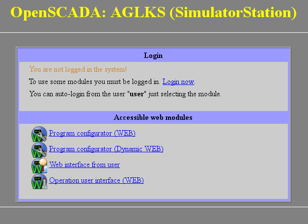

In the requests for the Web resources the URL(Universal Resource Locator) are commonly used. Hence, the URL is passed as the main parameter via HTTP. The first element of the requested URL is used to identify the module UI. For example, the URL "http://localhost:10002/WebCfg" means requesting to the module "WebCfg" on the host "http://localhost:10002". In the case of an incorrect indication of the module ID, or when you address without identifier of the module at all, the module generates the information dialogue on the entry and the choice of one of the available user interfaces. Example of the dialogue is shown in Figure 1.
Fig.1. Dialogue of the WWW-interface module choice.

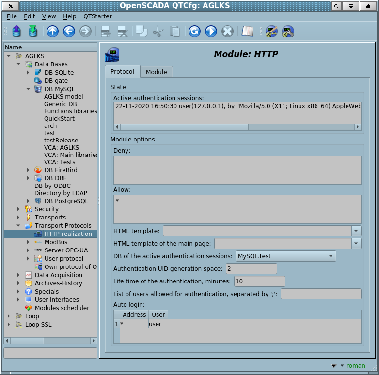

To configure and control this module, you have the configuration page of the OpenSCADA control interface (Fig.3) where you can perform:
Fig.3. The module configuring page.

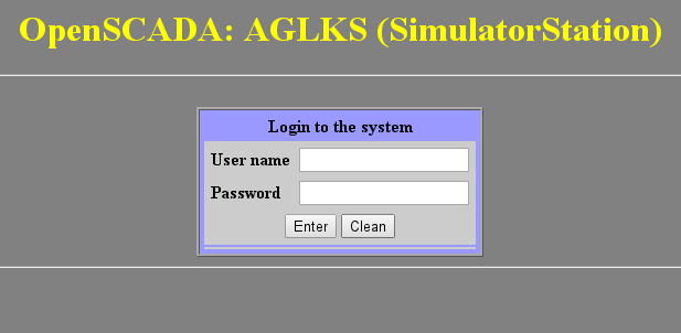

The module supports authentication in OpenSCADA while providing access to the WEB-interface modules (Fig.2).
Fig.2. Authentication dialogue in OpenSCADA.
The authentication by the module is provided by the cookies with the dynamic name and the User ID space, where the cookie name is "oscd_UID" and is used the User ID space in work with the common authentication sessions table, and the cookie name is "oscd_UID_{PrjNm}" in the work without that.
