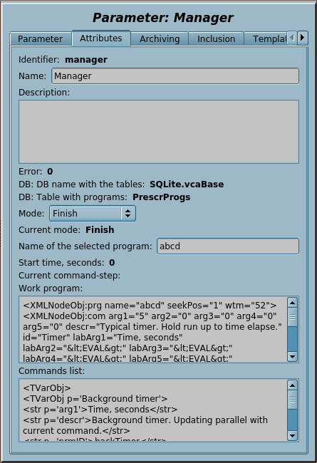

Configuration.
Configuring and using
1. Create and start a logical controller object with the needed scheduling properties.
2. Create a logical parameter object, for the case of using the logical controller, and select this template for it. Enable the parameter.
  • [JavaLikeCalc] or select this template for the JavaLikeCalc controller; enable the controller; create a parameter "manager" of reflection the representative attributes:
dbDB
dbProgs
comLs
prog
mode
curMode
startTm
curCom
work
3. Into the tab "Template configuration" of the object of the logical parameter, or the controller for [JavaLikeCalc], you need to set:
  • DB: DB name with the tables — to DB, like to "SQLite.vcaBase", where stored or must be stored the prescription-program tables. The empty value is not allowed and will cause an error!
  • DB: Table with programs — to name of the prescriptions-programs table, by default it is "PrescrProgs".
  • Commands controller — left it in the default value "*", to use this parameter's controller for the commands also. You must change this field if you run the manager controller object in a separate logical controller for the commands!
  • [JavaLikeCalc] or and additionally:
  • Commands controller — change this field in a separate logical controller for the commands!
  • [Command-macro] or and additionally:
  • DB: Table with commands — to name of the commands table, by default it is "PrescrComs";
  • Commands controller — set to <empty>.
4. Place the required parameters of the commands together to the manager parameter.
  • [Command-macro] or prepare the required commands in "DB: Table with commands" according to the conception; the empty commands table must be created automatically after starting the object of the logical parameter, or the controller for [JavaLikeCalc]!
5. RESULT: Launching the controller object (where this parameter is created), we must get the operational data in the tab "Attributes" for the: allowed commands list, current mode, work program, current command-step and start time.
  • [JavaLikeCalc] or the JavaLikeCalc controller object directly.
6. In the process of the working, through the tab "Attributes" of operational data, in addition to obtaining the result, it is possible to perform operative setup and control on:
  • Name of the selected program — to set of the selected program name in processing by the manager;
  • Mode — to set the manager mode of the selected prescription-program execution: Finish(-2), Error(-1), Stop(0), Run(1), Pause(2), Pass command(3).

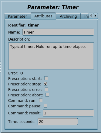

Template of a command of the prescription typical timer. The timer is only designed to hold time between other action steps and for example, so it only has one attribute, "Time" in seconds.
Template IOs
Identifier Name Type Mode Attribute Configuration Value
start Prescription: start Boolean Input Full access Variable 0
stop Prescription: stop Boolean Input Full access Variable 0
error Prescription: error Boolean Input Full access Variable 0
abort Prescription: abort Boolean Input Full access Variable 0
run Command: run Boolean Input Full access Variable 0
pause Command: pause Boolean Input Full access Variable 0
rez Command: result String Input Full access Variable 1
arg1 Time, seconds Real Input Full access Variable
tmp1 Temporary 1 Real Output Not attribute Variable 0
f_stop Function stop flag Boolean Input Not attribute Variable 0
f_frq Frequency of calculation of the function, Hz Real Input Not attribute Variable 1000
f_err Function error String Input Not attribute Variable 0
f_start Function start flag Boolean Input Not attribute Variable 0
1. Create and start a logical controller object with the needed scheduling properties, or use created one for the prescription engine.
2. Create a logical parameter object and select this template for it. Enable the parameter.
3. RESULT: Launching, we must get the operational data in the tab "Attributes" for the command result.
4. In the process of the working, through the tab "Attributes" of operational data, in addition to obtaining the result, it is possible to perform operative setup and control on the representative attributes of the prescription commands and the additional ones:
  • Time — to set time of the timer in seconds.

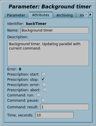

Template of a command of the prescription background timer. The timer designed only for hold a time in the background to an example, then it contains only one attribute, it is "Time" in seconds.
Template IOs

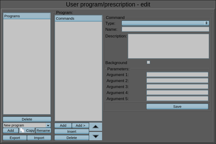

3.1 Prescription — edit (prescrEdit)
1.3 GPLv2 * en, uk, ru Roman Savochenko

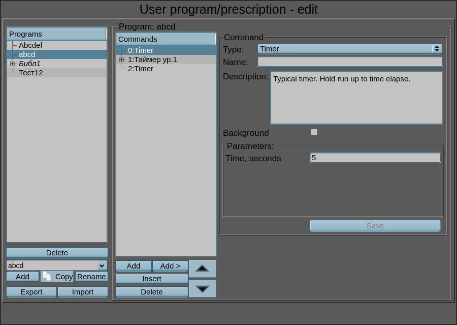

The frame, shown in Figure 3.1, is one of the group frames for working with the prescriptions, which serves for the user-editing of the prescriptions-programs. The frame commonly uses and represents the representative structure of the prescription manager.
The frame contains from left to right:
Fig.3.1a. The "Prescription — edit" frame in the development mode.

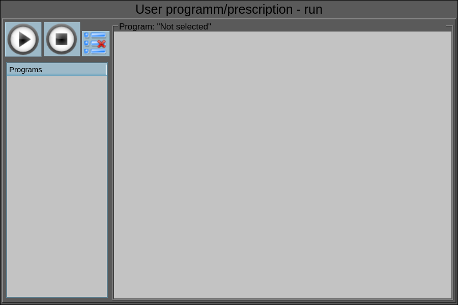

Using — development
The frame is designed to perform the role of page, and should therefore be placed directly in the project's tree. To the frame can be connected one parameter of the prescription manager, by setting the links.

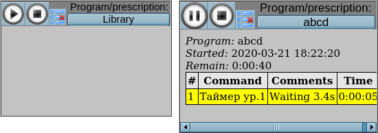

Using — runtime

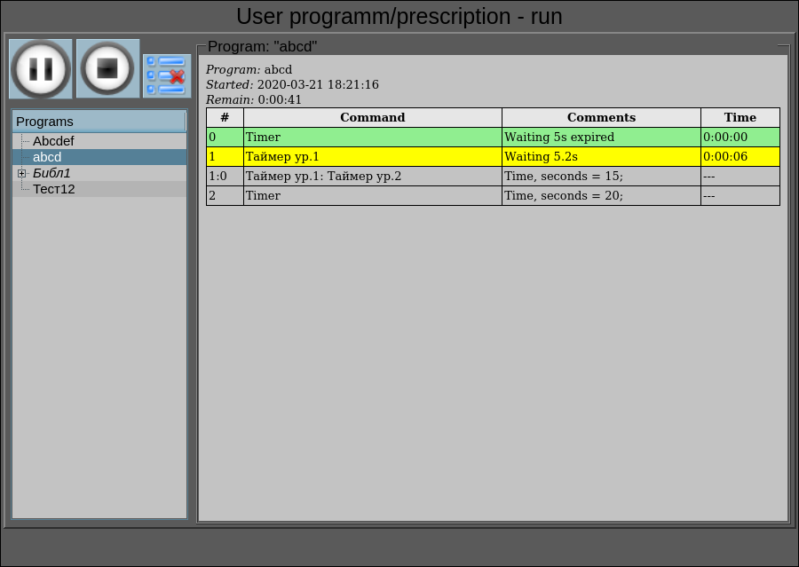

In the runtime mode, the user can add new prescription-programs, delete, copy and export the existing ones as well as to import prescriptions from other OpenSCADA stations. In the selected prescription-program user can do: add or insert a new step, remove or move the selected step. For the selected steps of the prescription-program the user can set the command and enter the name, description, background execution flag and values for the available arguments of the selected command, and then to save changes of the step.
Removal operations are accompanied by the confirmation dialog.
Fig.3.1b. The "Prescription — edit" frame in the runtime mode.

The frame, shown in Figure 3.2, is one of the group frames for working with the prescriptions, which serves for control and observing of executing the programs-prescriptions, previously formed in the Prescription — edit frame. The frame commonly uses and represents the representative structure of the prescription manager. In addition to this full-format prescription frame, there is a simplified one — "Prescription — run, simple, that allows you to manage and to track compactly the prescriptions execution in other frames of the technological process.
The frame contains from the left to the right:
Fig.3.2a. The "Prescription — run" frame in the development mode.
Using — development
At.png To archive completed sessions while the operator is switching between frames, this full-format frame in the project tree must be set for the parameter "Page: process not opened".
At the end of the prescription-program, messages with session parameters are generated by the prescription manager, as well as archiving of the session document. The messages with the session parameters can be used either simply to view the sessions history or to create a session list, for example, in the graphics group to go to the history at the session time. The reports archive is set to the depth of 10 documents by default, what you can change by setting the "Archive length (n)" attribute of the document widget.
Using — runtime
In the runtime mode, the user can select the desired prescription-program and run-on the execution, and then track the execution progress or switch to other frames. The running program user can pause by pressing the "Pause" button or terminate by pressing "Stop". In addition, the user can skip the current step by clicking the "Skip" button. Also the user can review or print reports of the previously executed prescriptions of this full-format frame, for what it is necessary to press the left mouse button on the document and browse on the navigation bar through the archive of the executed prescriptions.
Fig.3.2b. The "Prescription — run" frame in the runtime mode.
