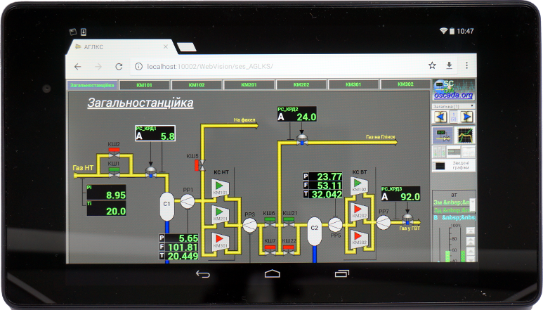

Achievement: packs manually to the APK generic packages by CrystaxNDKr10 (ABI 19, Android = 4.4) and NDKr13 (ABI 21, Android >= 5), starts and works for both Web and Qt5

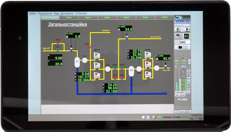

(+) build Qt5: in the default configuration, with the early built libraries;

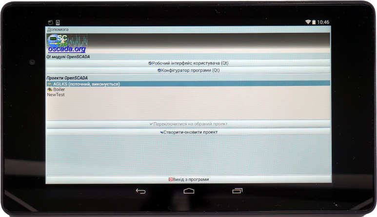

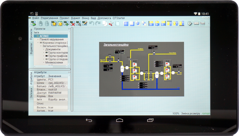

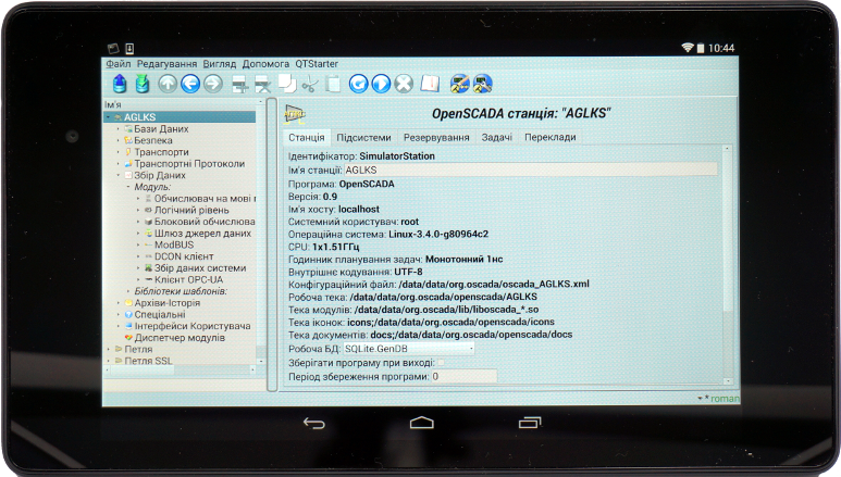

(+) initial build OpenSCADA with Qt5;
(+) build and observe an example of Qt5 as a Java package (APK);
(+) adapt OpenSCADA to Qt5 on Android and build as a Java package (APK); get the program's locale from Java environment and set it to environment LANG;
(+) the Java package (APK) resolve for different data files placing and fill in;
(+) OpenSCADA main functions related to Qt restore and fix: Qt5 builds with soft-float but hard-float causes the mostly problems; two branches were created, based on CrystaX NDK r10 (from ABI 19) and Original Ndk r13 (from ABI 21); default interface style was set to "fusion";
