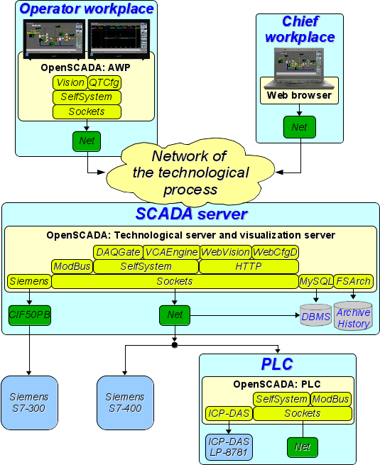

1.1 Server of the SCADA system
| Visual Control Area (VCA) of the end user | |
| Remote visualization server grounded on the visual control engine of VCA — local starting of the module UI.Vision, connected to the visualization server. | Module of the VCA engine VCAEngine |
| Remote WEB interface | Web-browser Module of the visualizer WebVision Module of the VCA engine VCAEngine |
| Simple remote Web-interfaces of the user | Web-browser Module WebUser |
| Providing data to higher level systems | |
| By interfaces | |
| Serial interface: RS232, RS485, Modem, ... | Module Serial |
| IP-networks sockets and network level protocols TCP, UDP and Unix | Module Sockets |
| Security sockets layer (SSL) | Module SSL |
| By protocols | |
| Self protocol of OpenSCADA | Module SelfSystem |
| ModBus family protocols: TCP, RTU and ASCII | Module ModBus |
| "OPC-UA" protocol | Module OPC-UA |
| Simple specialized protocols developed by the user protocol | Module UserProtocol |
| Through DBMS | |
| MySQL | Module MySQL |
| PostgreSQL | Module PostgreSQL |
| FireBird | Module FireBird |
| DBGate — DB of the another OpenSCADA station | Module DBGate |
| ODBC — DBMS for which there is an ODBC driver | Module ODBC (not finished) |
| Configuration and development (SCADA programmer and administrator) | |
| Remotely, through WEB-interface | Web-browser Module WebCfgD or WebCfg |
| Remotely, from the configuration station by the control interface of OpenSCADA | Module SelfSystem |
| Languages of the user programming and calculation | |
| JavaLikeCalc — a high level language similar to JavaScript and Java | Module JavaLikeCalc |
| Block Schemes | Module BlockCalc |
| Storing station data | |
| Configuration file | Core of OpenSCADA |
| DB | |
| SQLite | Module SQLite |
| DBF | Module DBF |
| Directories through LDAP | Module LDAP |
| Acquisition and control of internal and external data (DAQ) | |
Different types of logical and physical sources that have data access utilities or accessible through simple and specialized network protocols. This is accomplished by writing a data acquisition procedure of the user protocol in the user programming language. Most known protocols implementing on the user protocols:
Module of the user programming language JavaLikeCalc Module LogicLev Module of the user protocol UserProtocol |
| Formation of logical sources and derivative parameters structures, based on templates of parameters and data of other sources | Module LogicLev |
| Formation of logical sources using block diagrams | Module BlockCalc |
| External servers and PLCs are built on OpenSCADA, possibly for duplication. | Module DAQGate |
| Information about hardware and software platform | Module System |
| Industrial controllers and other devices by the ModBus protocol | Module ModBus |
| Industrial controllers by the DCON protocol | Module DCON |
| Industrial controllers and other devices by the OPC-UA protocol | Module OPC-UA |
| Industrial controllers and other devices by the MMS(IEC-9506) protocol | Module MMS |
| Network devices and other sources by the SNMP protocol (Simple Network Management Protocol) | Module SNMP |
| Industrial equipment of the firm ICP DAS, modules of the series: I7k, I8k, I87K and other on the ISA bus | Module ICP_DAS |
| Industrial controllers of the firm Siemens of the series S7 | Module Siemens |
| DAQ-boars on the buses ISA, PCI, PCMCIA and USB | Library Comedi Module Comedi |
| Input channels of the sound controllers | Module SoundCard |
| Automation of the "Big Dutchman" company | Module BFN |
| Archiving-History | |
| Message archives by various categories and levels | |
| Files in the format of XML or plain text with packing the out-of-date archives | Module FSArch |
| On tables of the archival DB of OpenSCADA | Module DBArch |
| On the other, based on OpenSCADA, archiving server, may be remote | scheduled |
| Value archives of the gathered data | |
| Buffers in memory of a certain length | Core of OpenSCADA |
| Files with double packing: consecutive and the standard archiver gzip | Module FSArch |

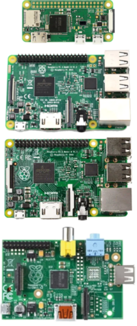

| Discrete inputs/outputs of general purpose of different single-board computers | Module GPIO |

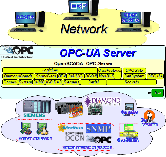

1.4 Universal OPC-UA server
Due implementation of the protocol OPC-UA into agent mode, OpenSCADA can provide a popular function of the OPC-server to client's protocols, which supports and direct implemented into OpenSCADA. The function common uses on platform MS Windows®, and many SCADA-systems on the platform work exclusively with OPC—servers, as the data sources. Thus, OpenSCADA can act as an universal OPC-server on Linux platform (Fig.2).
In plans. With adapting OpenSCADA to work on MS Windows® platform and implementing the work with OPC-DA by system DCOM, there will appear possibility for applying OpenSCADA into the gate OPC-DA -> OPC-UA role, which means free integration of old systems to the new or accumulation systems.

The hardware requirements of OpenSCADA for its execution in different roles are given in Table 1. The software requirements for execution OpenSCADA and its modules are presented in Table 2.
Table 1. The hardware requirements of OpenSCADA and it modules.
| Role | Demands |
| SCADA server |
CPU: x86 (i586 and above), x86_64, ARM or MIPS, with frequency more to 500 MHz |
| Station of the operator of the technological process, the dispatcher board, the monitoring panel, etc. |
CPU: x86 (i586 and above), x86_64 or ARM, with frequency more to 1 GHz |
| Environment of execution of controllers (PLC) |
CPU: x86 (i586 and above), x86_64, ARM or MIPS, with frequency more to 133 MHz |
