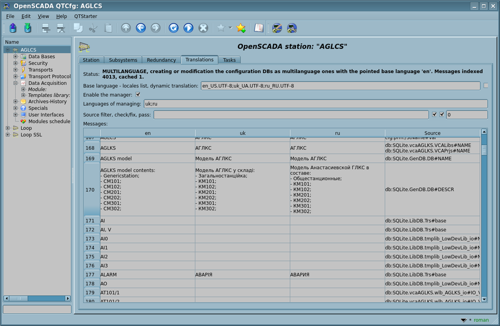

All basic translation actions are performed in the "Translations" tab of the station configuration root page, which is shown in Figure 1 and where we will consider all the actions in this step.
Fig.1. The tab "Translations" of the main page of the station configuration.
First of all, we have to switch the project of the previous stage to multilingual mode, for which in the specified tab we enter the code of the previously selected BASIC language, or a list of locales of all project languages with BASIC first, which is better, because then they will be substituted automatically and used in the translation of system-library messages such as months of date — the figure shows "en_US.UTF-8;uk_UA.UTF-8;ru_RU.UTF-8", so the BASIC is English (en). If you also need dynamic multilingualism, check the box after the language field, which is a plan to enable multilingualism the next time you run it. That is, save these changes to the project storage and restart it.
If everything happened correctly, then after restarting in the translation status we should get "MULTILANGUAGE" or "MULTILANGUAGE-DYNAMIC" and go directly to the translation on the same tab, ie in the table "Messages". If you do not have the table itself, then you have chosen non-dynamic mode, where initially there is no translation messages index to build a translation table manager, but there is a field "Enable manager", which forms that index.
At.png Before enabling the translation manager, or starting to work with it in dynamic mode, you must fully download all messages that do not happen automatically for the VCA projects and libraries and can be done simply by opening the development environment.
After enabling the translation manager, and then its appearance, in the field "Languages of managing" and through the delimiter symbol ";" specify the list of selected languages except BASIC. You can now translate the messages in the table into the specified languages and together with the BASIC, if the original language of the project was not it.
The translation manager, or rather the procedure for its formation, also performs a series of checks with appropriate markings and direct corrections of inconsistencies to simplify this process as much as possible, which is enabled by the appropriate flag.
You can learn more about the interface elements of this page on the description page.
