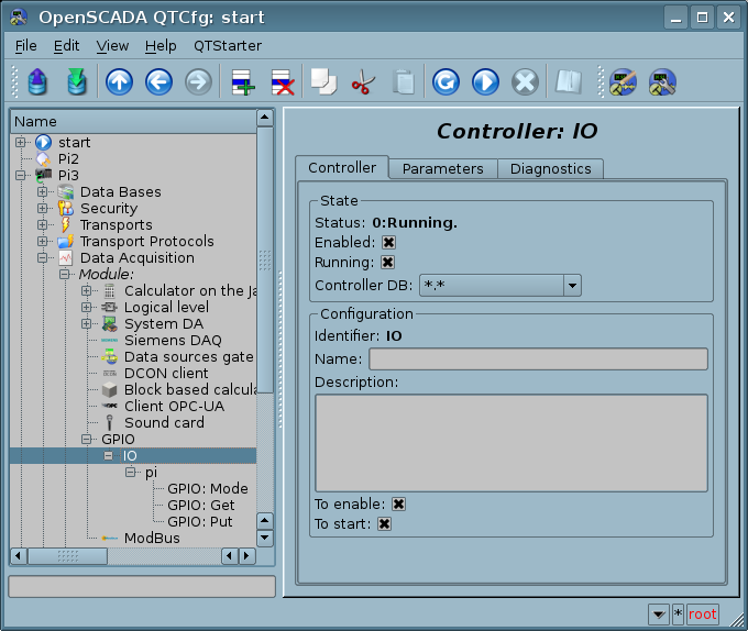

1 Controller object
GPIO in OpenSCADA is configured by creating a new controller object (Fig.1) and the controller parameter — one GPIO parameter for one card.
Fig.1. Configuration tab of a controller object.

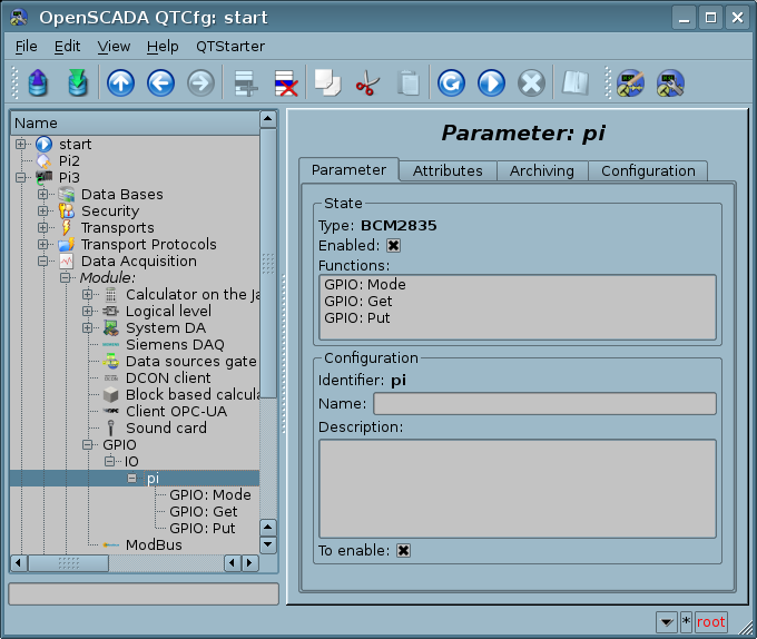

The parameter is the direct representative-reflection of the GPIO, which contains a list of attributes of a discrete type in an amount that corresponds to this GPIO type. The parameter configuration tab is shown in Figure 2. The data collection is performed only in synchronous mode since the GPIO should be fast.
Fig.2. Configuration tab of a parameter.
With the parameter configuration tab you can set:

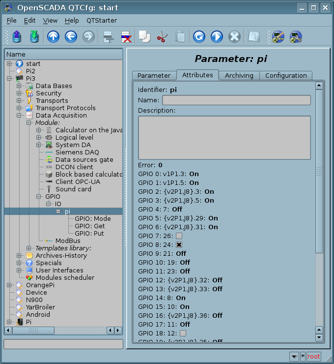

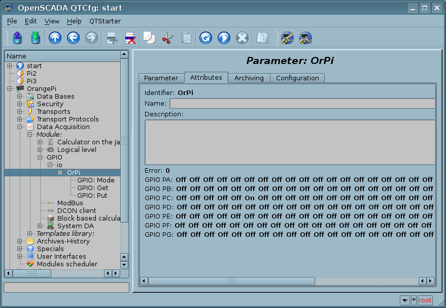

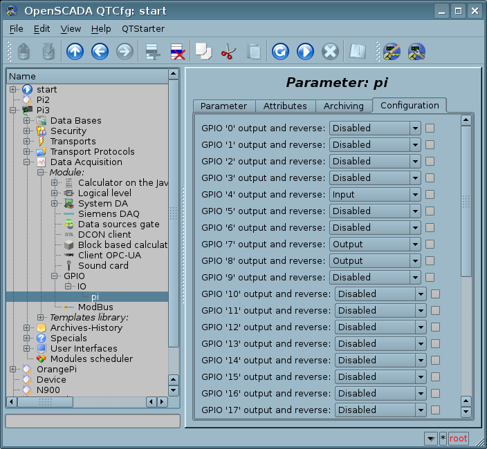

The tab "Attributes" of GPIO is shown in Figure 3 for BCM2835, and Figure 4 for SUNXI. For the GPIO, the "Configuration" tab (Fig. 5) is also available with the IO mode and the inversion state.
Fig.3. Tab "Attributes" of a parameter of the "BCM2835".
Fig.4. Tab "Attributes" of a parameter of the "SUNXI".
Fig.5. Tab "Configuration" of a parameter.
