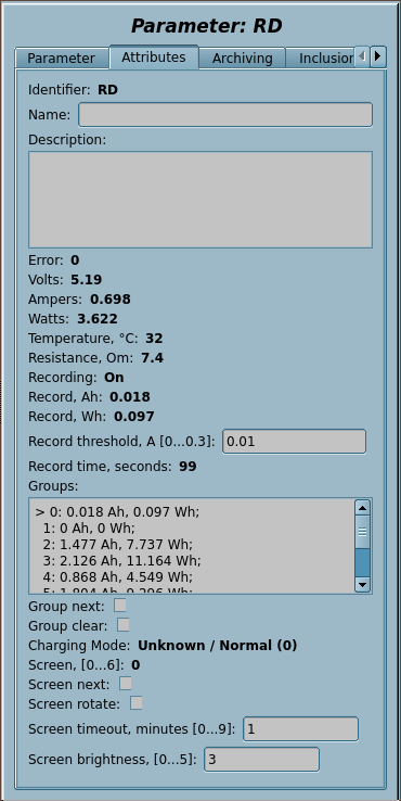

1 BT: RDTech UM24C, UM25C and UM34C (RDTech)
1.1 GPLv2 * en,uk Roman Savochenko
Result and the operative setup.
RDTech UM24C/UM25C/UM34C BlueTooth interface template. At.png Tested only on UM24C now.
The RDTech (RuiDeng) UM24C, UM25C and UM34C are low-cost USB pass-through power measurement devices, and support a decent number of collection features, as well as full control via Bluetooth. This template implements most exposed commands and data collection available by the device's Bluetooth interface.
This template in first time uses the new output transports connection function SYS.Transport.outAt() and the Bluetooth interface for the data acquisition.
Template IOs
Identifier Parameter Type Mode Attribute Configuration Value
transport Transport String Input Not attribute Constant Serial.RD:/dev/rfcomm0:9600||1000:40-20
dev Device to bind
Like to "98:D3:31:F8:52:29" for binding by "rfcomm bind {N} 98:D3:31:F8:52:29".
V Volts Real Input Read only Variable
A Amperes Real Input Read only Variable
W Watts Real Input Read only Variable
T Temperature, °С Integer Input Read only Variable
R Resistance, Om Real Input Read only Variable
rec Recording Boolean Input Read only Variable
recAh Record, Ah Real Input Read only Variable
recWh Record, Wh Real Input Read only Variable
recThr Record threshold, A [0...0.3] Real Input Full access Variable
recTm Record time, seconds Real Input Read only Variable
grps Groups Text Input Read only Variable
grpNext Group next Boolean Input Full access Variable
grpClear Group clear Boolean Input Full access Variable
chMode Charging Mode String Input Read only Variable
scr Screen, [0...6] Integer Input Read only Variable
scrNext Screen next Boolean Input Full access Variable
scrRot Screen rotate Boolean Input Full access Variable
scrTm Screen timeout, minutes [0...9] Integer Input Full access Variable
scrBright Screen brightness, [0...5] Integer Input Full access Variable
this Object Object Input Not attribute Variable
f_err Function error String Input Not attribute Variable 0
f_stop Function stop flag Boolean Input Not attribute Variable 0
f_start Function start flag Boolean Input Not attribute Variable 0
f_frq Frequency of calculation of the function, Hz Real Input Not attribute Variable 1000

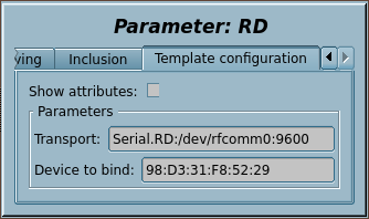

Configuration.
Configuring and using
1. Connection the BlueTooth device:
bluetoothctl
#[bluetooth]# scan on
#  Discovery started
#  [NEW] Device 98:D3:31:F8:52:29 UM24C
#  [CHG] Device 98:D3:31:F8:52:29 RSSI: -60
#[bluetooth]# scan off
#[bluetooth]# pair 98:D3:31:F8:52:29
#  Attempting to pair with 98:D3:31:F8:52:29
#  [CHG] Device 98:D3:31:F8:52:29 Connected: yes
#  Request PIN code
#  [UM241m[agent] Enter PIN code: 1234
#  Pairing successful
#[bluetooth]# trust 98:D3:31:F8:52:29
#  [CHG] Device 98:D3:31:F8:52:29 Trusted: yes
#  Changing 98:D3:31:F8:52:29 trust succeeded
#[bluetooth]# exit
rfcomm bind 0 98:D3:31:F8:52:29   # 0 here for binding to /dev/rfcomm0
2. Create and start a logical controller object or use any presented one with the needed scheduling properties.
3. Create a logical parameter object and select this template for it, one for each the devices. Enable the parameter.
4. Into the tab "Template configuration" of the logical parameter object you need to set:
  • Transport — to the address of the automatically created transport with its parameters after ":", according to the function SYS.Transport.outAt() address format, where the device address corresponds to the command rfcomm bind 0 in item 1.
  • Device to bind — here you may set the Bluetooth address of the device as "98:D3:31:F8:52:29" to call the rfcomm bind {N} command when starting the template, where N is respectively taken from the address of the previous item.
At.png The rfcomm command is normally not available to be called by a non-privileged user, and if you want to call it by such a user, you must set a corresponding sign for it as chmod u+s /usr/bin/rfcomm from the super user.
5. RESULT: The logical parameter object will perform gather data of and trace to modify of the writable properties.

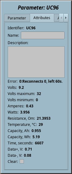

2 BT: ATORCH UC96, UD24 (UC96)
1.2 GPLv2 * en,uk Roman Savochenko
ATORCH UC96, UD24 BlueTooth interface template.
The ATORCH UC96, UD24 are low-cost USB pass-through power measurement device with many interfaces and supporting a decent number of collection features, as well as control via Bluetooth. This template implements only the clearing data command and data collection by the device's Bluetooth interface.
The device sends data packages not at a request and just after establishing the connection, that is broadcasting with one second period. At.png The device may not to send the data packages at enable not in the first screen, so you need to switch the first screen for the data appearance. The data can be missed also after suspending the PC, so this template in the first time implements the data missing detection and reconnection.
Template IOs
transport Transport String Input Not attribute Constant Serial.UC96:/dev/rfcomm0:9600||1000:40-20
dev Device to bind
Like to "58:F4:04:33:D5:FD" for binding by "rfcomm bind {N} 58:F4:04:33:D5:FD".
noDataTm No data detection time, seconds Integer Input Not attribute Constant 60
Vup Volts maximum Real Input Read only Variable
Vdwn Volts minimum Real Input Read only Variable
Ah Capacity, Ah Real Input Read only Variable
Wh Capacity, Wh Real Input Read only Variable
Tm Time, seconds Integer Input Read only Variable
Dplus Data+, V Real Input Read only Variable
Dminus Data-, V Real Input Read only Variable
clear Clear Boolean Input Full access Variable
Configuration.
1. Connection the BlueTooth device: performed in the standard way of pairing and trusting without PIN and to UC96_SPP
  • Transport — to the address of the automatically created transport with its parameters after ":", according to the function SYS.Transport.outAt() address format, where the device address corresponds to the command rfcomm bind 0.
  • Device to bind — here you may set the Bluetooth address of the device as "58:F4:04:33:D5:FD" to call the rfcomm bind {N} command when starting the template, where N is respectively taken from the address of the previous item.
  • No data detection time — here you may set the time of detection of the data missing.

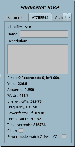

3 BT: ATORCH S1BP (S1BP)
1.0 GPLv2 * en,uk Roman Savochenko
ATORCH S1BP BlueTooth interface template.
The ATORCH S1BP is low-cost AC energy measurement device with supporting a decent number of collection features, as well as control via Bluetooth. This template implements the command of the data clearing and switching the power mode, also as collection the data by the device's Bluetooth interface.
Template IOs
transport Transport String Input Not attribute Constant Serial.S1BP:/dev/rfcomm2:9600||1000:40-20
dev Device to bind
Like to "40:2B:6D:EF:48:A7" for binding by "rfcomm bind {N} 40:2B:6D:EF:48:A7".
KWh Energy, KWh Real Input Read only Variable
Hz Frequency, Hz Real Input Read only Variable
Pf Power factor, Pf Real Input Read only Variable
power Power mode switch Off/Auto/On Boolean Input Full access Variable
Configuration.
1. Connection the BlueTooth device: performed in the standard way of pairing and trusting without PIN and to S1BP_SPP

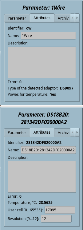

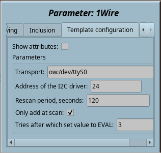

4 1-Wire (1W)
2.1 GPLv2 * en,uk Roman Savochenko
One Wire One Wire sensors bus implementing by 1Wire adaptors DS9097, DS9097U (DS2480B) on the bus RS232 and by the chip DS2482-100 on the bus I2C. Supported direct and parasite powering for the temperature sensors.
Supported 1Wire devices: DS1820, DS1820/DS18S20/DS1920 (not tested), DS1822 (not tested), DS2413, DS2408, DS2450, DS2438.
Template IOs
transport Transport String Input Not attribute Constant 1Wire:/dev/ttyS0
addr Address of the I2C driver
[24...27] - for DS2482-100
Integer Input Not attribute Constant 24
tmResc Rescan period, seconds Real Input Not attribute Constant 60
onlyAddAtScan Only add at scan Boolean Input Not attribute Constant 0
tryEVAL Tries after which set value to EVAL Integer Input Not attribute Constant 3
adapterS Type of the detected adaptor String Input Read only Variable No detected
