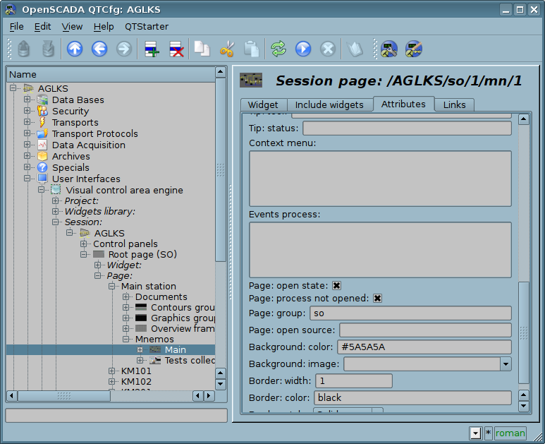

Current execution context of the VCA procedures (procedures of the widgets) you can observe on the tab "Attributes" of the proper page or widget of the session of the executed now project (Fig. 3). To append some interim values you can temporary append and link several attributes to the widget/page.
Fig. 3. Tab "Attributes" of a page or widget of the session of the executed now project.

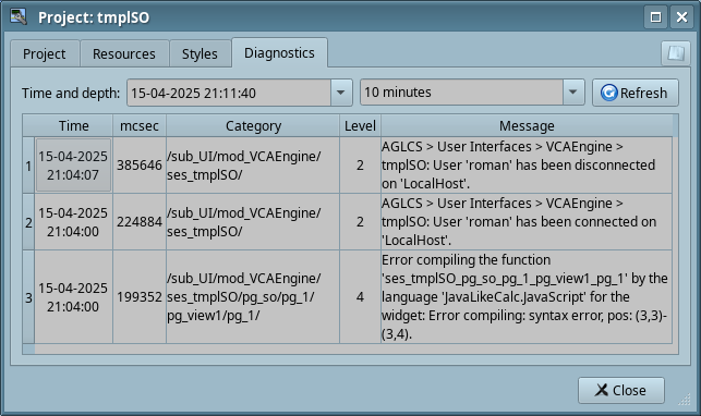

  • Tab "Diagnostics" of the project object of VCA into the configurator (Fig. 6) or of the project properties of the development mode of UI.Vision (Fig. 7).

Fig. 7. Tab "Diagnostics" of project properties of the development mode of UI.Vision.

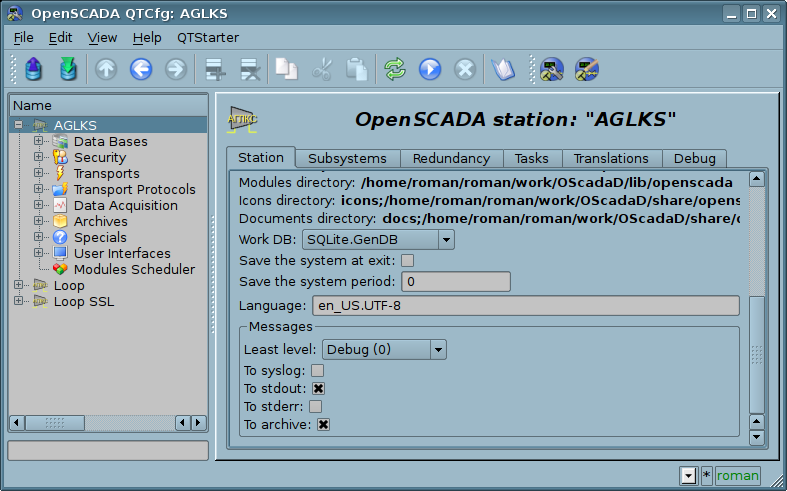

At.png The debugging messages (the suffix is "Debug" or the level is 0), on the last versions of OpenSCADA, will be allowed to observe only after the debugging enabled: the field "Least level" set to "Debug (0)" (Fig. 8) and check category(es) of the messages (Fig. 9), for the details read here! The debugging messages enabling and disabling allows you to include the debug messages permanently into the procedures with the proper category of the place. All other, not debug, messages will show anytime, for levels more or equal to the globally set (Fig. 8).
Fig. 8. Field "Least level" set to "Debug (0)".
