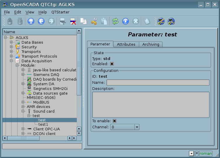

To add a channel of input sound device a parameter of the controller object is created and configured in OpenSCADA. Example of the configuration tab of the parameter is shown in Figure 2.
Fig.2. Configuration tab of a parameter.
From this tab you can set:

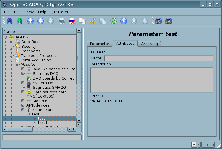

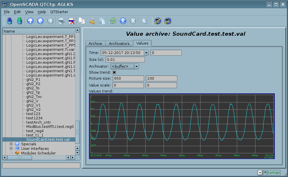

Tab of attributes of the parameter has the form presented in Figure 3, the tab of the values of the attribute's archive "val" is presented in Figure 4.
Fig.3. Tab of attributes of a parameter.
Fig.4. Tab of values of an archive of the attribute "val".
