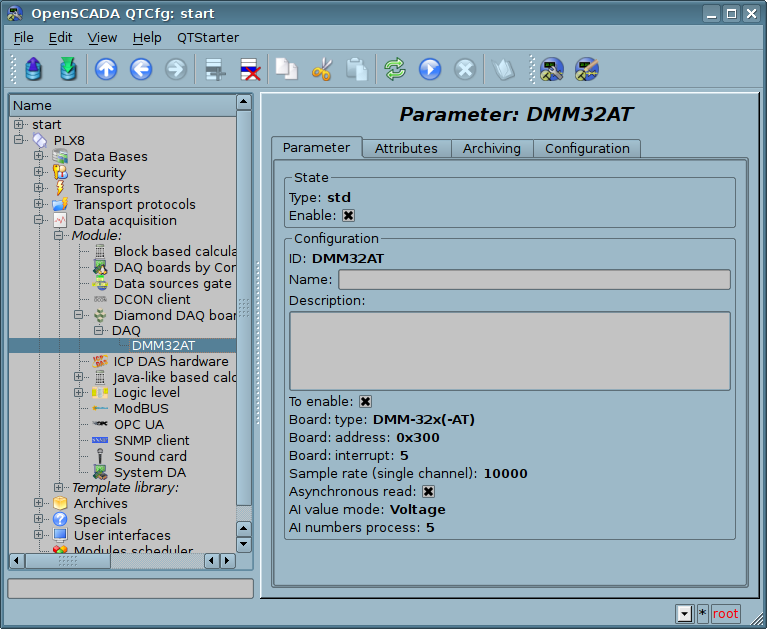

Parameter-board's object same has a configuration of concrete board and provides available on the board data by attributes. Example of the tab "Parameter", configuration of the parameter-board at all, shown on Figure 2, and the tab "Configuration", signals properties, shown on Figure 3.
Fig.2. Configuration tab "Parameter" of a parameter-board at all.
In assistance with the tab you can set:
At.png Value of the field may be dropped to the limit of the counter's frequency of service AI by interrupts, on it's recounting to single channel.

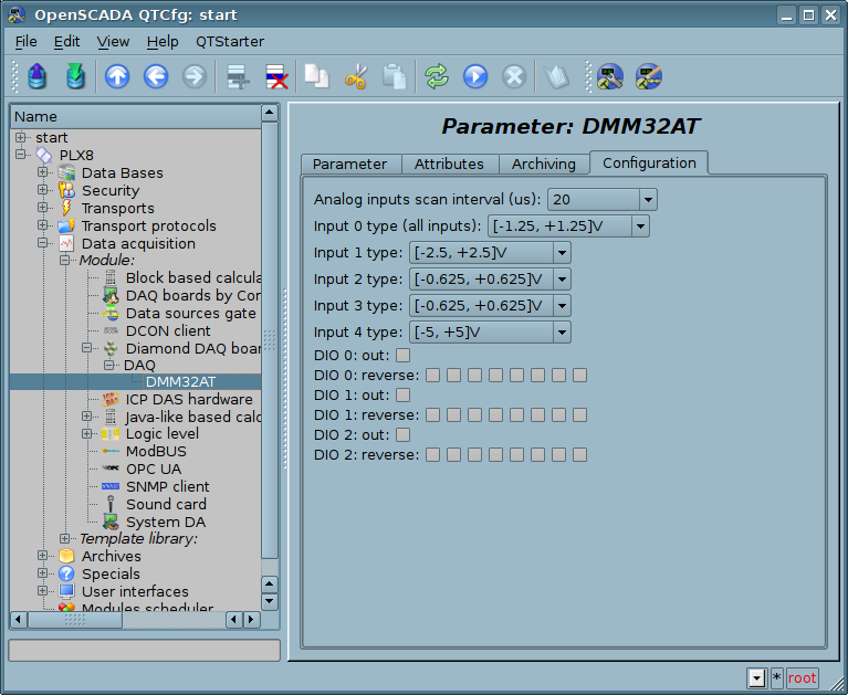

Fig.3. Tab "Configuration" of properties of signals.
At.png In case of the requested samplerate and the interval too big then the result frequency may be dropped to a value got from the scan interval.
