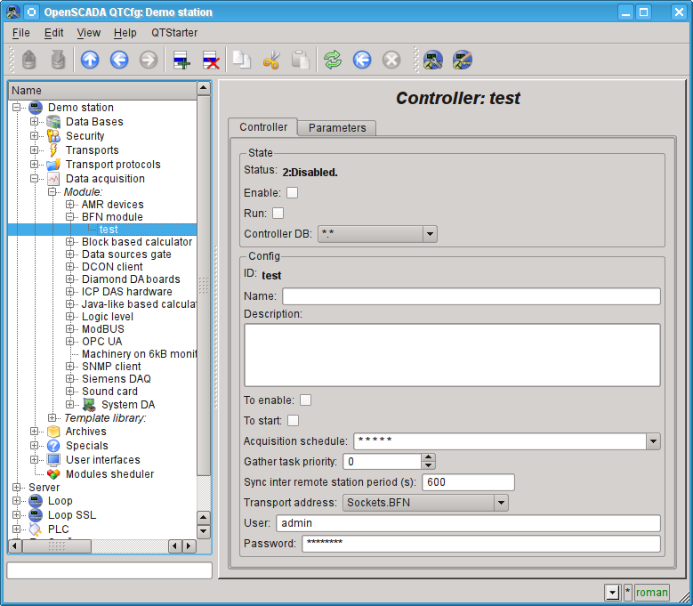

To add a data source, in OpenSCADA creates and configures the controller object. An example of the configuration tab of a controller object of this type is shown in Figure 2.
From this tab you can set:
